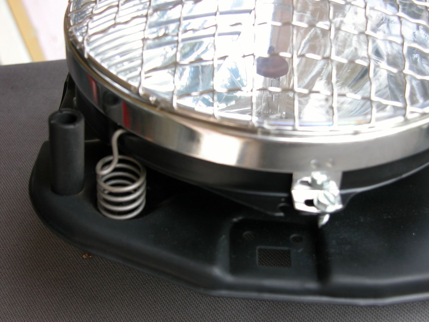

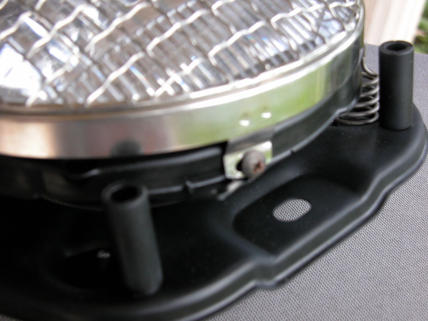

NOT A TA 04-18-2017 07:24 AM
Thanks guys! I'm feeling good and started back to work a couple days ago. Self employed with no insurance, so a month of no pay and a stack of medical bills combined with pay as I go office visits to doctors for follow up provided a lot of incentive to get back at it.
Carbuff; the screens are designed to hold the headlight in place like the stock ring with 3 mounting tabs. The issue is that the 3 tabs for the Jeep application don't line up quite where you'd want them on the Firebird buckets in order to have the screen grid horizontal/vertical. So you need to modify the tabs a bit and drill a couple holes in order to make them look nice and straight.
