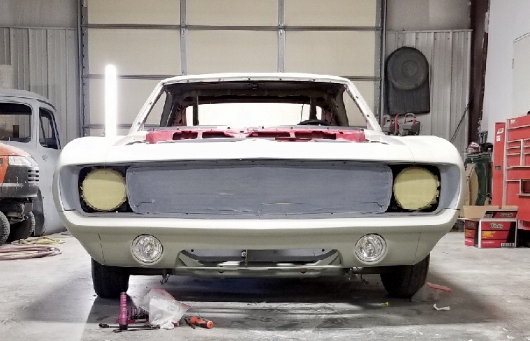

Some final fitment of the headlights. Came together nicely so far. Persistence and patience to get a RS front end just right.

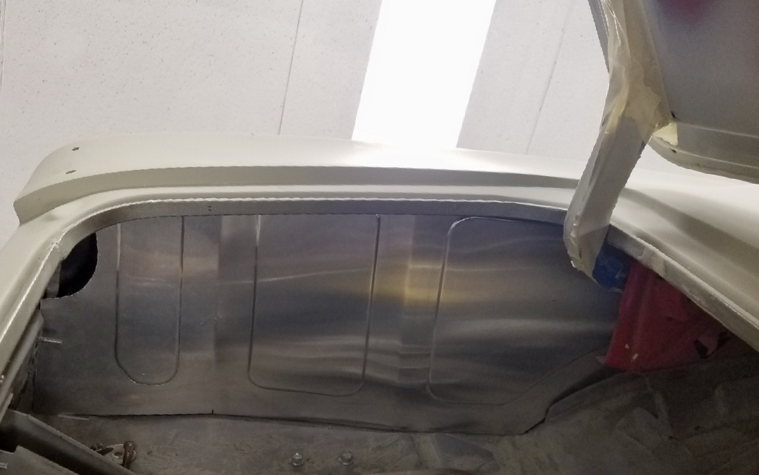

cjfirstgen 04-04-2019 09:35 AM
trunk and back seat bulkheads. The aluminum side panels are removeable while the rear bulkhead is 18ga welded in of course. A little cleanup before paint needed yet.

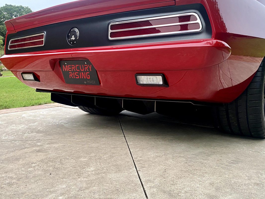

cjfirstgen 04-16-2019 08:00 PM
Gotta have a tag light....flush mounted LED.
https://i.postimg.cc/Rh8Hkgh0/6-C7-D...-D2-FDD113.jpg
https://i.postimg.cc/m225JdVg/FF6-C8...E6-CF1-FCF.jpg
https://i.postimg.cc/J7QFTwNF/6-FB2-...9475869-E2.jpg
