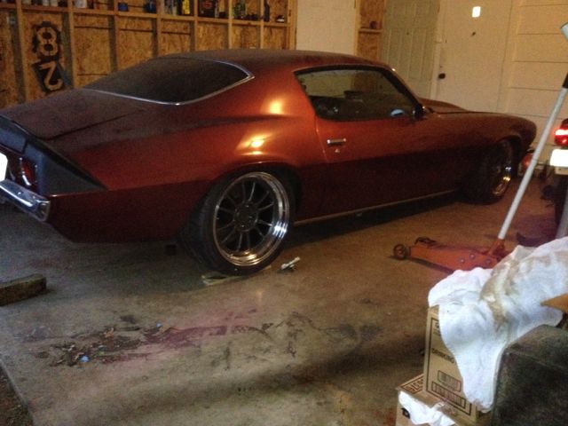

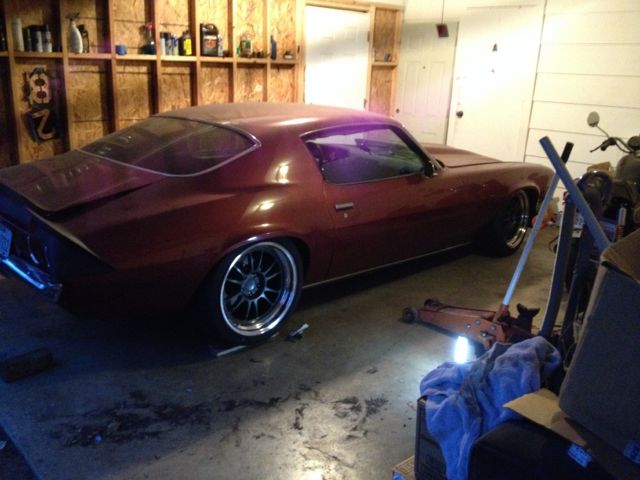

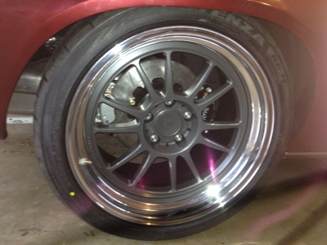

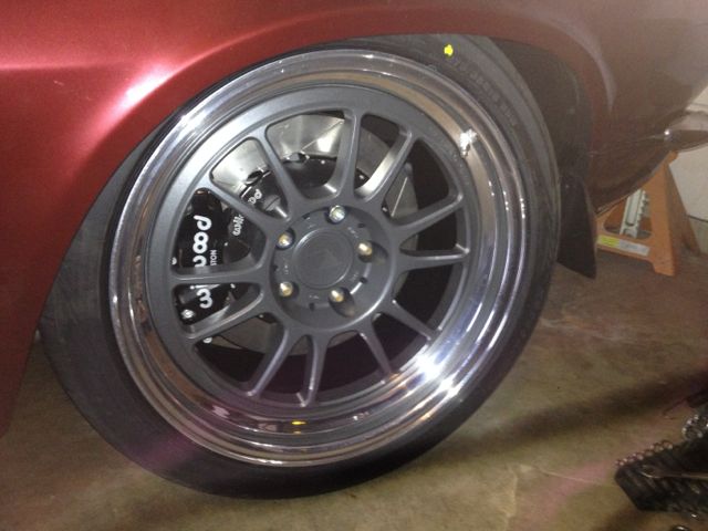

Got the wheels and like the full combo. I was nervous of the wheel depth but really like the the more shallow rear rim rather than a huge lip. I also really like the 18/19" combo. I think the sizing looks perfect on the car and would do it again in a heartbeat.
There are 2 issues but they can be addressed
  1. The tolerance for the rear hub is too tight so the wheels don't fit all the way on.
I'm either going to need to send them back to have the hubs bored out or machine down the hub flanges and add 1/4" spacers. I went concervative on the spacing to allow more clearance with the quarter panels so there is room to space out but it's still a little frustrating.
  1. With the lower ride height that looks awesome the wheels could have used a little more BS.
I'm going to change the inner fenders one more to allow from more clearance. Think I'm going to cut out the entire edge and rather than try to reshape and weld it I'm going to simply fiberglass the edge.
Time for the pics. I'll try to get better ones in the morning.
Attachment 46910
Attachment 46911

WSSix 03-25-2014 08:03 PM
Gorgeous! I hope I can get my stance down low. I see cars like your car and just drool.
GregWeld 03-26-2014 05:54 AM
Those look great Steve!
I know how worried you were... but they turned out awesome.
Payton King 03-26-2014 06:04 AM
I would not be worried about running a spacer on those. Also on the speedway hub is it the standard Ford size register of 3.06? Did you have the wheels made for a Chevy register of 2.78?
If the material is there, I would have the hubs turned down. Had to to do that on my Moser rear for the yellow car I had.

Thanks Greg. I am pretty happy with them but still think a few small changes would have made them perfect. The real test comes on the track so I'll leave it until then.
No, I would not have such an issues with the 2.78" diameter. I gave Travis a rough measurement of 2.5" x1.5" which is the end of the hub and told him it was the Speedway Mod-Lite hub. I thought incorrectly they had cut wheels for the hubs before and knew the specs so they could leave plenty of clearance.. Instead he took my rough measurement and added .003" for clearance. Completely my fault for assuming, I should have given detailed specs for every dimension of the wheels I needed and not made any assumptions. This was my first time to buy expensive custom wheels so I didn't know any better. Hopefully in a few years when I save up the money again to build another car I'll be much more detailed when making my purchase.
I think I could shave ~.030" off the hub (Will call Speedway today) and run the 3.06" inner diameter spacer to clear the radius without issue. It will be tight but I think there will be enough clearance. Expansion of the metal when hot is my greatest concern. Just frustrating given I'm already well over budget both time and money wise.

Talked to Speedway. The drive plates are hardened so they can't be turned. They can be ground but anything more than .01" is not recomended since it may cause cracking near the bolts holding the dust caps. Looks like the wheels will be headed back to Michigan.

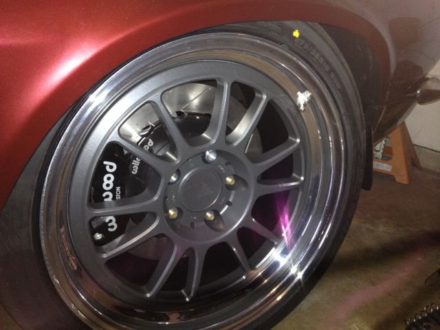

gerno 03-26-2014 08:19 AM
1 Attachment(s)

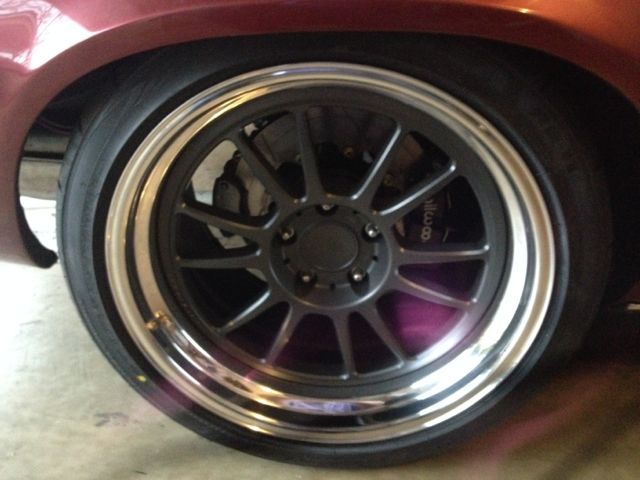

If you couldn't tell from the other posts I was a little frustrated with the issue but after talking to the team at Formula 43 I'm feeling much better. Travis and Trisha are going to take care of me and adjust the bore on the rear wheels. I'm really glad I chose Formula 43.
Here are a little better pics with light.
Attachment 46930

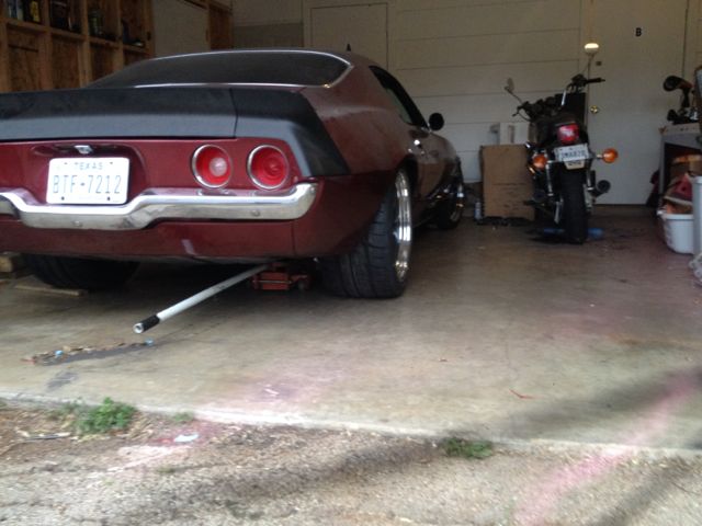

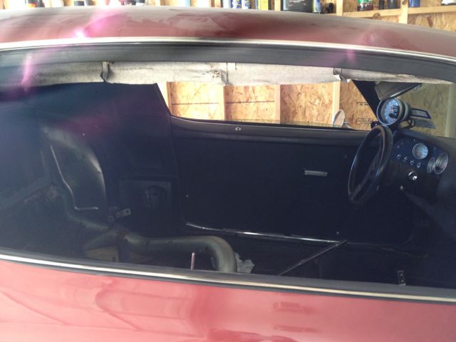

9 Attachment(s)
Originally Posted by FETorino (Post 543666)
Hey where are those daytime photos you promised everyone:headscratch:
Steve
In the end all the effort in getting the combo together will be worth it. The stance and the wheels look stellar:thumbsup:

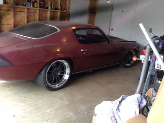

Here are your pics since I know you can't see much on your crackberry. You know I have a connection who can hook you up with a real phone.....
When I'm able to pull the car out of the garage I'll get better picks. For now the car hauler is blocking the drive and I didn't want to take the time to move it.
, in the dark.:lmao:
Attachment 46959
Attachment 46960
Attachment 46961
Attachment 46962
Attachment 46963
Attachment 46964
Attachment 46965
Attachment 46966
Attachment 46967

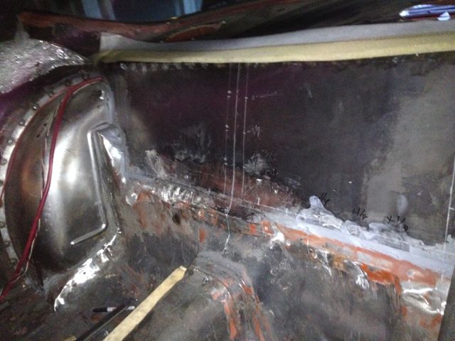

gerno 04-05-2014 08:16 AM
7 Attachment(s)

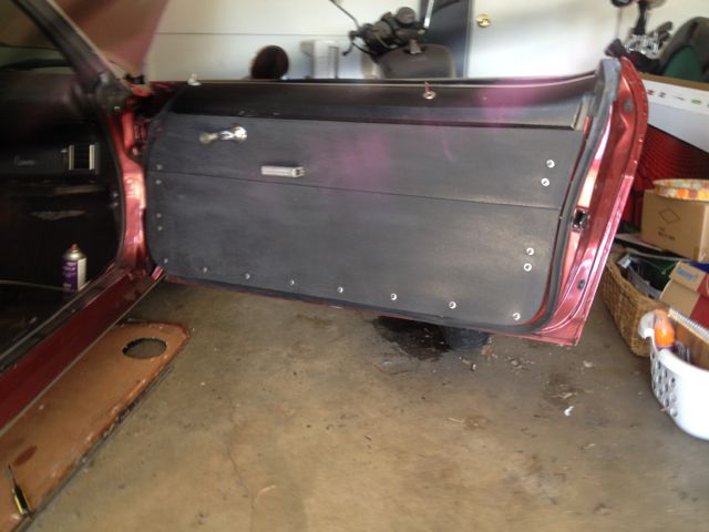

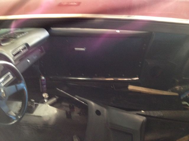

I've been working a little bit on interior cleanup. I tried to make a set of door panels a few years ago. They turned out good at the time but heat caused the glue to release and they really started looking bad. I grabbed a sheet of 1/8" black ABS and built some new door panels.
I plan to use the same material on the rear seat closeout. I added some allen head bolts with stainless washers to create a little more texture. I also cut down the bump in the rear section from the floor seam and welded it closed. '
For the lower area I'm thinking to grab some 1/2" or 1/4" square tube and build a box big enough to house the side exit exhaust if I go that route. I can this cover with the ABS. If I decide not to put the exhaust there I may also move the battery there in the future. I need to weigh the car to better understand my corner weights before making this decision.
Attachment 47253
Attachment 47254
Attachment 47255
Attachment 47256
Attachment 47258
Flash68 04-05-2014 12:05 PM
I like the look of that panel Steve.
