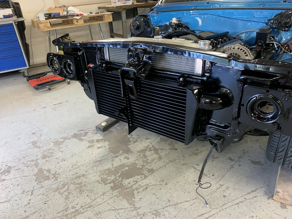

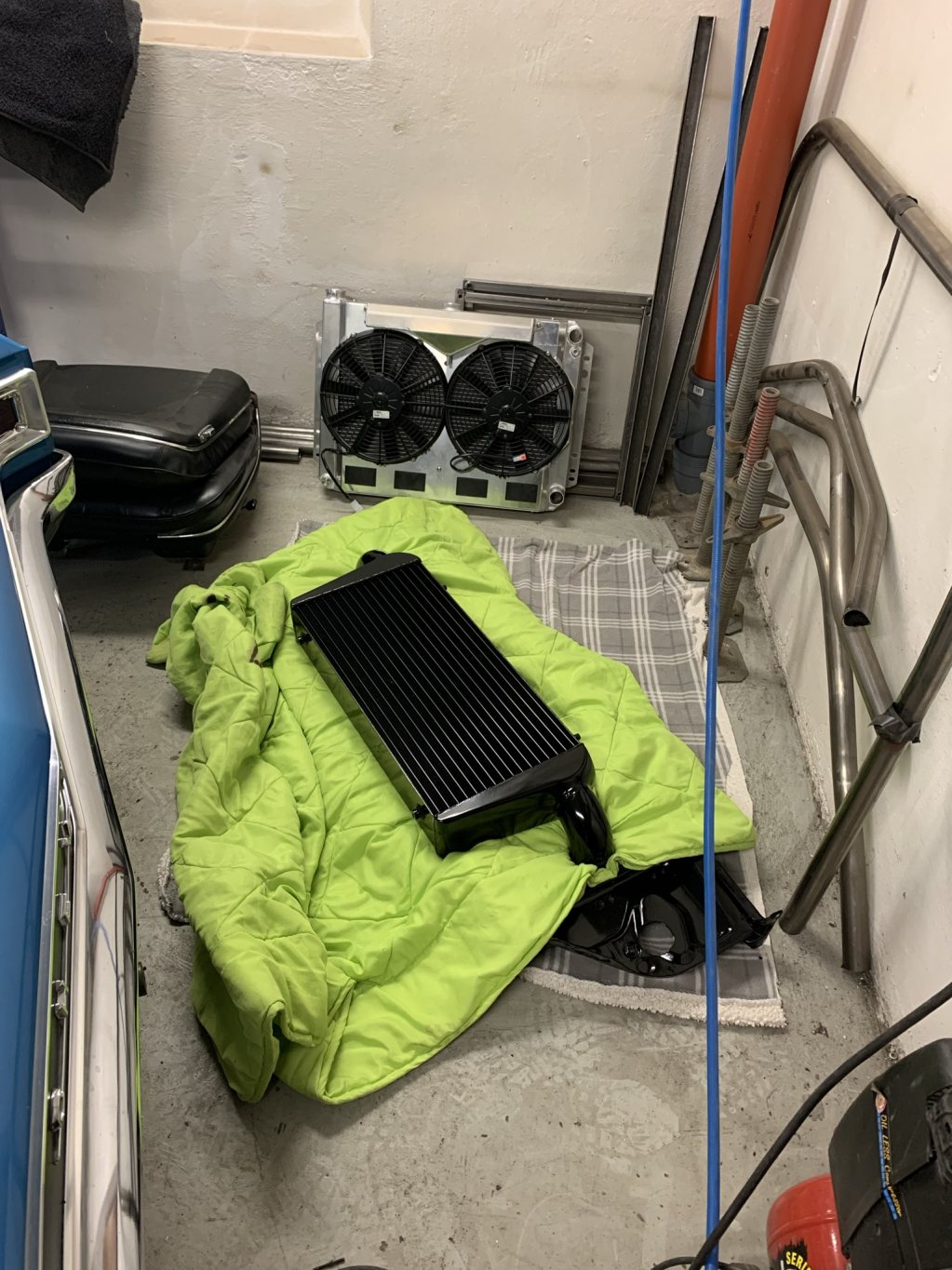

Had a buddy weld some bends and couplers to the intercooler.
PPF is the speedshop here in Sweden thats going to build hot and cold side plus exhaust for the car eventually, they do awesome work
https://rejsa.nu/im/user/8648/2020-0...58e15f092.jpeg
This juuuust fits behind the grille :gitrdun:
https://rejsa.nu/im/user/8648/2020-0...f413fc7f4.jpeg

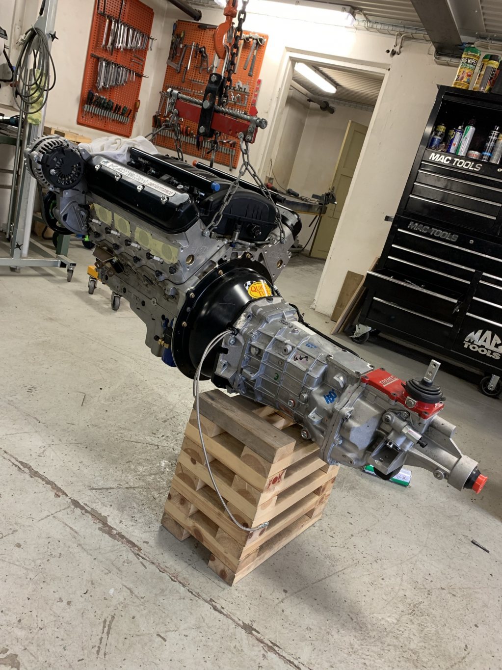

Well, got started with a new much better tunnel over the weekend.
Will do the sides tomorrow and then take out engine and trans to finish it of and make the panel towards the firewall :thumbsup:
https://rejsa.nu/im/user/8648/2020-1...5e451209e.jpeg

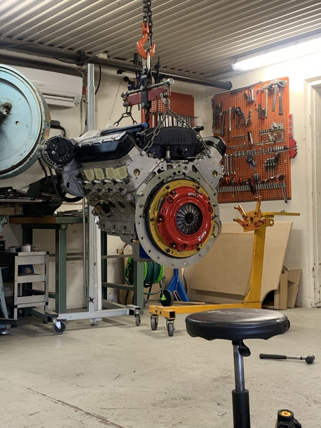

warhawkchevelle 01-09-2021 08:46 AM
R
Engine and trans came out yesterday, before I put them aside for a while I decided to get the hydraulic throw out bearing set at spec .200” for my dual disc clutch.
Installed the clutch and started measuring, had to remove some material from the plate between bearing and transmission to get correct play.
https://rejsa.nu/im/user/8648/2021-0...19219f8fd.jpeg
https://rejsa.nu/im/user/8648/2021-0...cbdaef170.jpeg
https://rejsa.nu/im/user/8648/2021-0...0a720fd02.jpeg
https://rejsa.nu/im/user/8648/2021-0...74bc81f81.jpeg

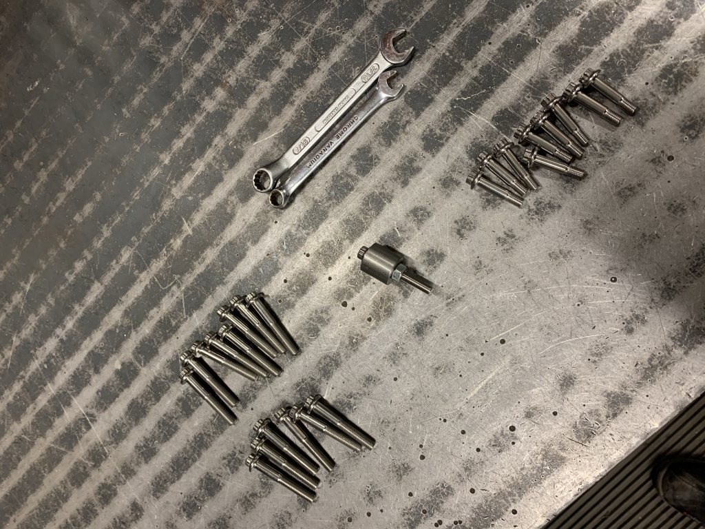

warhawkchevelle 03-27-2021 11:49 AM
Hello!
I had to make some wheelspacers to clear calipers to the spokes.
It turned out to be a little tight to the quarters, a buddy came up with the idea to move the disc and caliper instead so I had some spacers made.
https://rejsa.nu/im/user/8648/2021-0...ab3cedcc0.jpeg
Ordered some new longer stainless ARP hardware to get a longer unthreaded section, had to shorten them a bit.
https://rejsa.nu/im/user/8648/2021-0...a916ba3f5.jpeg
https://rejsa.nu/im/user/8648/2021-0...51eed1e7a.jpeg
Much better and fully centered in the tubs again, had to wipe them down and enjoy a beer :D
https://rejsa.nu/im/user/8648/2021-0...8bb0f2b79.jpeg

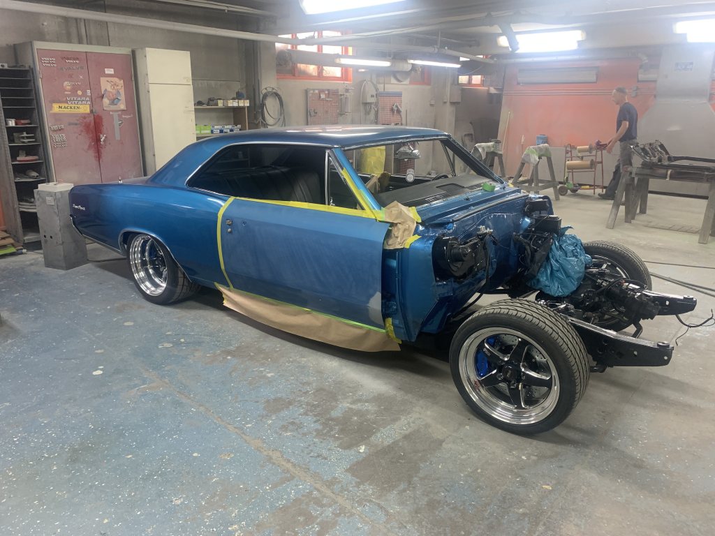

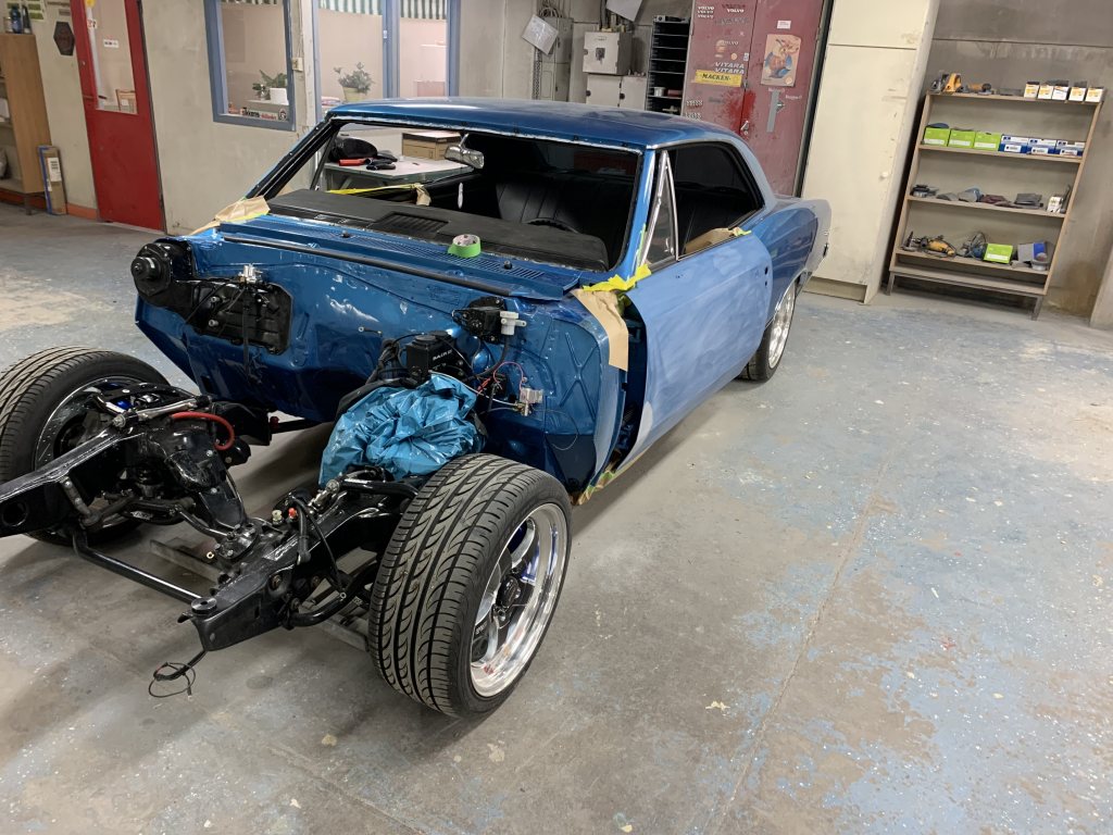

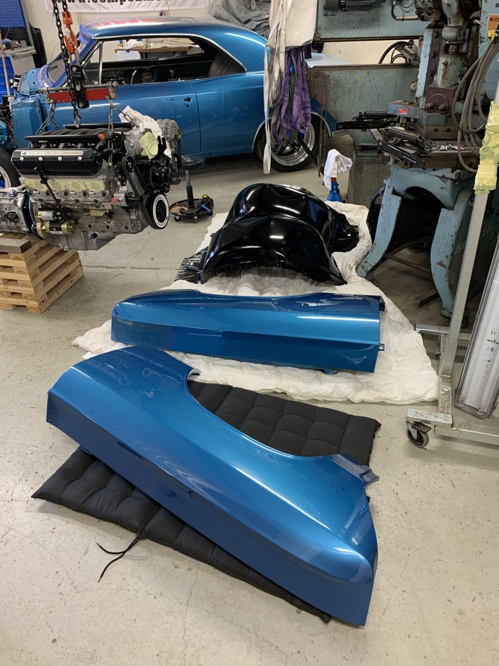

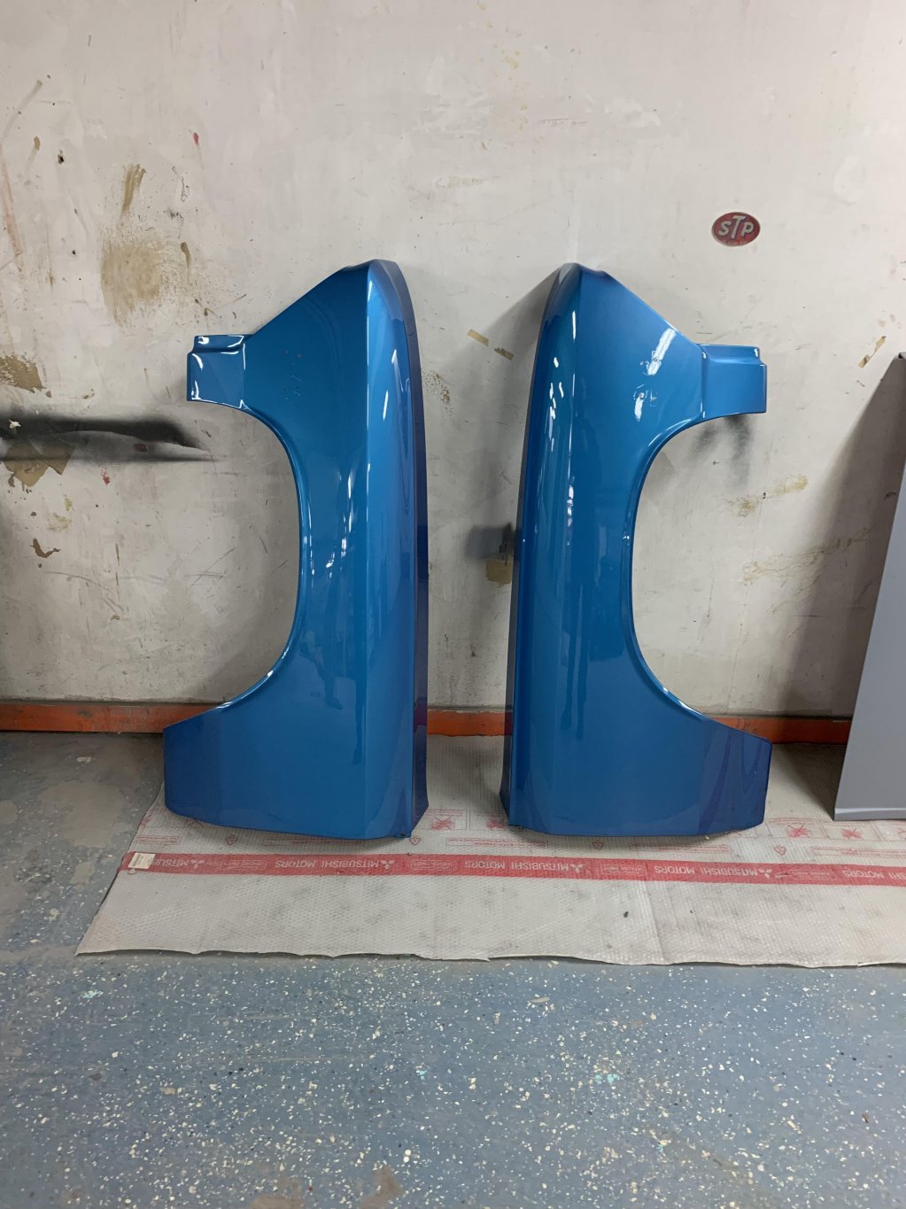

warhawkchevelle 06-24-2021 09:18 AM

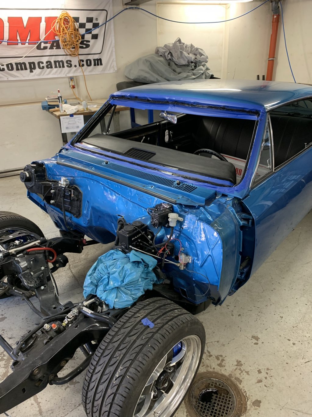

Fenders are painted, he will paint the inside in the same semigloss black as the rest of parts for the frontend.
Left all of those today, radiatorsupport and Hood latch and all the small parts.
Helped him push the car into spraybooth, so the doors will get painted tomorrow and then I can take the car back home :D
https://rejsa.nu/im/user/8648/2021-0...bebf992ff.jpeg
https://rejsa.nu/im/user/8648/2021-0...d3fdee5f4.jpeg
https://rejsa.nu/im/user/8648/2021-0...200e67f0a.jpeg

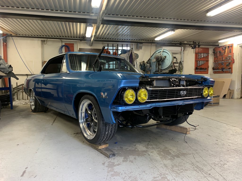

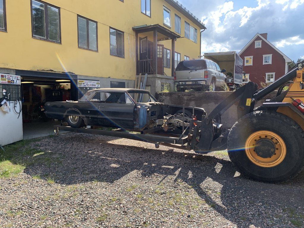

warhawkchevelle 07-06-2021 08:45 AM
The Chevelle is done at the painter, taking it home tomorrow to start assembly.
Got some help from a buddy with a loader today to lift the Impala upstairs until the Chevelle is done. Always nice to have more space during assembly :headspin:
https://rejsa.nu/im/user/8648/2021-0...4ade88304.jpeg

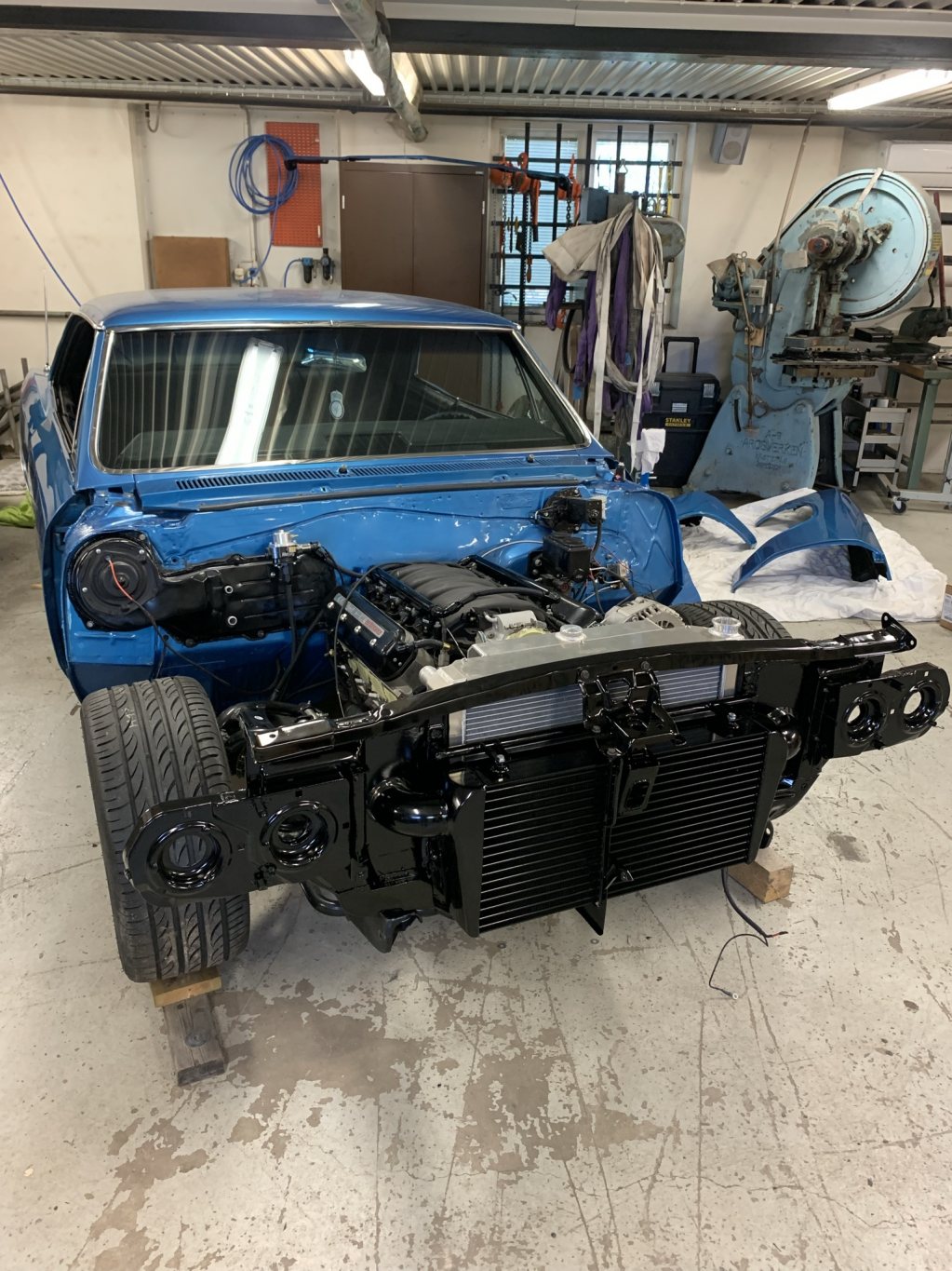

warhawkchevelle 07-08-2021 11:37 AM
Towed the car back home yesterday and all the parts today.
Im gonna glue in the windshield tomorrow before mounting motor and trans.
More space to move around now :thumbsup:
https://rejsa.nu/im/user/8648/2021-0...abb35c69c.jpeg
https://rejsa.nu/im/user/8648/2021-0...10eb49d92.jpeg
https://rejsa.nu/im/user/8648/2021-0...8a8721a07.jpeg

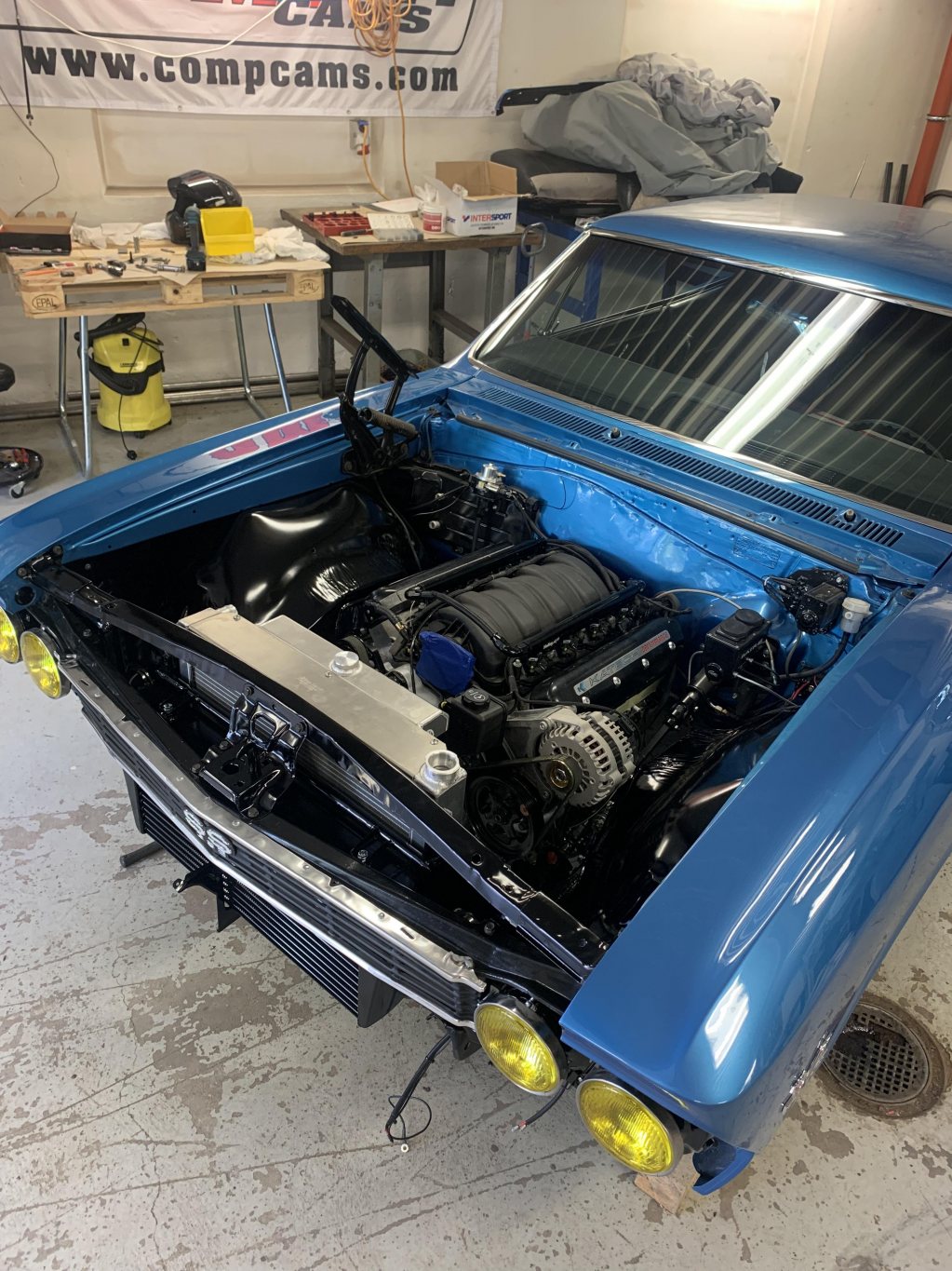

warhawkchevelle 07-19-2021 11:21 AM
Mounted and adjusted fenders and wheelwells today, looks alot better already :)
Gonna polish some stuff tomorrow before install.
Also ordered the new ICON 102mm throttlebody from motion today, unfortunately the 90˚ will not fit my combination because of offsets.
A buddy is gonna help me to design with my measurements with a reducer from 4” to 3” then have it machined.

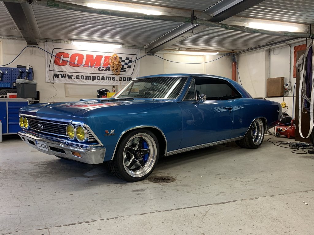

warhawkchevelle 07-23-2021 11:00 AM
Exteriör trim all done!
I will lower it a little in the front and raise it some in the back but I like the look :)
https://rejsa.nu/im/user/8648/2021-0...3ef46a40a.jpeg

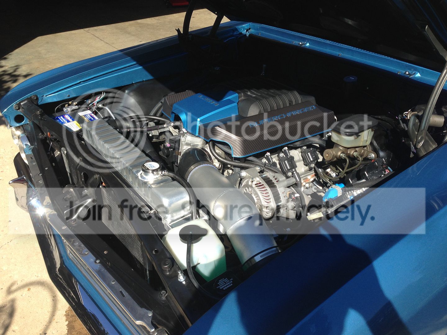

kwhizz 07-24-2021 05:03 AM
https://hosting.photobucket.com/albu...aa5b5b2bf3.jpg
kwhizz 07-24-2021 05:08 AM
https://hosting.photobucket.com/albu...DE00C3FBBF.jpg

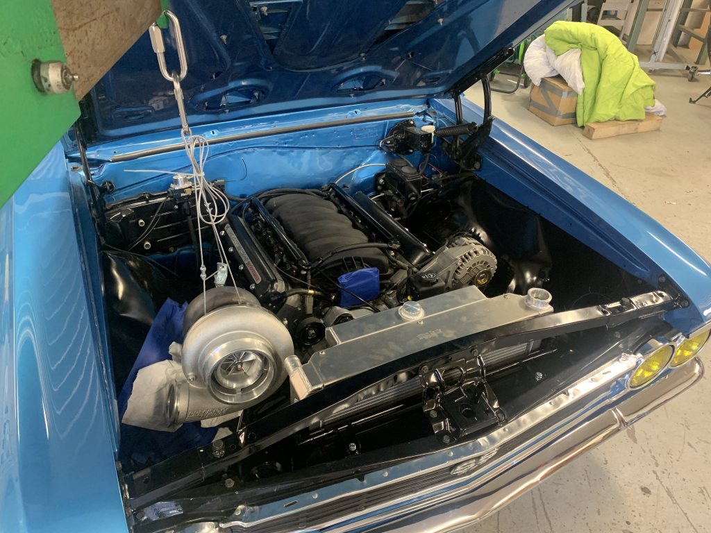

warhawkchevelle 07-24-2021 05:45 AM
Looks awesome Kwhizz :wow:
Around there will the turbo sit, its a Precision 8284 (1350hp rated )
Will get a custombuilt kit in the fall by Pure Performance Factory here in Sweden
https://rejsa.nu/im/user/8648/2021-0...d41163bae.jpeg
