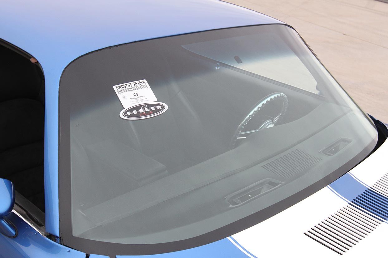

Goosesdad 01-01-2018 10:23 AM
2 Attachment(s)
Originally Posted by Musclerodz (Post 671059)
I would extend the a pillar gaps, they tend to run wide.
Hi Mike! Thanks. Honestly, I haven't done a deep dive here, just a quick test fit. Yep, agreed the pillars need to come down to close up to the doors but what's interesting is that the glass seems to extend down further on the drivers side than it does on the passenger. The result is that the bottom of the glass is exposed on the passenger side where the drivers side is covered by the door and the fender. This is with a consistent 1/8" gap around the glass. First thought was raising the pass door and fender but the bottom gap is already about perfect and the body line is pretty accurate. Appreciate any thoughts...
alex n 01-01-2018 01:20 PM
I am building one of these cars as well , I had to extend the gap’s on the pillars to get it right on both sides , as for your windshield situation is the passenger door too low ? that seems odd.
Goosesdad 01-01-2018 06:57 PM
I don't think so, gap is about 3/16" to the rocker and I already closed that gap by 1/16" when I added my rocker extensions. I will chase this a little more next week and let you know. Thanks.

Here you can see the fitment to the doors and fenders to a car that was painted about 18 years ago... We are removing the trim and will repaint the car and fix the A-pillar at that time for a perfect fit but we designed this to fit as well as possible for all cars and yes they are all a little different. Are you fenders or door factory? This car is all factory Camaro. You gap is the largest one we have seen yet.
So as you can see on a factory car they are just about even or as even as we could get them and not hit anything. We want the glass to be tight but can't be to tight that it hits the metal or you will break it. There has to be a gap around the glass or in flex you will snap it. Hope this helps somewhat. That car is going to be bad ass...

Goosesdad 01-04-2018 08:55 AM
Driver Side car not touched...
http://i269.photobucket.com/albums/j...ps4rcxzqxf.jpg
Passenger Side car not touched...
http://i269.photobucket.com/albums/j...psh7tr0eej.jpg
Thanks Chris! FOR SURE this isn't a glass issue....it's me! Glass is great! Just need to find the balance of the bottom gap and the body line a bit better I think. My pics show the glass touching the A Pillar....it doesn't touch, I was doing this alone and it just slid down a little. I'll redo these pics soon and show how well the glass fits.

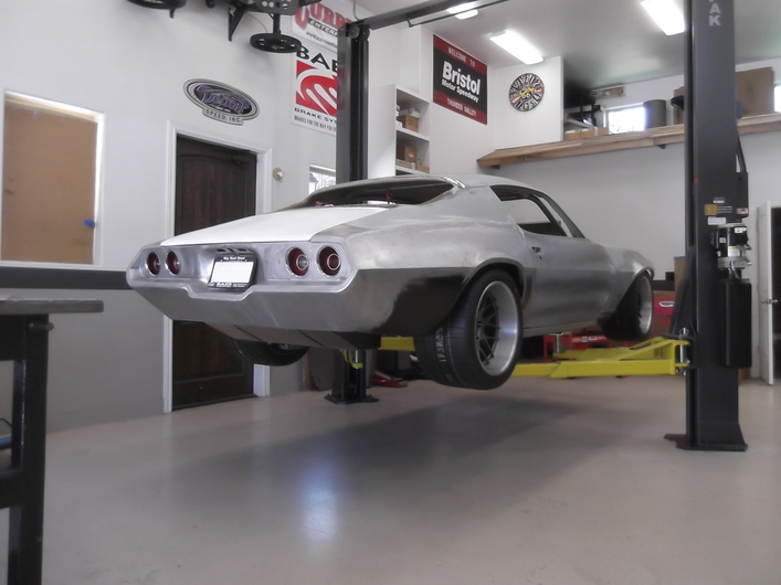

Goosesdad 01-07-2018 08:20 PM

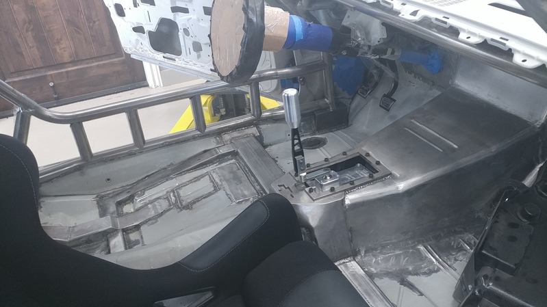

3 Attachment(s)

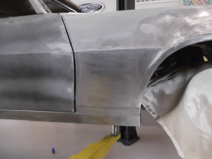

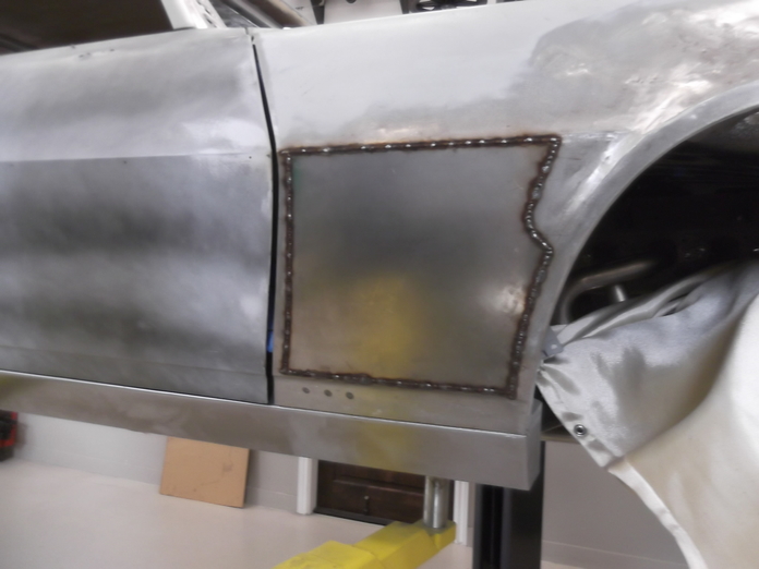

Driver side rocker almost done.
Goosesdad 01-07-2018 08:32 PM
2 Attachment(s)
I did a more careful test fit of the front glass. Gap is great! Update on my earlier posts on this...for some reason my passenger door sits a little lower than the driver side, I will adjust a little of that out when I do a final door/fender adjustment. I ordered my radiator and core support this week, I'll do the final adjustments once that's installed. On to the rear glass next week!

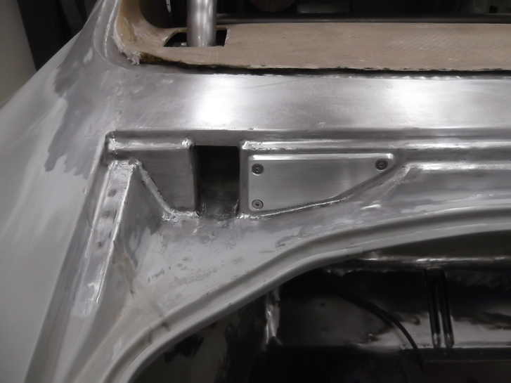

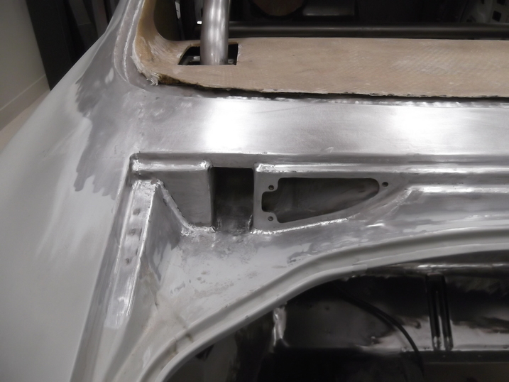

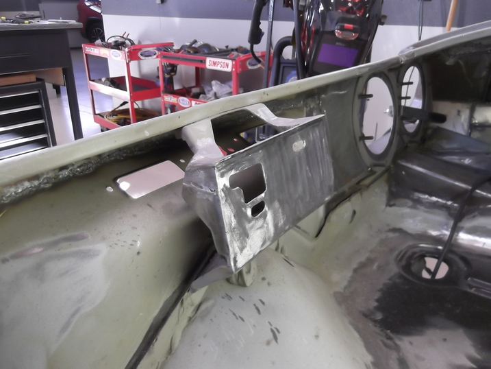

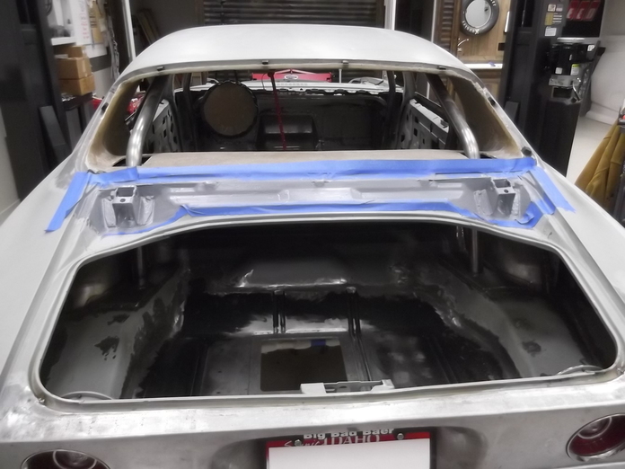

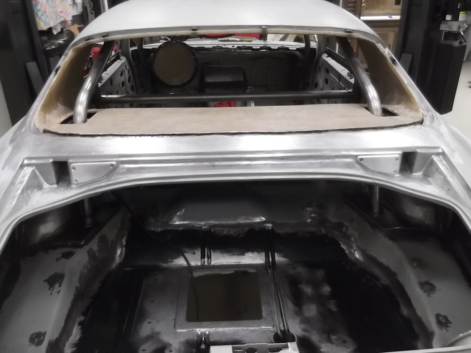

Sealing up the trunk filler panel.
Started with an AMD filler panel, fit pretty good.
Attachment 64634
This area will be completely sealed, applied rust protection.
Attachment 64635
Welded the seams both on the trunk side and the rear window side, will be 100% sealed from water. Took some fitting. I welded up the seam between the filler panel and the fender but I will recreate that seam later....just to keep the factory look.
Attachment 64636
I didn't take any pictures of how the trunk hinges mount, sorry about that! Basically a pin through stock/modified hinges with brass inserts for bushings.
Made an access panel so I could remove the hinges.
Attachment 64637
Attachment 64638
Attachment 64639

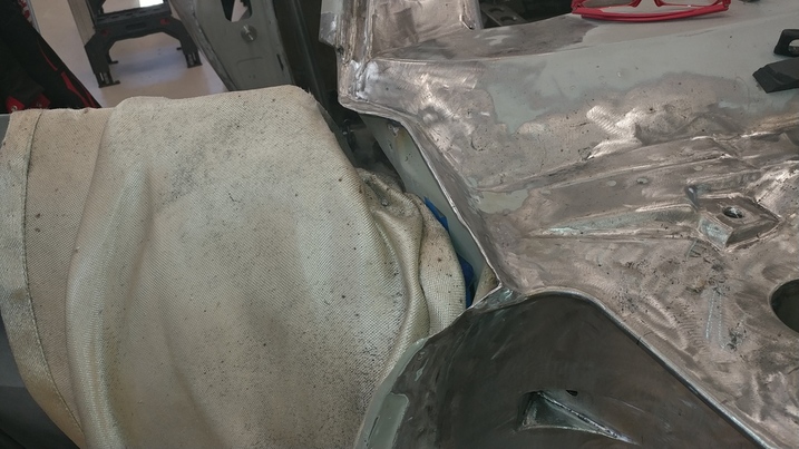

Goosesdad 03-04-2018 08:01 PM
6 Attachment(s)

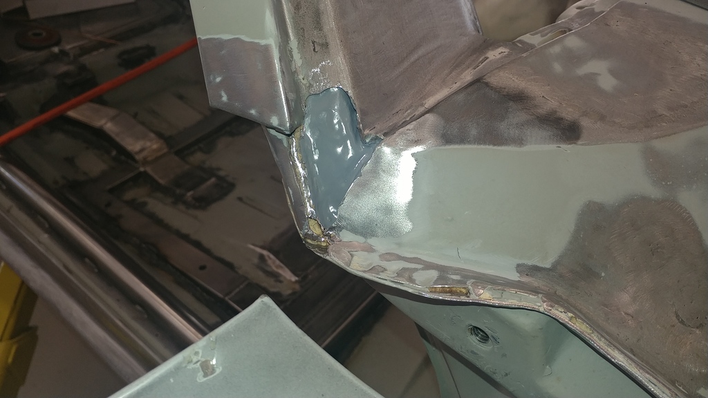

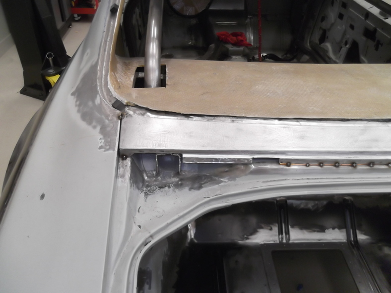

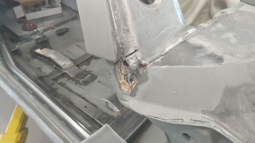

A little rust repair on the A-pillars and tying in the roll bars.
alex n 03-05-2018 09:09 AM
what tools are you using to knock down the welds and finish the metal.
alex n 03-06-2018 12:28 PM
The metal finish looks damn good, 3M makes a spot weld grinding disc that I started using recently for use with a die grinder , it knocks down welds insanely quickly 3M #01991, I started using it after my pile of spent 2 inch discs turned into a mountain
Goosesdad 03-08-2018 09:41 AM
Ahhh! Very cool, thanks for the advice. Ordered!

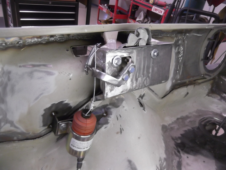

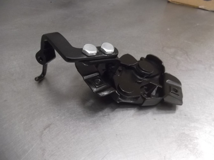

Fab'd up the automatic trunk release set up. Used an actuator from Electric Life. Works pretty nice. Has a button for inside the cab and a 12 channel remote, though probably only use the door locks. Made a custom arm and welded it to the trunk release tab on the factory trunk latch. Had to make a new plate to mount the latch, factory location wouldn't work with the fiberglass trunk lid.
Attachment 64961
Attachment 64962Attachment 64963
Sounds a little more intense than it really is, just echoing in the metal trunk. That cable clamp is just temporary, will use a cable crimp for final assembly.

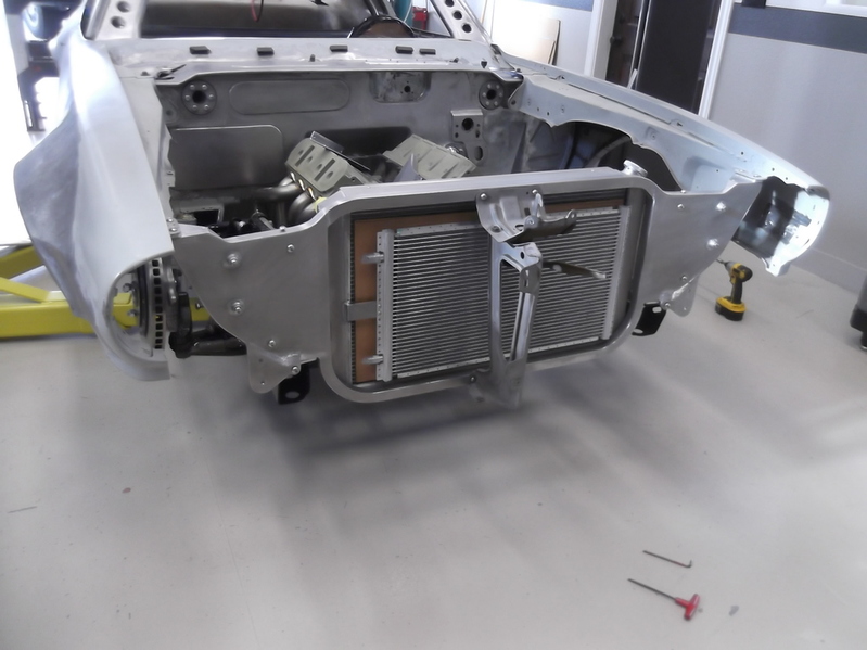

AutoRad radiator and core support arrived. REAL nice piece, everything looks great. Serious attention to detail and that was continued in the packaging for shipment, well done x 10! Looks good (will be painted later). Fit perfect. Had them install a condenser but decided to do remote oil and power steering. Dual 14" Fans and their handmade shroud....looks awesome!
Attachment 64969
Attachment 64970
Attachment 64971

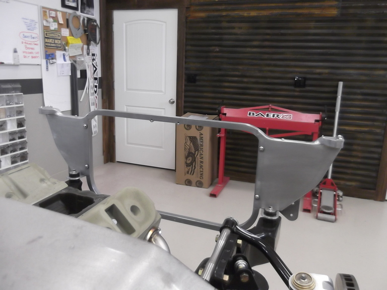

3 Attachment(s)

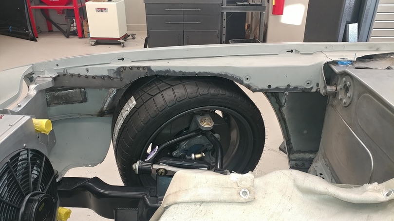

Needed to do a little re-do of the lower section of the front fenders, was a little wavy after the flares were done.
Attachment 65340
Attachment 65341
Started the inner fenders by building the flanges.
Attachment 65342

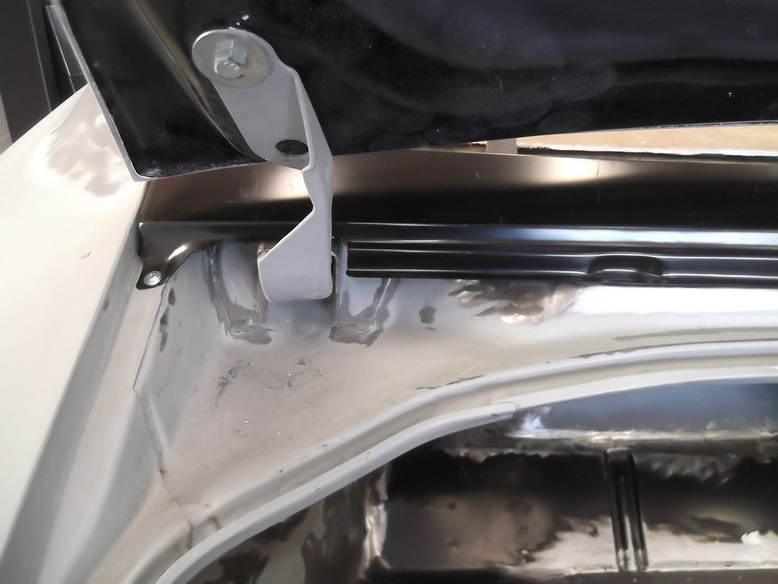

Cleaned up the front fender mounts, just to hide the gap.

Finally welded the new rocker to the door jam.
Attachment 65871
I think this is actually the very last bit of rust repair.
Attachment 65872
Attachment 65873
