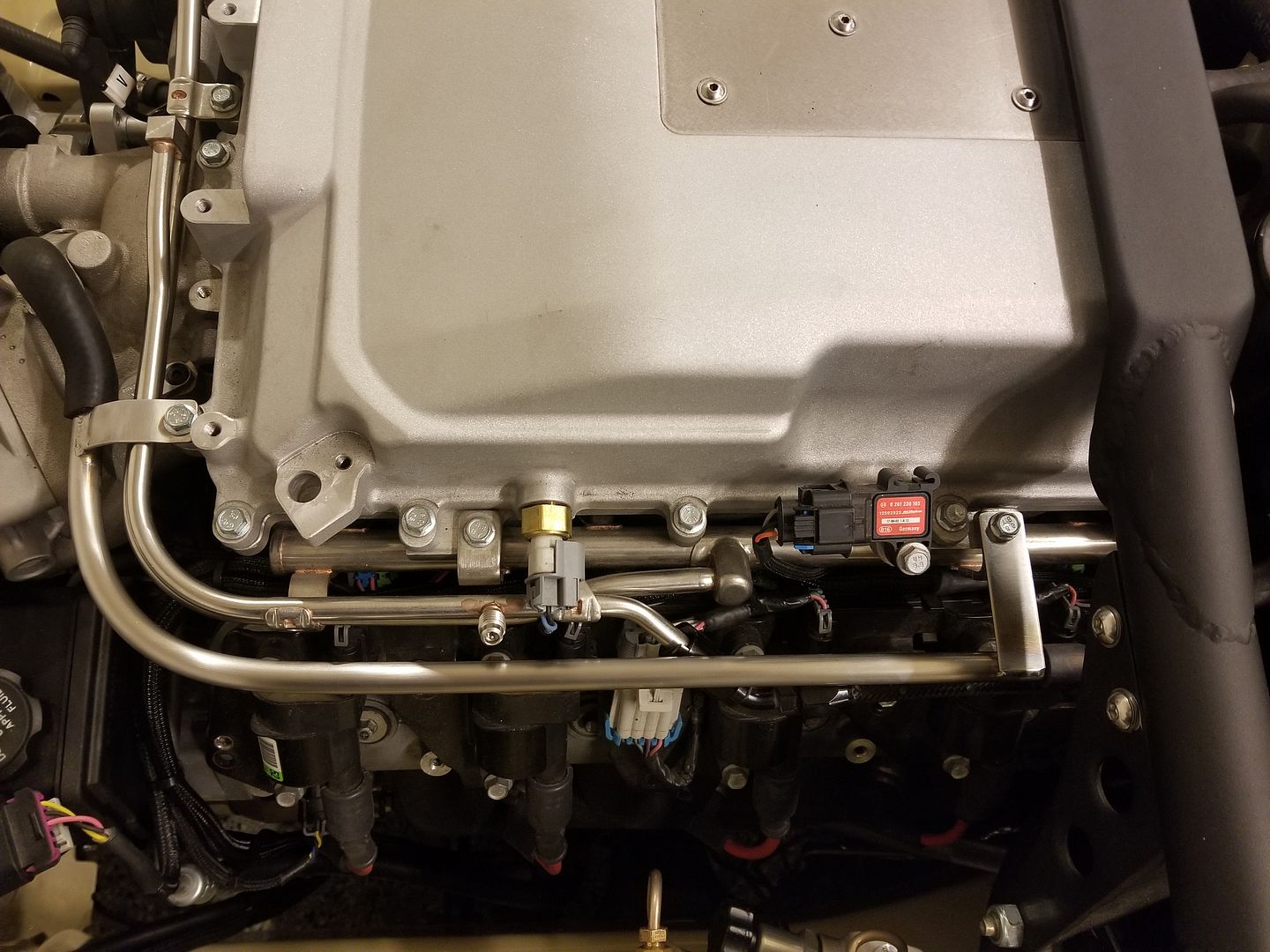

Got the exhaust hung after having a buddy weld it all out for me......its the second thing on the car that I have not done myself, he is however a far more experienced welder and it turned out amazing. Only hang up installing was the rear hanger moved and I didnt open the hole for the wideband sensor enough to fit so it had to come back out, get a couple things dialed in and then final install.
Pretty sure its going to hit on the axle tube but I can deal with that a little later.

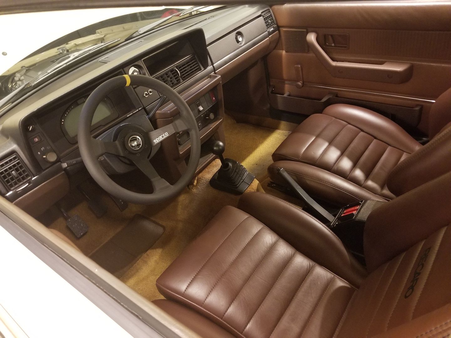

Once I got the dash in I got to work on getting that bad ass cluster all built and put together. For those that have not seen it, this thing is seriously a work of art.
http://i1133.photobucket.com/albums/...ps7dxxkgli.jpg
Getting there, First look of the dash bolted in.
http://i1133.photobucket.com/albums/...ps97ellasw.jpg
By the end of the day I had a fully installed dash and console. There is a lot of little detail work to make highly modified look simple and tasteful.
This is the inside of the glovebox,
Pic is hard to tell but the OBDII port is mounted on the exterior of the box and just pokes through, the connector is for OBDII can bus interface for the race pak setup. The white wire is for data logging the AFR's. Behind that is a flush mounted USB port for programming the Race Pak dash configuration.
MIL Light is flush mounted in the top corner of the glovebox opening.
http://i1133.photobucket.com/albums/...ps2kojsuug.jpg
All assembled and functioning.
http://i1133.photobucket.com/albums/...pstkh2lytk.jpg
http://i1133.photobucket.com/albums/...ps2obeqnjg.jpg
http://i1133.photobucket.com/albums/...psxxqpwqt8.jpg
http://i1133.photobucket.com/albums/...pswkzdsadr.jpg
I also spent a bunch of time fighting with the stupid TCM controller. Long story short, the e38 ecu and OS I am running doesnt like having the VSS input straight into it, so we are having to run a TCM controller, send the VSS into the TCM controller and from there over can bus into the ECU but when I hook it up it corrupts the Can Bus so working with Jolt to see if he has a different solution.
If all goes well this thing should be ready for some tuning in the next few weeks.

Kind of a **** show of a week, sometimes you win sometimes you loose. Bought a new steering wheel and the dish that I thought would work great is just not enough and the wheel is too close to the turn signal and windshield wiper lever.
Managed to work on the can bus issue and pretty sure I made it worse.

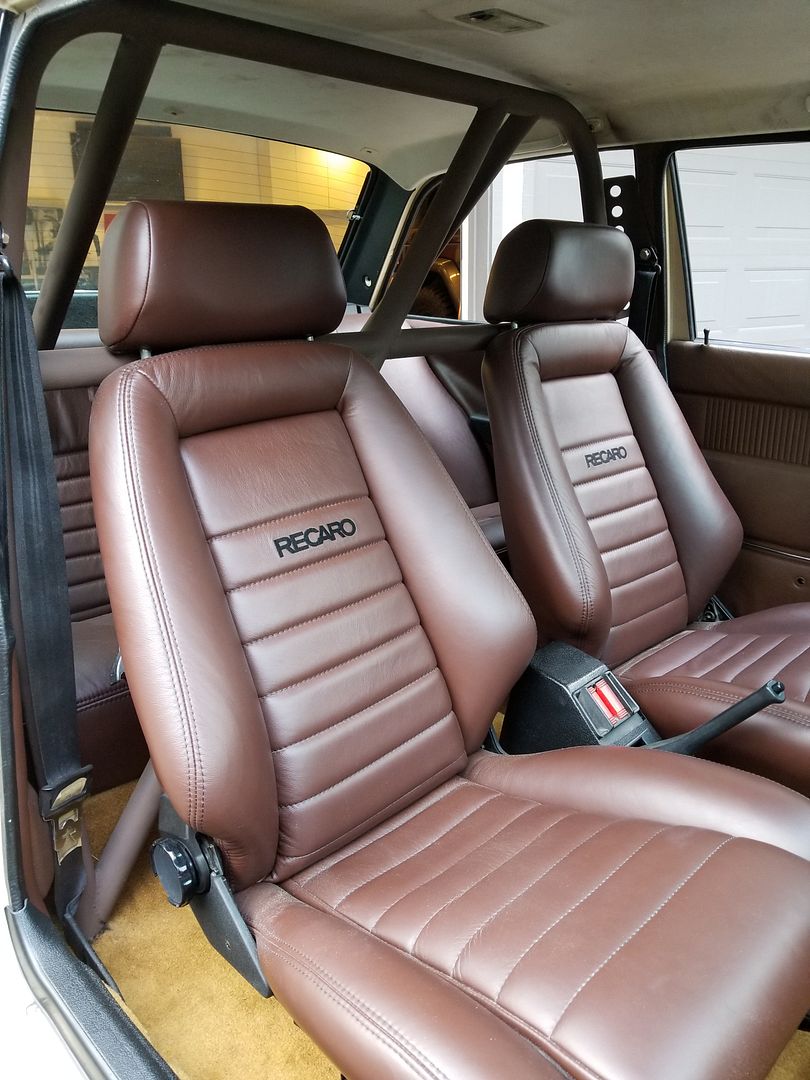

I did manage to get the rear seat and door cards picked up from the upholstery guy. Have a little spot on the top of the seat back that needs redone but can do that down the road. Other than that turned out great. Pretty much what I had in my little pee brain.
Pretty sure nobody needs this many pics of a volvo rear seat but I am excited about how its turning out.
Not sure about the black handle yet, but all brown seemed to be a little bit too much.
http://i1133.photobucket.com/albums/...ps7u6sgphl.jpg
Isnt this how you are supposed to put a seat in?
http://i1133.photobucket.com/albums/...pstfoqokrh.jpg
http://i1133.photobucket.com/albums/...psssge0cqr.jpg
http://i1133.photobucket.com/albums/...pswtrld9kz.jpg
And the whole thing together.
http://i1133.photobucket.com/albums/...psmvtmrrlx.jpg
http://i1133.photobucket.com/albums/...ps6kgpxkm8.jpg
http://i1133.photobucket.com/albums/...psgjo0whg7.jpg
http://i1133.photobucket.com/albums/...ps23vckydi.jpg
Flash68 02-06-2019 11:16 PM
Just incredible... so killer. :bigun2:
SSLance 02-07-2019 06:46 AM
I love that you went thru all the effort and expense to put a rear seat back onto the car that is 100% impossible for anyone to ever sit in. :D
Makes my sheet metal and carpet rear seat delete kit seem ametuerish. ;)
Looks great. When is first test drive around the block?

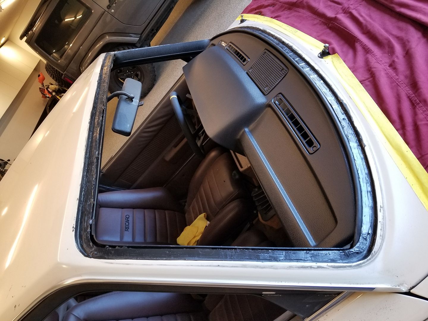

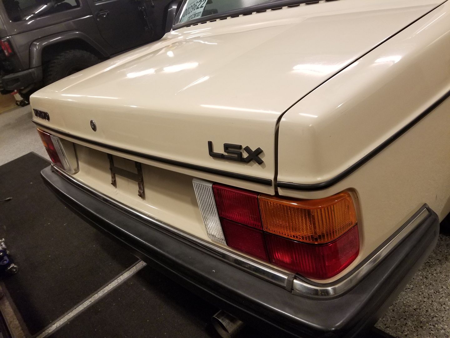

Very little progress on the car, picked up the deeper dish steering wheel and got it bolted on, much better clearance on the turn and windshield wiper levers.
Also got a bunch of little items buttoned up. Got the clip for the wiper motor installed. Rear passenger seatbelt indicator purchased and installed, final blank plate for the dash installed as well.

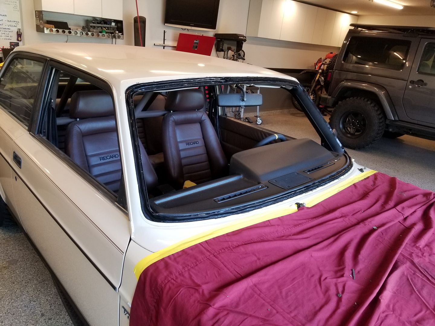

Aside from a little fix on the carpet and the rear driver window the interior is buttoned up as well as it is going to be for now. Still need to get the door panels in for upholstery but that will happen in a few weeks, will only take him a day to knock them out.

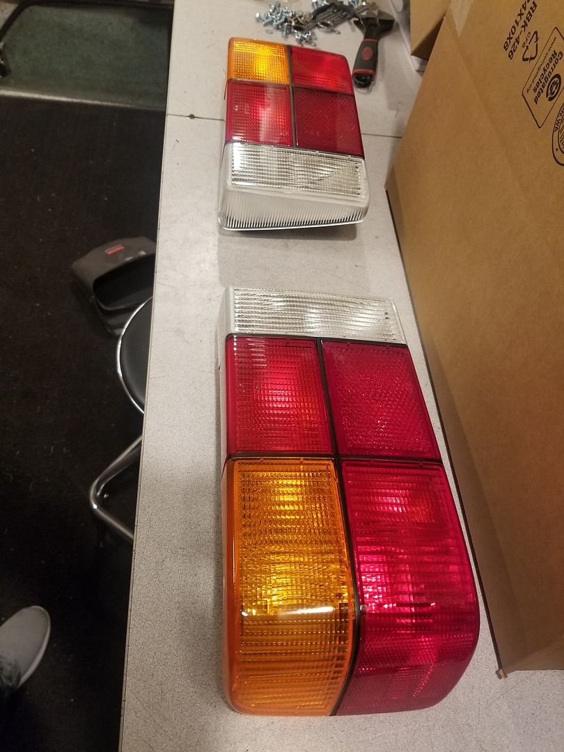

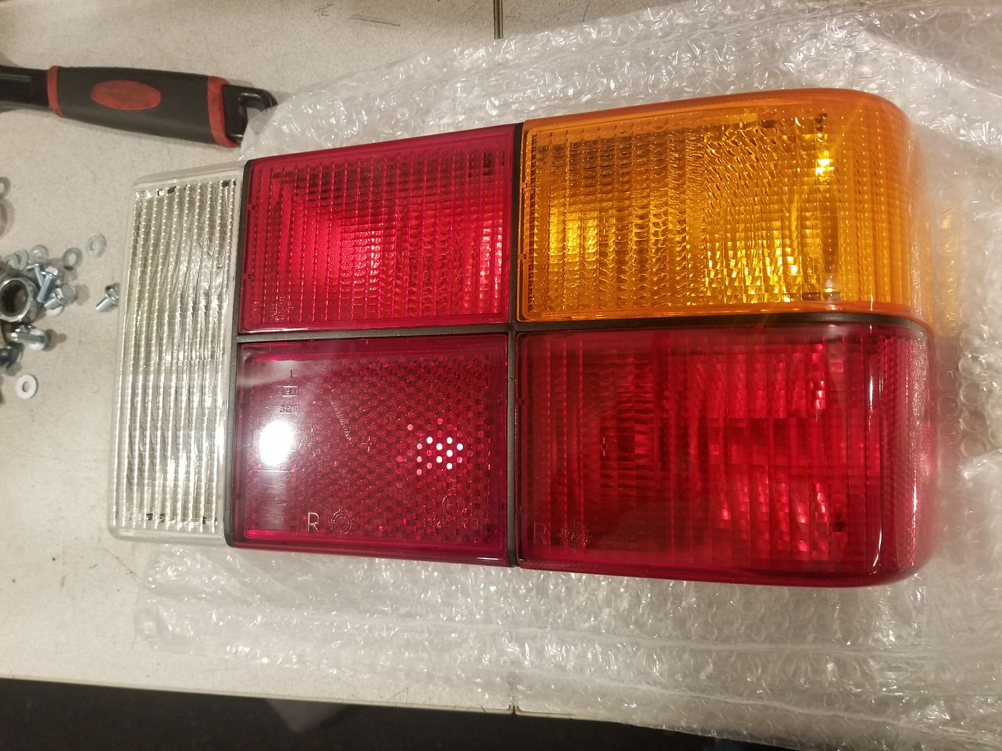

I didnt have a ton of motivation this weekend so I got to stripping off all of the old trim (what was left on the car).
I had 4 of the 6 pieces on the car so popped them all of and got to work pulling the old trim clips.
http://i1133.photobucket.com/albums/...psgifni5yf.jpg
Its hard to describe but from the time of it sitting around it built up some horrible crud above and below the trim on the paint. I tried everything I could in order to get it off, purple power, rubbing compund, clay bar, hard plastic scraper and I could not make a dent in it. I had a buddies steamer and thought what the hell, cannot hurt so I gave it a shot. Steamer with a brush on it worked amazing. I spent hours on the drivers rear quarter by hand. Had the passenger side all the way down done in 30 mins with the steamer.
You can kind of see what I am talking about in this pic.
http://i1133.photobucket.com/albums/...pshzxckr5e.jpg

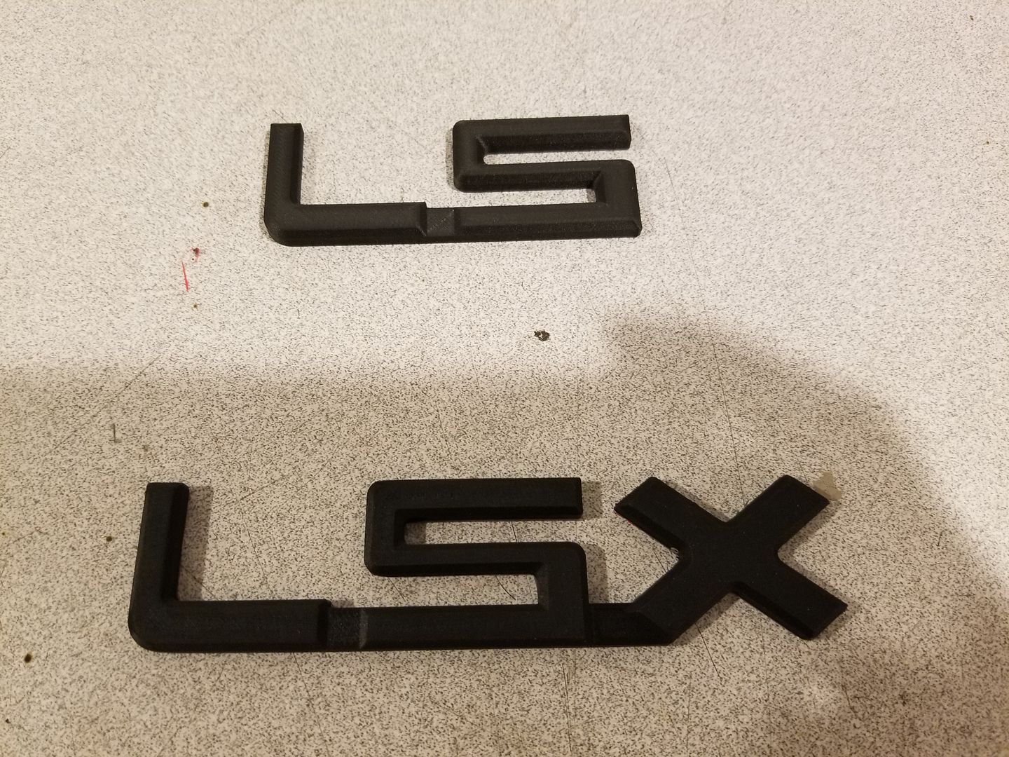

Pulled all the logos off.
http://i1133.photobucket.com/albums/...pspnml1n2s.jpg
It was time for this to happen.....passenger side is unpulled/ unrolled.
http://i1133.photobucket.com/albums/...pszgyntszj.jpg
Drivers side, is rolled, pulled and probably cussed at more than a few times. Front fenders are ****ty repaints so I have not been worried at all about keeping the paint perfect.
Great coverage on a 10" wheel and a 275 clearing the strut with about 1 degree of - camber, should be no problems up front.
http://i1133.photobucket.com/albums/...pscbdpppe4.jpg
Got to work with a little color sanding and lots of polishing. Turd is looking how it should in my head. Shiny but not nice.
http://i1133.photobucket.com/albums/...pso3na9v6e.jpg
http://i1133.photobucket.com/albums/...psosr4gwjf.jpg
This fender is the worst, color doesnt match, paint is all chipped and cracked but its whats on there and it got color sanded and buffed all in the same.
http://i1133.photobucket.com/albums/...pskkhya63i.jpg
Took Sunday off from all car stuff and played in the snow with the new daily.

Scott at STS got a new bad ass 3d printer and whipped these up for me to test it out the new machine, turned out killer.
Not sure which one is going to go on but its a super subtle look.

Got the intercooler setup all filled up with water wetter, antifreeze and distilled water and got it all bled. Got the cooling system all filled up by pulling the upper radiator hose and the steam line, filled the engine and the radiator, ran the engine till operating temps and bled the air out and git it back in one piece. Then I pulled it out of the shop for the first time on its own fully functioning.
<iframe width="560" height="315" src="https://www.youtube.com/embed/pERt9uM4hyg" frameborder="0" allow="accelerometer; autoplay; encrypted-media; gyroscope; picture-in-picture" allowfullscreen></iframe>
http://i1133.photobucket.com/albums/...psrm96cz92.jpg
Interior looks pretty killer out in the daylight.

Nice little touch on the brake booster vacuum line. That really cleans up and gives a professional look to the engine bay.

Thank you and yeah I am shooting for the clean yet serviceable engine bay. I am sure it would be easier if I had a camaro or a mustang......:poke:

Thanks man,
So here is the deal with the badges on the rear of the car. The paint got damaged under the factory badges, it looks like the paint got eaten from the chemicals in the tape I hit it with a tiny bit of 1500 and buffed it and you can clearly see the DL coming through.
I would much rather have it just clean and no badges. There is some cool that I can deal with like the FORD on the tailgate of the old truck just looked cool, this just looks kind of ****ty without an emblem back there.
The badges are in the exact font , size and profile of the stock DL Badge.

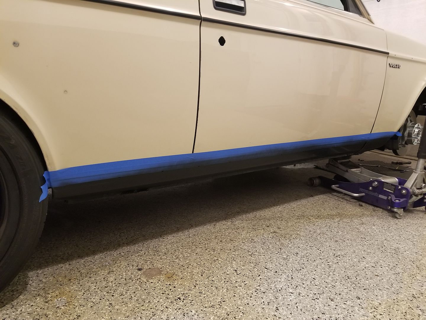

Took a couple of days off last week for the first time since October of last year. Got a much needed deep clean done in the shop and got rid of lots of stuff. Felt great.
Built a bunch of new storage stuff to hang on the walls a bunch of tig welded ****. Getting a little better on the TIG but still have a tough time feeding the filler and getting consistent results. I can fuse **** together and get halfway good results.
I have to give a shoutout to the twins, they have provided me with a ton of good parts for this old **** box.
Picked up a single round grille and headlight setup from them last week and went to town getting everything cleaned up, prepped and painted.
I would like to get the spring buckets zinc plated but my rebuilders cast is going to have to work for the time being.

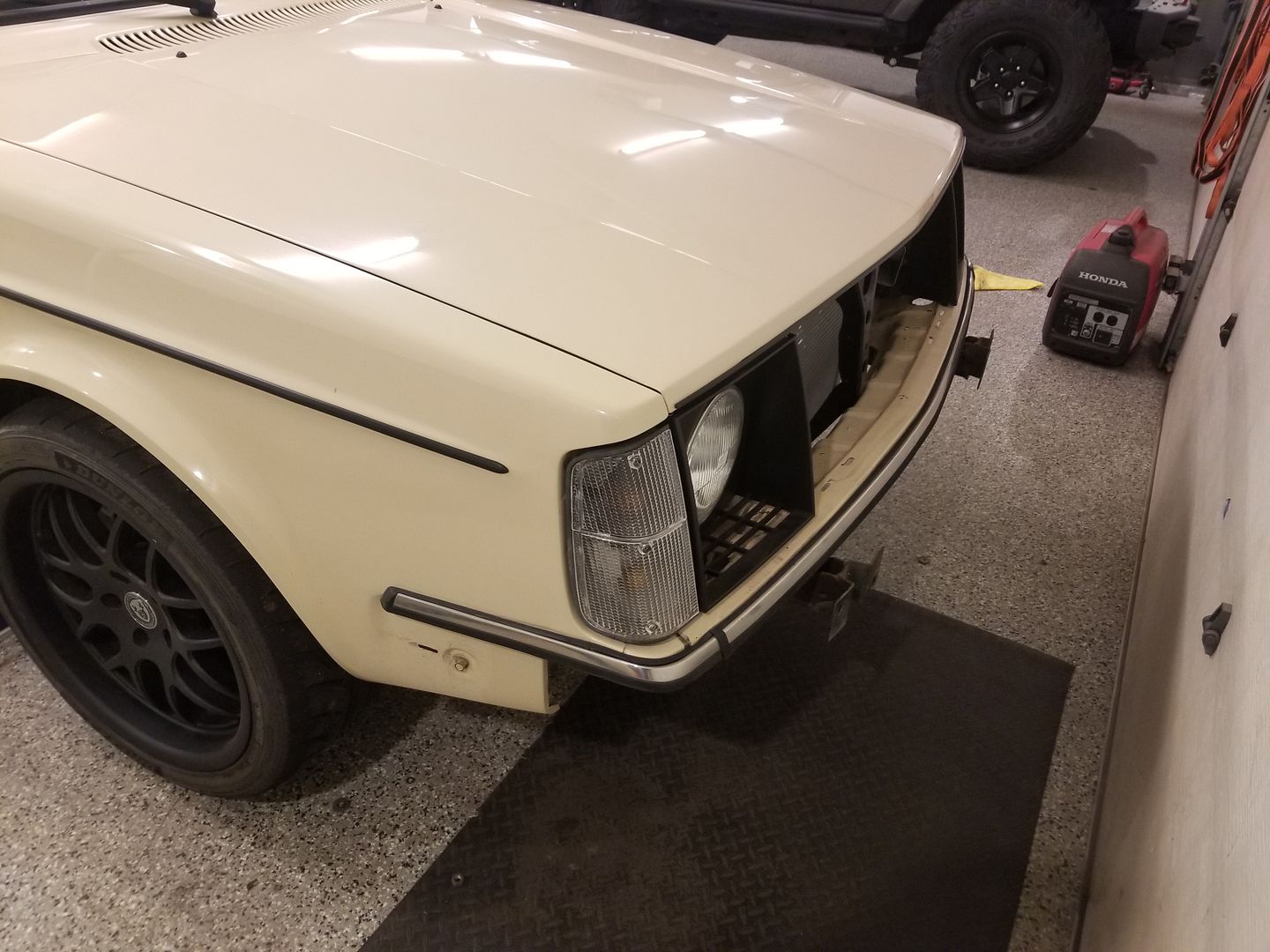

The front of the car had received a crappy repaint at some point in the past. Scott shot me an add for a beige car out in the gorge and I met up with the guy last week to snag some parts off of it. Driver side is perfect, its a dead on match for the car paint and finish. So I got to work swapping my better old ****ty fenders onto the car once the hood was done.
Seems as though I like going backwards eh?
http://i1133.photobucket.com/albums/...pswicjxtdl.jpg
http://i1133.photobucket.com/albums/...pstbos4j71.jpg
I am glad I did this though as I discovered my tire was actually going to hit the firewall pinch weld at full lock so it got some massaging while I was in there.
New Fenders going on. They are so much better than the ones that were on the car.
http://i1133.photobucket.com/albums/...pstzwp8cma.jpg
http://i1133.photobucket.com/albums/...psckjj6fuk.jpg
First time seeing it all bolted together. Hoods far from perfect but fits with the car. Was a bitch getting it aligned and the drivers rear is still a little bit high.
http://i1133.photobucket.com/albums/...ps7dry2drh.jpg
http://i1133.photobucket.com/albums/...psn0sr2ysc.jpg
Had to modify the fender roller to work with the lower ride height...
http://i1133.photobucket.com/albums/...ps4pm5cpfj.jpg
Rolling the new fender, still have the passenger side to do but should be able to get that all buttoned up tonight.
Non rolled and pulled...
http://i1133.photobucket.com/albums/...pswphpmxpn.jpg
Rolled and pulled. I measured the non rolled and pulled on the floor next to the rolled and pulled one and I have gained about 1.5" of total tire clearance, only downside is the gap at the bottom of the door to fender doesnt line up as the metal gets pulled in a little bit.
http://i1133.photobucket.com/albums/...ps8lsl2ean.jpg

Been waiting for these puppies to show up from Sweden for a while now. Who thought that getting tail lights would be a) so expensive and b) so exciting to get!!
http://i1133.photobucket.com/albums/...psreyzcetz.jpg
http://i1133.photobucket.com/albums/...psmxtnevxh.jpg
http://i1133.photobucket.com/albums/...psxfxe088z.jpg
I got them on the car last night, they look killer, fit like OEM and are great quality!!

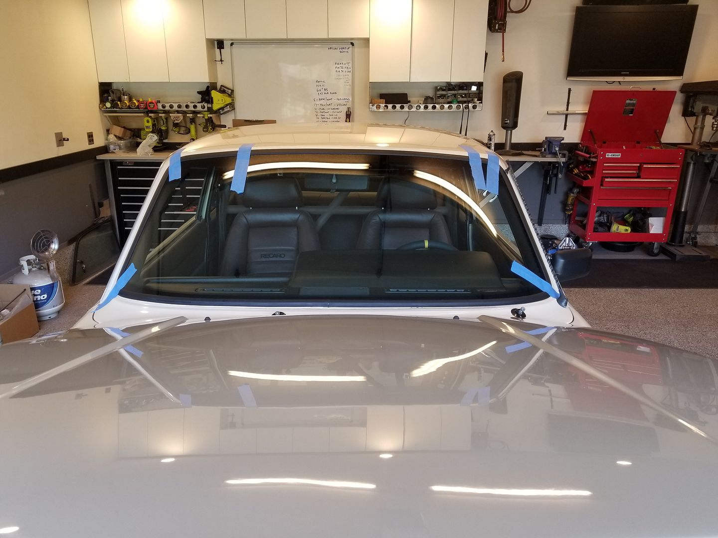

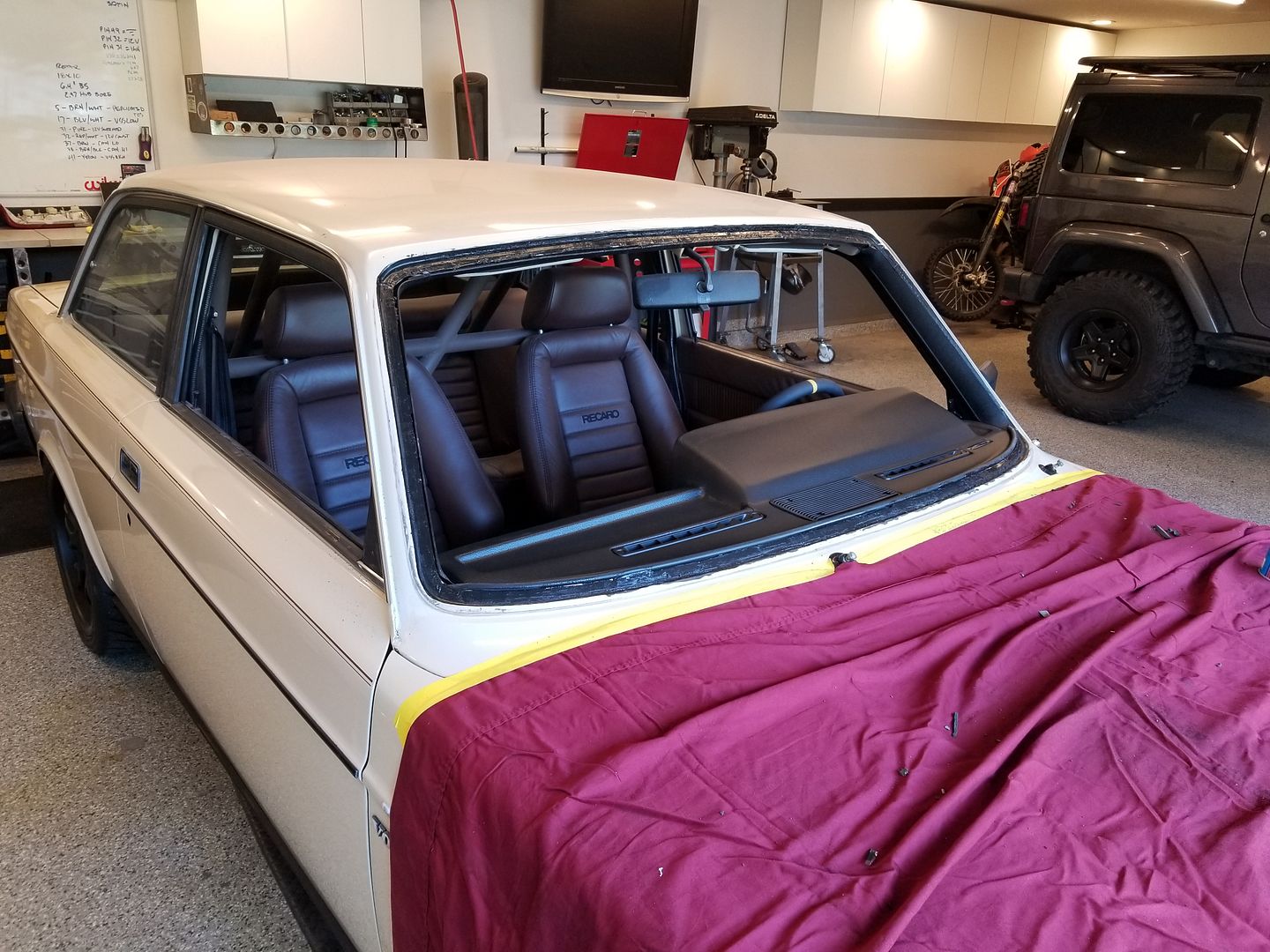

Had a day in the garage yesterday as the glass guys were coming!!!
They were withing their window, attentive and did a great job.
http://i1133.photobucket.com/albums/...pstfvuyg3e.jpg
http://i1133.photobucket.com/albums/...pstinhphip.jpg
http://i1133.photobucket.com/albums/...psxgo2iqus.jpg
http://i1133.photobucket.com/albums/...pstuh6pzd7.jpg
He even gave me time to clean up all the old **** around the windshield before he set the new one in. Good peeps. Apple Auto Glass in Portland.

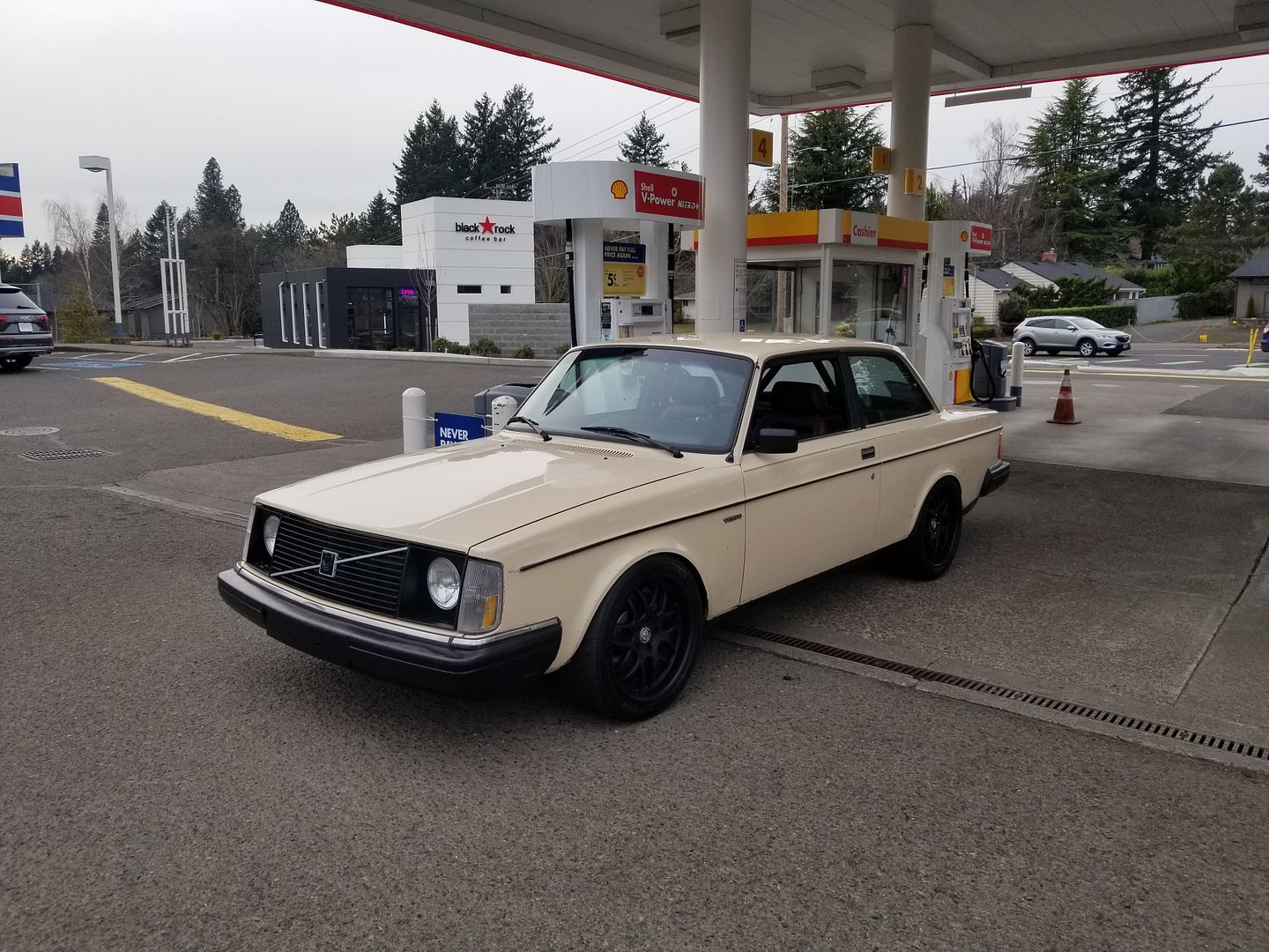

Got the wideband wired in to the serial port for Data Logging wideband.
Worked with a tuner from Detroit all evening on the tune since my buddy Ron has some family issues he is dealing with.
We got it running and he wanted a log so for the first time ever we went around the block.

Got the old front bumper trim cleaned and presentable, pulled the bumper again, installed old trim, rehung bumper and got it aligned. Pulled passenger door panel and installed lock cylinder, freed up all lock cylinders and got the door locks working. Installed the drivers rear window finally.

First fuel stop

LSX badge installed

For all the haters of the carpet color, I have to say that spending some time in this space has been nice, the interior came together pretty damn well.
http://i1133.photobucket.com/albums/...psmotdycac.jpg
