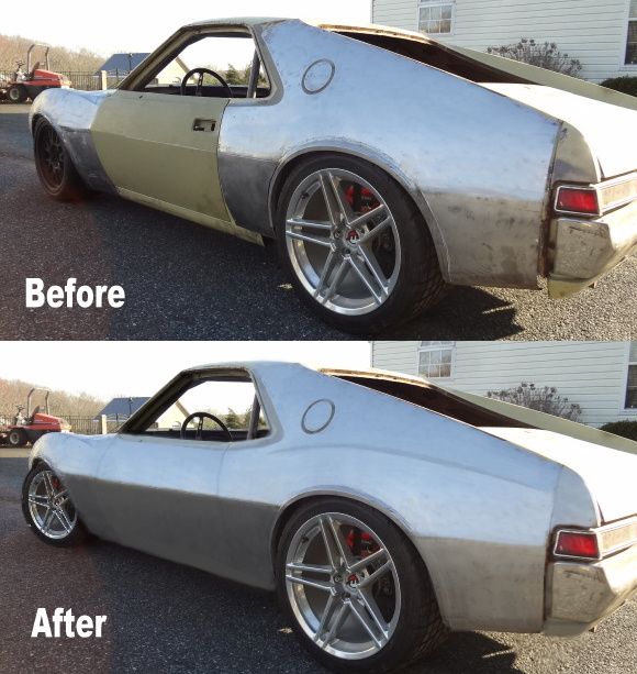

Torquedork, and I have been collaborating on what to do with my quarter panels, this what we have come up with. Reshape the rear window opening a bit, and install an eyebrow over the wheel opening. Love the way he was able to C14 wheels in gold on the thing, the dude is a real artist with a computer. What do you think?

WSSix 04-27-2014 05:57 AM
I think it looks good, Ron!

Here's basically where I started showing "Before" and "After" adding the hump accent to the 1/4 panel and raising the bottom of the 1/4 window to make it all blend. Helps to balance the look front to back.
