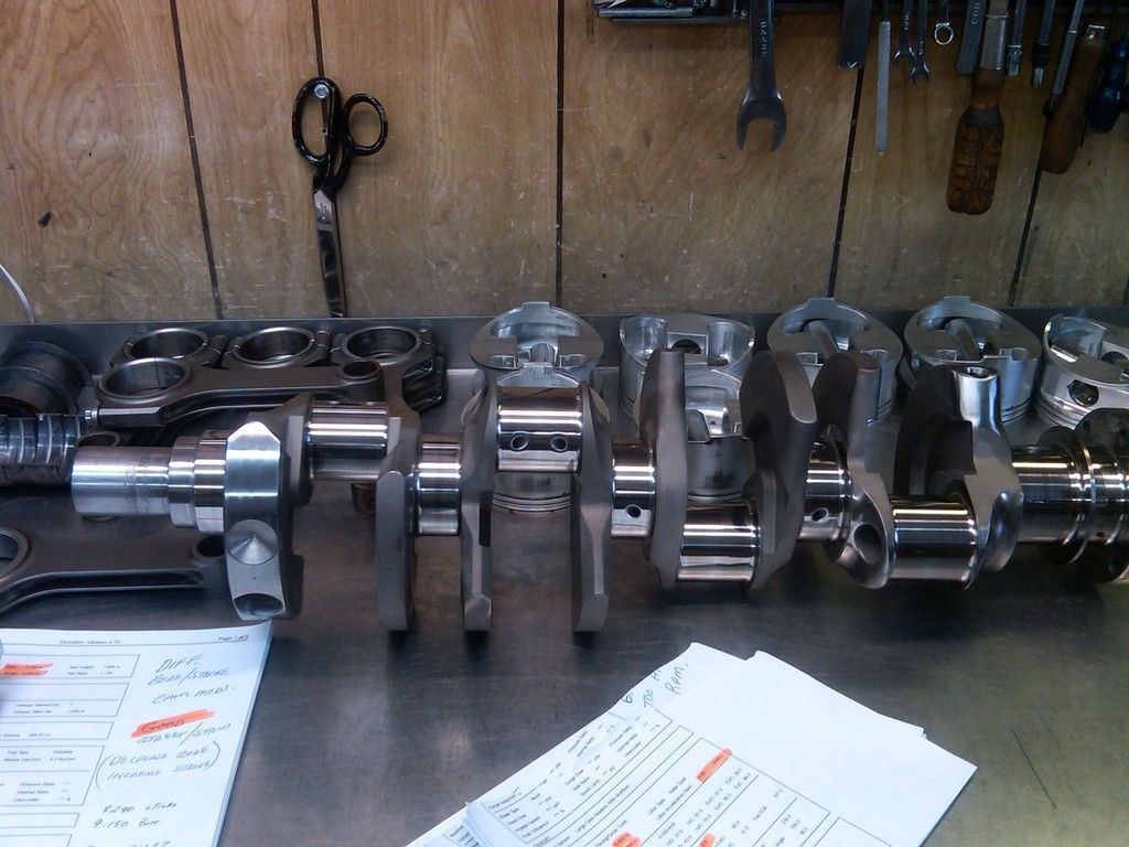

Okay I had a similar Matt Alcala situation the other day at Watson going over the motor teardown and inspection of my SB2.
Nothing is good and everything needs something.. of course. :rolleyes:
#4 cylinder has a pretty deep score.
Bad main cap walk.
Crank thrust no good.
Wrong bearings.
Wrong piston ring package (napier).
Steel lifter sleeve (wish it wad bronze bushed).
Standard SBC cam core (may go to 50mm BBC size if there is room).
And then there was..... ok at this point I just pulled a Weld and said "just fix it."
There was some good news. They loved the dry sump stuff I brought over and it was the first time Mike didn't tell me the stuff I brought to him was crap or inferior. :lol: He even brought Ben (Watson) who does all their billet and sheetmetal manifolds over and showed him the Hendricks pan. They loved it. :woot:
He's gonna send the crank out, do calcs on everything and then we'll decide where we go.
Oh, and he said the head gasket on this motor was the largest he'd EVER seen......
.120. :eek:

He's gonna send the crank out... said the thrust bearing was toast... like Rob said everything should be usable... it's just a matter of more time and more money. :rolleyes:
Block is Dart Little M. Mike will do a soft hone on it he said and redo the mains and it should be good.
He did like the crank overall though. Need to weigh it but it is pretty damn lighweight.

I've never seen a main cap walk issue. Did Watson show you the issue or do you have any pics of it? I'm interested to see what it looks like.
You also mention the wrong rings and bearings. I assume they where sized correctly, what did he say saw wrong with them? Since I'm building up my engine I'm interested to know more.
Flash68 10-29-2012 03:34 PM
Originally Posted by sik68 (Post 443648)
Aww man sorry Dave. At least you know Watson is checking EVERYTHING and you will eventually get a motor that will last.
:thumbsup:
Originally Posted by gerno (Post 443655)
That sucks about the engine but at least you know you'll be able to beat on is good once you get it back.
Yep. He showed me some of the issues while we talked. No pics tho.
Rings were not necessarily wrong per se... just not good for my application per Watson. They were napier 2nd rings. They want to switch those out.
Bearings he said were mismatched. They were a mixture of hard and soft. A throw together job it appears.
