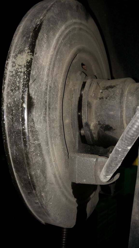

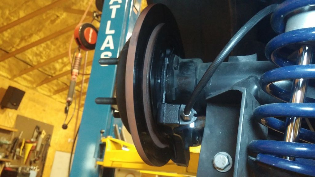

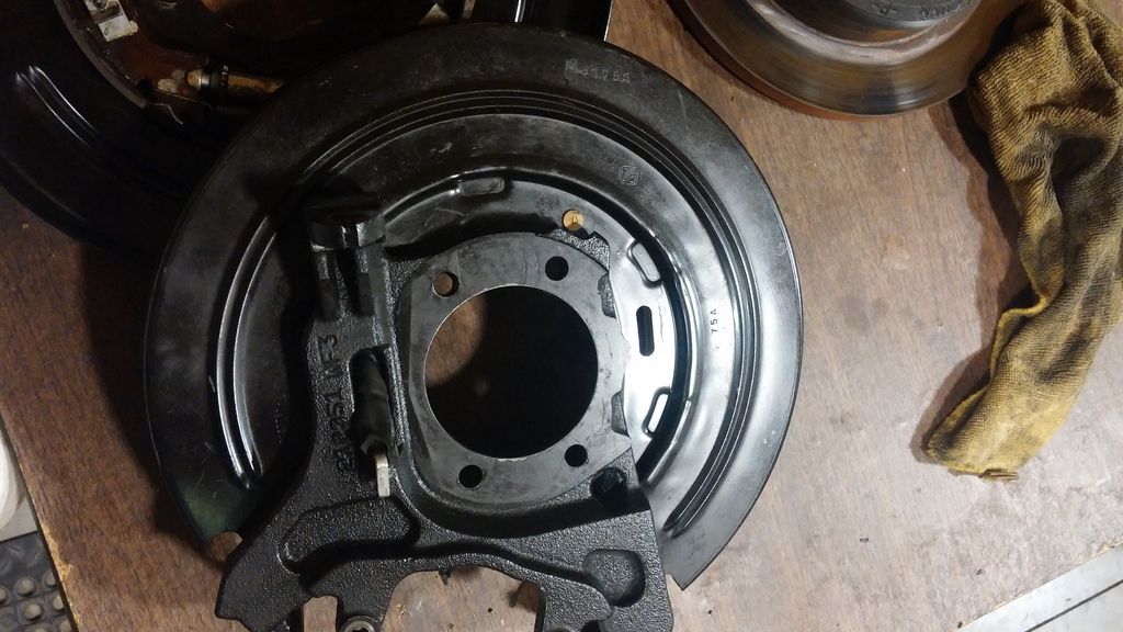

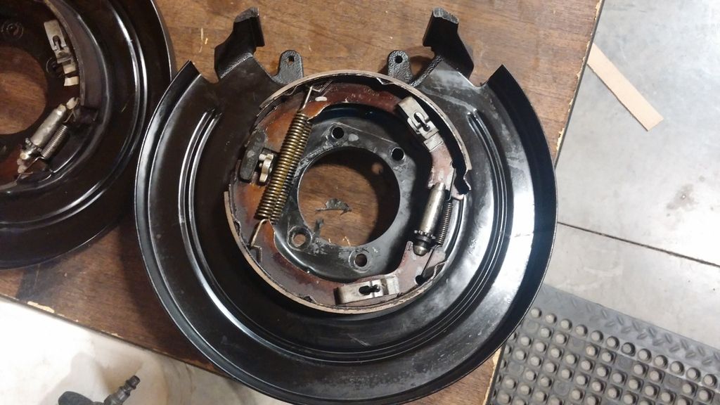

It has been a while since the last update so here is a little that I have been working on.
For a while now I have been fighting excessive rear brake rotor heat during and after a track session. After some careful diagnosis and help from a few friends, hopefully this will be a big help.
I run the Ford Racing Explorer rear disc brake kit which includes a cast caliper bracket attached to a sheet metal rotor shield that also holds the e-brake internals in place. This shield completely covered the inside face and outer edge of the solid (non-vented) rotor.
http://img.photobucket.com/albums/v3...712161719b.jpg
http://img.photobucket.com/albums/v3...0712161939.jpg
http://img.photobucket.com/albums/v3...712161939a.jpg
A little work with a bandsaw should let some heat escape and some cool air get to the rotors now...

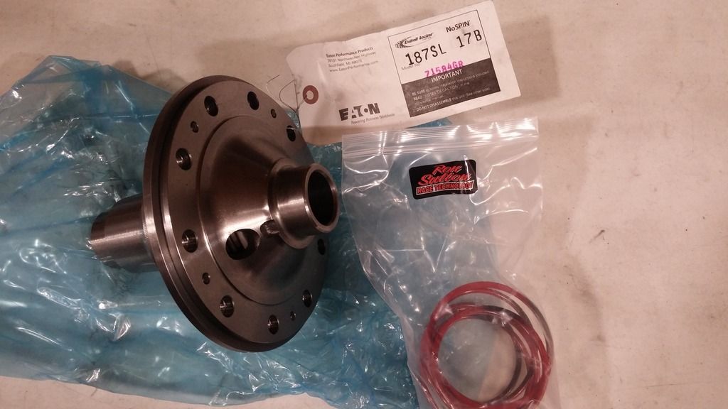

I had the axles out because I was repairing yet the 3rd or 4th burnt out clutch posi in the car. Actually...I was replacing it with this.
http://img.photobucket.com/albums/v3...0709161432.jpg
Barney now transfers it's power to the rear tires through an Eaton Detroit Locker with some of Ron Sutton's 40# internal springs. I've only driven it a few times since and on very crappy stock size tires...but I can tell already that I am going to like my corner off traction, especially on right hand turns...a TON better.

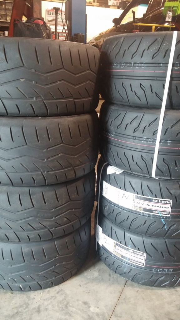

Speaking of tires...this also has happened...
http://img.photobucket.com/albums/v3...0714160813.jpg
The stack on the left are an old set of 275 Falkens that I've been running the past few years...the stack on the right is my new set of 275 RE71s. I can't wait to officially join the sticky tire club!!! Hopefully this next week I'll have something to mount those tires on.

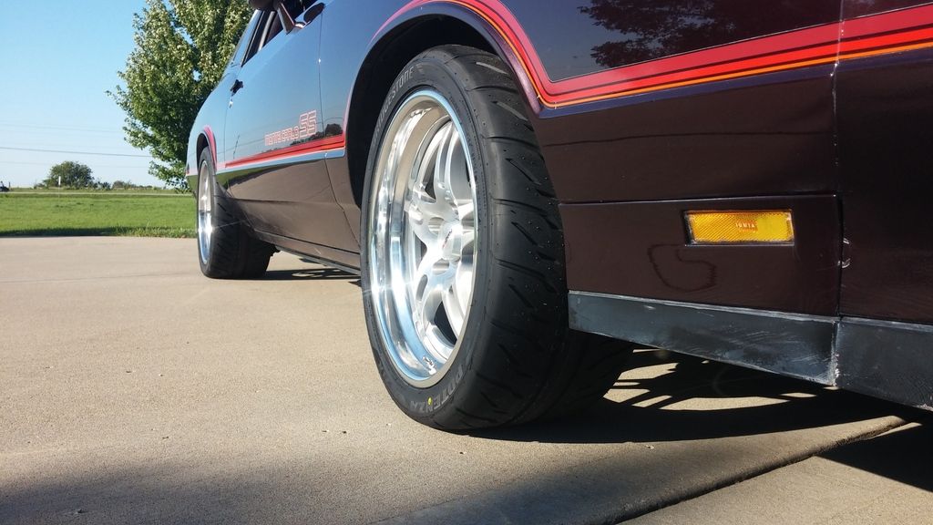

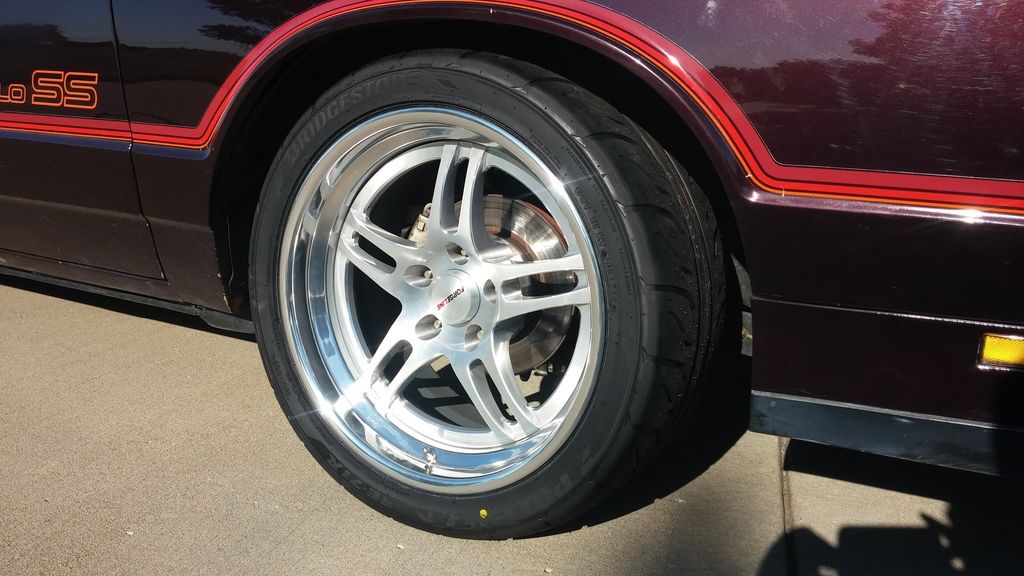

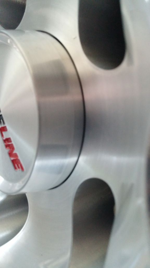

Here are the new wheels installed with new RE71 rubber around them.
http://img.photobucket.com/albums/v3...0721161817.jpg
http://img.photobucket.com/albums/v3...721161817a.jpg
http://img.photobucket.com/albums/v3...721161817b.jpg
They are like works of art... They've been on the car since Thursday and I still stop to look at them everytime I walk by the car in the garage. Haven't driven on them much but the grip from the Bridgestones is amazing! Can't wait to race on them. #Stickytireclub #Finally
