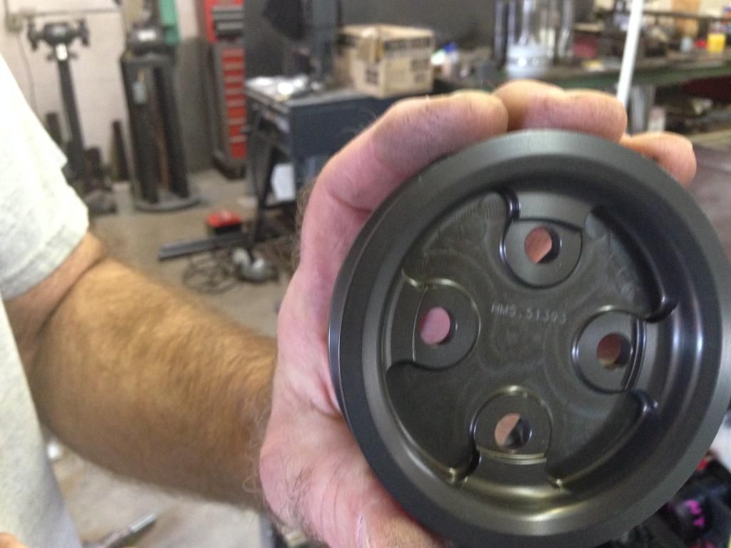

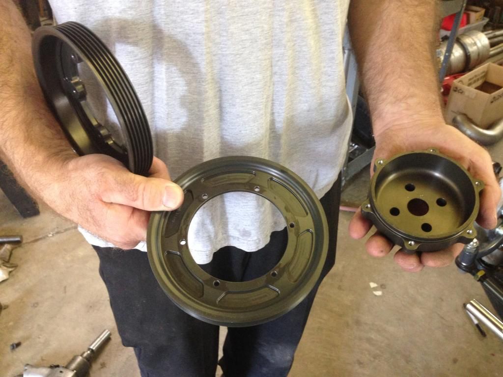

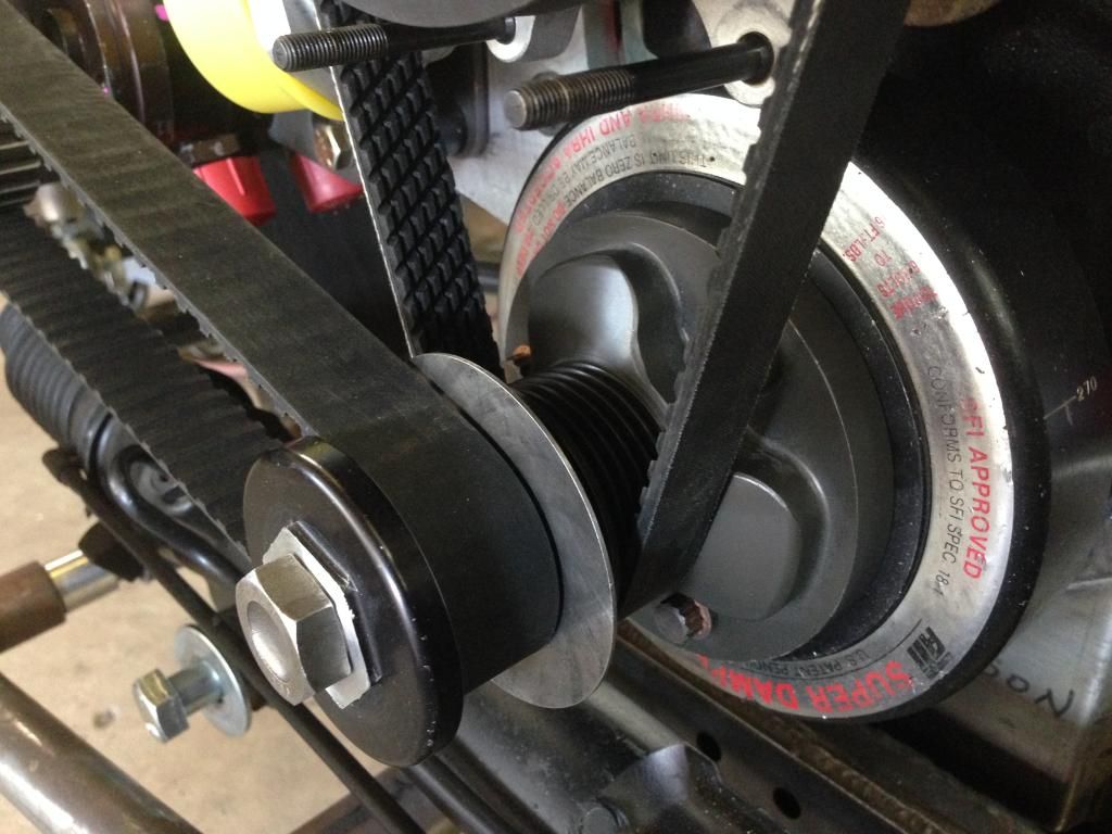

Payton King 12-02-2014 12:09 PM

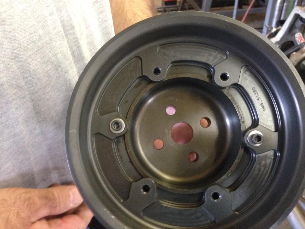

Here is something you do not see everyday. These are pulleys that Hendrick machines up for their motors. They are modular and they make them in different diameters to change the pulley ratios for different tracks and RPM ranges.
http://i1138.photobucket.com/albums/...psh30hwxrm.jpg
http://i1138.photobucket.com/albums/...pswipptz9a.jpg
http://i1138.photobucket.com/albums/...psffoulfvf.jpg
http://i1138.photobucket.com/albums/...psnunqqpqz.jpg

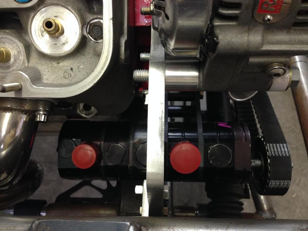

Payton King 12-02-2014 12:15 PM

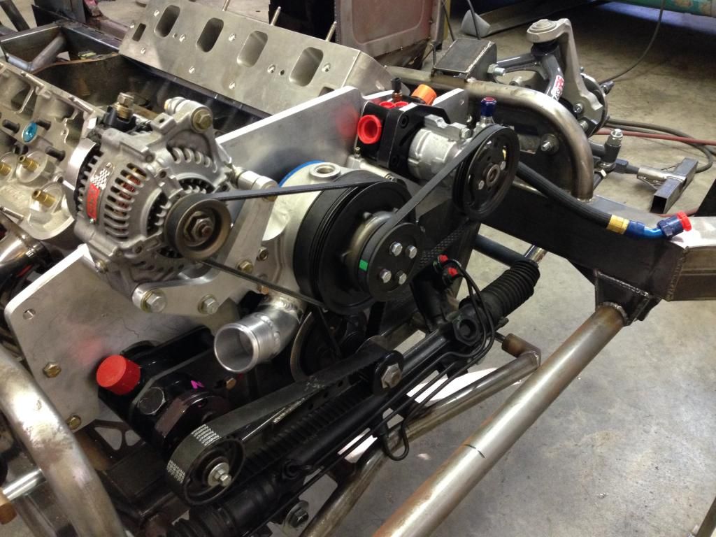

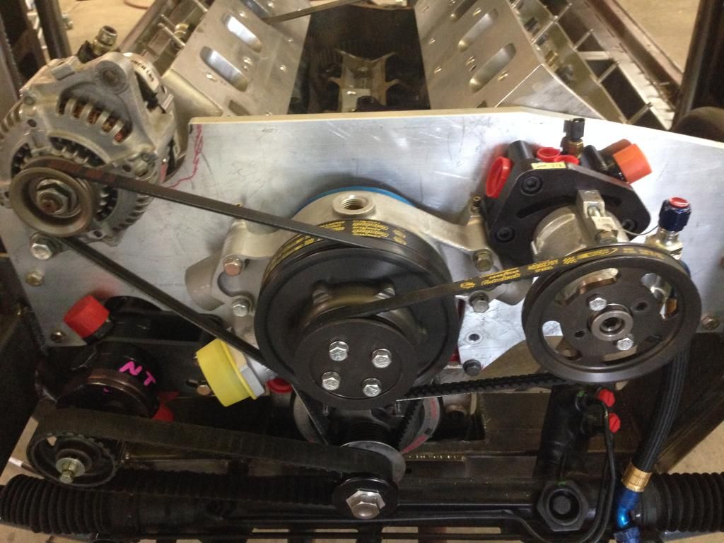

New oil pump location
http://i1138.photobucket.com/albums/...psqr4fbvlj.jpg

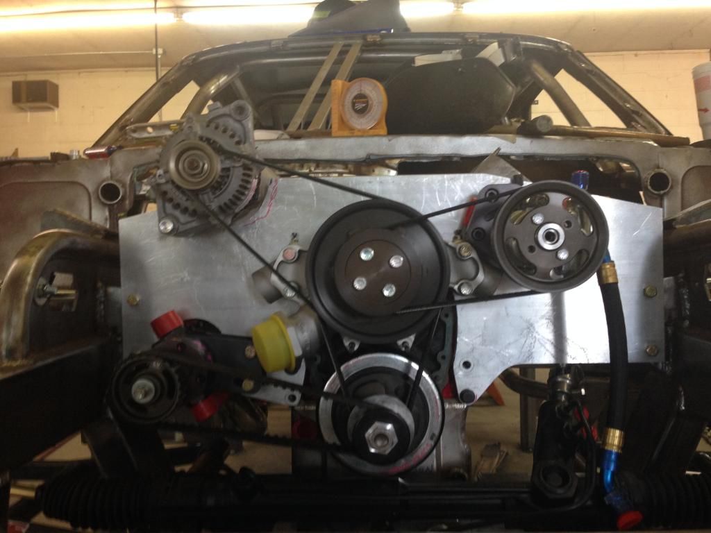

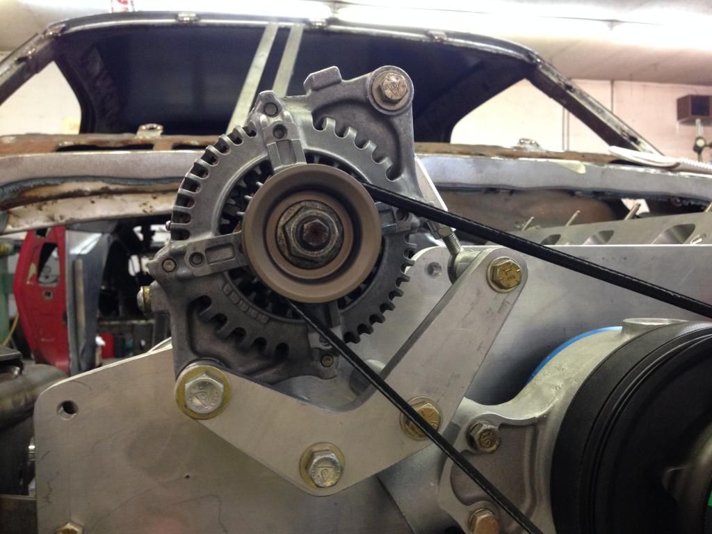

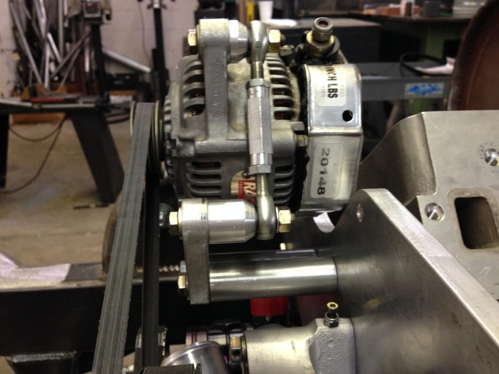

Alternator bracket
http://i1138.photobucket.com/albums/...ps297rxbwj.jpg
http://i1138.photobucket.com/albums/...pskiukjk0w.jpg

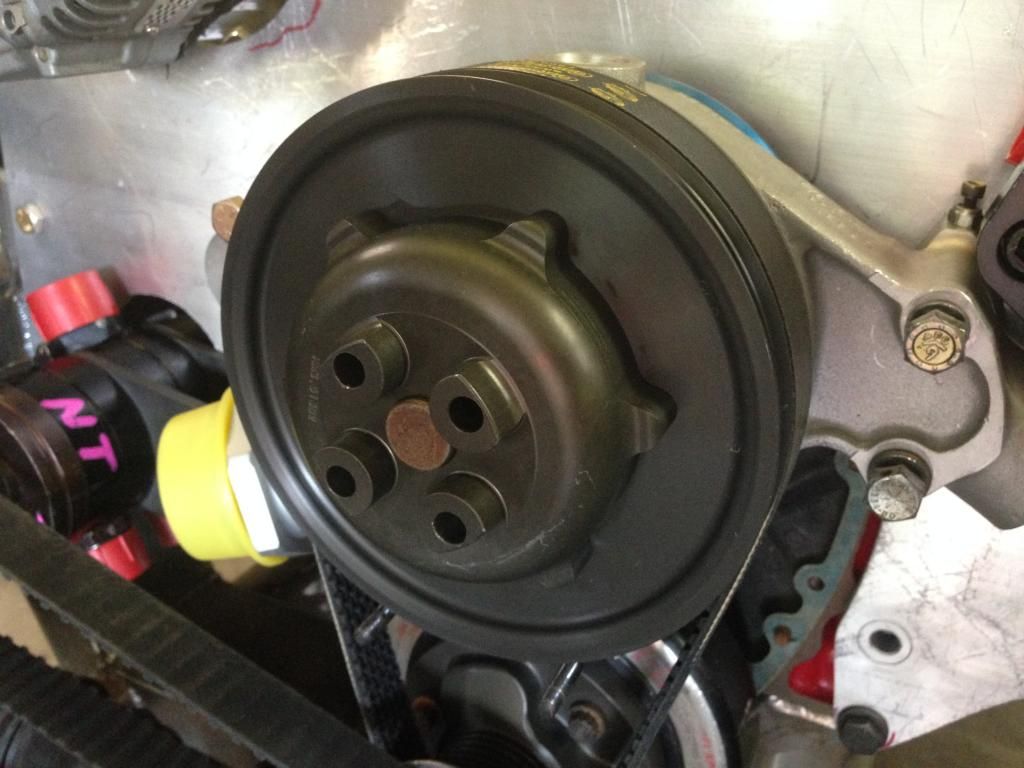

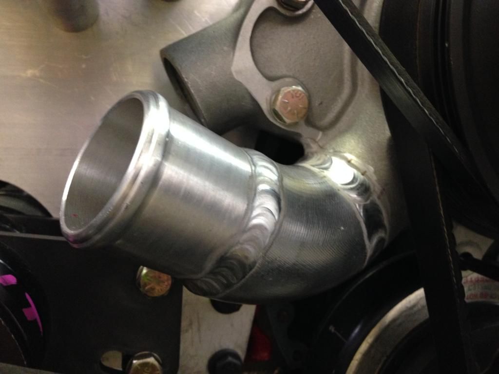

We had to alter the water pump inlet to clear the right side oil pump and belt
http://i1138.photobucket.com/albums/...pscodotsut.jpg

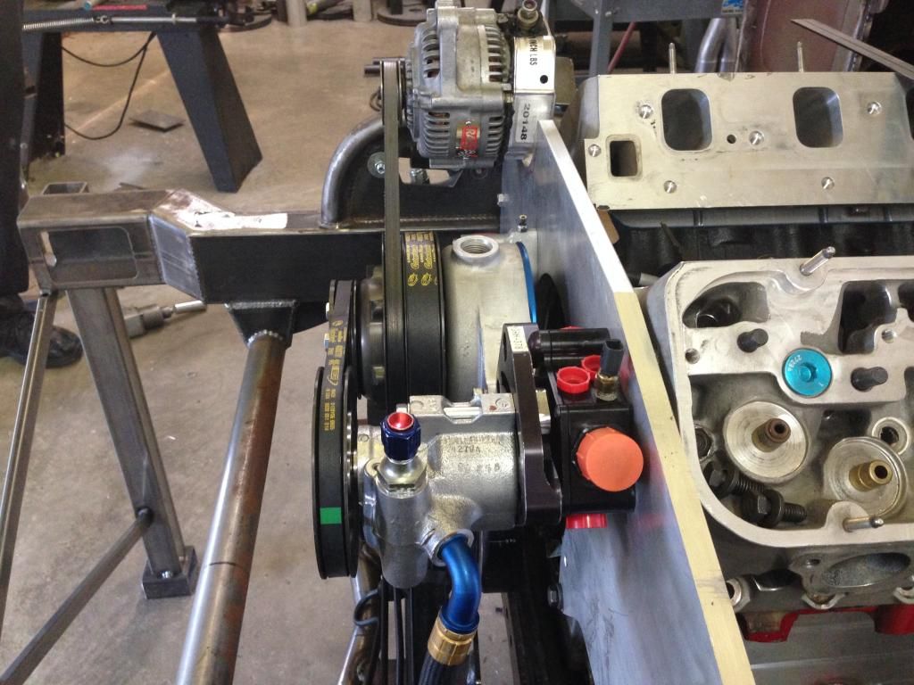

Payton King 12-02-2014 12:19 PM
You can see in this picture the clearence we gained with the water pump inlet
http://i1138.photobucket.com/albums/...ps0leavqo5.jpg

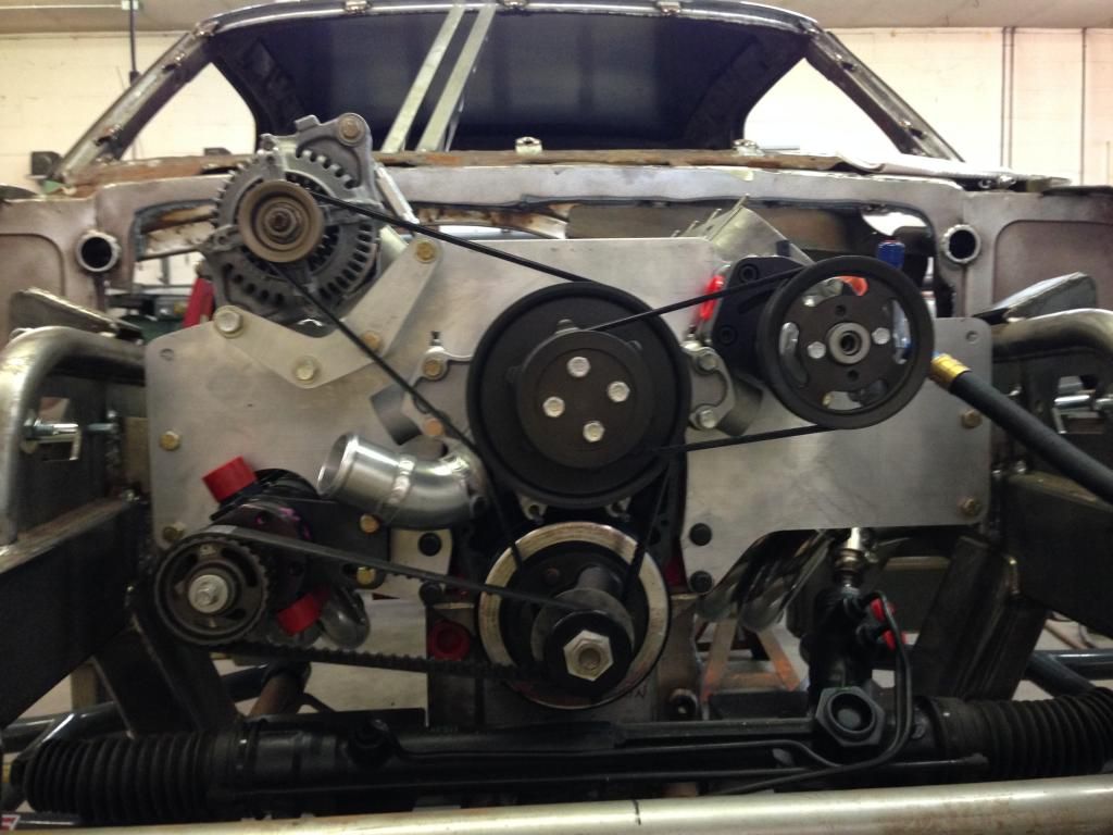

Ron in SoCal 12-02-2014 02:58 PM
It really bothers me that your motor sits behind your rack centerline ... :trophy-1302:
Rick D 12-02-2014 03:01 PM
You could always move yours :poke: just sayin :D

65_LS1_T56 12-02-2014 05:52 PM
And they have lightening pockets! Those are cool :thumbsup:
