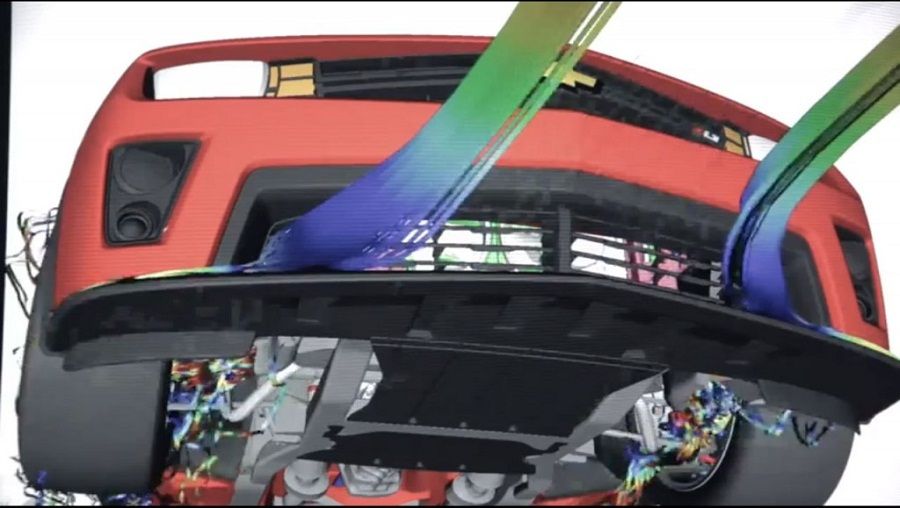

Originally Posted by Stielow (Post 537697)
This is the general idea.
The lower valance is open and the outer courners are brake cooling ducts and the center is for the heat exchangers.
Hi Mark,
I don't know for sure what is going on in the picture... but I'm assuming the changes in color represent changes in air speed. It looks like the air is flowing through the valance, around the rotors, and out through the wheels. What a great tool for designing the valance and ducting for cooling the brakes. No guess work here.
I would be interested if you had any more details about this picture... cool stuff.

Originally Posted by Stielow (Post 537676)
Oh yes we are using the DSE Hydraformed rails for brake cooling ducts. I need to be more careful on the pictures I post....
Matt opened up the rail and capped off internally and added a curved piece to turn the air. 18 X 11 wheel no problems lock to lock. :idea:
With the Anvil lower front valance it is wide open for brake ducts. We squared off the end of the frame rail and removed all the bumper bracket holes. Then added front duct that pull of the opening in the lower valance.
Now that you guys figured that I can post the rest of the pictures when I find them.
With Carbon Ceramic Brakes you need a lot of air flow to cool the brakes. Especially when you are making 875 HP. They don't have much thermal mass so much the cooling needs to be by air flow.
Mark
