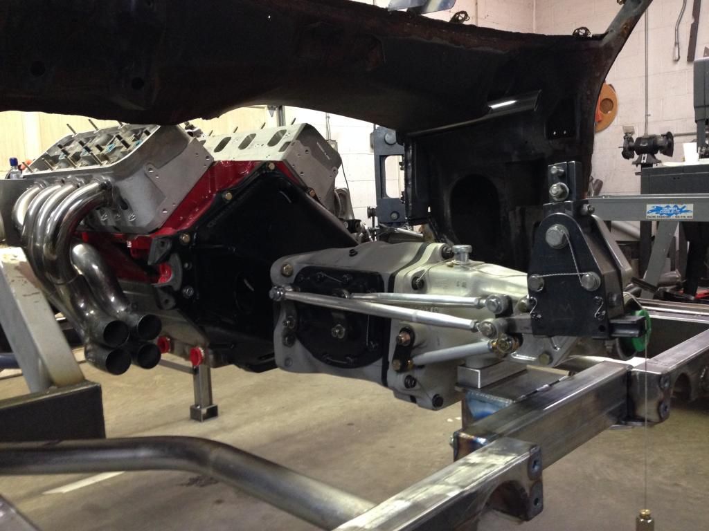

Ron, with the motor moved back as you noted, needed a remake of the fire wall which makes a great transition to my next set of pictures. That was almost like it was on cue.
Before we get to the firewall, we needed to do a little header fitment to make sure we were going to have room. These headers are from Jimmie Johnson's 48 car. They are made by Profab.
http://i1138.photobucket.com/albums/...psadjr9m4y.jpg
http://i1138.photobucket.com/albums/...psjqowmbyn.jpg

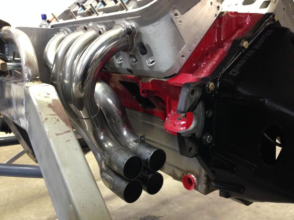

Since we moved the motor over about 1/2 inch and how wide these headers...a little frame notching was in order on the passenger side.
http://i1138.photobucket.com/albums/...psjweyv2sv.jpg
This is the driver's side. Needed the room for the steering shaft. May still need to alter a tube but it is looking good.
http://i1138.photobucket.com/albums/...pstkrmu4vw.jpg

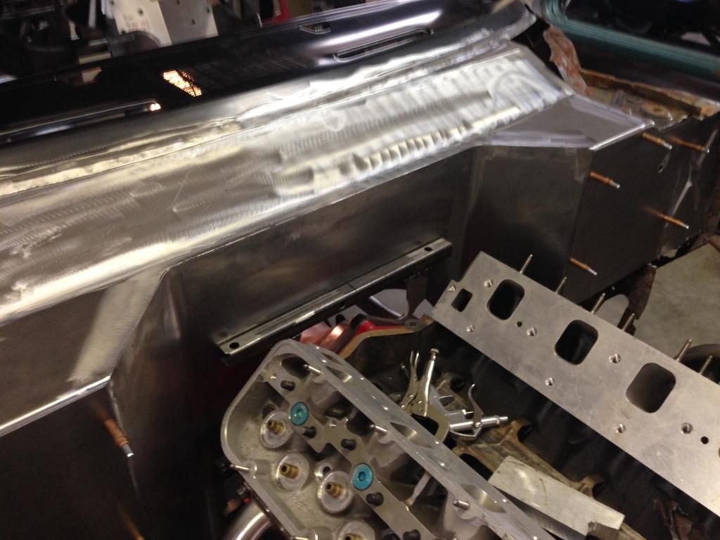

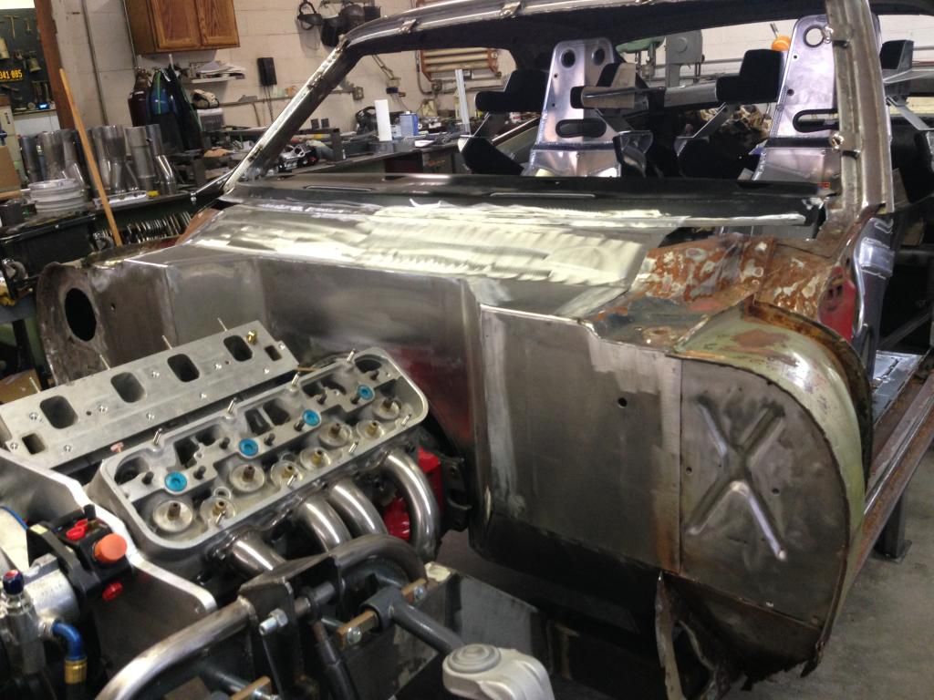

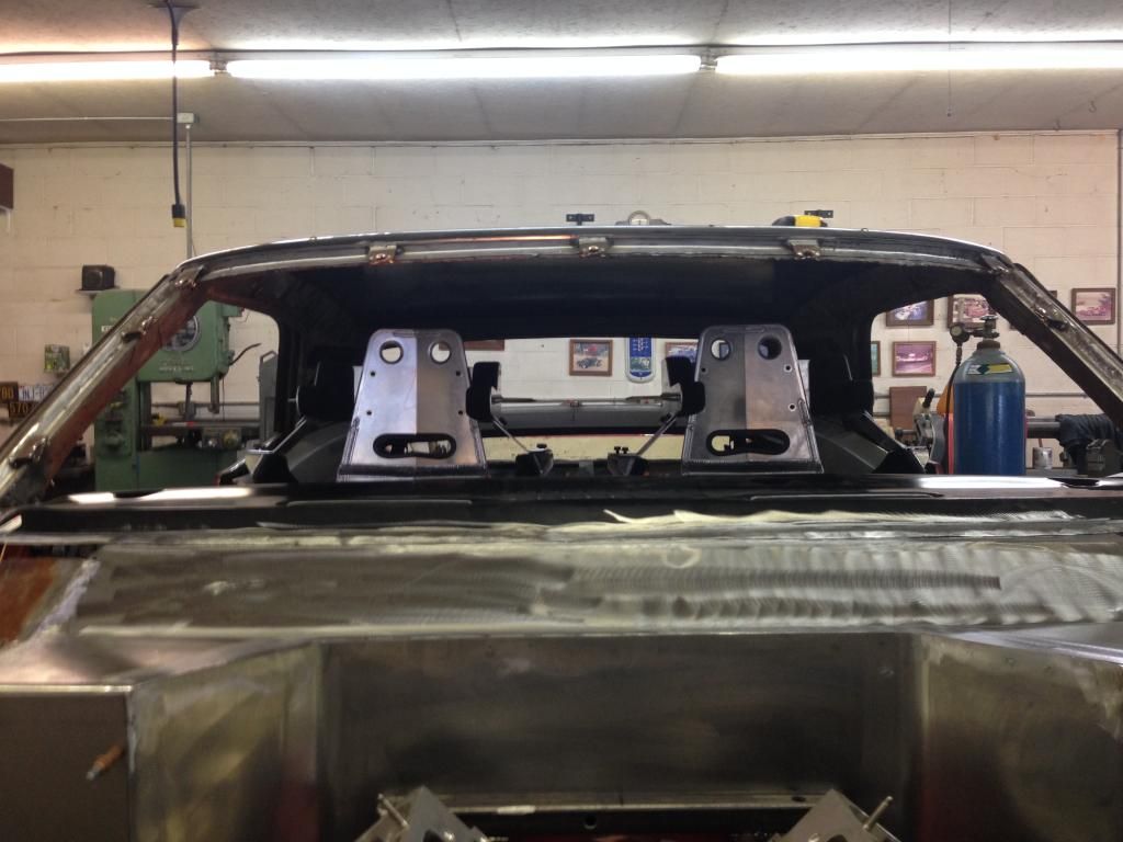

Finally on to the firewall
http://i1138.photobucket.com/albums/...psfj1a5shd.jpg
http://i1138.photobucket.com/albums/...psw8vmthva.jpg
http://i1138.photobucket.com/albums/...psdgyafzgp.jpg
Payton King 12-03-2014 07:29 AM
http://i1138.photobucket.com/albums/...ps01qtclyk.jpg
http://i1138.photobucket.com/albums/...psug3d5t0s.jpg
