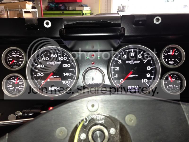

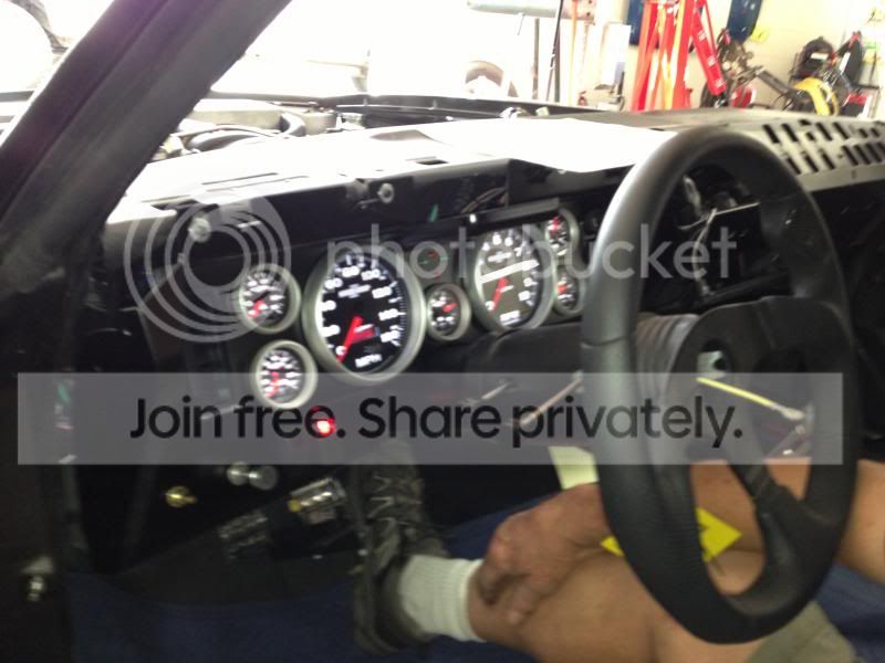

So I do have an update. Last few weeks have been absolutely swamped. Tonight was the first dinner at home in two weeks. Next week is no better, but I did take the opportunity to run down to BoS this afternoon and drop off some stuff. Friday afternoon shop BBQ, just what I needed :thumbsup:
Also Matt was out testing today at BW. I'll let him tell you all about it, but what little I heard he's getting closer to being dialed in for Optima. Loved that text!
I was happy to see the dash painted and wired. Looks like guage placement will clear the steering wheel.
http://i885.photobucket.com/albums/a...psb10910cc.jpg
http://i885.photobucket.com/albums/a...ps0ff970f0.jpg

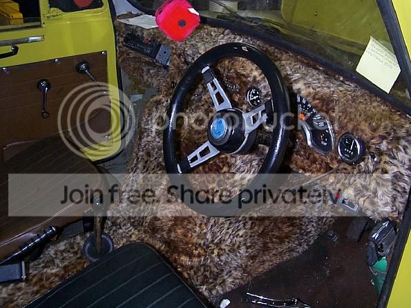

GW's solution looks great, if it's out of your budget I found a solution too........
http://farm6.staticflickr.com/5125/5...518ffdb7_z.jpg
You're welcome. :thumbsup:

Sweet. ;)
IIRC that's from the Grizzly Adams signature collection.

I was thinking more of a matching coat from the Sir Mix-a-lot Pimp Daddy collection? :lol: :sieg:

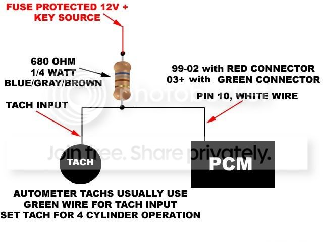

Hey Vince! So this may only be a PSI harness configuration and like I said, John is always there for support. My issues are switched fan runs on start up, OBDII is not able to be read w a code reader or HP Tuners, check engine light does not come on momentarily upon start up, and the Tach is not reading a signal from the computer.
Sounds like a system meltdown right?
It's a ground and a resister issue and that's about it.
The car electrical system is currently is ground to the frame and the motor. To test it we ran a ground from the E38 computer to the battery. Also checked the pin outs:
OBDII Port:
POSITION 4 TO GROUND
POSITION 5 TO GROUND
POSITION 6 TO BLACK ECM CONNECTOR POSITION 28
POSITION 14 TO BLACK ECM CONNECTOR POSITION 27
POSITION 16 IS SWITCHED 12-VOLTS
Here's the Autometer Tach/resistor issue.
http://i885.photobucket.com/albums/a...ps08723ced.jpg
