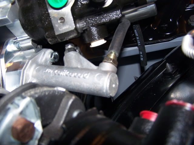

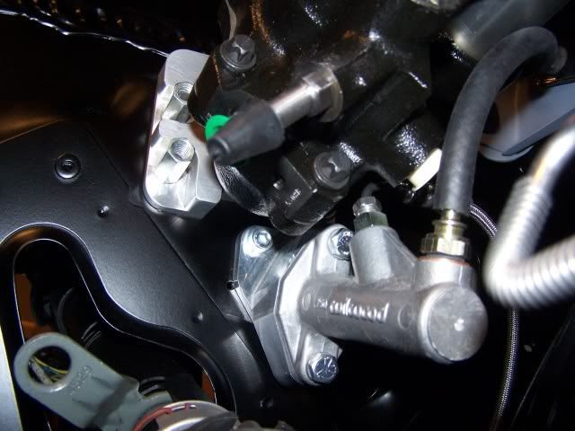

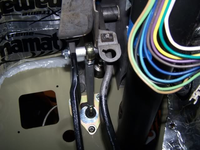

Well the master for the clutch was a tight fit. Tried mounting it in the spot Kiesler suggested but with my Hydro boost it would not fit. I had to move it to wards the drivers side a little and down a touch. Then I installed the line for the throw out bearing before I bolted it up. The rod to the clutch pedal was still in line with the master so it should be good.
Here are a few pictures
http://i172.photobucket.com/albums/w...l/000_1068.jpg
http://i172.photobucket.com/albums/w...l/000_1067.jpg
http://i172.photobucket.com/albums/w...l/000_1070.jpg

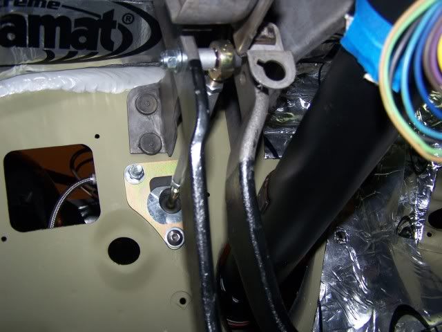

The cap screw is pretty close to the brake pedal but has enough room.
http://i172.photobucket.com/albums/w...l/000_1071.jpg
We also threw in the steering column temporarily.
