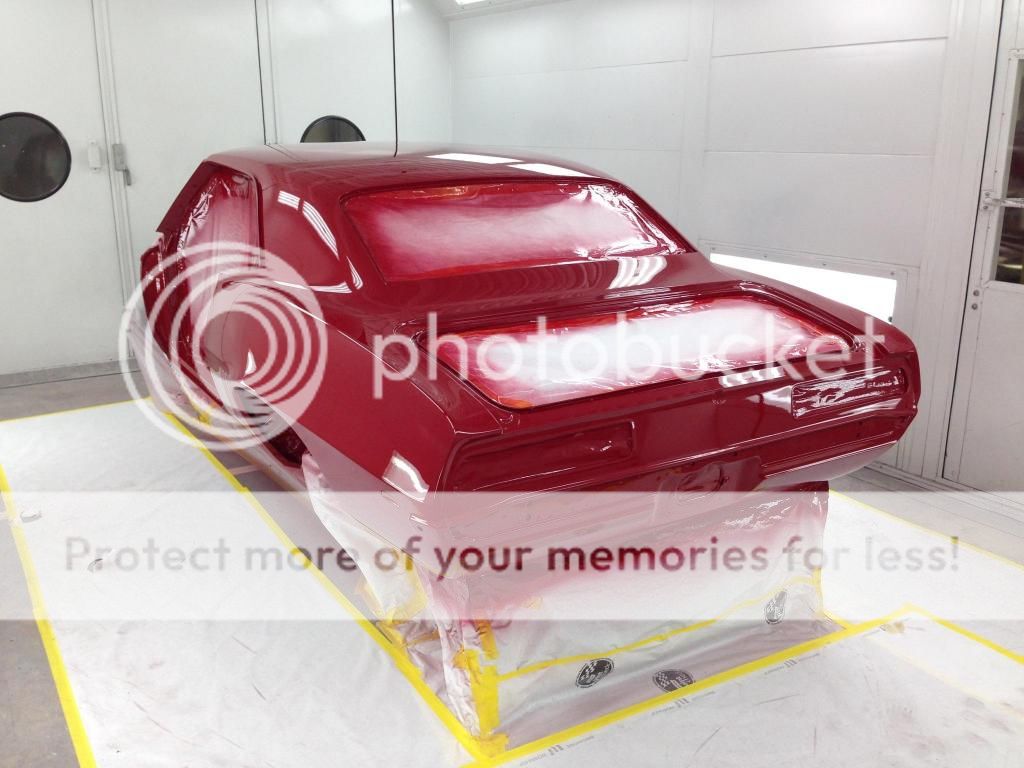

The Dutchboys have the main body, doors and decklid painted.
http://i439.photobucket.com/albums/q...ps21a529f4.jpg

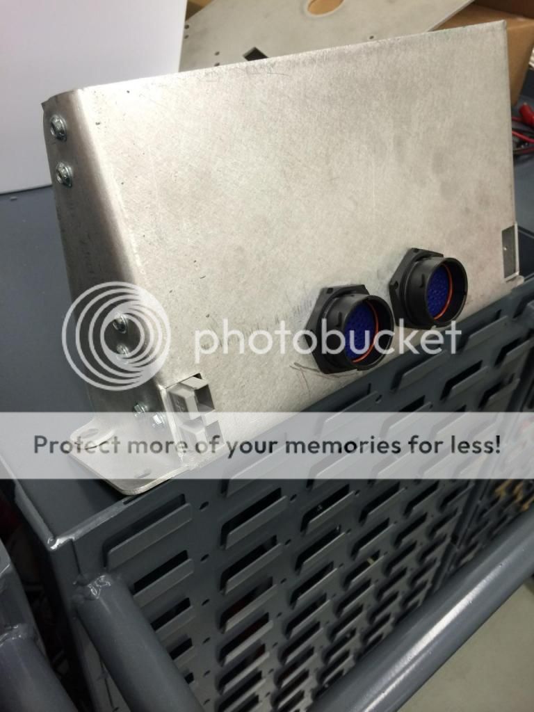

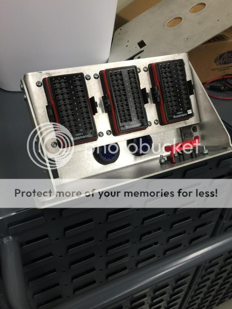

Wiring
Ryan Kuhlenbeck is helping me with wiring so we are doing the whole system from scratch. It gives us the flexibility to put things where and how we want them.
Attached is a photo of the fuse boxes that will be mounted in the trunk. I'm tired of the fuse boxes under the dash where they are hard to get at. These are modular and can be wired on the bench.
Ryan has helped me on my last 5 builds so we have a good mature game plan on the wiring.
This allows all the power to be switched in the trunk and all the circuits we need for engine, ABS, Vapor Work Fuel controller, body wiring.....
All the Mil Spec connectors are cool and allow a modular build up.
http://i439.photobucket.com/albums/q...ps5694ded3.jpg
http://i439.photobucket.com/albums/q...ps0f43060d.jpg
