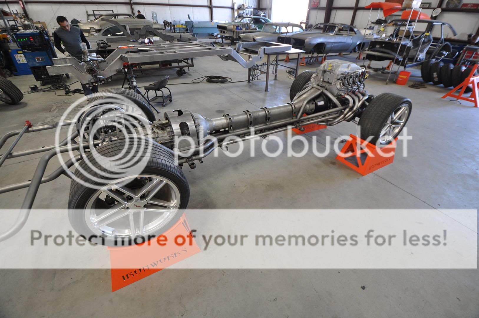

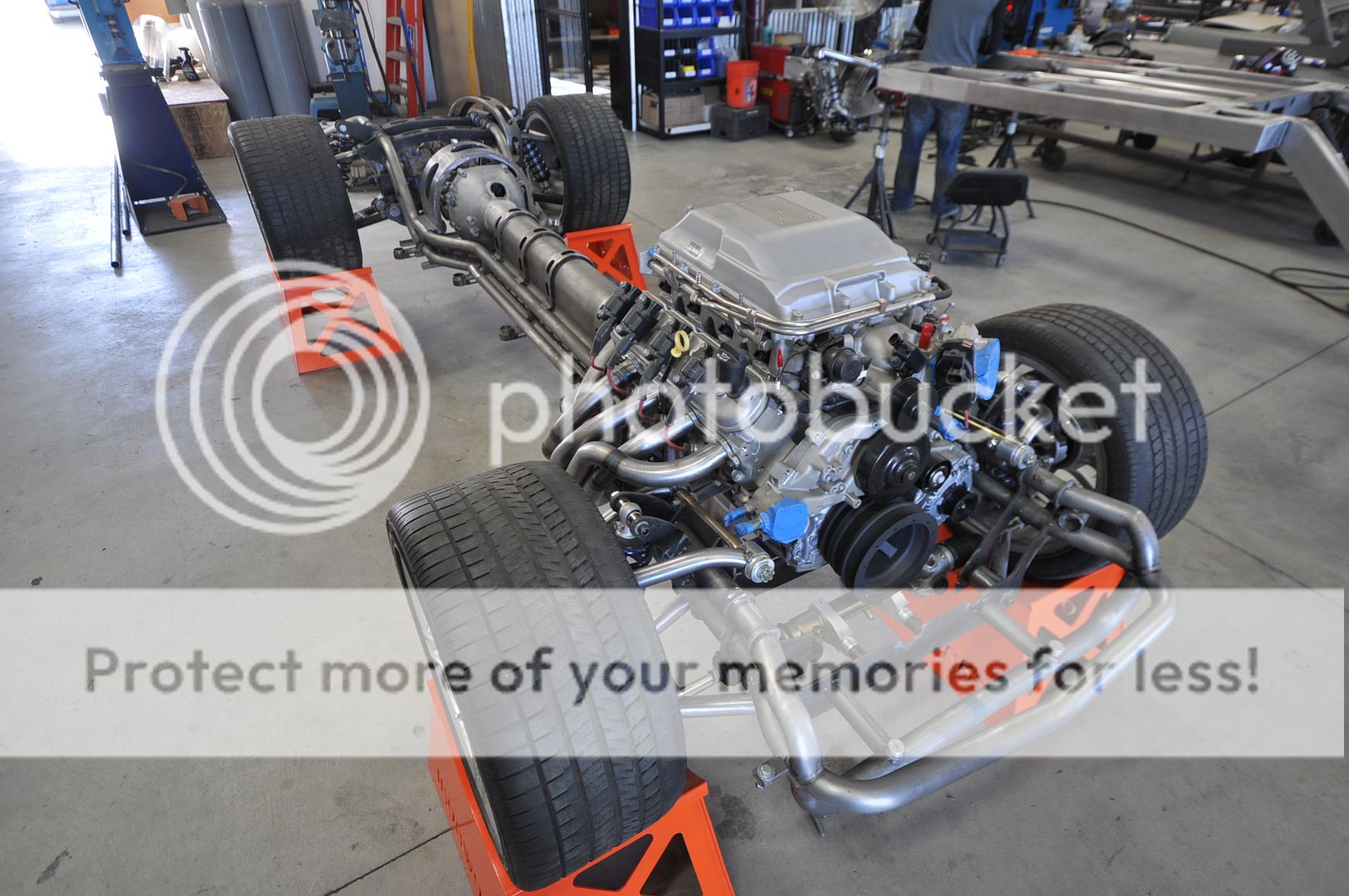

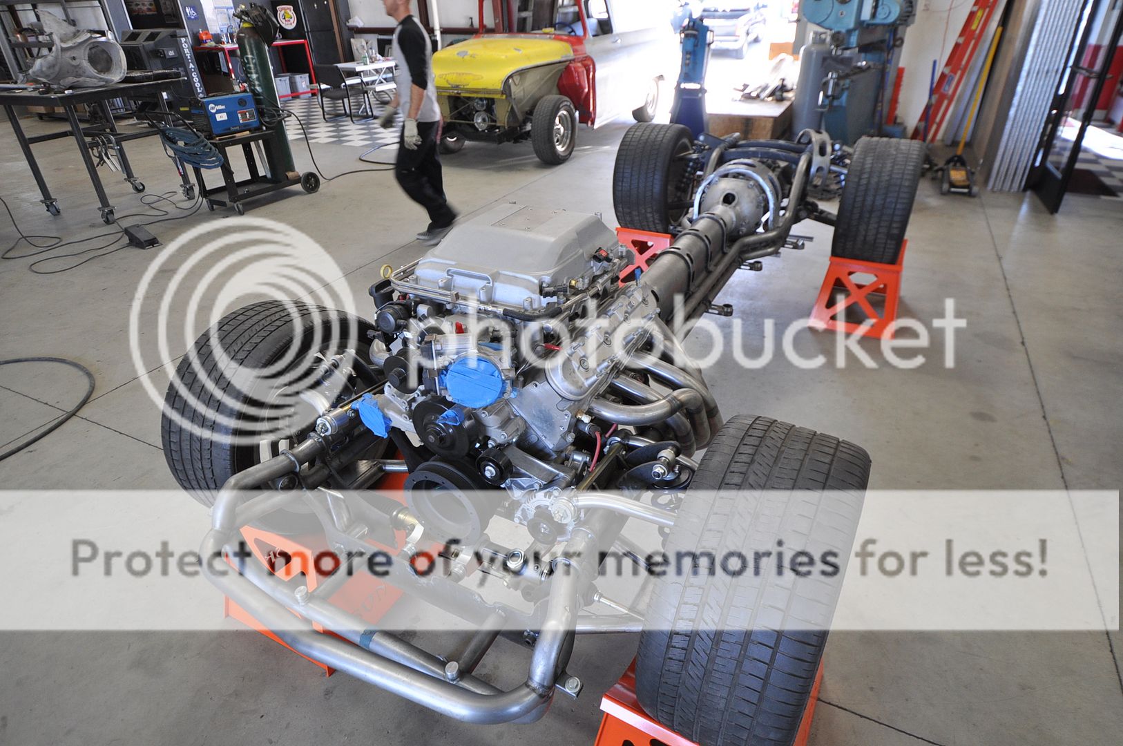

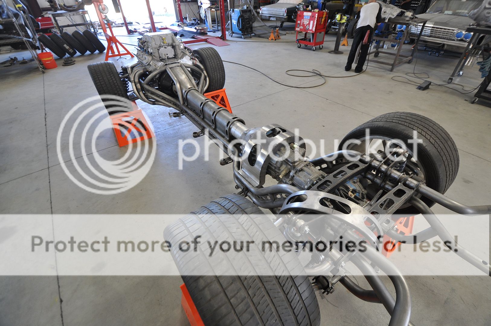

We have been knee Deep in getting some details worked out in Darrel's tube chassis for his Nova. The steering rack placement and front control arms are finalize for the rack and pinion to clear the low mount alternator of the stock LSA bracket system. When working with the LSA engine you don't have to many engine bracket system options without engineering your own complete system.

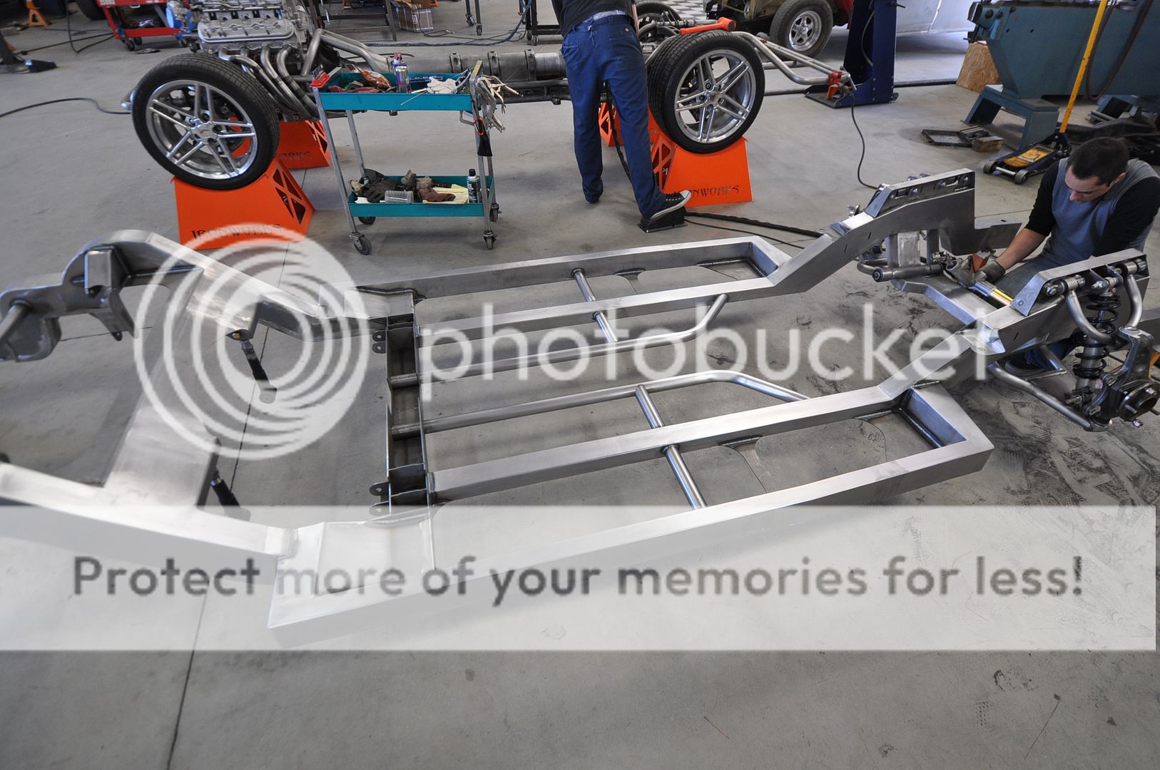

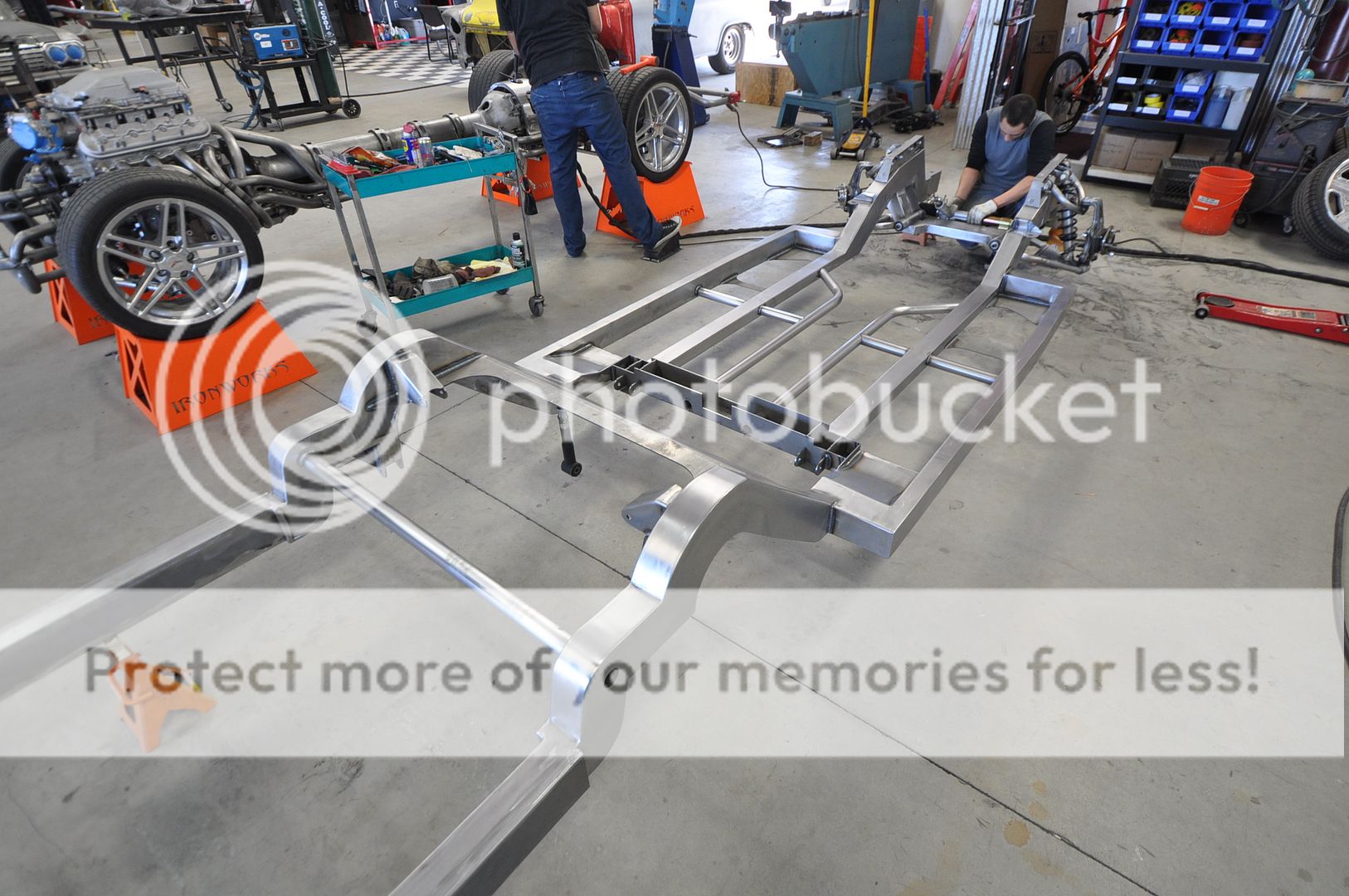

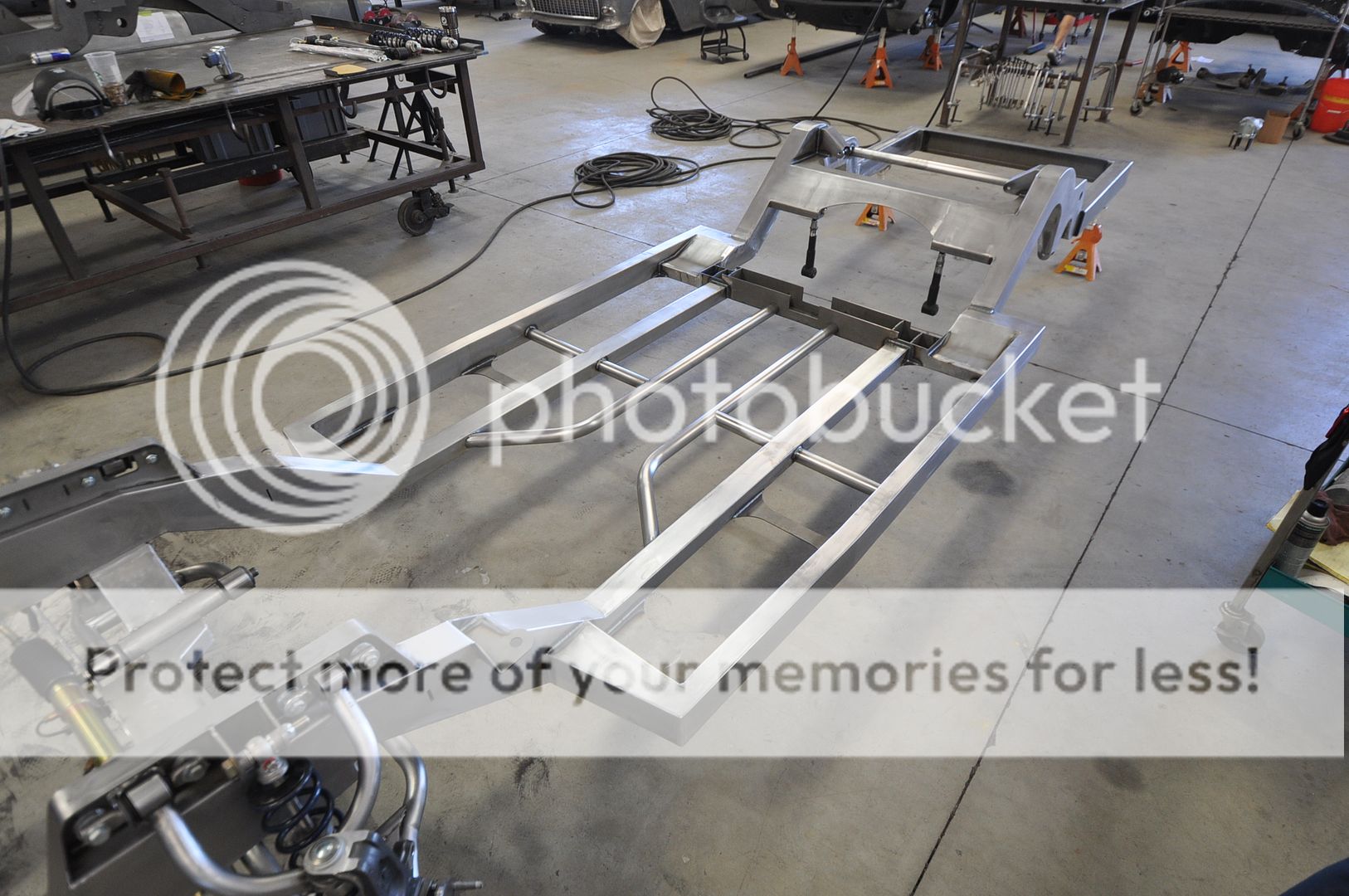

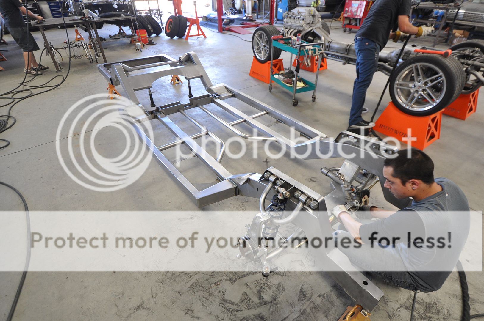

Well here it is. Almost Ready for the LA Roadster show. Finally.
http://i616.photobucket.com/albums/t...2-20120012.jpg
http://i616.photobucket.com/albums/t...2-20120022.jpg
http://i616.photobucket.com/albums/t...2-20120032.jpg
http://i616.photobucket.com/albums/t...12-2012006.jpg
http://i616.photobucket.com/albums/t...12-2012005.jpg
http://i616.photobucket.com/albums/t...12-2012004.jpg

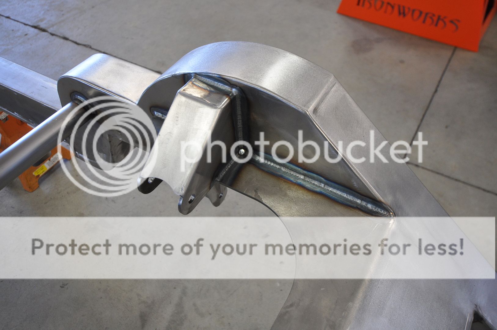

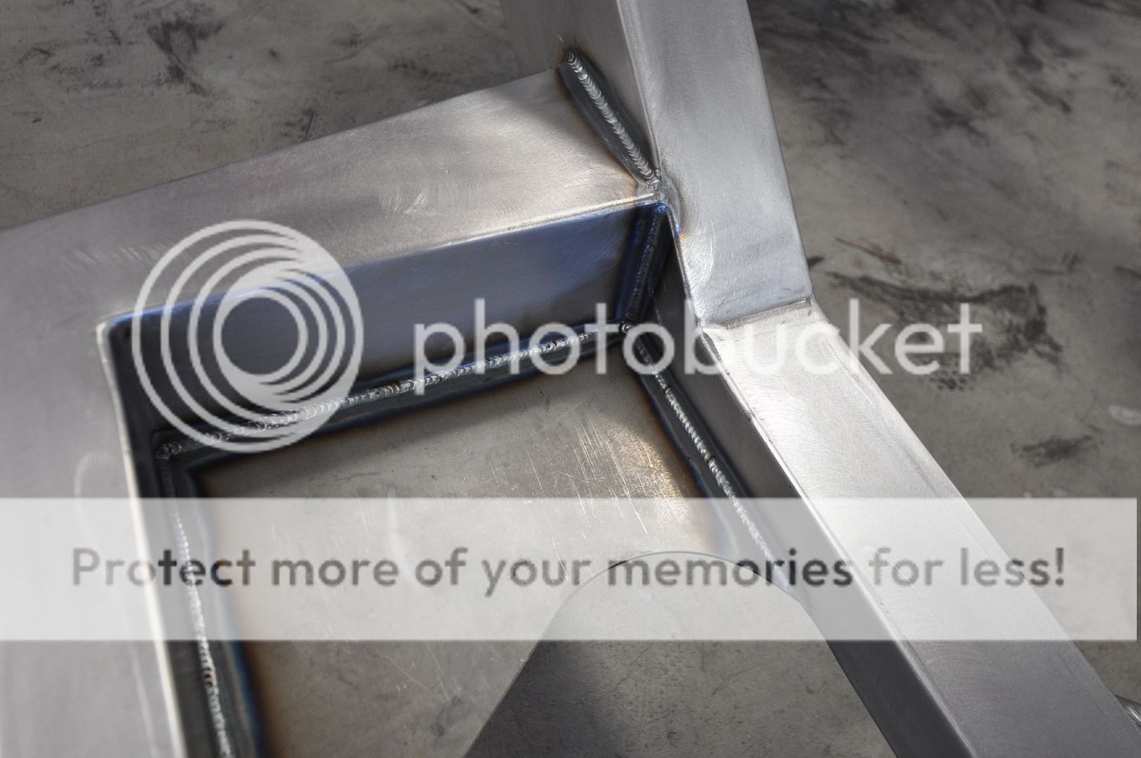

Introducing the Lowest sitting, Strongest 58-64 Impala chassis on the market. You have to cut out a little bit more floor then I intended, but when stance matters I guess it is all worth it. For the first time ever we have gone to using some 3/16 plate in some of the vertical section of the chassis to raise strength even further for such a big car. The entire chassis is still TIG welded. Not just the welds that get sanded down. Enjoy
We plan to finalize the frame center section once we have routed the exhaust and mounted the engine and trans in a car or two.

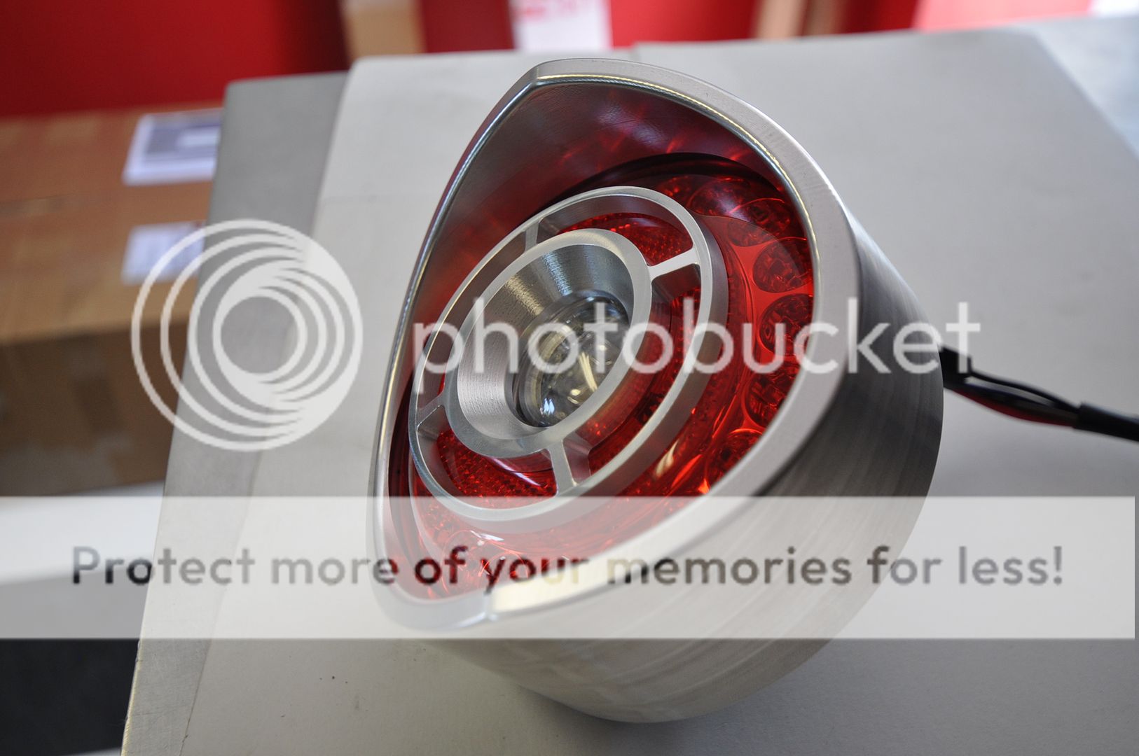

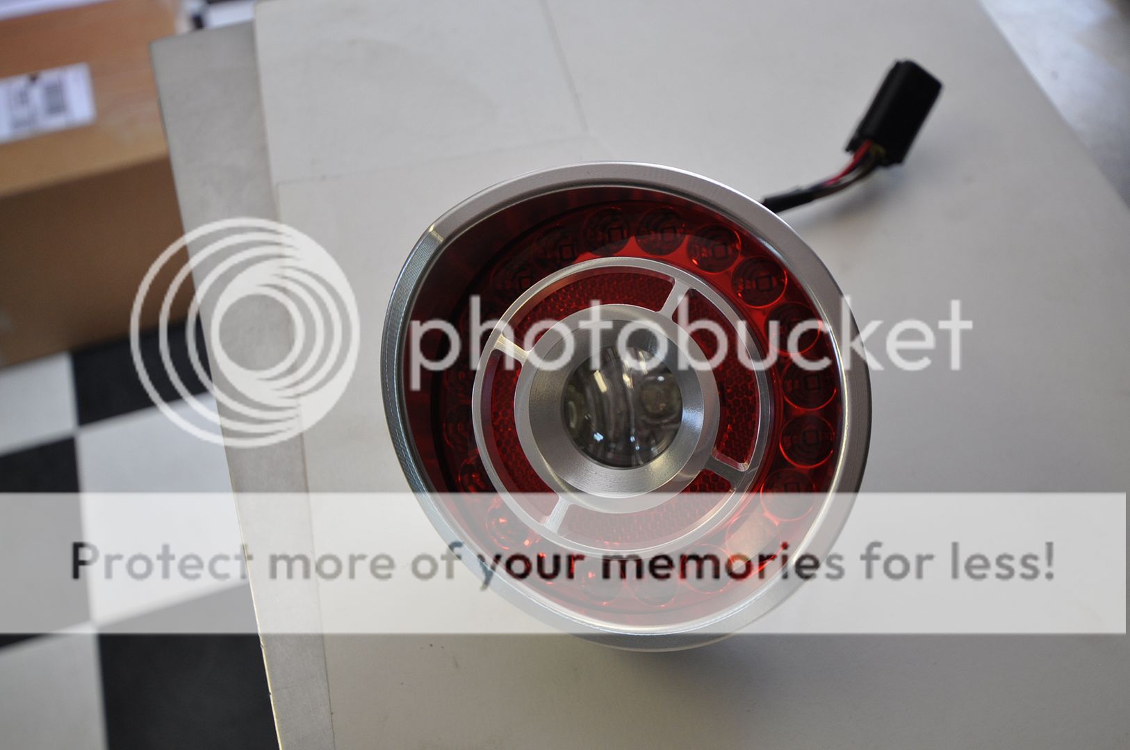

Here are some pictures of the Sweet machined Taillights for the Bubbletop project that we have going on. I case you did not see it in the build thread.
Sweet.
http://i616.photobucket.com/albums/t...-2012008-1.jpg
http://i616.photobucket.com/albums/t...-2012009-1.jpg
