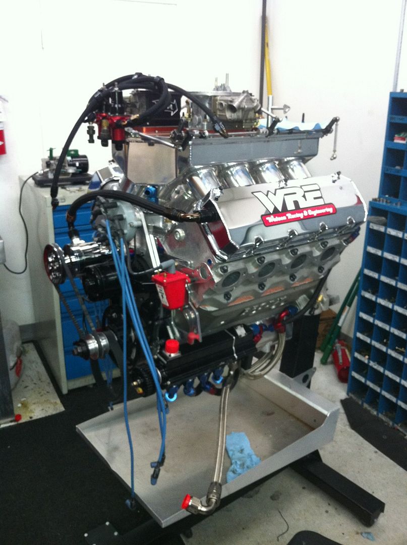

Flash68 02-07-2013 04:11 PM
making progress..... but I am in line behind this thing... 781 cubic inch. :guns:
http://i236.photobucket.com/albums/f...ps2868ec80.jpg
I am back in the queue early next week Mike says. :thumbsup:
GregWeld 02-07-2013 04:20 PM
Exact same CI that my Freightliner has! OMG!! I almost passed out when I saw this bad boy... Nothing better than a big azz motor on a dyno. Bet she shakes the whole building. Ya gotta be there when they run it and post video!!!!
Oh.... and you're small block is okay too.... I guess. :lmao:
Flash68 02-07-2013 04:25 PM
I was just getting ready to ask if I could come see it on the dyno but he said they have to haul it down to San Leandro because Watson's dyno ONLY handles 1000 ft lbs. Dammit.
That should make 1600+ hp he said.
We dyno'd some big cubic inch engs and well... you just have to be there to know the feeling.:thumbsup:

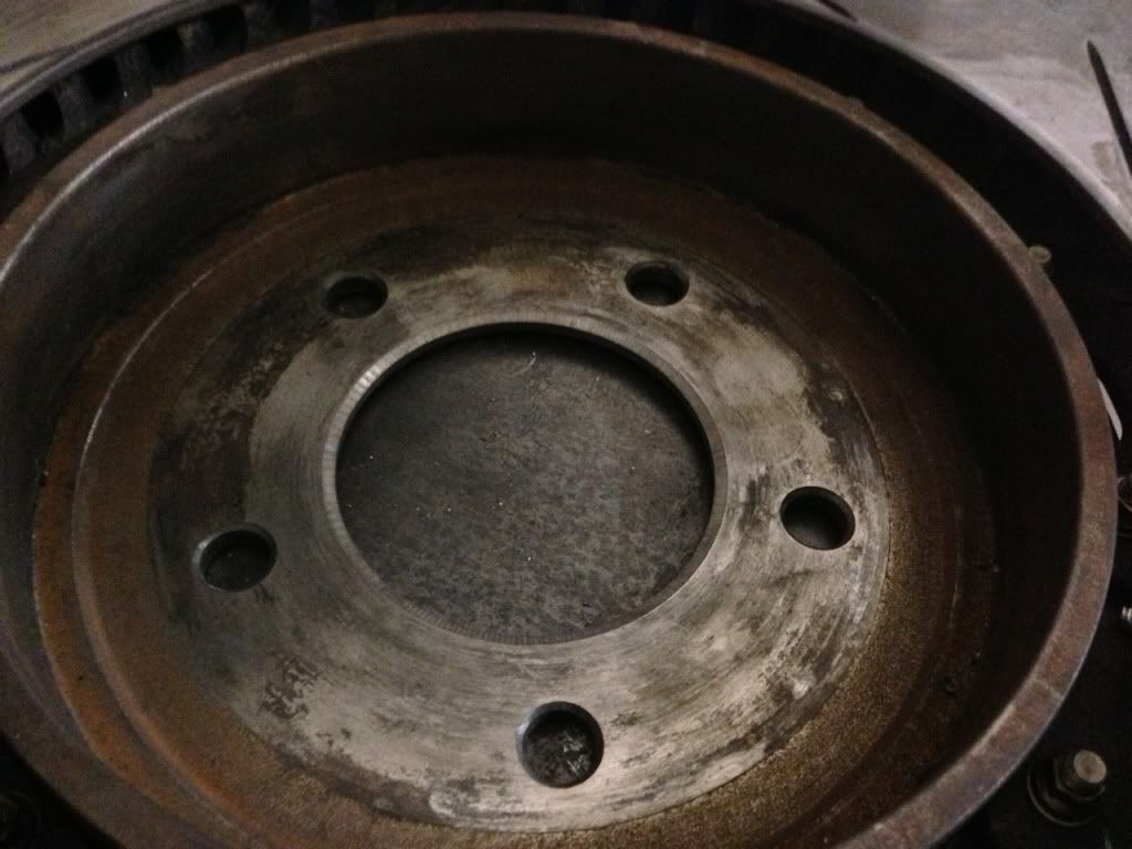

Flash68 02-15-2013 01:06 AM
Received another NASCAR part today... :unibrow: Somewhat experimental (for me, not the part itself). I have always wanted to try a locker and now I will do so. Who knows, I may really like it. If not, I'll swap in a Tru Trac.
This is a Roush Yates Detroit Locker Cup Car take out.
Nodular case
3.25 big bearing
Daytona pinion support
3.64 gear ratio (the ratio I was looking for)
Gears REM polished
Gears scalloped/lightened
G-Force internal pump
1350 billet yoke
All this for under $1000 shipped to my door. And looks to be in excellent condition.
http://i236.photobucket.com/albums/f...pse8e6f374.jpg
This 3.64 rear with my T101A trans will put me around 67-70mph top speed in 1st gear and 150-160 mph in 4th, depending on final redline of motor (figuring 7200-7500).
Also, the Fab53 "Chain Saw" tow hook was a little worn and has been blasted and will be cleared before reinstall.
http://i236.photobucket.com/albums/f...psa1070379.jpg
Got a pallet on its way from Jake.... pretty stoked for what's coming. :thumbsup:
