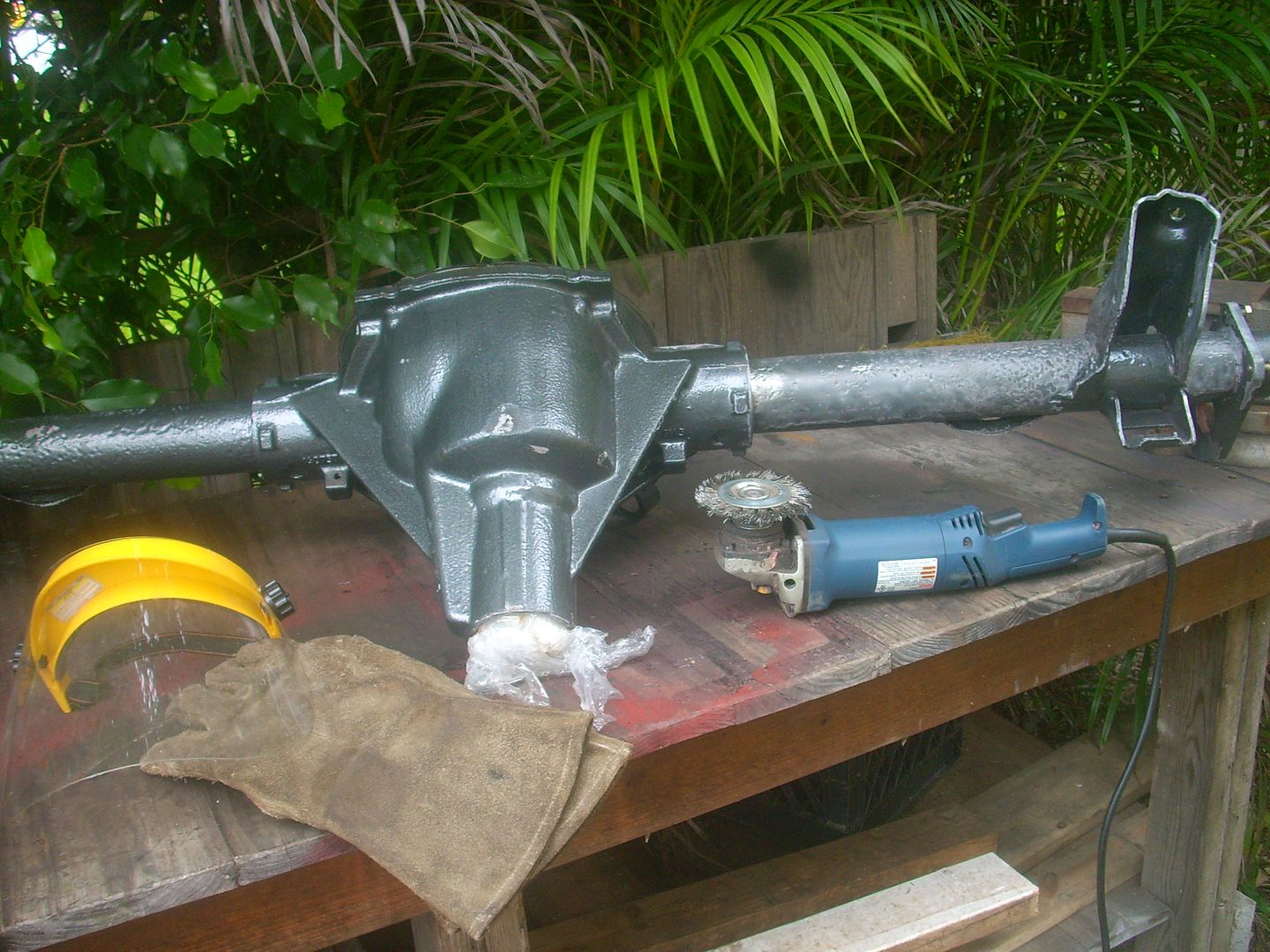

As for an update, I've also gotten started on building the rear. A few weeks ago I took all 4 axles to the machine shop I still work out of part of the time and checked them out after putting them in the washer to clean them up. The outer bearing surface was scored on one and a dial indicator showed one as slightly bent so the choice of which 2 to use was a no brainer. I bought a set of new Richmond 3.73 gears from a member on another forum and ordered a complete rebuild kit from Ratech for bearings, shims etc. The previous owner of the rear had cleaned up the rust on the outside of the housing and hit it with some POR 15 or something but because I want to weld the axle tubes to the center section the paint needed to come off that area. I figured I'd just clean and smooth the whole housing so I started stripping it.

Once the paint was stripped I prepped it for welding the tubes to the center section, additional spring perch welds, and also ground out some questionable factory welds on the lower link brackets to be rewelded. Had my bud Rick I work with (who's a better welder than I) weld it up for me. Yes, I checked to be sure the axle tubes were straight before welding. I will be taking the car to the strip and running it on sticky drag tires and plan on some auto X action with A-6's so hopefully the extra welding will help things stay together and straight.
