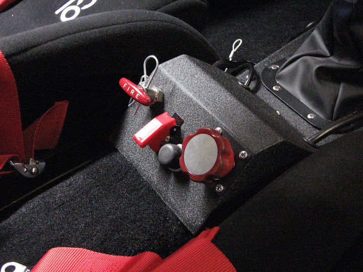

guys, heres a few last pics. got fire bottle mounted and nozzles run, got new autometer ultra light II gauges installed, built a mini console for fire handle pull, ign switch, and push button start as well as a brake bias control as it has hanging pedals and triple mc's
built the alum intake tube, then powder coated it in texture, as well as the console, we powder coat in house.

Jake, That is awesome build. Tell Vinny to throw you an extra tip and buy a better camera :D . We need some better pictures. Is that a steam line connected to your catch can?
68protouring454 02-04-2011 08:24 AM
its a 16 mp canon slr, just done quickly and in reg shop lighting also resized
yes thats connected to the catch can, the radiator is a c/r with built in oil cooler and no fill neck, so the catch can is the reservoir as well
