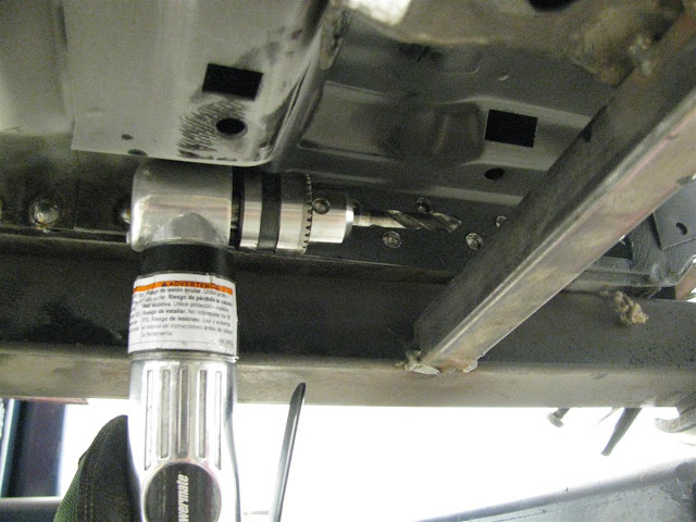

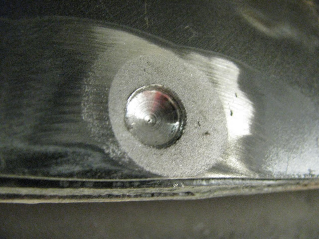

I know how important the floor is for structure for these unibody cars... so to get even a bit more penetrationinto the rails and rockers (which are WAY thicker than the floor) I would use a drill and slightly drill into them so as to get deeper penetration! Might be overkill, but makes me feel better. :)

Then I just turned up the HEAT!! welding them as hot as I could to get as flat of a plug weld as I could.

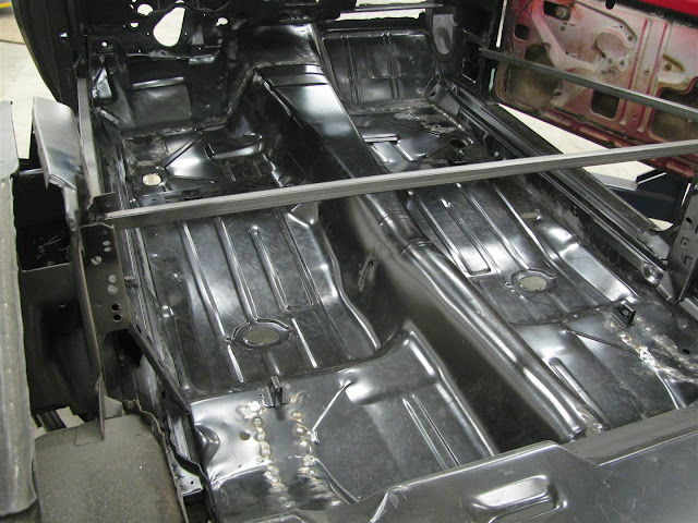

BIG IMPROVEMENT!! nice NEW metal! With both the full trunk and full main floor, I now have a solid base. Still have to add the convertible bracing but that will be a bit later.

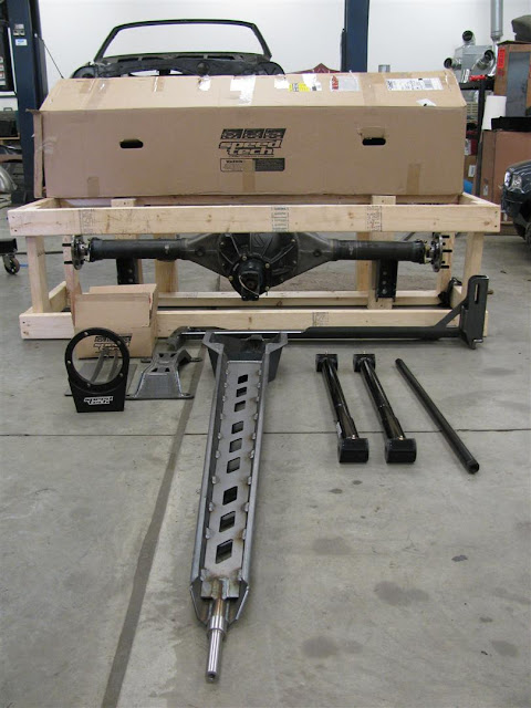

But I did get one of my major pieces recently... Thanks to Roger and the guys over at Speedtech I am the proud owner of one of their Torque Arm systems w/ complete 9" rear-end! The quality and craftsmanship of their components is amazing... only thing better is their customer service! :thumbsup:

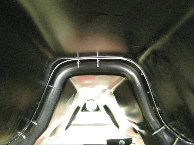

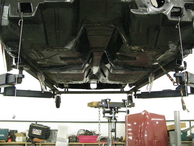

So on to the convertible floor braces... these were a bit of a PITA! the initial fitment showed that I would be using LOTS of screws to suck them up and get them to contour to the floor.
I used a Trans-Jack to hold the main brace into place so I could mark it off and drill out the holes so I could weld from inside the car. When plug welding, I like to weld to the THICK metal of the floor brace, rather then to the thin metal of the floor.

Using the Trans-Jack to hold brace in place to mark floor...

Used screws to SUCK the brace up to contour the floor... it actually turned out to look JUST like the original that I still had in the shop for reference.

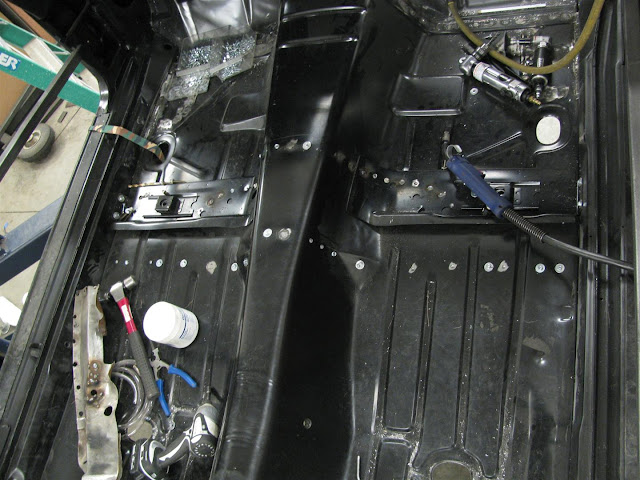

Here you can see all the screws holding the floor in place... it has some welds already done.

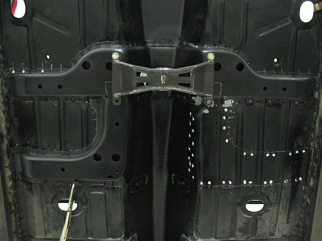

NOTE: make sure you use either the original cross brace or whatever brace you will be using to make sure it will bolt up BEFORE you weld in the left/right rear brace. Here I am using Speedtech's Torque Arm brace to make sure everything is OK before I mark off the location for the left/right rear braces.
https://lh3.googleusercontent.com/-X...Large%2529.JPG
Marked off for the left brace... drilled holes to plug weld from the top.
https://lh6.googleusercontent.com/-q...Large%2529.JPG

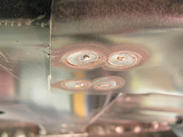

Not a fan of having to weld upside down... but was very pleased how my welds turned out where the left/right braces meet up with the main brace. I used LOTS of HEAT!
https://lh3.googleusercontent.com/-k...Large%2529.JPG
https://lh6.googleusercontent.com/-p...Large%2529.JPG
