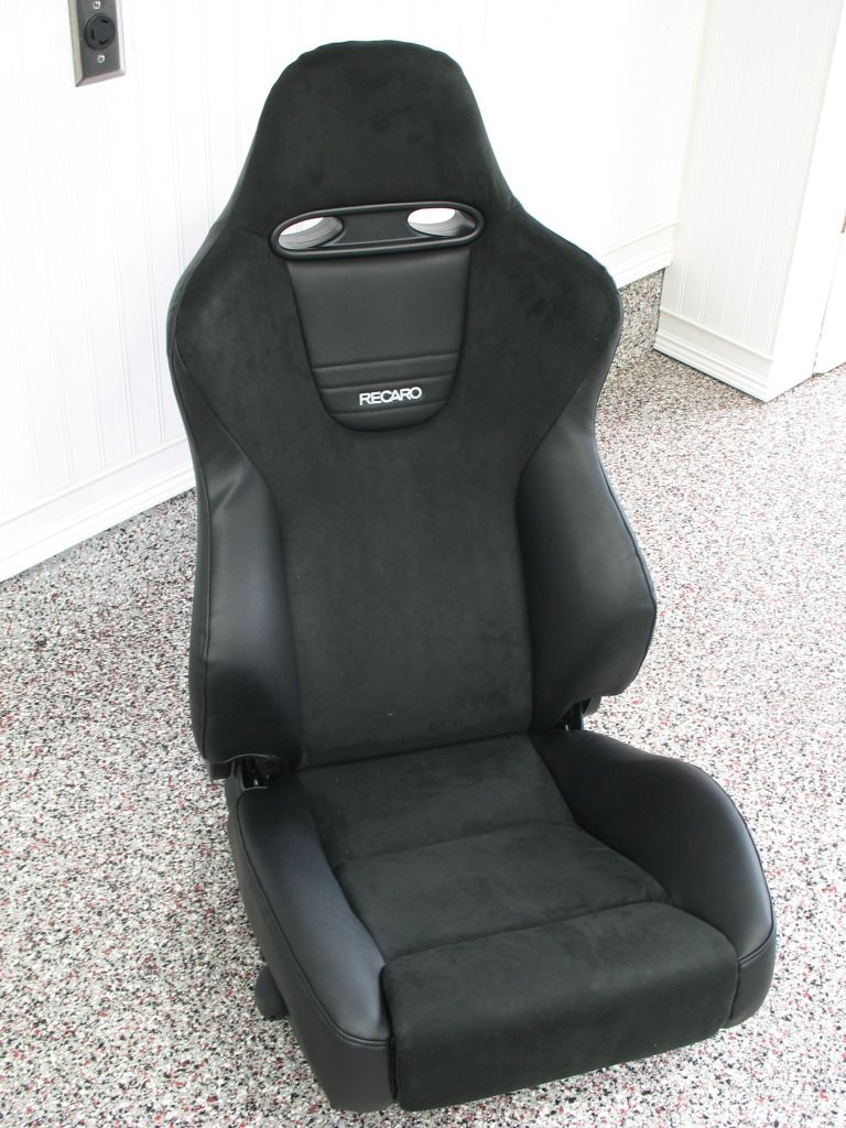

I decided to order the Recaro Sport seats from THMotorsports. They were prompt, easy to deal with and included availability information along with their quote. Of course, their prices were competitive too.
The passenger seat has already arrived.
THMotorsports could have just sold me the Recaro sliders and mounting brackets which are not made specifically for installation into a first gen. Camaro.
Instead, they encouraged me to consider using the Corbeau sliders and mounting brackets since they will fit the Recaros and they are specifically designed for installation into first gen. Camaros. That's the kind of service that makes a person sure they are dealing with the right folks.

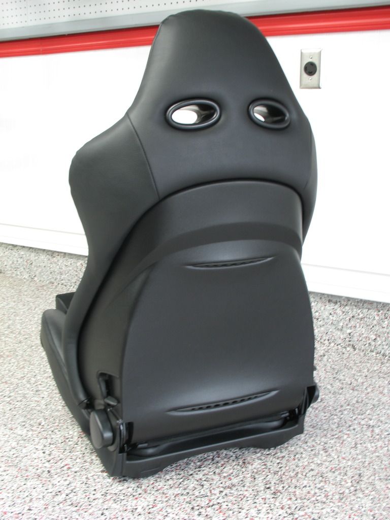

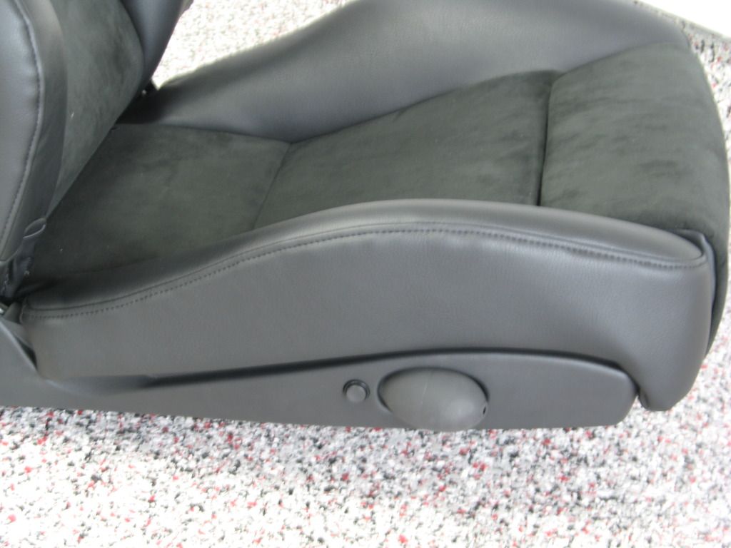

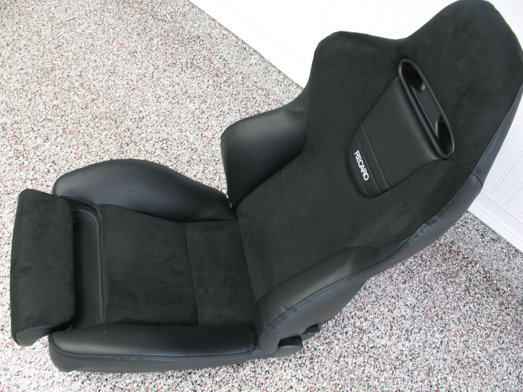

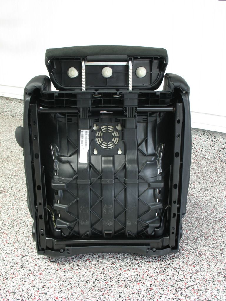

Here are some pics of the seat in case you are considering them. I couldn't find some of these views when I was researching them.
http://i1140.photobucket.com/albums/...i/IMG_3240.jpg
http://i1140.photobucket.com/albums/...i/IMG_3243.jpg
http://i1140.photobucket.com/albums/...i/IMG_3242.jpg
http://i1140.photobucket.com/albums/...i/IMG_3258.jpg
http://i1140.photobucket.com/albums/...i/IMG_3261.jpg
http://i1140.photobucket.com/albums/...i/IMG_3262.jpg

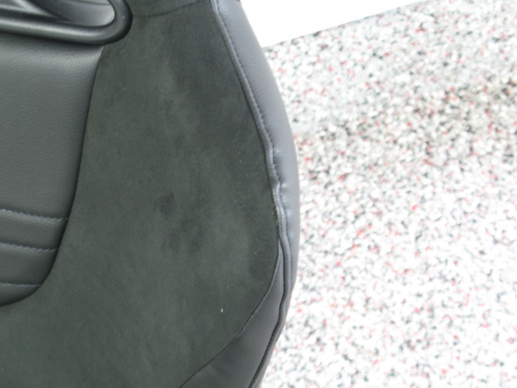

While I am happy with the seats, I will say that I am surprised that Recaro doesn't put more effort into making the seam down the side of the seat look better. Perhaps they should be using double stitching or something because as you can see in the following picture, the vertical seam down the side of the seat looks a little "amateurish" in my opinion. I think it should be nice a crisp without wrinkles and kinks.
http://i1140.photobucket.com/albums/...i/IMG_3255.jpg

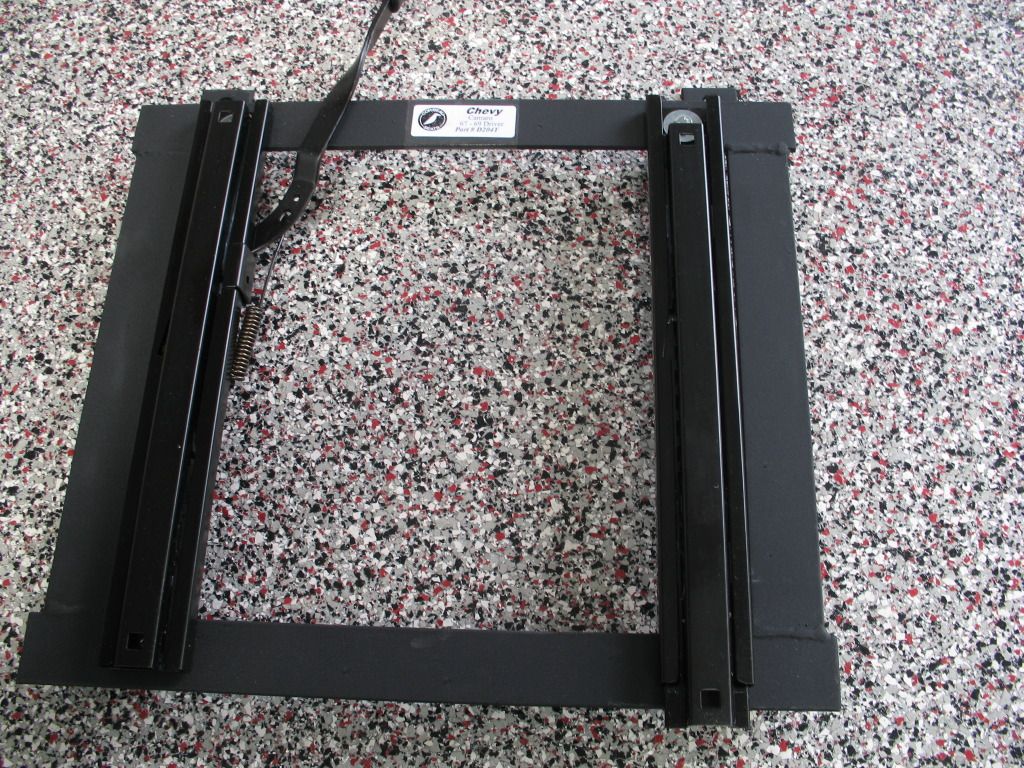

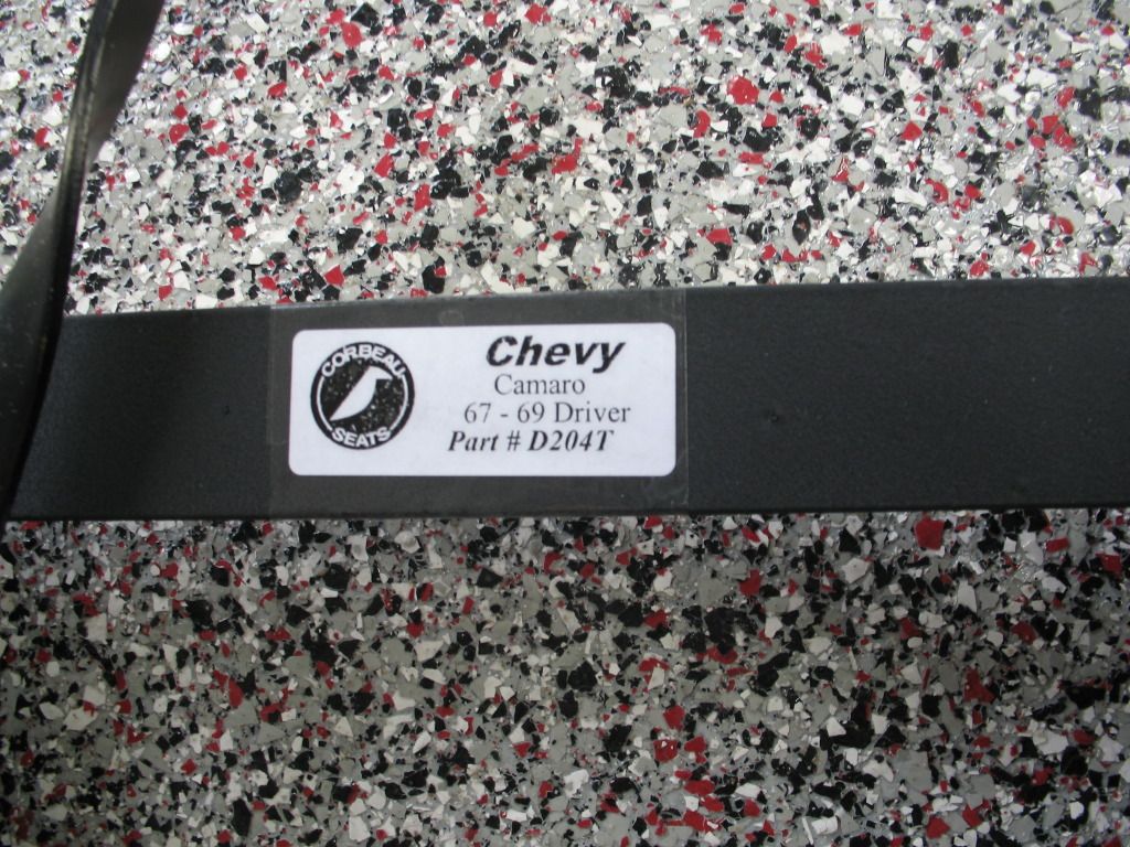

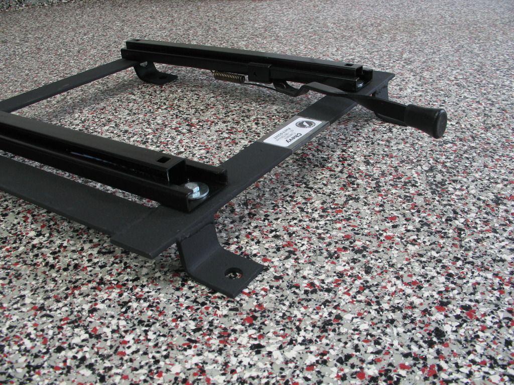

Here is the Corbeau slider and mounting bracket assembly.
http://i1140.photobucket.com/albums/...i/IMG_3253.jpg
http://i1140.photobucket.com/albums/...i/IMG_3252.jpg
http://i1140.photobucket.com/albums/...i/IMG_3251.jpg

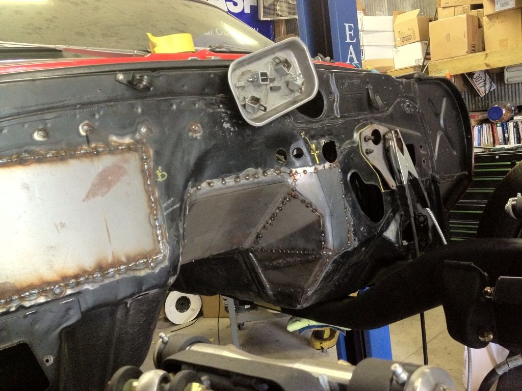

The crew at V8TV has been working on the trans tunnel and firewall.
The T56Magnum required the trans tunnel to be opened up since we are mounting the LSA motor in the rearmost position using DSE LS motor mounts.
The trans tunnel was clearanced by John.
First he cut out a basic window that would allow him to clearly see what needed to be done when the trans got lifted into position.
http://v8tvshow.com/1969_Camaro_LC/s...7.27.12_03.JPG
http://v8tvshow.com/1969_Camaro_LC/s...7.27.12_13.JPG
That obnoxious shifter hole cutout was compliments of someone in the past.
Next, John lifted the trans to plan his overall surgery strategy.
http://v8tvshow.com/1969_Camaro_LC/s...7.27.12_20.JPG
He could now see he had to slightly raise the tunnel and to create a whole new tunnel to firewall transition.
First he made a new tunnel roof and welded it in.
http://v8tvshow.com/1969_Camaro_LC/s...7.30.12_08.JPG
Notice how he made a piece that gently transitions into the original tunnel with nice radius edges.
http://v8tvshow.com/1969_Camaro_LC/s...7.30.12_13.JPG
He then cut out the firewall to tunnel transition and began fabricating his own.
http://v8tvshow.com/1969_Camaro_LC/s...7.31.12_01.JPG
Here is the result of John's craftsmanship. I think it looks a lot nicer than the stock transition ever did.
http://v8tvshow.com/1969_Camaro_LC/s...8.08.12_02.JPG
He also made a filler panel for the firewall and installed it.
http://v8tvshow.com/1969_Camaro_LC/s...7.31.12_11.JPG
http://v8tvshow.com/1969_Camaro_LC/s...7.31.12_22.JPG
http://v8tvshow.com/1969_Camaro_LC/s...8.08.12_09.JPG
http://i1140.photobucket.com/albums/...stunnelfab.jpg
Next week the body goes out to media blasting. We already know there will be some needed floor and trunk repairs along with some inner rear fender and dash repairs. Hopefully there won't be TOO many surprises when it comes back...
badmatt 08-12-2012 01:42 PM
Those seats look great, id raise some **** with Recaro about that seam though..
poor quality control on that piece.
