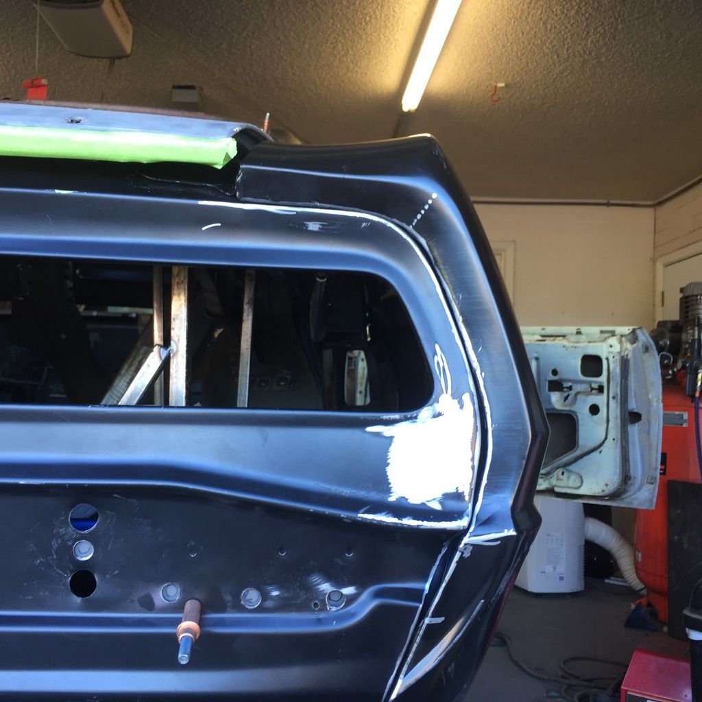

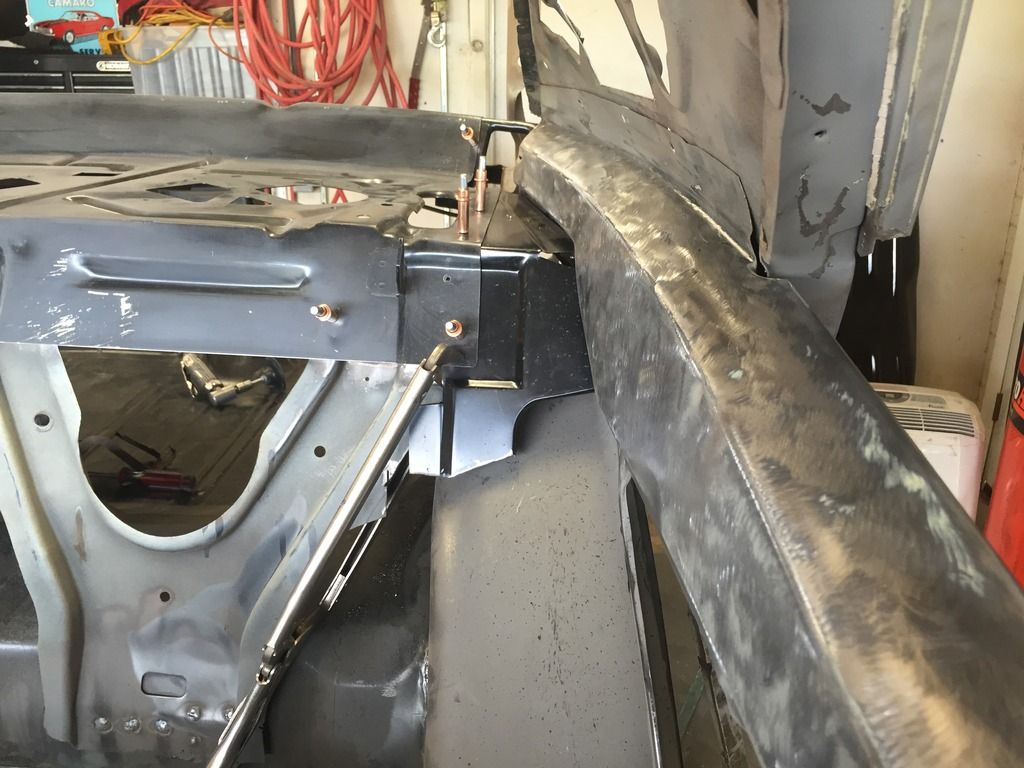

From what I've seen this is a common fit issue, the corner needs split in order
to get it to sit right, but doesn't seem to be too much on an issue the other side was the same
http://i1368.photobucket.com/albums/...psbogokyya.jpg
http://i1368.photobucket.com/albums/...pstc7jr1sy.jpg

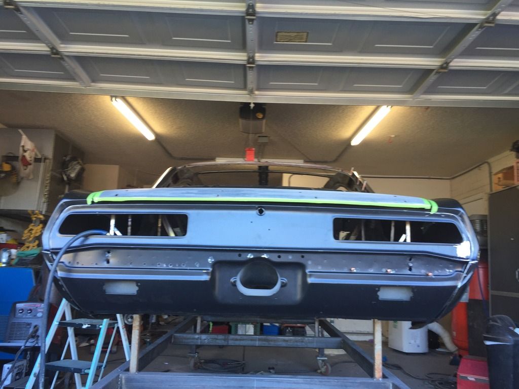

I used a silver sharpie to highlight the edges to help me see, Trunk gaps weren't terrible, seems to be par for the course from what I have seen, Tight at the top and bottom but a bit wide in the center

One thing I discovered is I don't own enough clamps!! But #10 tek screws work in a pinch! the only thing left to do was get the trunk floor extensions fitted.after that I pulled everything back apart not its a lot of welding and grinding of drilled spot welds and some little rust repairs before I sandblast and prime.

98ssnova 04-25-2016 11:46 AM
Maybe its the angle of the photos but the body line looks off from the fender to rear tail light panel?
JDODDS187 04-25-2016 12:02 PM
I was able to pill those lines together in the end, I just needed an extra set of hands to clamp while I held. I needed to pull up and push over at the same time and needed both hands. for the most part that is resting on the rear panel.
There is also a few areas on the lower part of the quarter panel that need worked in just a bit, some of the bends have just too wide of a radius and is holding the gap open.

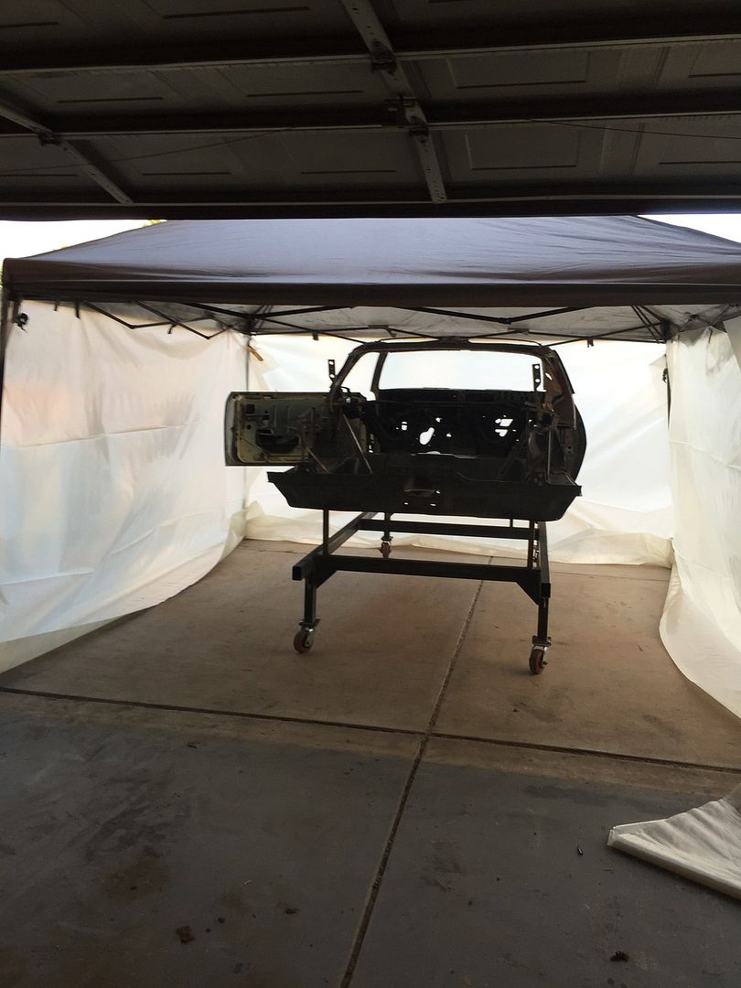

I had some time to work on the Camaro again this weekend, Did alot of work but not much to show for it... Back into the "Sandblast booth". I think Im done with sandblasting in my driveway. such a pain....
http://i1368.photobucket.com/albums/...psvhtdgob1.jpg
about 6hrs later and all i have to show for it is the inner structure is all clean and ready for epoxy primer.
http://i1368.photobucket.com/albums/...psor3n4unq.jpg
I only get about 30min of blasting to 1hr of clean up.... not only that the wind picked up and almost lost my booth...

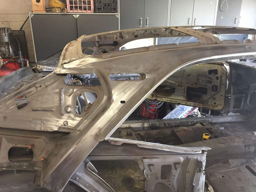

JDODDS187 05-02-2016 06:59 AM
After cleaning I spent most of the weekend filling areas where there was clusters of spot welds that were drilled out. and I got some paint stripper to clean the inner door frames and trunk lid, but after further examining of the trunk lid, I found some major rust in the inside, and it looks like it wouldn't be long before it comes through to the top side. so yet another part to buy.
