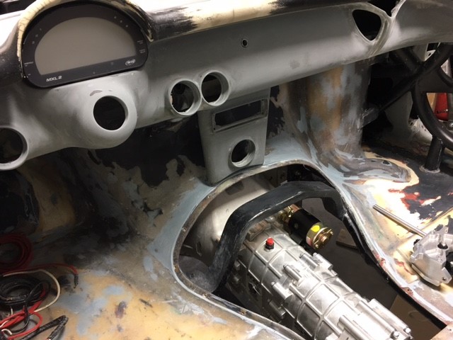

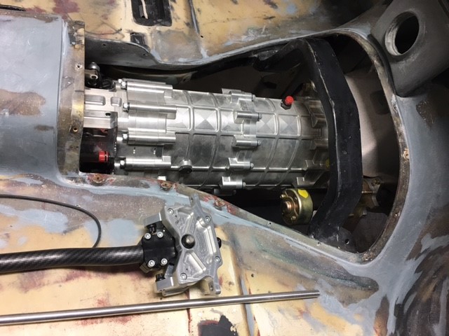

A seemingly endless string of construction updates. I finished modifying the firewall, floorboards, and frame to install a new 6XD sequential transmission. I need to build a bracket for the remotely-mounted shifter that is connected with a single push-pull rod. I will install the engine soon so I can finish the plumbing and get it on a chassis dyno for final tune and to program the ECU for no-lift shifts and no-clutch downshifts. I finished the conversion to a DBW throttle that was required for the shifts. Some progress.

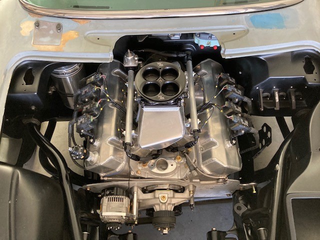

mfain 05-10-2021 07:19 PM
5 Attachment(s)

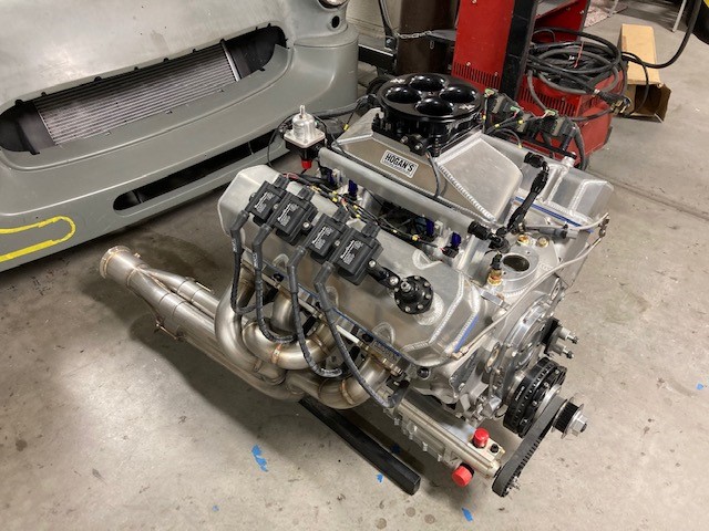

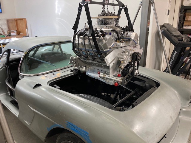

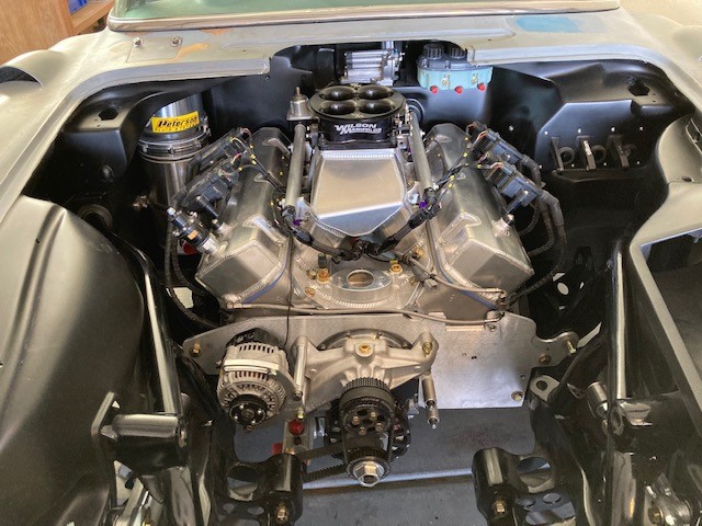

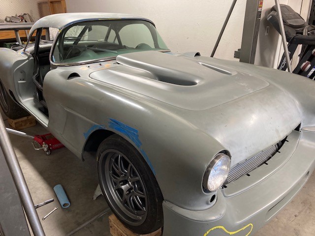

It fit...….time for plumbing.
Attachment 74778
Attachment 74779
Attachment 74780
Attachment 74781
Attachment 74782
