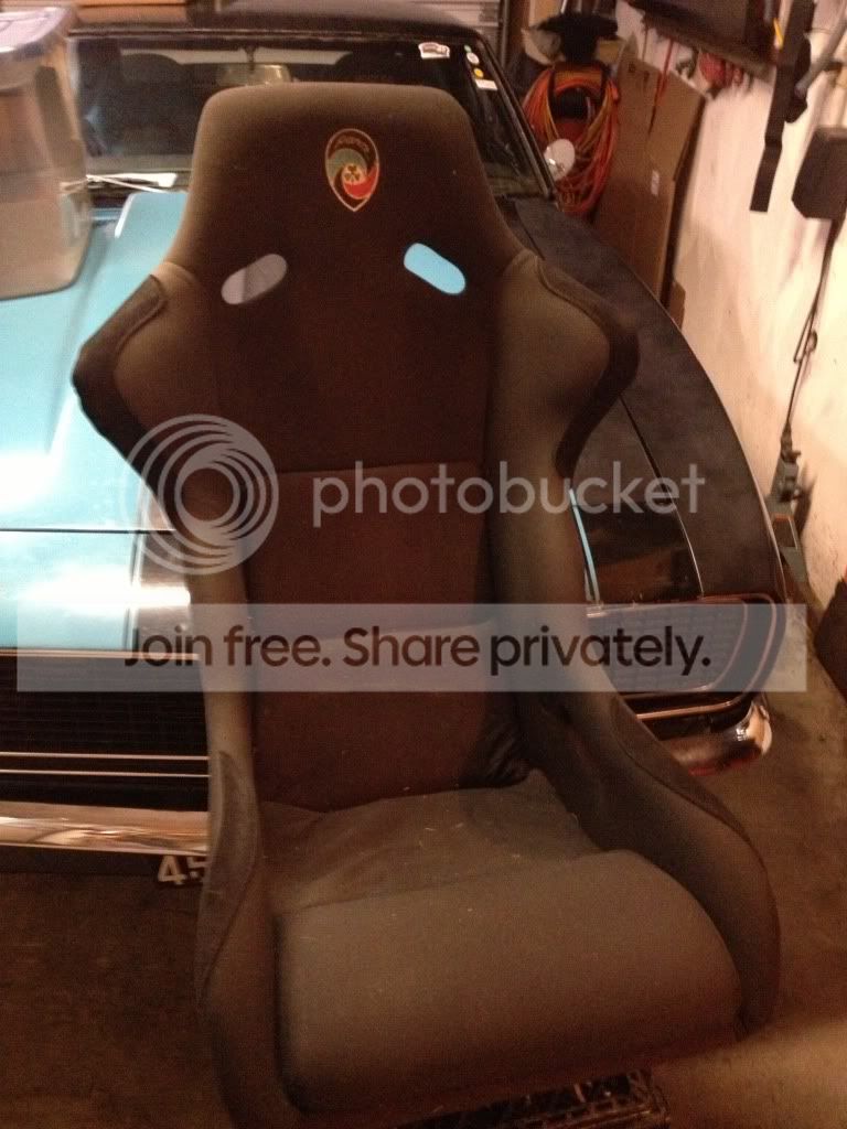

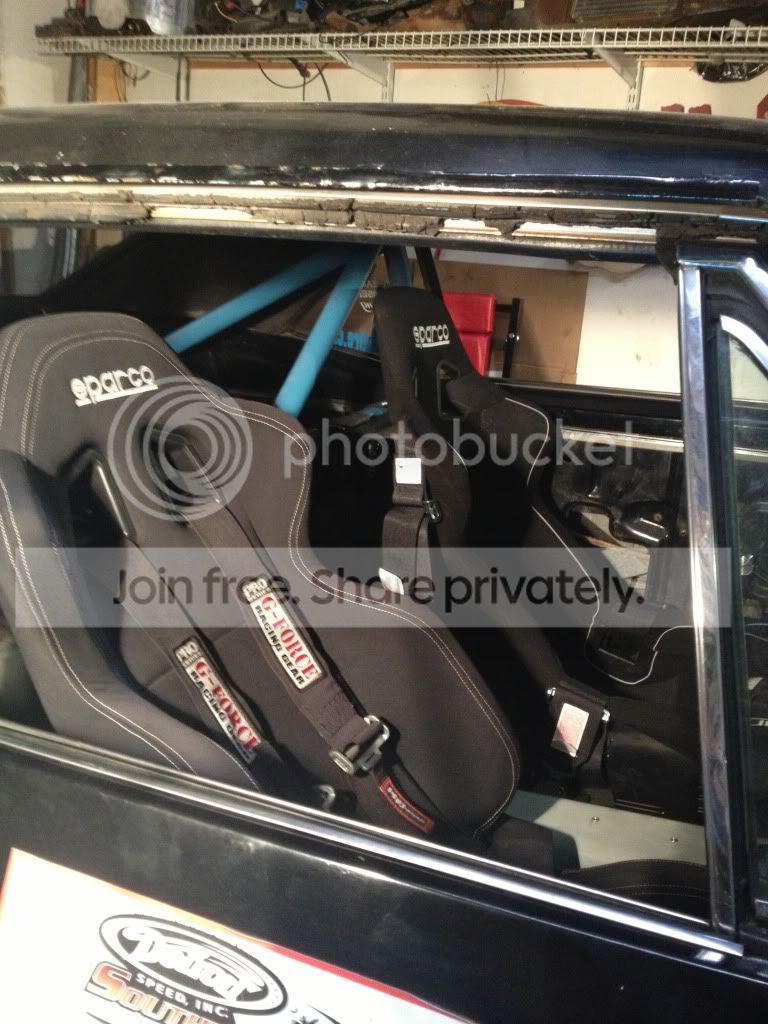

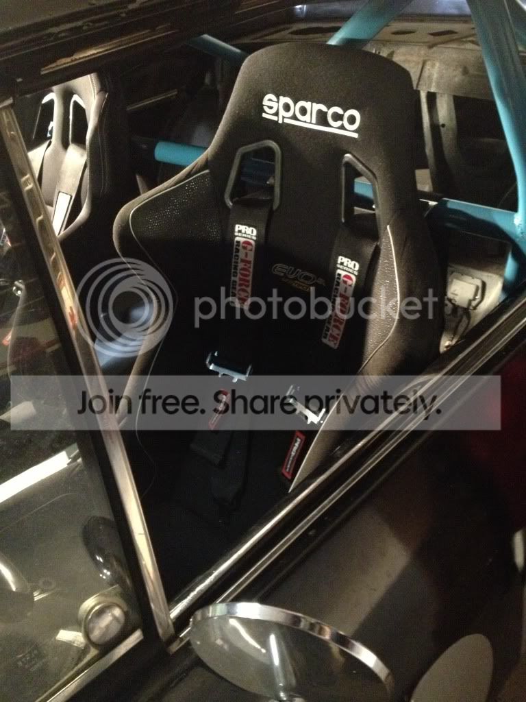

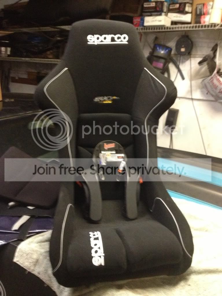

Next project is upgrading all the safety stuff on the car, I was going to buy a new Sparco seat to the tune of $800 but I scored this one off one of my buddies who pulled it out of his dad's Panoz for free! Yeah free! I need to get a new cover for it, but thats' better than buying a new one. I also need to install a back support to the harness bar because the SFI rating is expired, the back support will make it legal again. Still better than dropping $800!
http://i539.photobucket.com/albums/f...psc37d9acc.jpg

got all the new Christmas stuff in the mail, new seat cover fit's perfectly! Makes it look like a brand new seat! I need to order new pass through gaurds and cut the holes for the belts. HANS fits me perfectly too! gotta fit the tethers to my helment but that should be easy.
http://i539.photobucket.com/albums/f...psbcf32ad3.jpg

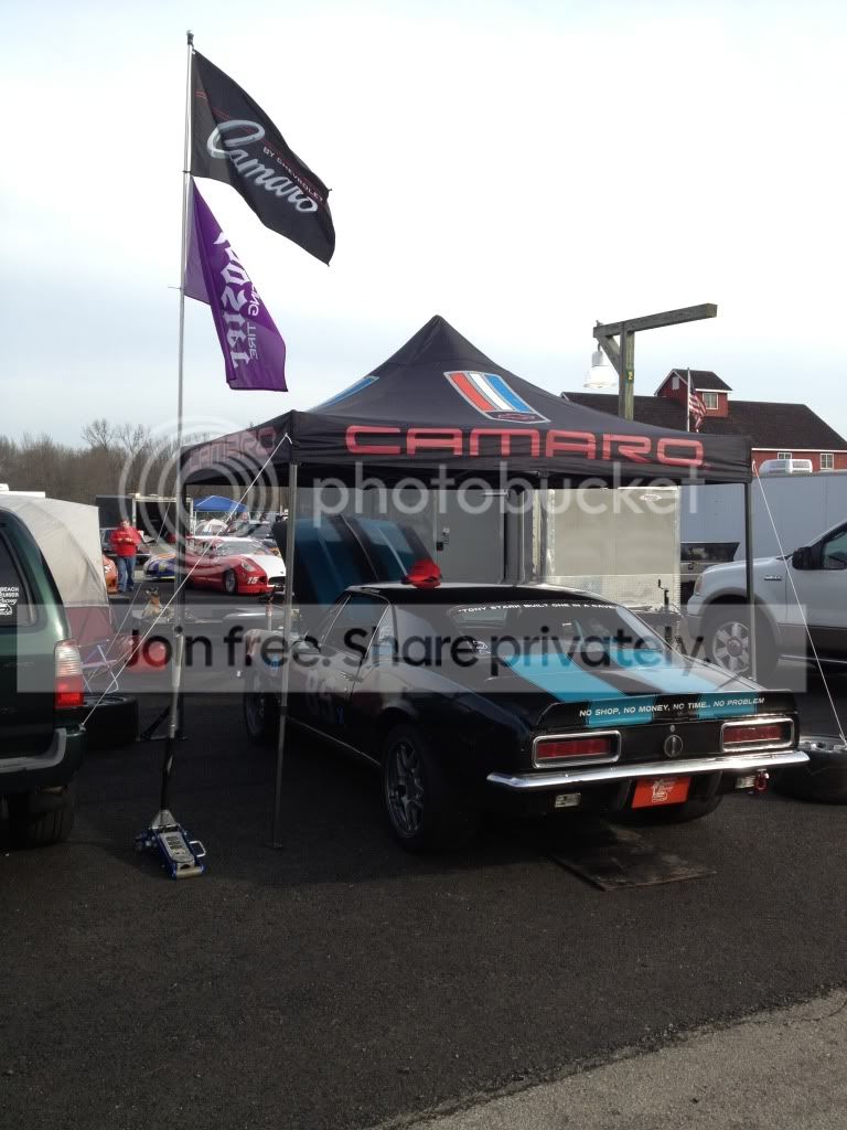

Went to the new car show here locally and picked up some cool flags to wave at the track! Also scoped out my wife's new car.

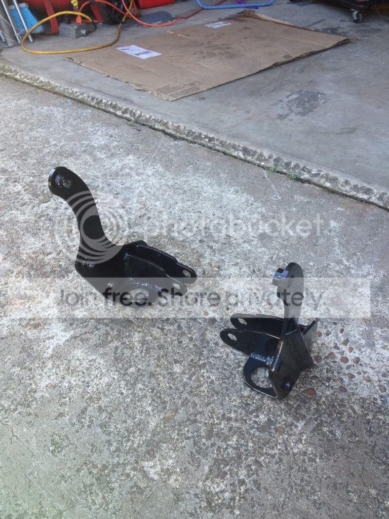

Every where there is an attachment point there is 1/4 angle hugging the frame rails to distribute the load. The cross bar is actually bolted to the frame, if you look at the pictures where the shock broke you can see the attachment points. So far I haven't found any signs of fatigue at all. It's been through some pretty stressful ordeals too! It's seen 7 track days, and 10 autox days this past year, I really beat on it to find the weak spots and I did find a few that I've corrected. I spent a lot of time early on dialing in the car and the rear end settings, I think its pretty good now. I'm gonna track it a lot more than autox this year and see how she holds up. Maybe paint next winter, I don't know every one likes it ratty.

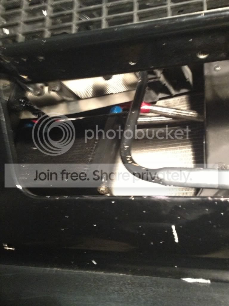

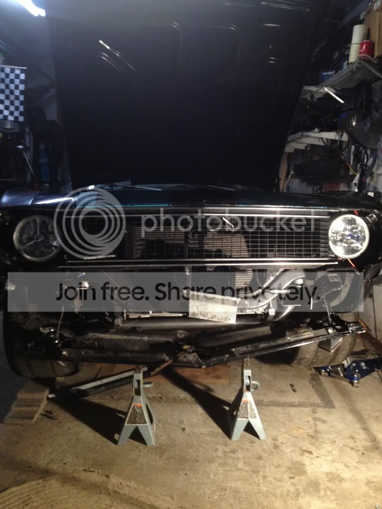

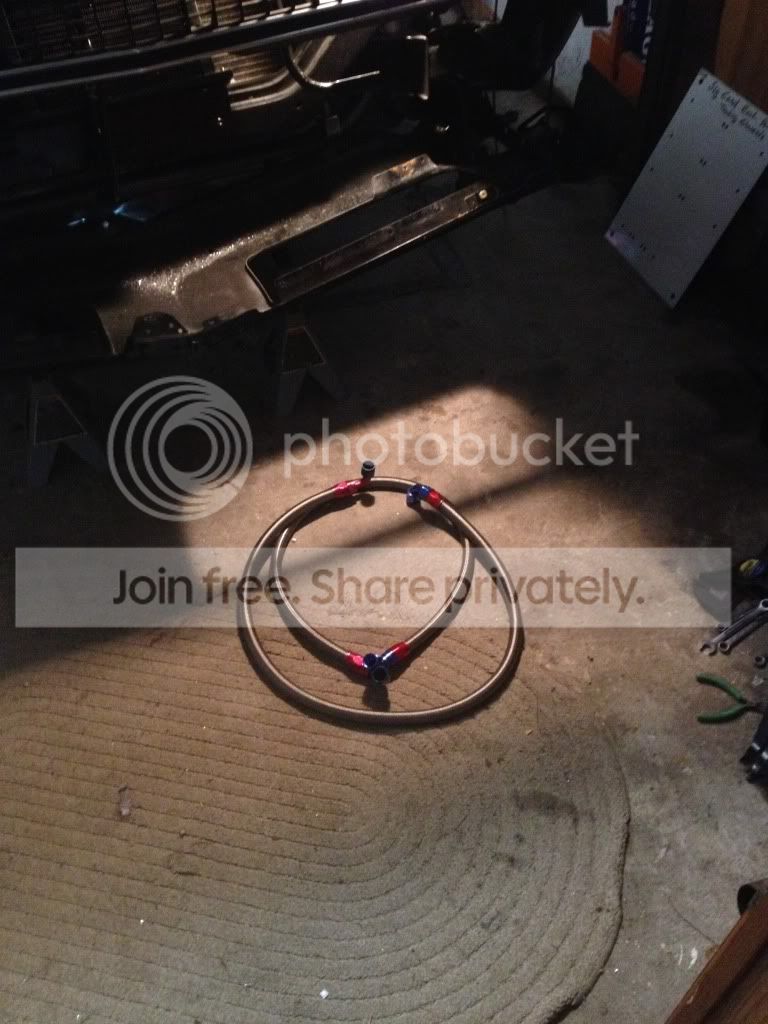

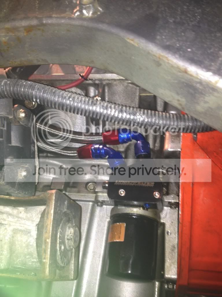

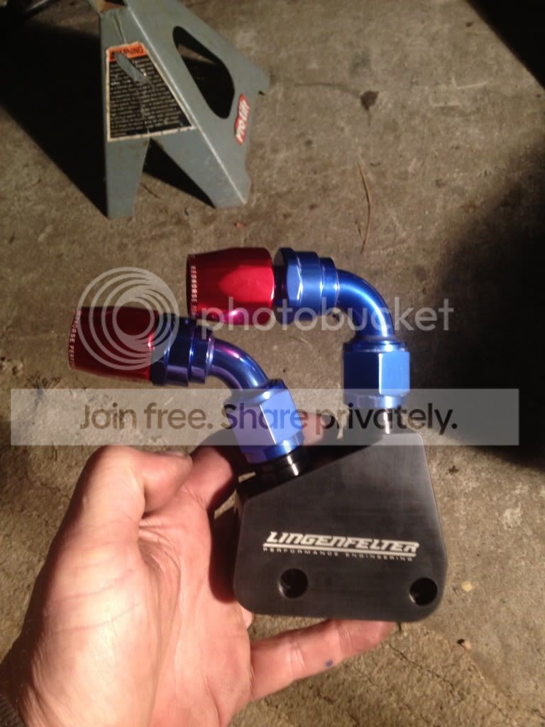

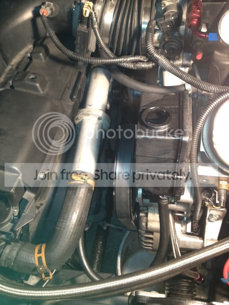

Time to be Cool! I scored this nice Setrab Oil cooler from one of my racer buddies for cheap and put in the Camaro this past week. It was kind of a pain as I had to remove most of the front end to be able to properly mount it. Bumper, lower valance, Spoiler ect. all had to come off, I also had to pull the drivers side header in order to have room to work to get the lines and adapter on. While at it, I decided to go ahead and install the 4th Gen Power steering cooler that I picked up for $50 online. With the big front tires, it's easy to overheat the PS fluid at an autoX, even with the TurnOne pump. Now It shouldn't be a problem. The season starts at VIR third weekend in March, I think I'm just about done with the winter projects. Seats and Belts are all done, I'll post pics of that when I can get the car outside and open the doors. Meanwhile, here's some crappy phone pics of the cooler installs.
http://i539.photobucket.com/albums/f...ps48ba0a47.jpg
http://i539.photobucket.com/albums/f...ps1d639011.jpg
http://i539.photobucket.com/albums/f...psd4167253.jpg
http://i539.photobucket.com/albums/f...ps5e93c940.jpg
http://i539.photobucket.com/albums/f...ps5f756fcd.jpg
http://i539.photobucket.com/albums/f...psfdf7ace9.jpg

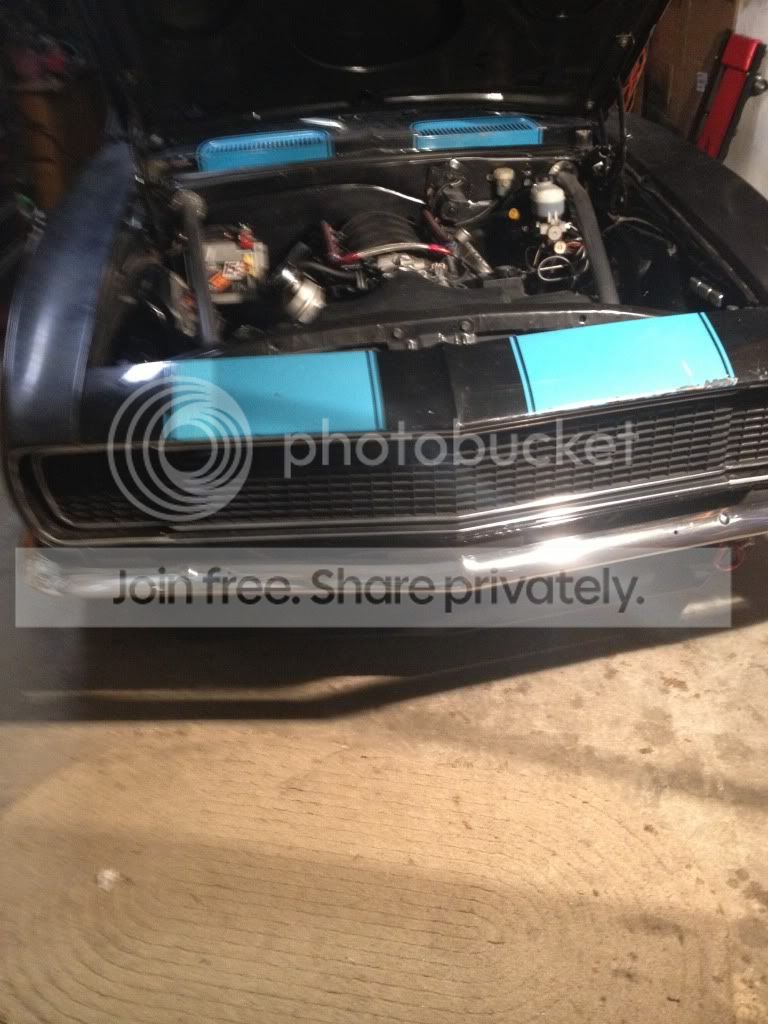

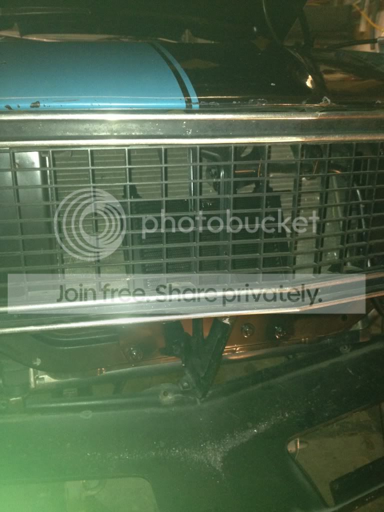

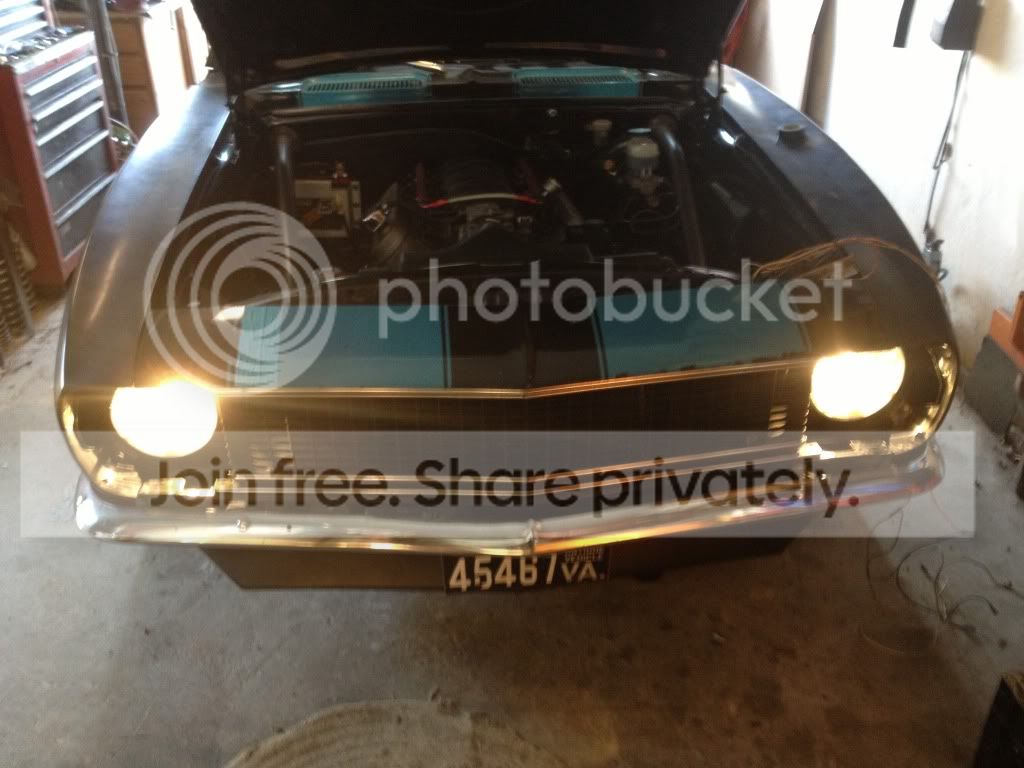

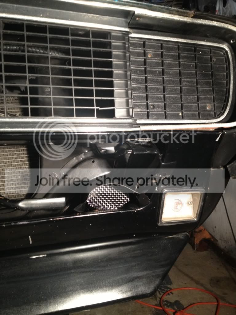

I put the rest of the front end of the car back together yesterday, I decided to put some screens in my brake ducts this time since I had them out. I started up the car and checked all the fluids and no leaks from the PS, Rad or Oil system so far. I was going to push the car outside so I could finish the install of my driver's seat, but we had another snowstorm yesterday! I can't get the door all the way open in my garage to really work on the seat like I should. Sorry about the crappy Cell phone pics, doesn't work too well when there is little light.
http://i539.photobucket.com/albums/f...ps384f27a0.jpg
http://i539.photobucket.com/albums/f...ps2b5cfd20.jpg
http://i539.photobucket.com/albums/f...psafcba066.jpg
Track Junky 03-04-2014 05:38 PM
Mills, didn't see you plumb an oil thermostat in. Probably a good idea unless you intend on taping your oil cooler off in the morning runs.
Beach Cruiser 03-05-2014 08:00 AM
Yeah, you're right. I thougt about plumbing one in and talked to a bunch of guys that run a cooler and none of them use them. I have a oil temp gauge and I'll pay attention to it to see what's going on, like you said I can always tape it off, it is a pretty good sized one. First event is VIR March 22-23, I think I'm just about ready. I got both seats in and my new belts all hooked up. Feels good to sit in the car again! Even it is just in the garage. Passengers side is on sliders and adjustable, My seat is fixed.

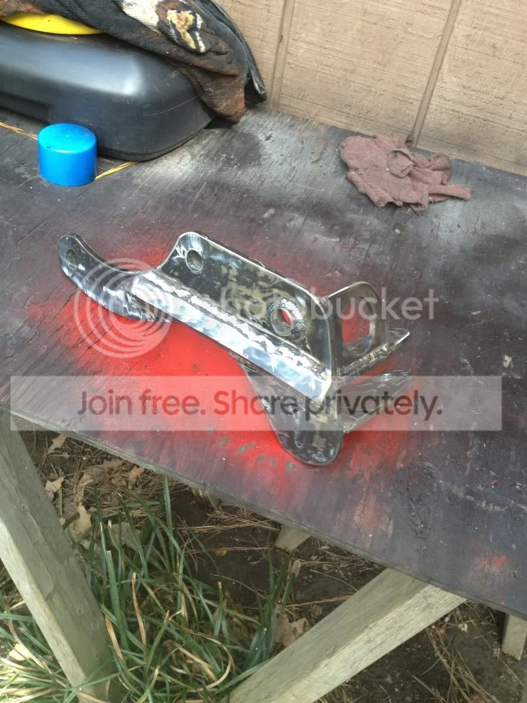

I had the car outside for a couple of days to finish up all the punchlist for VIR (much easier to work on outside). So I thought I would do a couple of things that have been on the bottom of the list for a long time. Decided to Beef up the rear Coilover mounts, and while I was at it, added some "supports" that also double as trailer tie downs. It's always been an issue finding a spot to tie down the rear, now the problem is solved!
http://i539.photobucket.com/albums/f...psd3c3f1a3.jpg
http://i539.photobucket.com/albums/f...pse6ecf2ba.jpg
http://i539.photobucket.com/albums/f...pse9abaa7a.jpg
http://i539.photobucket.com/albums/f...ps5445886a.jpg
http://i539.photobucket.com/albums/f...ps681b5a50.jpg

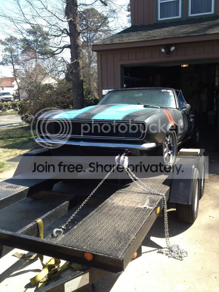

Unfortunally this is how I had to get it off the trailer to get it back in the garage.
http://i539.photobucket.com/albums/f...ps16790bc7.jpg

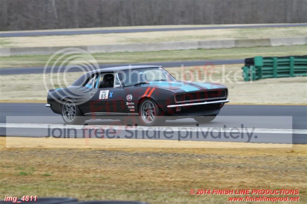

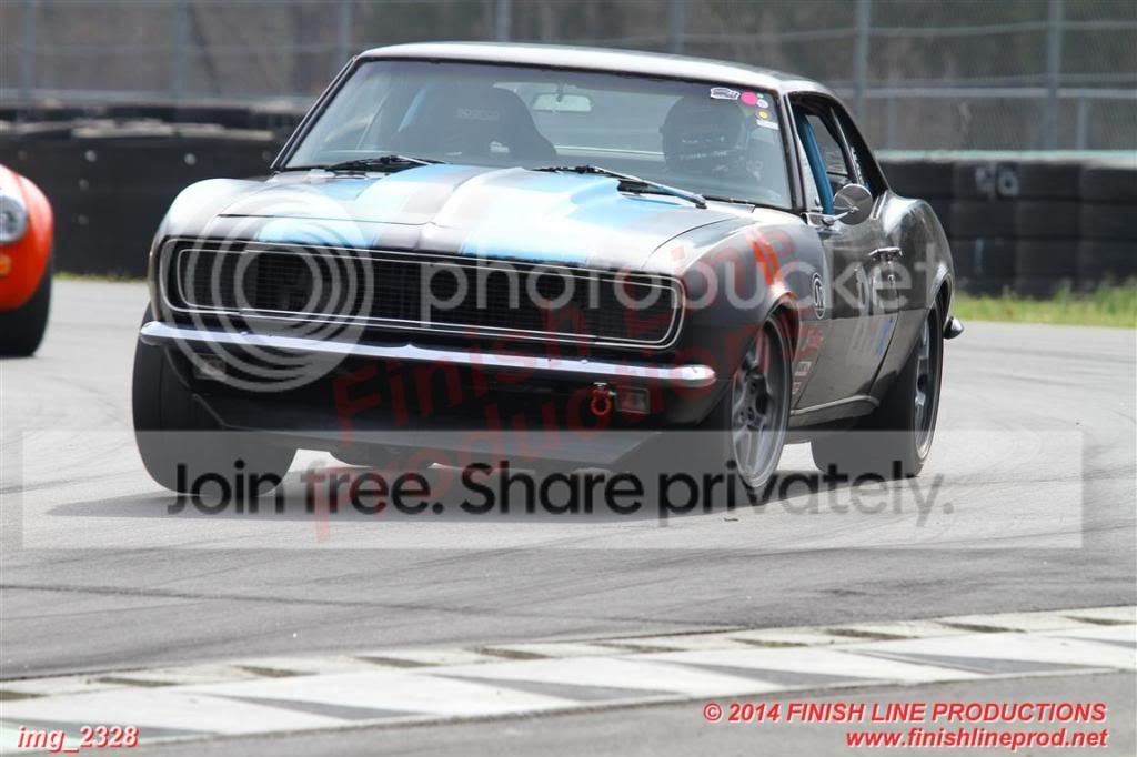

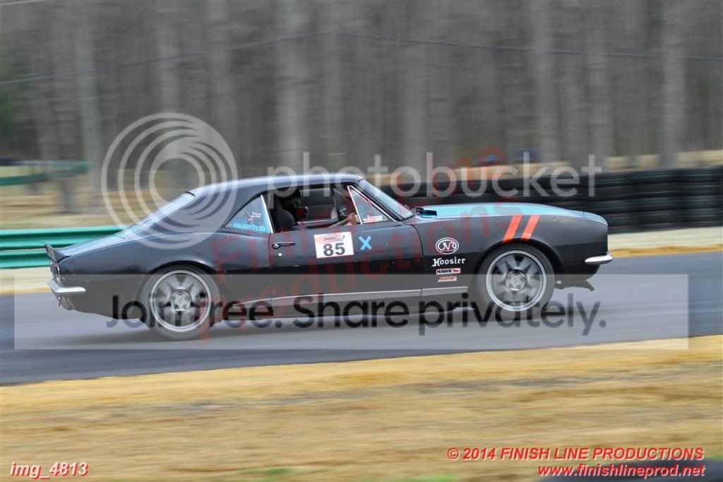

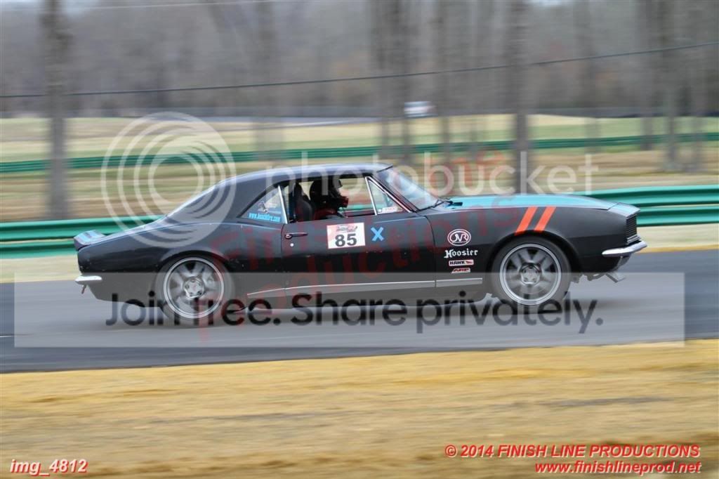

A couple of shots I pulled off the web from Finishline productions. Almost pulling a wheel coming around Oak Tree turn, the car has lots of roll in it despite a monster sway bar and heavy shocks up front, but it drives fantastic, just looks rolly polly.
http://i539.photobucket.com/albums/f...psdfef13ed.jpg
http://i539.photobucket.com/albums/f...psf2402005.jpg
And a couple between turns 3 and 4
http://i539.photobucket.com/albums/f...ps9bb9c0ed.jpg
http://i539.photobucket.com/albums/f...psfd87c12d.jpg
http://i539.photobucket.com/albums/f...ps366fc2bb.jpg
Payton King 03-26-2014 05:55 AM

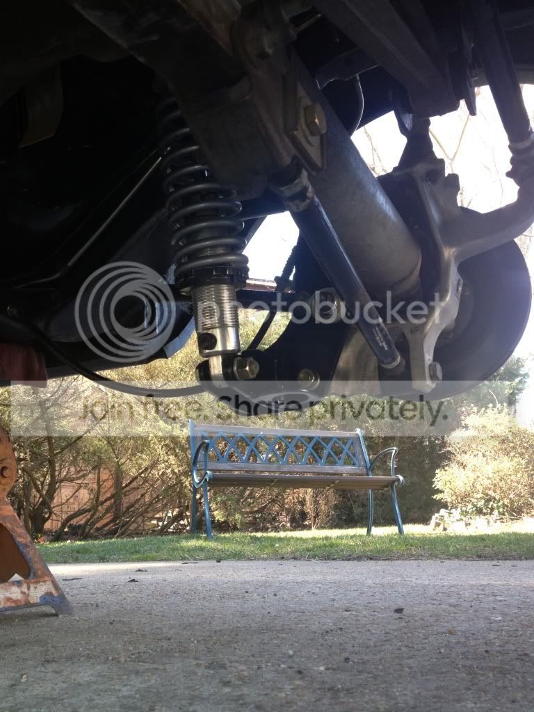

Shots look great Mills! What spring rates are you running front and rear?
Beach Cruiser 03-26-2014 06:51 AM
I want to say 550 or 600 on the front and 200 rear. I also have the stiffest hollow speedway motors bar up front.
Payton King 03-26-2014 08:49 AM
Looking at those photos it appears you need more spring in the rear for sure...it would help get the inside front down and helping with the corner grip.
Based on the Autocross and Road Race section of the Corvette Forum most are running spring rates in the rear very close to what is in the front on a 50/50 weight bias. Would thing at a minimum you would be at about 350 in the rear. With slicks, 700 f and 500 rear would not be out of the question.
What is the length, diameter and arm lengths of your front bar?
Beach Cruiser 03-26-2014 10:07 AM
I had stiffer springs in the rear and the car just wouldn't hook up, I don't have that problem anymore. the last three pictures are under hard acceleration (reference the rear tow hook) and the car never spins a tire. The first two pictures should have most of the weight planted on the front tires, just after braking and making the turn. I may be on the gas at corner exit at that point though, not sure.
Swaybar is 32" long .250 wall hollow and uses 12" arms For a rate of 482lbs
on a side note, I ran across the scales at VIR and the car weighs in at 3130 with a 1/2 tank of gas and me in the seat.

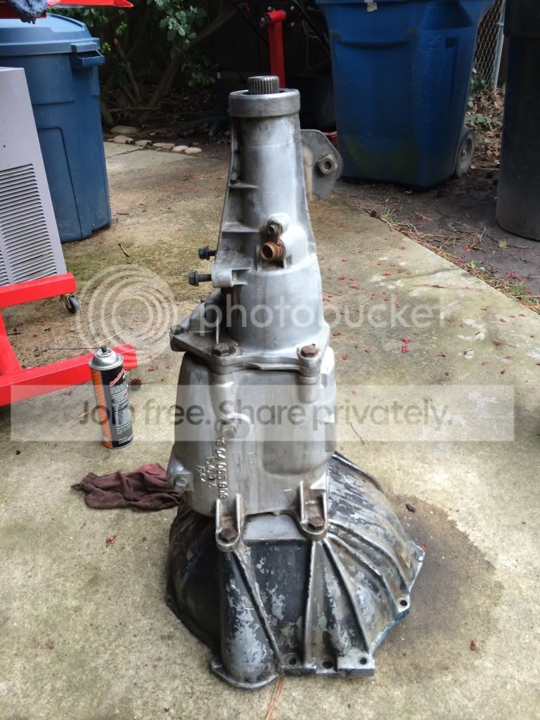

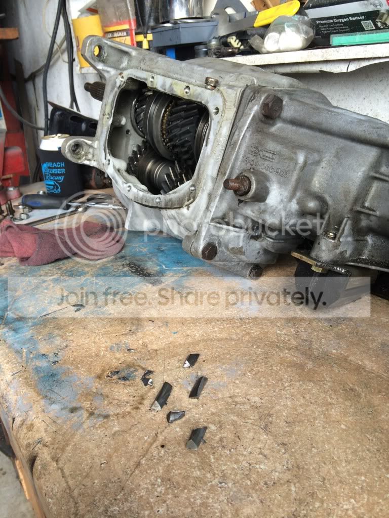

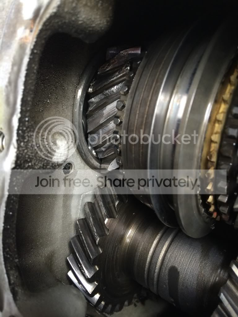

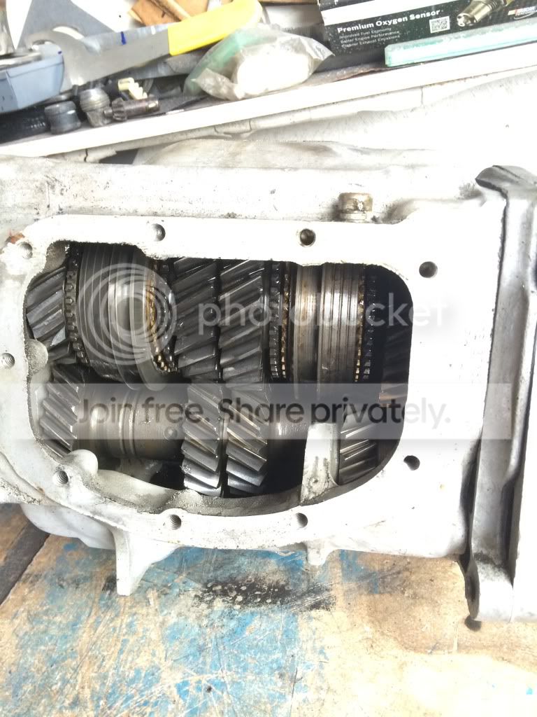

Got the trans out, lots of little pieces of the main drive gear in the case, this is what Ka Blewey looks like!
http://i539.photobucket.com/albums/f...psc99351ed.jpg
http://i539.photobucket.com/albums/f...psd820dee7.jpg
http://i539.photobucket.com/albums/f...psbd304a8a.jpg

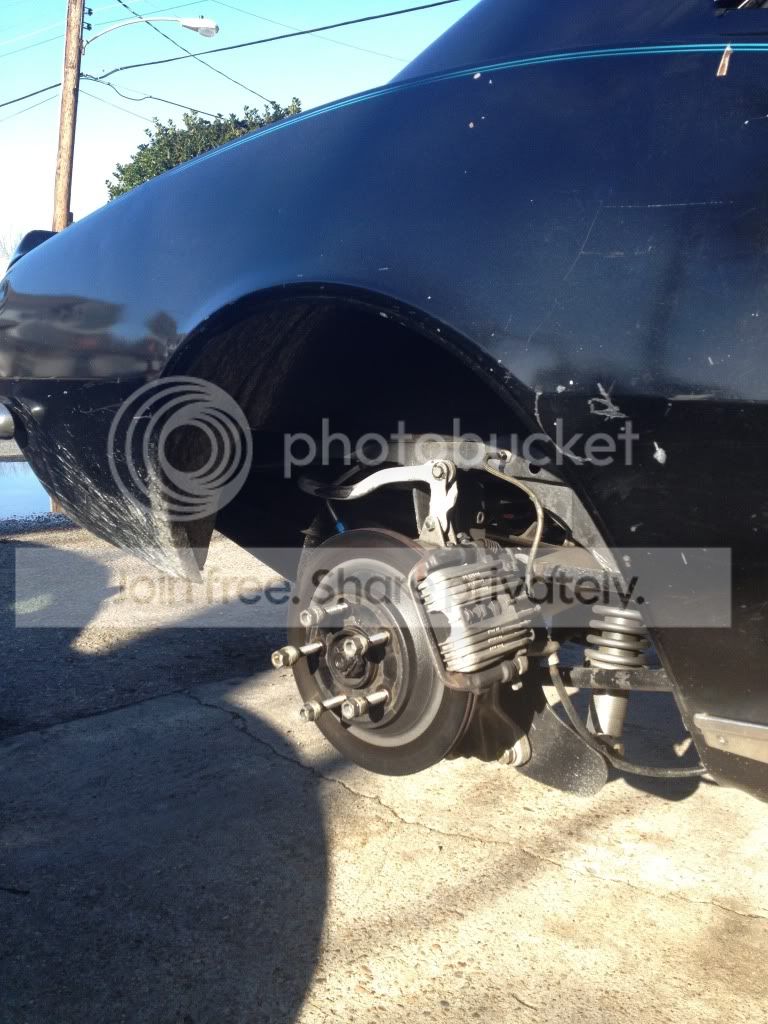

Trans is all swapped out and runs and shifts great! Best $150 ever! Also scored my last pair of Z06 rear wheels this week, and they showed up today! These are the best ones I think I've ever gotten, and they were the cheapest too! So now I have a complete set of 18's for the Hoosier Track tires and a complete set of 18's for some BFG Rivals so I can play in the Goodguys and new Classic American Muscle autoX class sand box. Both require a 200 TW rating, and my Kuhmos only were 180 and riding on 17's. No tires big enough for me in the 200 TW range that would fit 17's. May be selling the set of 4 Z06 (real ones) 17's sometime this summer if anyone is interested.
