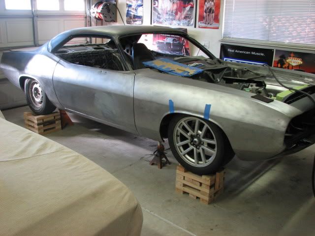

Also sound like your fender may be pushed in. Take a tape and measure from the fenderlip plumb bob to the frame rail and see what you get on both sides.
If that is the case i have the fender lip roller that you can use and instead of rolling the fender lip you can gently flare the fender back out. I did this on the bed of my truck and it worked great.
Originally Posted by DRJDVM's '69 (Post 237823)

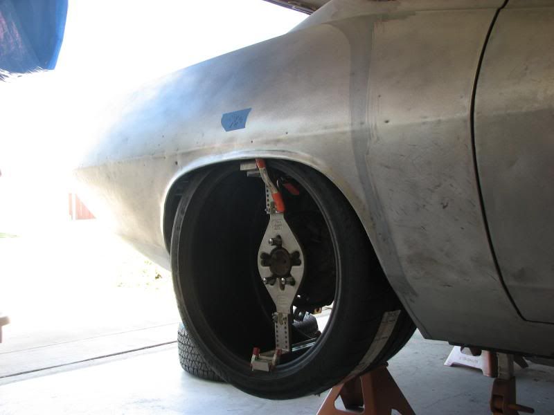

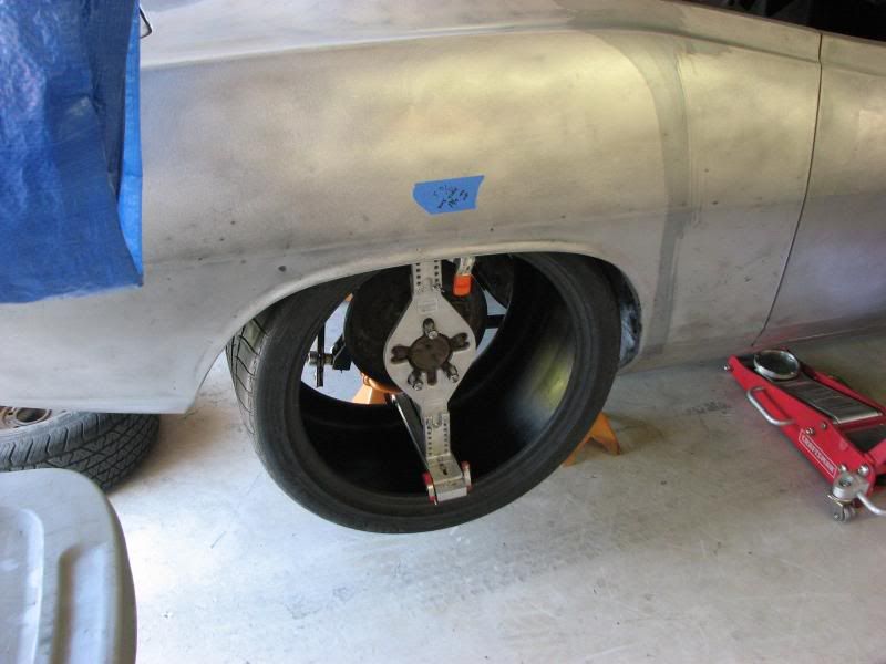

Since thats been all mounted up, I've been trying to measure for wheels....that has been a huge PITA.
I wanted to thank Marty (Syborg) for lending me his Mount Mate to help the job. I borrowed it back in late July (anticipating my brakes would arrive soon) and then we had all the brake delays and its been sitting in my garage unused.... thank you Marty for being so understanding on the delays. I'll have it back to you next week, I promise.....
I dropped a plum bob from the fender lip and measured to the hub on both side and it looks like my fender is about 1/2 inch pushed in on the driver side.
If I do more BS, then the Mount Mate hits the tie-rod at lock...plus I guess 6 BS is the most I can really do on an 8 inch rim anyway....so best I can figure is do the 19x9 with 6.5 BS, have a slighlty larger lip, and fix the driver side fender opening.....
I can go with a shorter hub and hat and move the track width in, but the caliper is the most "outboard" piece, so it wont do anything for my dish....so by doing the shorter hub, all I'm doing is changing the BS reading.... the mount pad gets thicker and the dish stays the same....
So decisions, decisions......
DRJDVM's '69 09-30-2009 02:15 PM
Thanks again Marty..
I've measured from just about every fixed point I can find to the fender lip and they are all about 1/2 off from side to side. If I sight down the fender, I'm pretty sure I can see it bow in just alittle. Plus on the Cuda there is a little flare just over the opening and if I put a straight edge from lip to body line it's pretty perpindicular on the "in" side and angles inward (body line above is inboard). The definition to this small "flare" is not nearly as crisp as on the "good side" either. Both are original fenders, but both have had some damage over the years
So I'm pretty sure its pushed in about 1/2 inch near the opening on the driver side.

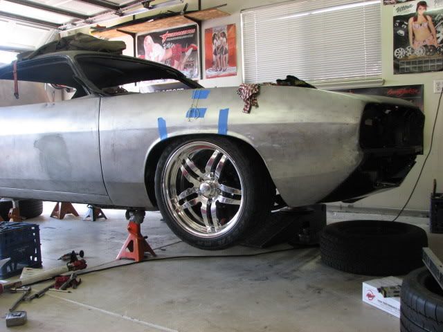

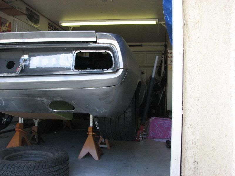

Today I started to mess with the rear tires.... I'm using my stock rearend just to get me in the ballpark for BS and see what I have to work with. The plan is to get the rims and tires and then measure and order a custom Dana 60. Right now I just want to see where I stand......
http://i229.photobucket.com/albums/e...I/IMG_3933.jpg
http://i229.photobucket.com/albums/e...I/IMG_3934.jpg
http://i229.photobucket.com/albums/e...I/IMG_3938.jpg
This is the passenger side lip clearence right now... the tire is alittle crooked in the pix..... I havent done any trimming or rolling of the fender lip yet, but that is the plan for sure. I should be able to move the rim out just a tad more and still have fender clearence and enough space up top to sink the tire up into the wheelwell when its aired out..... I have about 3/4 inch of clearence on the inside right now...so probably move it out about 1/4 inch and I should be perfect.
http://i229.photobucket.com/albums/e...I/IMG_3936.jpg

elitecustombody 10-02-2009 08:38 AM

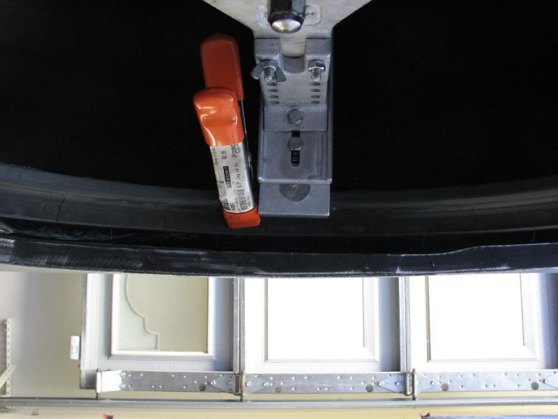

Ned, if you don't mind me asking,where did you get that wheel/tire tool?I must have one. BTW, great progress on your Cuda, I wish I was at that stage with my 71
DRJDVM's '69 10-02-2009 09:01 AM
I actually borrowed it from a fellow Lateral-g member, but you can buy them from
http://www.wheelworksinc.com/mountmate.html
http://www.autowaretech.com/mountmate/
It looks like a great investment if you do alot of wheels and tires etc
Percy's also make a more generic version that doesnt actualy use a real tire.....
http://www.jegs.com/i/Percys/760/01201/10002/-1
elitecustombody 10-02-2009 03:51 PM
Awsome, it's good to have one of theese,I could've used it so many times. Thanks again.

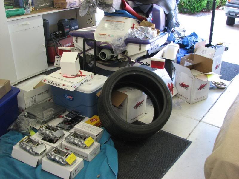

Time for some new pix.....

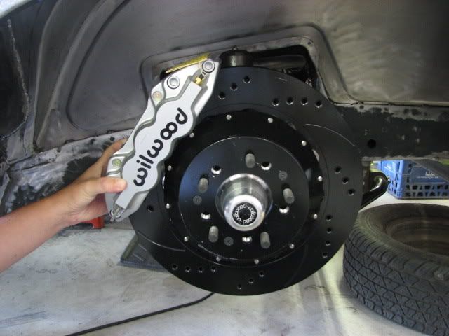

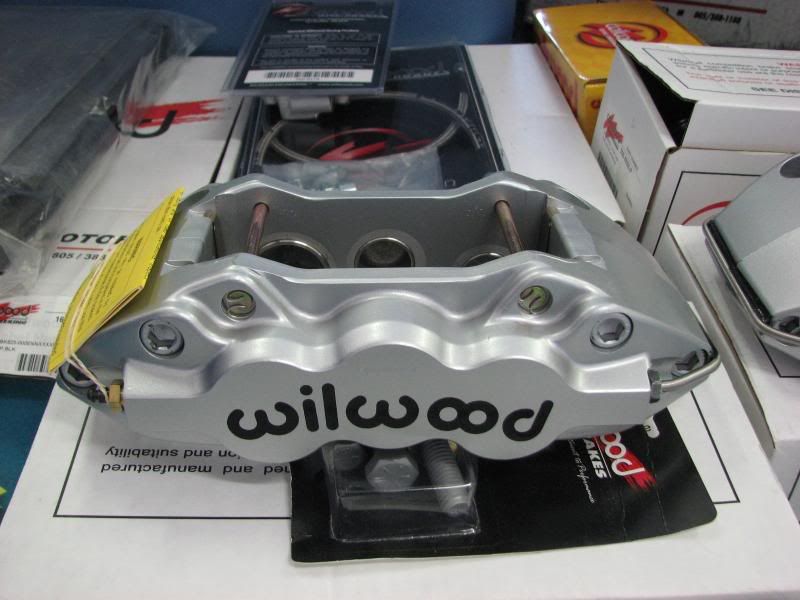

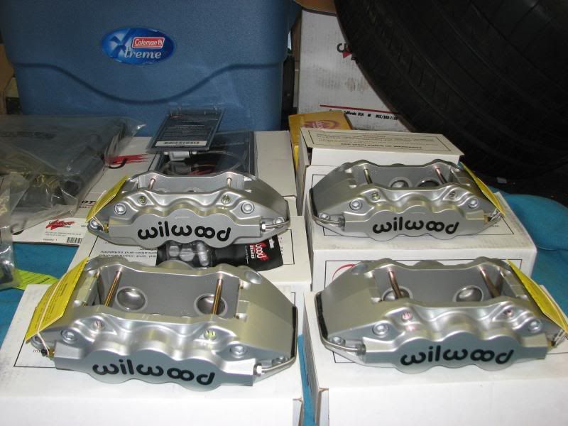

Well it was a Wilwood Xmas again !!!! Last time I just got my hubs, hats, rotors etc..... my caliper came alittle later. They are fricking awesome....and huge !!!! They are the W6A 6 piston with the optional silver color.
http://i229.photobucket.com/albums/e...I/IMG_3978.jpg
http://i229.photobucket.com/albums/e...I/IMG_3977.jpg
http://i229.photobucket.com/albums/e...I/IMG_3975.jpg
http://i229.photobucket.com/albums/e...I/IMG_3980.jpg
Wilwood still needs to make the caliper mounts for my application on the front. I dont have my Dana 60 yet for the rear, so I cant mount the rear stuff yet since the mock up rearend is way different.

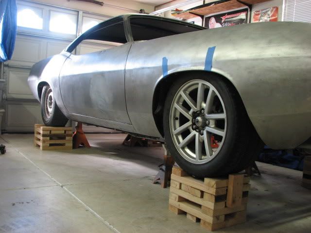

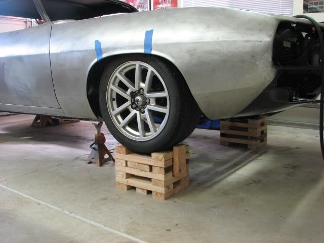

Once I finalized my brake combo I went back to the wheel fitment check...man was that a huge PITA..... I changed hubs and hats a couple of time to get a decent track width and try and get some dish to the rim etc etc....so it was a ton of changing back and forth and measuring over and over. So I'm glad thats over. The rear was much easier since I'm having a rearend made to specs..... the front was much harder since it all turns etc. I only hope I made the right choices with the wheel BS etc...time will tell....
I used my Camaro rims as a trial just to see if a real rim/tire fit okay and check the BS one more time. I used Marty's Mount Mate to do most of the measuring but it never hurts to have an actual rim on there.
http://i229.photobucket.com/albums/e...I/IMG_3994.jpg
Then I went ahead and made some wheel stands. I had some wood lying around and I will need them for the rearend measuring etc so I spent a couple of hours ( is that better Greg?) making these... those are my old mock up wheels for now.
http://i229.photobucket.com/albums/e...I/IMG_3997.jpg
http://i229.photobucket.com/albums/e...I/IMG_4000.jpg
http://i229.photobucket.com/albums/e...I/IMG_4001.jpg

Nice brakes!! I like the finish!! :thumbsup:

Silver calipers look great.....didn't know that was an option for Wilwood

Ned those calipers look great
I like how you got Kyle to hold the caliper on there
"Hurry up Dad! Take the picture! I can't hold this thing!"
You should have come over and got the framing nailer then you could have made those four stands in 15 min
GregWeld 10-26-2009 05:22 PM
Rob -- I was thinking the same exact thing -- as in "how could it take a "day" to build some 2X4 crates"???
Then I remembered --- it was NED.... and he studied it for a couple hours trying to figure out how to make it just a bit more complicated... :willy: :willy: :rofl:

It didnt take me all day....considering who I was talking to I should have been more specific.:willy: ..it took 6.265 hours on a late Sat afternoon....while it was raining outside....it was 55 degress at the time. After I did a CAD drawing and did some structural strength testing I made them by hand using a hand crafted and laser etched ceramic blade I had imported from Japan and stainless steel screws imported from Norway.......:D Better ?
Geez......it only took me about 2 hours.... the only "back and forth" I did was how high to make them.
As for the caliper finnish....... I dont think it will be any worse than keeping the red calipers clean...or the wheels for that matter. My BAER calipers are that dull rough gray color and they dont get covered in brake dust at all. Nothing alittle wheel cleaner and a hose wont wash off.
And thats Monet's hand holding the caliper.....no way I would trust Kyle to hold them up :) They arent exactly lite......
