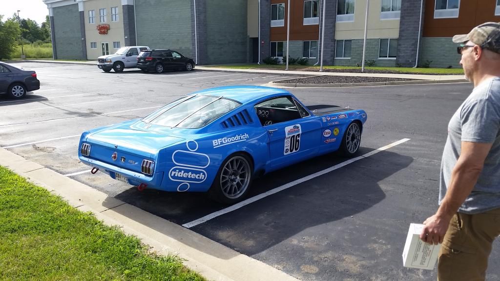

65_LS1_T56 07-24-2014 07:03 AM
Muttstang sitting in MI
http://i1207.photobucket.com/albums/...pspxur2rsz.jpg

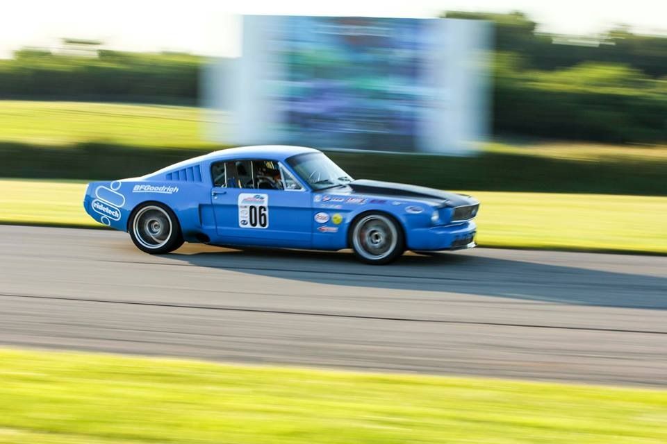

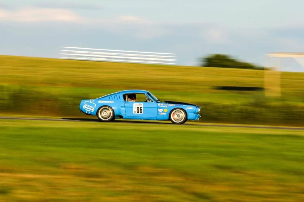

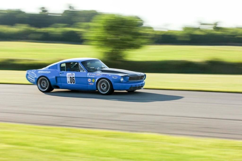

Flash68 07-28-2014 10:31 AM
she looks bad azz at speed.
http://i236.photobucket.com/albums/f...pssmfslbw1.jpg
http://i236.photobucket.com/albums/f...psxttloab0.jpg
http://i236.photobucket.com/albums/f...psj95rkuho.jpg
