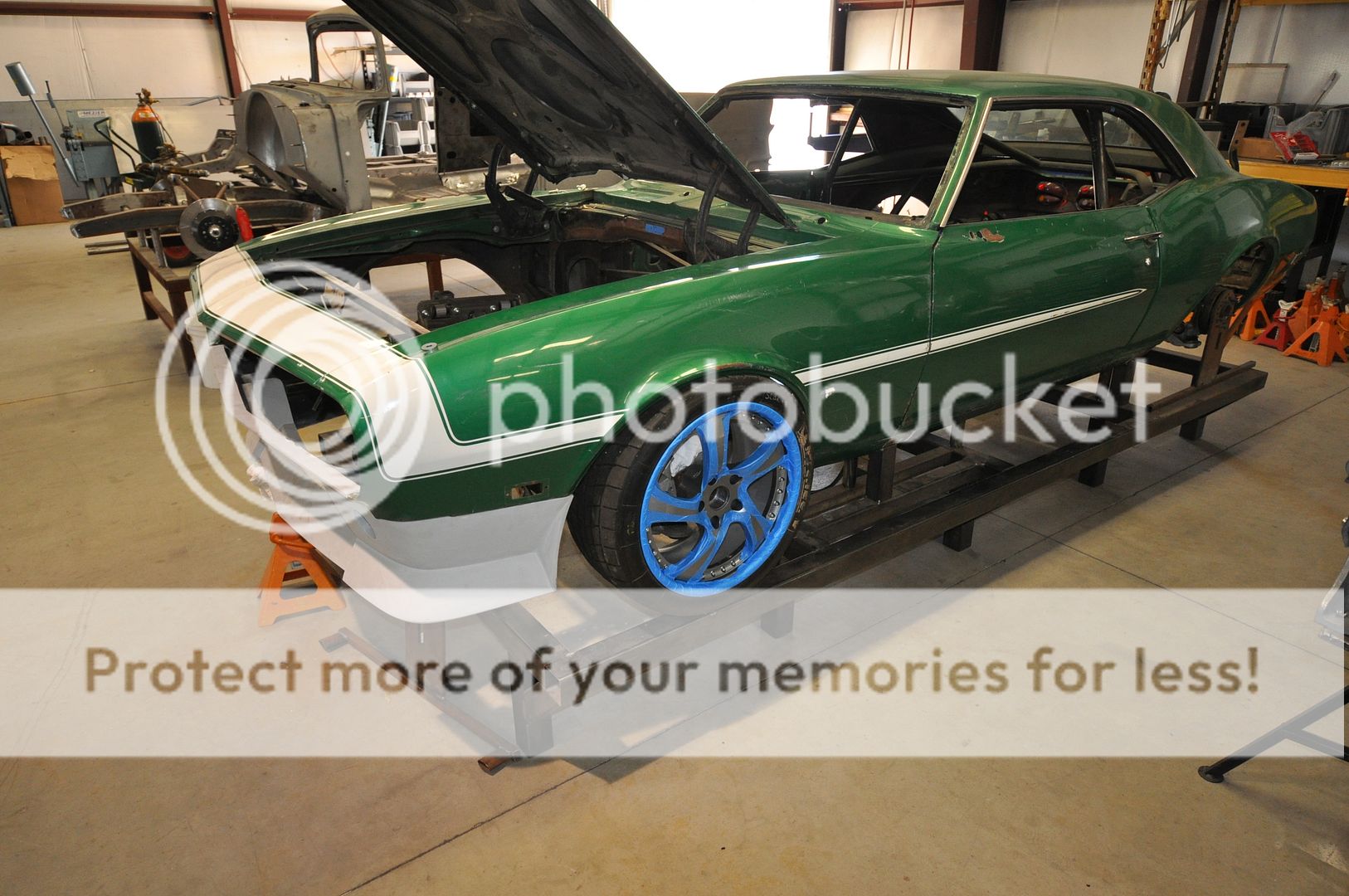

Teetoe_Jones 07-29-2010 05:14 PM
These guys work fast. Already aligned the entire front end and installed the hood. Usually takes me a few days to get gaps that good.
http://i26.tinypic.com/w8kymg.jpg
http://i28.tinypic.com/2hxwxn8.jpg
That's all for today.
Tyler

Teetoe_Jones 07-30-2010 05:05 PM
Update for the weekend:
Floors are coming along very nicely.
http://i28.tinypic.com/fs3t0.jpg
http://i27.tinypic.com/2jfix4j.jpg
Wheel test fit:
Inside drivers front:
http://i32.tinypic.com/2d9xr2c.jpg
Front view; looks like I'll be doing a wide body front and rear 68 body now:
http://i28.tinypic.com/30a8ia0.jpg
Drivers side shot at ride height:
http://i25.tinypic.com/utsee.jpg
Can't wait to see the 3/4 shot with both front and rear wheels, even if they stick out past the sheetmetal.
Have a good weekend boys.
Tyler

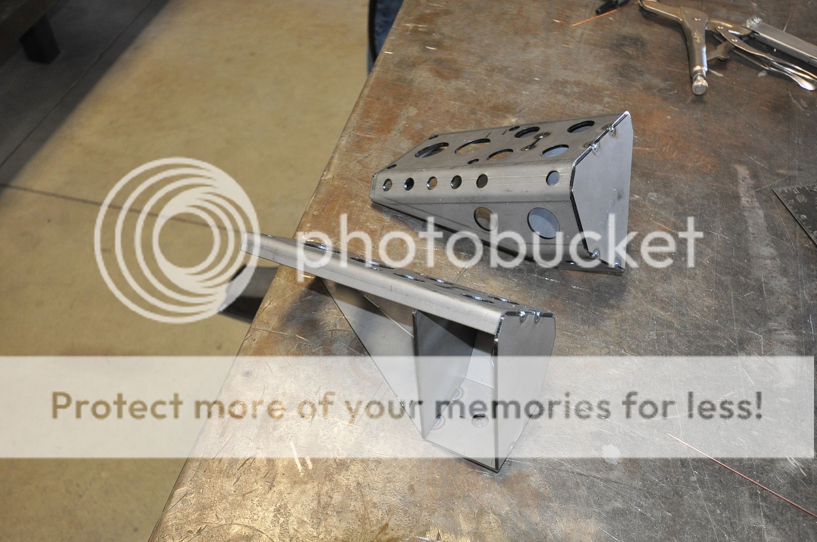

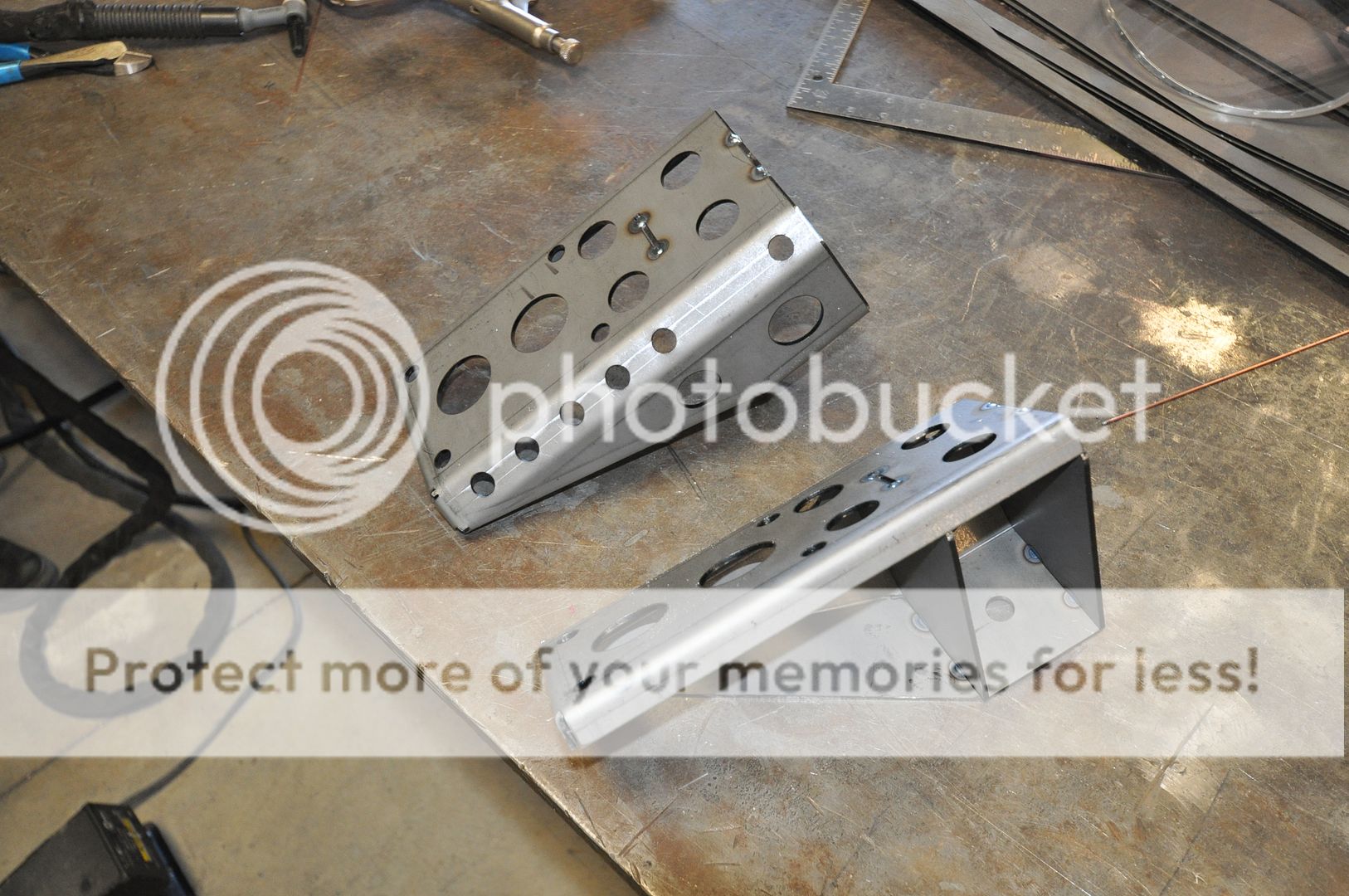

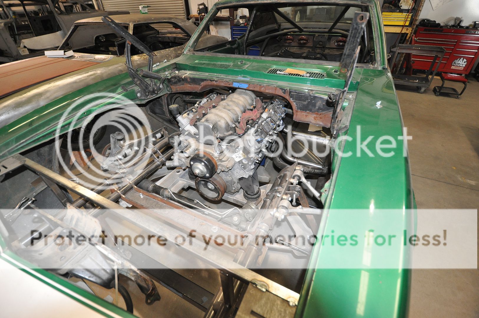

Teetoe_Jones 09-14-2010 09:34 PM
So I was gone most of August and half of September in Europe; London, Amsterdam, Prague, Paris, and Rome. Rodger did get a few things rolling when they had time.
They did the front A pillar down tubes of the cage, mounted the Tilton pedals, fab'd new engine mounts to set the engine back for use of my Sidewinder accessory drive, re-made the torque tube, and re-installed the drivetrain.
I only have a few pics, and they don't show much, but an update is an update.
Checking HRE wheel clearance.
http://i616.photobucket.com/albums/t...uly2010001.jpg
New laser cut engine mounts
http://i616.photobucket.com/albums/t...ust2010038.jpg
Same thing, different angle
http://i616.photobucket.com/albums/t...ust2010039.jpg
Engine setback is now very much into the firewall, and at least 2 inches behind the front axle centerline
http://i616.photobucket.com/albums/t...ust2010028.jpg
Torque tube all installed
http://i616.photobucket.com/albums/t...ust2010029.jpg
Tyler

68RS350 09-15-2010 04:57 AM
How much is the engine recessed back in the firewall? Also how much clearance is there between the outside of the torque tube and the inside of the tunnel? Im doing the same thing in my 68 and havent decide on how much clearance I was going to give.
Tyler

Engine is set back very deep into the firewall at this point; I'm guessing 7-8 inches but it's hard to tell with the new fisheye lens my boy picked up.
http://i616.photobucket.com/albums/t...ber2010061.jpg
Sweet. Tilton pedals are mounted. Now I need to get off my ass an choose a Sparco seat, get a steering column, and wheel to get me all set up.
http://i616.photobucket.com/albums/t...ber2010062.jpg
A pillar bars again.
http://i616.photobucket.com/albums/t...ber2010063.jpg
Tyler

ironworks 09-16-2010 09:32 AM
The engine is 3.5" back from stock. The torque tube is stock length and there is room to run Tyler's Sidewinder system on the front of the engine now.
We plan to relocate the firewall back.

Nope.
Factory cradles, yes. Engine placement is further rearward than factory. Those laser cut mounts shown moved it 2 inches further back (maybe more) to allow for my Sidewinder accessory drive and so I could use a factory length torque tube.
Tyler
