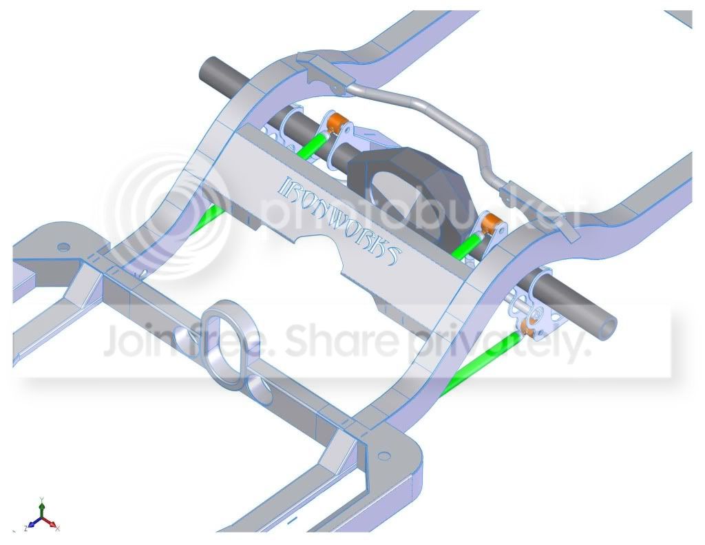

Originally Posted by kennyd (Post 322941)
please reverse the ironworks logo ! so when the car is assembled the logo is correct !
Originally Posted by 96z28ss (Post 322943)
yep so it can be read when the car is on a lift.
Come on get with it Rookie.
Should I back-light it too???!?!???!!!!..... some nice neon-blue perhaps.
--Eric

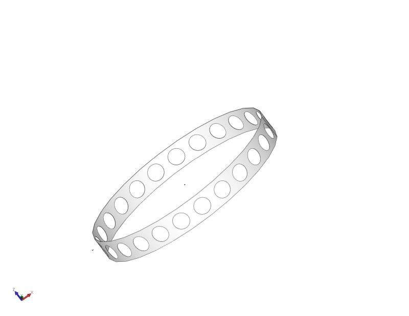

Originally Posted by ironworks (Post 322912)
Here is another Table I'm working on for another customer. The top section will also be dimple died around the up right of the C channel. But putting that in Solidworks to be cut 2D is beyond me. If you do it when the plate is flat it is gravy.
http://i616.photobucket.com/albums/t...speed/Desk.jpg
send me the file. I'll put dimple die hole in it for you.

is this what your talking about Rodger.
you don't know how to get dimple dies around the contour?
Maybe a quick lesson in February, when i come down for RTTC.
ironworks 12-21-2010 11:48 AM
But can you flatten it into a sheetmetal pattern to be laser cut.

96z28ss 12-21-2010 01:37 PM
The easiest way for you to do it is to add all the arc lengths from the edge.
Then calculate how many dimples you want in it. With the spacing then figured out, then design it in the flat.
There is a module for the CAD system I use, to take bent up sheetmetal and flatten it for pattern making but I don't have it. Its alot of $$$
ironworks 12-21-2010 01:45 PM
Yeah that lower grade program we use has it, But it will not carry a feature designed after you flatten the part back into the part when you fold it. So I just put the holes in it when its flat and pretend until my vision is complete in metal. Eric and I are just getting slick with what can be done with the sheetmetal feature in Solidworks. We took want would be a few days labor out of that Chevelle chassis with that program.
96z28ss 12-21-2010 02:31 PM
yeah thats cool.
I have a sheetmetal module on my system but they charge extra for the forming/flatening module. It allows you to design in the flat and bend it, or design it then flatten it.
Keep playing with it you'll get better.

Precision Metal 01-24-2011 06:32 PM
"Yeah that lower grade program we use has it, But it will not carry a feature designed after you flatten the part back into the part when you fold it. So I just put the holes in it when its flat and pretend until my vision is complete in metal. Eric and I are just getting slick with what can be done with the sheetmetal feature in Solidworks. We took want would be a few days labor out of that Chevelle chassis with that program"
Great Stuff Roger, CAD tip, Use the unfold and fold feature in the sheet metal tool bar instaed of the flat pattern in the feature tree. This way you can unfold the part make your modifications, fold it back up and it will show up in the bent part. In Solidworks at least the flat pattern must remain at the bottom of the feature tree.

ironworks 01-25-2011 06:56 AM
BTW did you ever do any thing with that ls7 manifold?
See ya, Jeff
Hay Jeff. I use the fold and Unfold. But it is tough to put holes in part that is on a radius. So I just put them in after its flat to get what I want. Sure it lacks on a PDF drawing. But I'm not building drawings.
The project with you manifold is getting posted today. It is the Test car project. Bu I might build a stock one first. Just to show the easy stuff, Not as much fun for me but better for business.

ccracin 01-25-2011 09:31 AM
Are you going to dimple it before or after forming? Are you just trying to get the holes laser cut first so that all you have to do is dimple it after it is formed?
ironworks 01-25-2011 10:29 AM
I'm just trying to get the holes in a radius. Which is difficult to do in general since there is no flat surface to draw on. I have a system to make it happen. It just does not look good in a rendering.
ccracin 01-25-2011 11:44 AM
It works if all you want is the holes!
http://i140.photobucket.com/albums/r...tmetalPart.jpg
http://i140.photobucket.com/albums/r...tal-Sheet1.jpg
