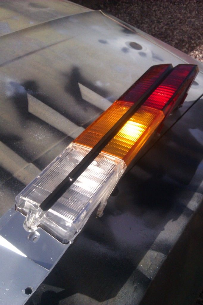

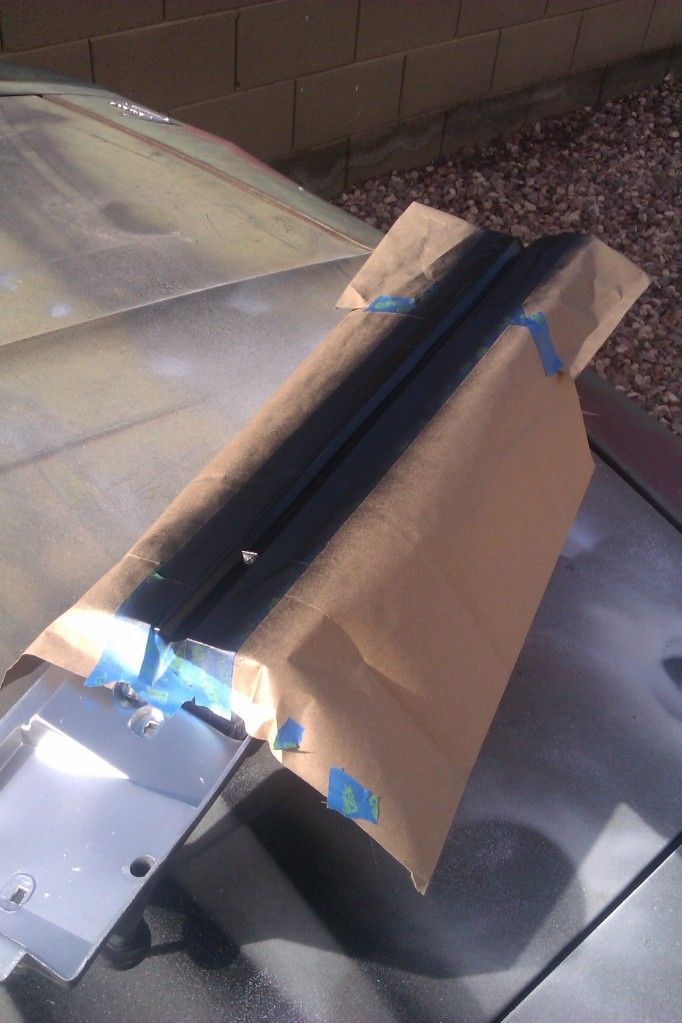

painted the Z-28 stripe on the new tail lenses

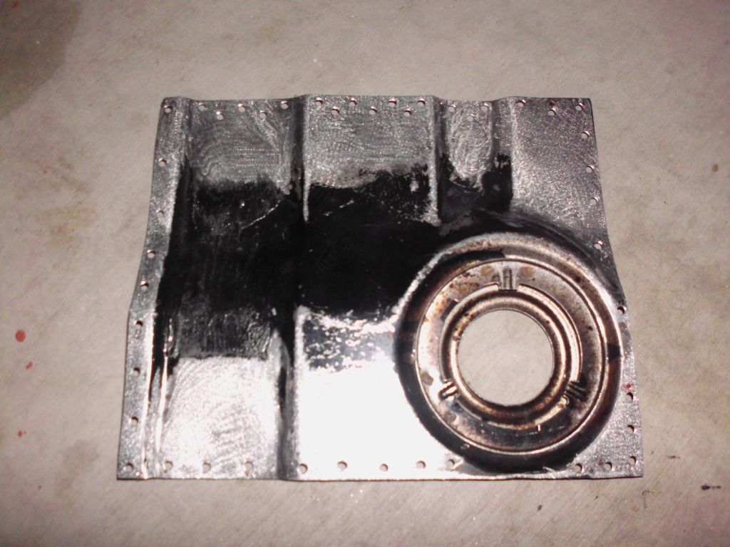

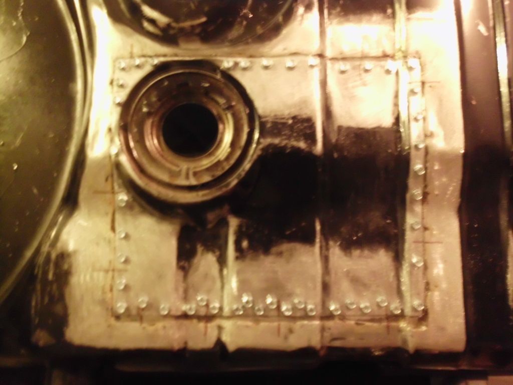

67goatman455 12-29-2012 01:21 PM
was that the fuel pump "sump" in the pictures of the gas tank? i dont see how fuel could get into the box:question:
70TWO NOVA 12-29-2012 01:26 PM
you cant see in the pictures, but there are 3/8" holes drilled into the bottom of the sides of the sump to allow fuel in and out but keeps forward and rearward sloshing from letting the pump run dry.

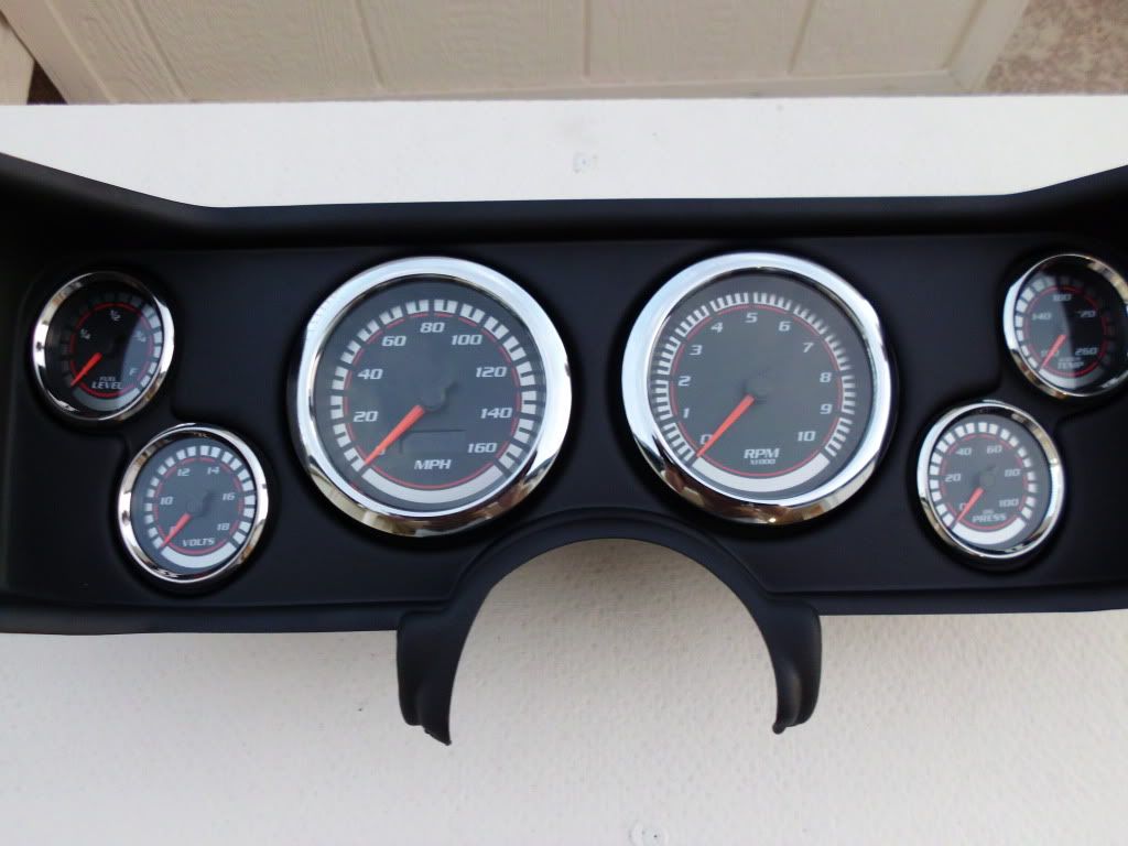

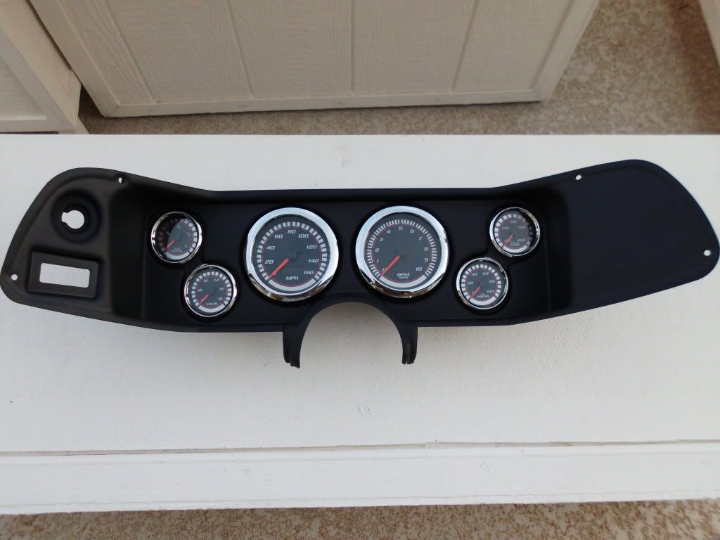

thanks. Got the New Vintage gauges in last week. These are pretty cool, they have white or red back lighting, peak recall and custom high/low level warnings.
http://i270.photobucket.com/albums/j...HPIM0001-3.jpg
http://i270.photobucket.com/albums/j...HPIM0002-3.jpg
Cool- I like how you've switched the dash to the (better looking, IMO) 70-78 style dash/ IP.

Got the inlet tube soldered in and the pump wires run through the bulkhead. also had to alter the fuel pump sender to fit correctly into the baffle. Now I just need to find a good fuel resistant sealer to seal it all up.
http://i270.photobucket.com/albums/j.../gastank14.jpg
http://i270.photobucket.com/albums/j.../gastank13.jpg
WSSix 01-06-2013 06:54 AM
You've got a grommet on those wires running through the metal, right? I'd redo that set up even if you do have a grommet on the wires. Way too risky being right there with the fuel vapors. They make bulkheads with threads on both side and with a rubber seal. That's the way you need to go about wiring the fuel pump. The ground can just connect to the fuel tank itself or run another bulkhead and run the wire to the frame near by.
70TWO NOVA 01-06-2013 12:56 PM
I was wanting to run those bulkhead connectors for the pump wiring but I could not find anything. I even posted up a thread on here but nobody could help me find anything. If you happen to know where I could get them Id really appreciate the info. Thats really how I wanted to do this in the first place.
WSSix 01-06-2013 03:24 PM
Now that you mention it, I remember that thread. I have no idea where to get something like that though. Maybe McMaster Carr? You might be able to make it using a small grommet that'll let a bolt bass through. You'd have to seal the bolt to the grommet though. Maybe use the sealant you'll use on the tank cover. Use washers on either side of the grommet and it should seal together when tightened down.
