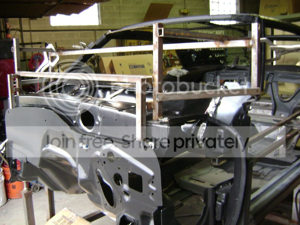

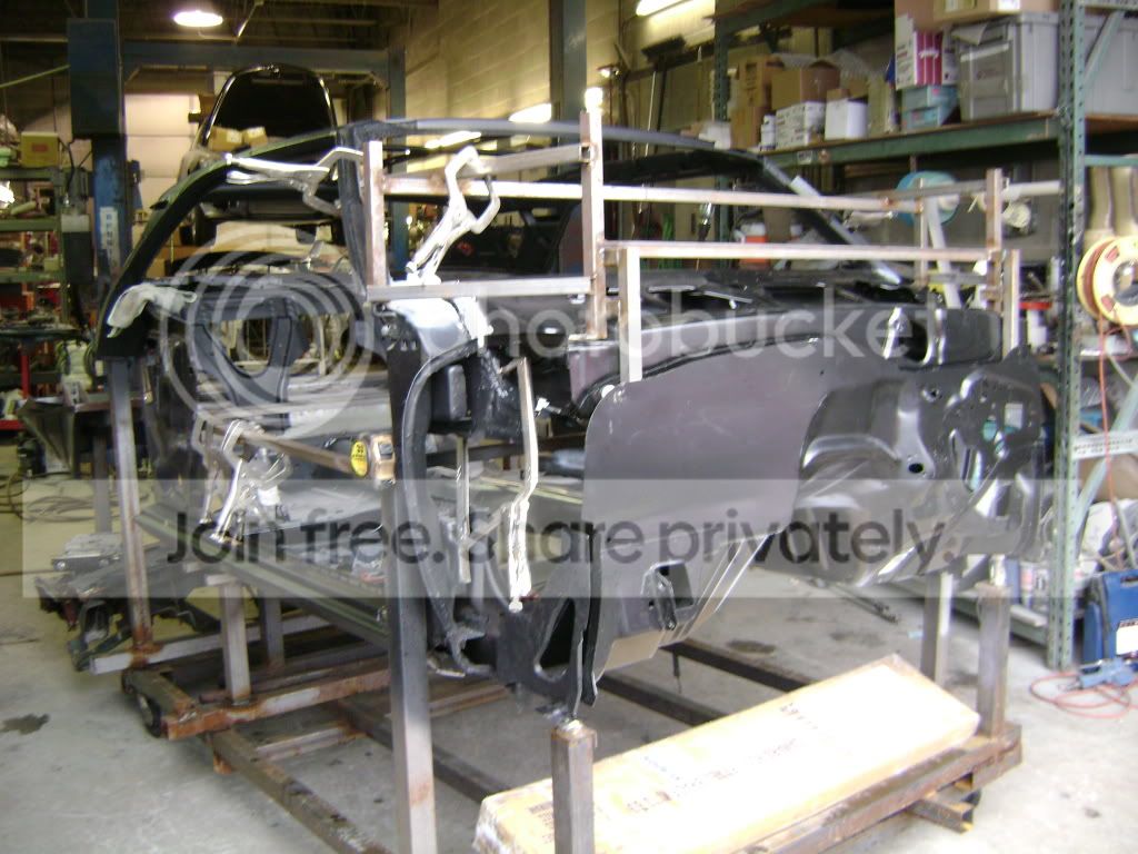

Rockers are finally done:willy: The upper cowl and firewall are fitted and ready to weld, just have to do some minor repair work on a piece I cut off that I should of stayed with the original cowl section.It's starting to some what look like a car again!! Off to SEMA back on it this weekend..

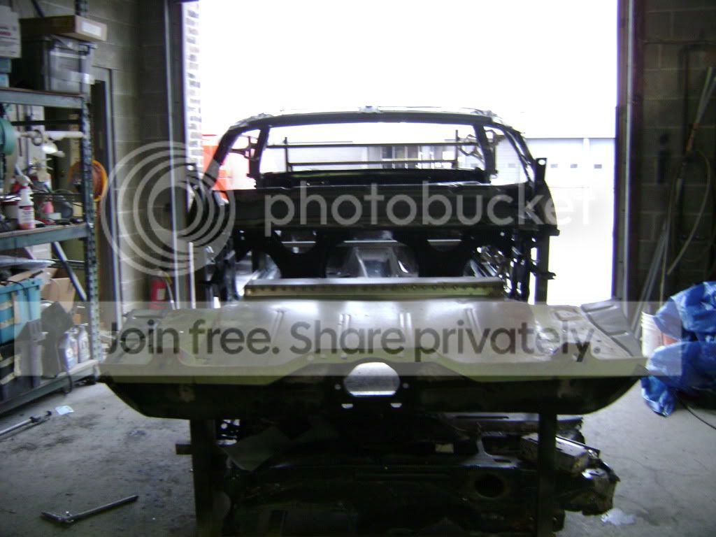

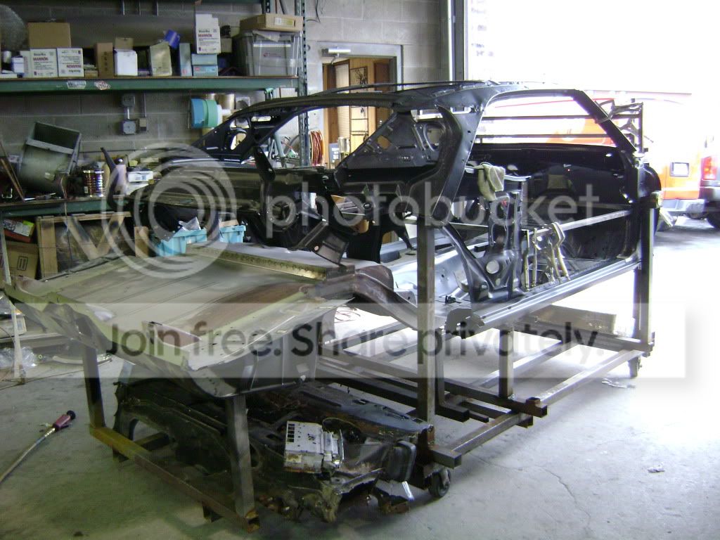

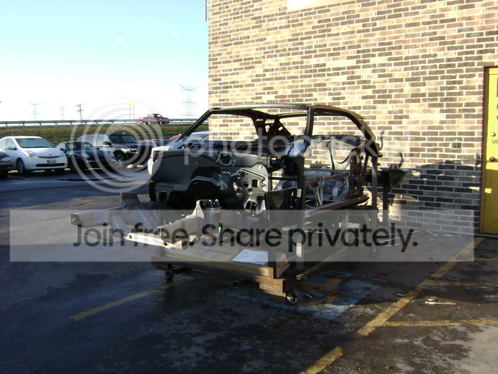

The floors in !!!!:willy: Not welded in yet, I have it set in so I can make sure the sub frame mounts are in the correct location. I have a couple of issues I have to tend to, the right side of the toe board is coming up short on the right rocker . And it seams that the floor is coming up short to the toe board so I might have to do some pulling and stretching to get this thing to fit!!

Mario- looking good! Im looking forward to seeing the monster wheelhouses your putting in there, you did go with Mikes 4.5" set back rails? :thumbsup:

Sure did Rich ! Just pulled them out to see just how big they are WOW !!!!:faint:

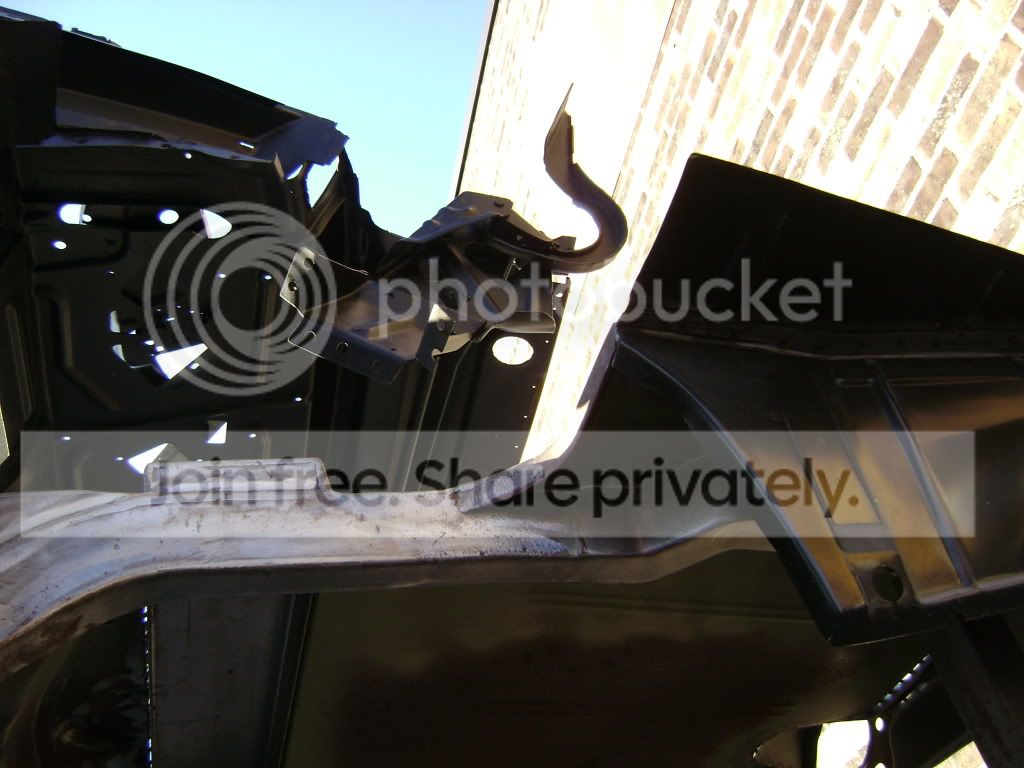

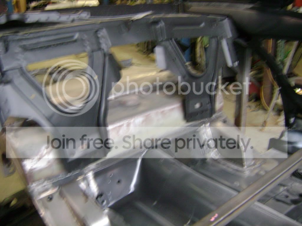

Set the subframe in Sunday just to make sure the mounting points were in the correct locations. It was right on the money!! Now I can finish welding the firewall and floor .... You will here this alot from me on this build,''THIS AFTERMARKET SHEETMETAL SUXX!!!!!!'' Rick here's a bad picture of the frame rail.. See ya this weekend..
