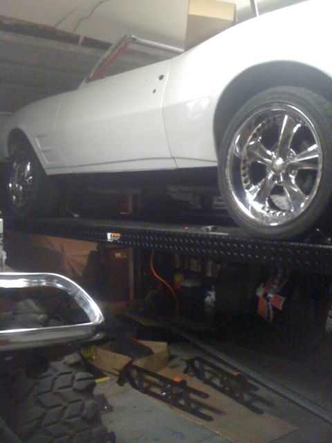

I made some progress this weekend on the inner fender. It's pretty much wrapped up, and the next project will be the trunk extension. Everything was going great until around 3 something this afternoon when a neighbor called the cops on me to complain about the noise. Apparently, there's a "no power tools" ordinance in my town- which is geared towards construction. The officer was very friendly and seemed to like my project, explained to me that a project like mine is a grey area as it's not really construction, so the complaining neighbor, who wished to remain anonymous, would have to press charges and take me to court. bleech.... I also ran out of welding gas, but, at least I was able to get through the day. Coincidentally, I'll be busy the next month so they'll get their quiet, just not for the reasons they think... Pics attached. |

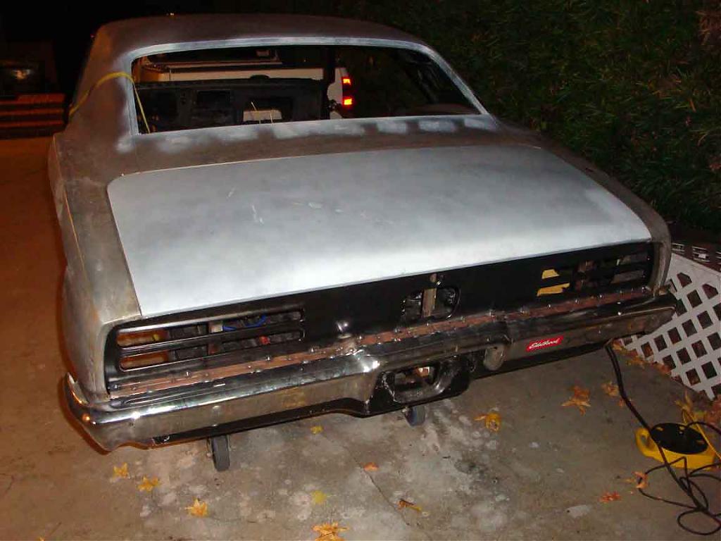

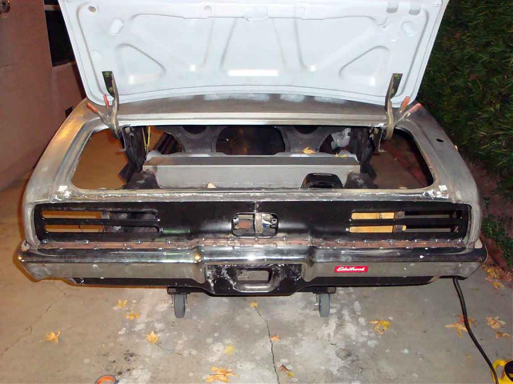

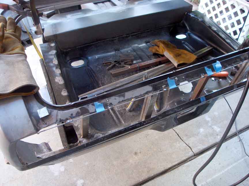

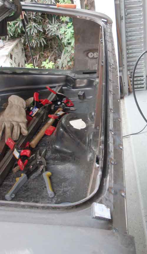

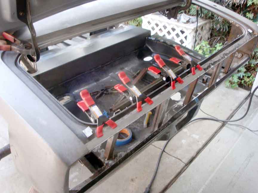

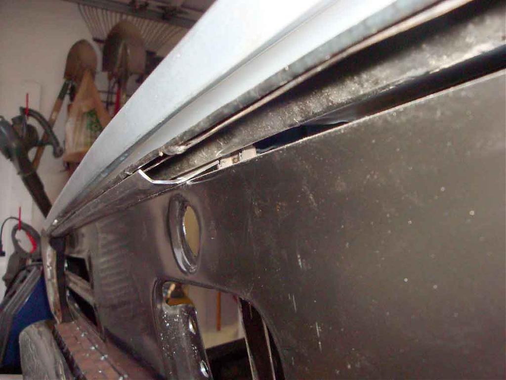

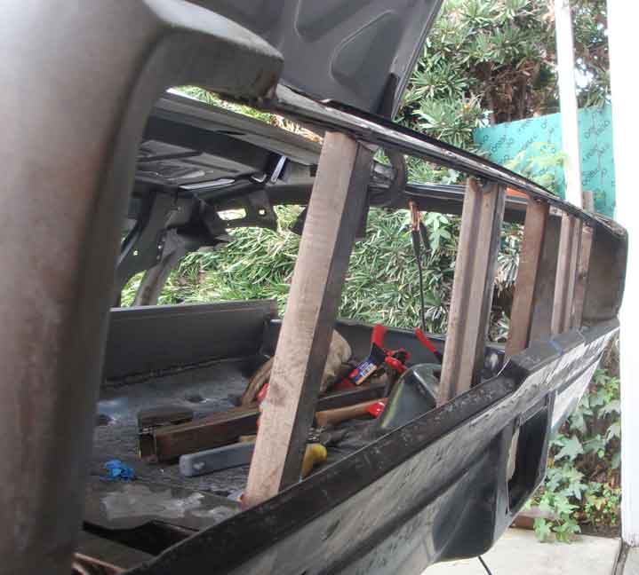

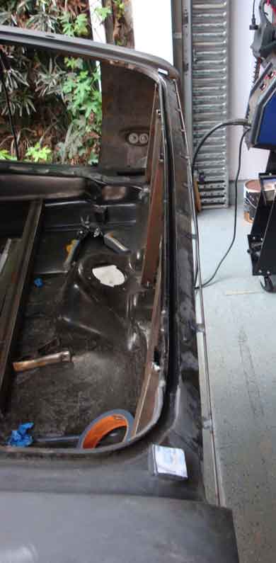

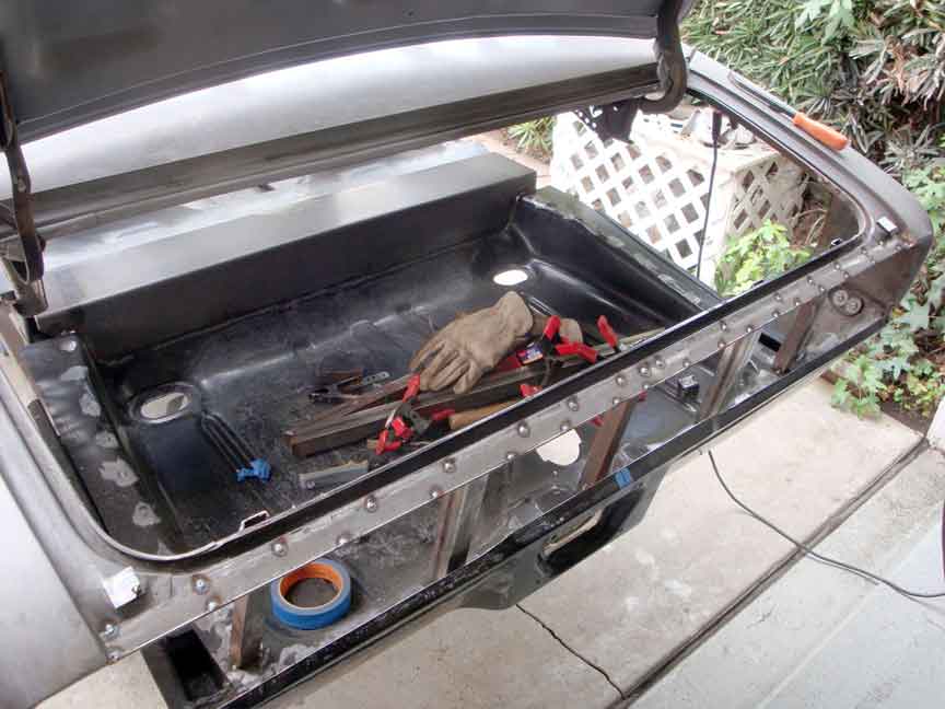

Anyways, last I left off working on the trunk extension for the passenger side along with a recessed battery tray (idea courtesy of Wayne, thanks!). On the day I left for China, I started building a basic box slightly larger than the dimensions Optima has on their website. Only I didn't leave myself enough material so I had to add a bit more. (Math never was my strong suit) I was able to get back in the garage yesterday and add the bottom to my battery tray, as well as recycle the last of my original tail panel- I saved the pieces in between the tail lights. I used these as supports for the bottom of my battery tray box. I also made a frame rail brace, and boxed in the frame in that area. I also worked on trimming the trunk extension panel to make room for the battery box. Of course, my Eastwood welder pooped out on me (will deal with that this week), but I still have my Miller so I continued working with that for the day. Hopefully I can get more time in next weekend. |
4 Attachment(s)
Just a quick update, I got a little work in today (This weekend was busy attending the Hot Wheels double dare loop at the X-games. BTW pretty cool if you haven't see it: https://www.youtube.com/user/HOTWHEEL...?v=c6PQ49B5Gpw ) by attaching the battery box and getting the truck panel welded in. I still have a bit more welding and one patch panel to add on the back side, then I can clean it up and move onto the next project...

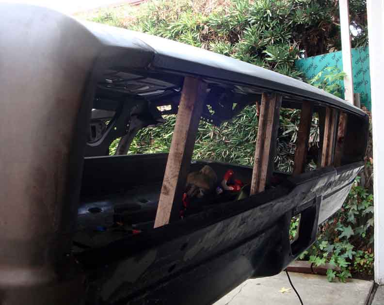

I had some time over the holiday weekend to work on the car, but didn't have a chance to post pics until now. I did some rudimentary work- installing the bumper braces (which didn't align anymore, so I had to cut and rebuild them) I trimmed the center panel in the trunk down to fit, as well as trimmed the brake light brackets to fit (they work now). I started to build my recessed fuel neck area. My goal is to modify this so I can use a modern fuel pump to refuel. I don't like how the fuel pumps (here in CA, anyhow) all have those "vapor recovery" devices on there and make refueling old cars a nuisance. I will build more of then when I install the tank and figure out the filler neck. I also trimmed the driver side front wheel opening, and am currently working on the inner fender. I also need to follow through on the fender extension, and then trim the passenger side. |

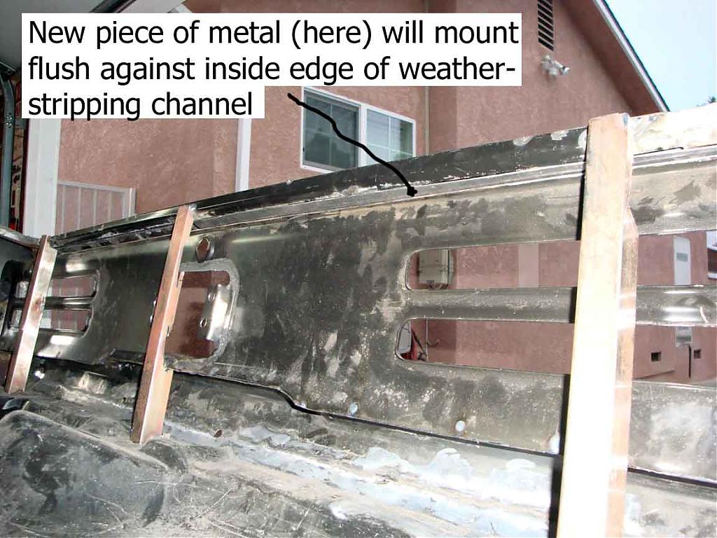

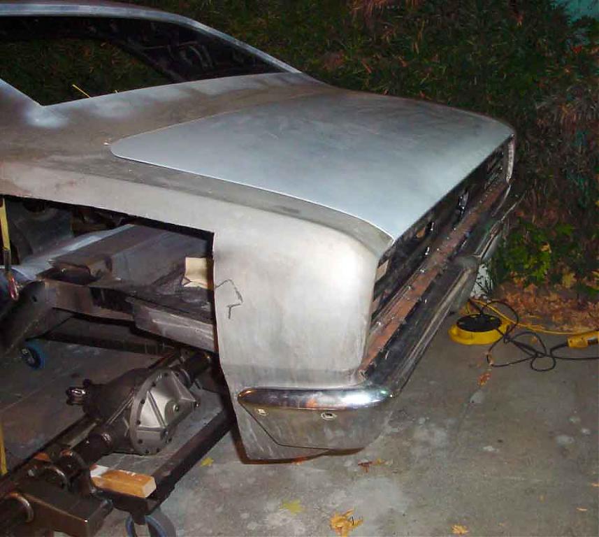

Today I was able to finish up the driver front wheel opening revision. This included finishing up the inner fenders to align with the enlarged wheel opening, and then completely rebuild the fender extension to match. The set from my car were pretty rusty (much like the rest of the car was). Fortunately, I have an extra passenger side extra, but just one driver side so I removed the rot and replaced the metal.

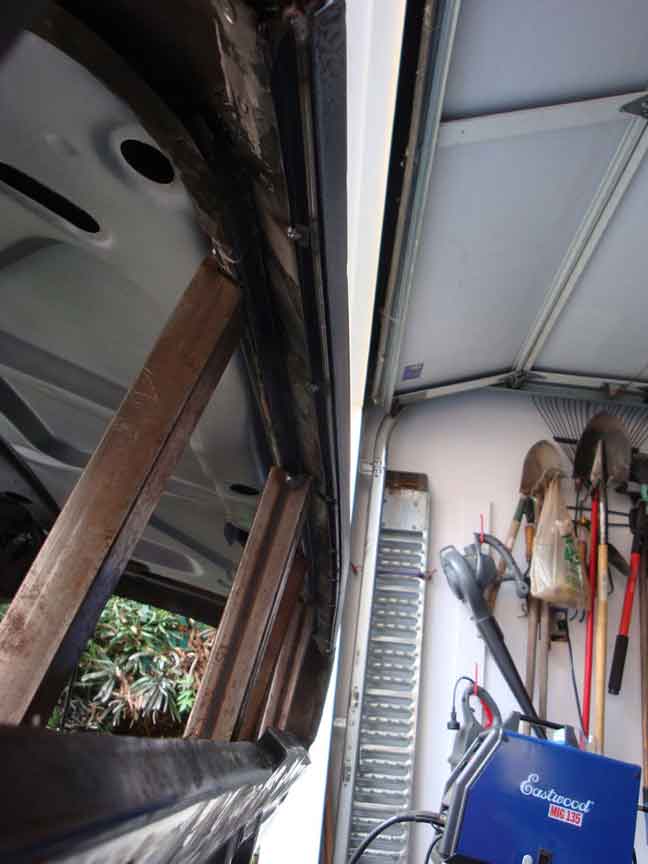

I got a few hours in this weekend, I was able to get most of the passenger side done. This went much faster (maybe because I didn't have to sandblast off some rubberize undercoating and rust) but I still need to drill holes and align the panel to fit. Next weekend, I hope. |

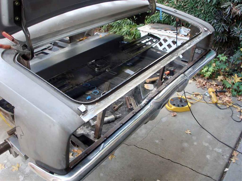

I got another day in this weekend- I worked on improving the fit of the fender/ fender extension and lower valence panel. There are a few "before" pics where you can see poor panel alignment. I used a combination of tweaking the shapes and adding some weld on the edges to reduce the nasty gaps. It's not perfect, but, it is better than before...

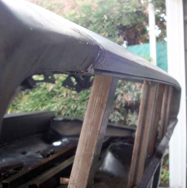

This weekend I worked on more panel alignment/ fitting. I lost count of how many times I put the fenders on, took the fenders off, made an adjustment here and there, then put the fenders on, then took them off.... I also did numerous trimming on the inner fenders, but not enough as I need to make more. I also trimmed off one of the brackets on the underside of the fender- this allowed me to move it back farther for a nicer fit. I still have to take them off again and trim on the fender to prevent the door from scraping it. I have the gaps pretty tight, I'm hoping I'll be able to keep this, as it looks much better than I remember it being before. I also took the time to fill in some holes on the core support (it was like it was perforated) and I widened the area for the radiator opening. The goal now is to get the sheet metal on and aligned, as I have a few more customizing ideas I want to do, but I'll need the panels on for measuring, etc. |

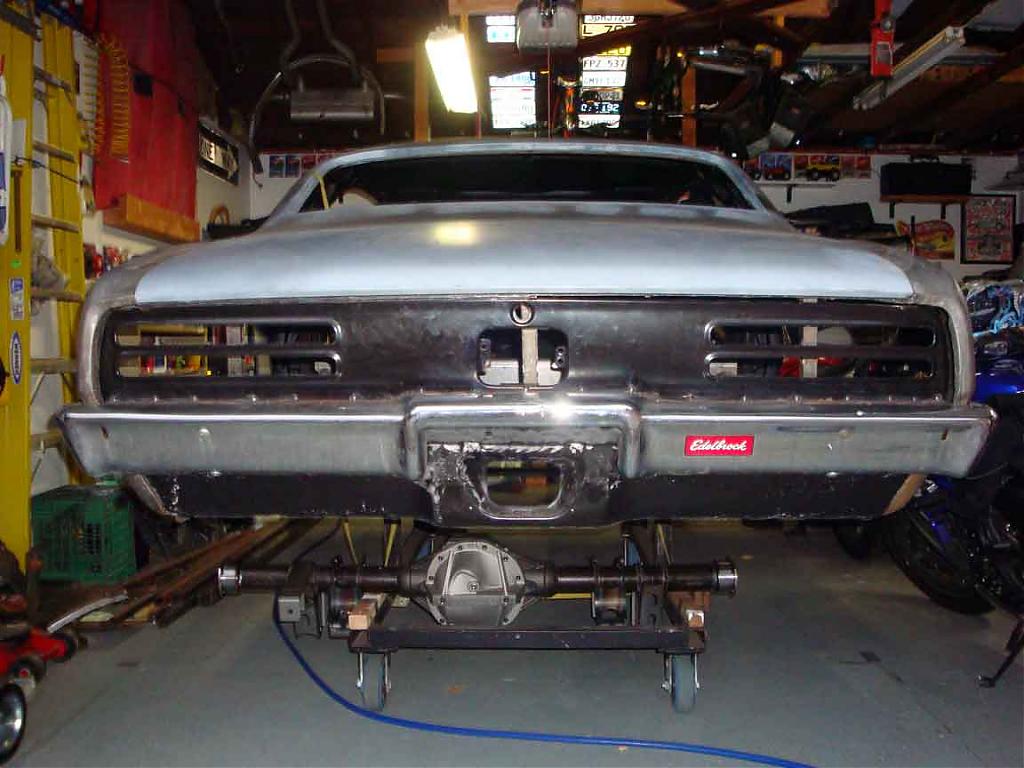

A little more progress on my bird this weekend. I chopped off the damaged area of the bumper and welded on the new section, as well as shortened my bumper brackets. I found that I couldn't move the bumper back far enough to where I want it to be, so I shortened it.

I got a little work done today- I spent most of it trimming and adjusting trying to get the bumper to fit. I had to bend it a little, and trim it some, as well as move my hood back a little. I also need to add some material to the front passenger area, and next I will need to slice it and tweak the shape to get it more like the driver side. Shortening the bumper brackets did help get the bumper closer. So that's it. Just a little update. Hopefully more next weekend. |

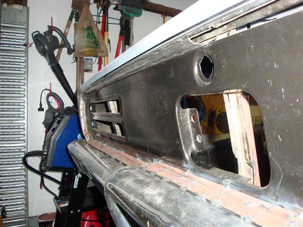

The front bumper is still a work in progress. I also had to shorten the lower bumper brackets to get the bumper to sit closer to the body. I spent most of the weekend aligning the body to the ends of the bumper. I also added flanges on the inner edge to help eliminate visible gaps and light shining through. I also had to push some of the fenders out along the bottom edge to sit closer to the bumper. I have some "before" and "after" pics. you cna see the improvements. From that I now need to reposition the header panel as it's causing interference with the hood shutting fully. It got pulled inward as I attempted to get the bumper to sit where I wanted it. After that I need to add some material along the edges of the hood itself and the bumper to get those gaps right. They just don't align to my satisfaction. Tomorrow I'm off to SEMA, yay!! |

I had some time on Sat to work on the front bumper fitment more. Not done yet, it still needs tweaking. Attached are images of the flanges I'm making to help the front bumper stay put and not let light through as I'm not using those rubber gaskets anymore. |
