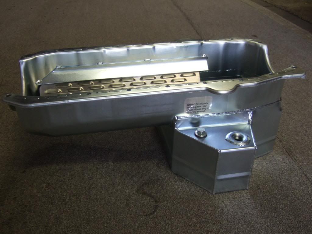

Been ordering a bunch of stuff from Summit with those coupon codes posted on here recenty (thanks to that poster) -- mostly just gaskets/seals to button up this leaky SOB of a motor I have.
But I did decide to upgrade my pan from what I already thought I had upgraded to. I think I am not the only one out there who isn't crystal clear on this either, so thought I'd share. CV Products/Champ makes 2 versions of this SBC pan but many people mistakenly call both of them "road race" pans. One of them is a circle track pan with trap doors only on the left side (3 total) and the true RR pan (5 total) has trap doors on both sides. I found the CV/Champ RR pan on Amazon of all places for $251 with free shipping. It said 2 left in stock when I ordered.
Part #s are (CV) CV1080-LT-RR, and (Champ) CP80LT-RR. Same pan. Here are specs:
http://www.champpans.com/index.cfm?e...ctdetail&id=43
Anyway, after spending a good 2-3 hours last night researching old threads, part #s, dealer sites, and PM'ing people, I decided I wanted this pan -- and this post from 2008 helped me feel very good about it too, if anyone else is researching pan options. It's always nice to get an opinion from someone on a subject who has experienced firsthand all the options out there.
http://www.pro-touring.com/showthrea...174#post366174

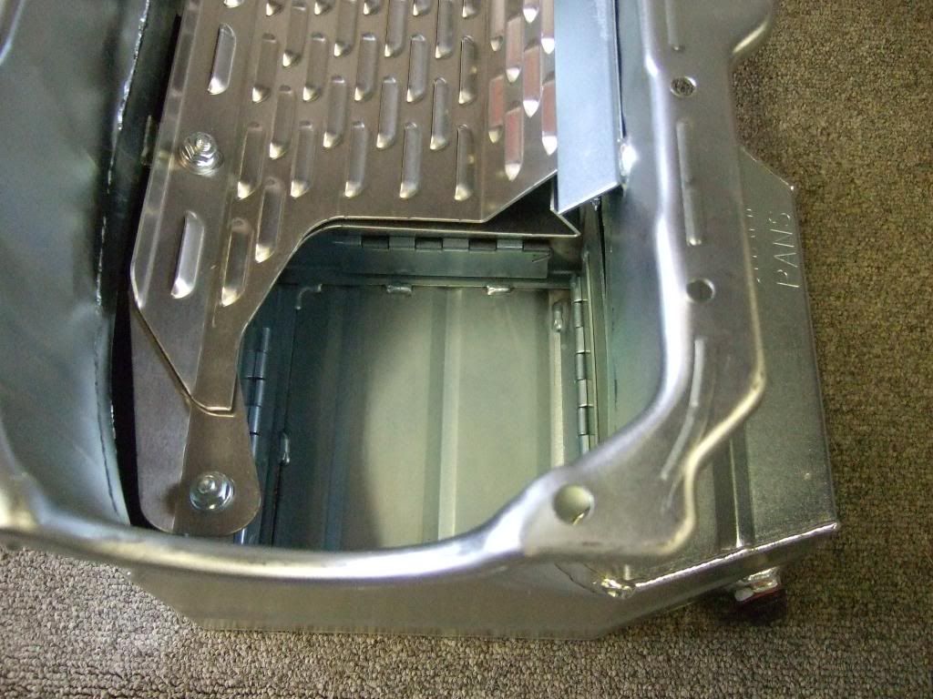

My Champ Road Race pan came in from Amazon, and at $251 shipped, I thought that was a very good deal. 1 left in stock the site says now.
http://i236.photobucket.com/albums/f...8/DSCF3103.jpg
http://i236.photobucket.com/albums/f...8/DSCF3102.jpg

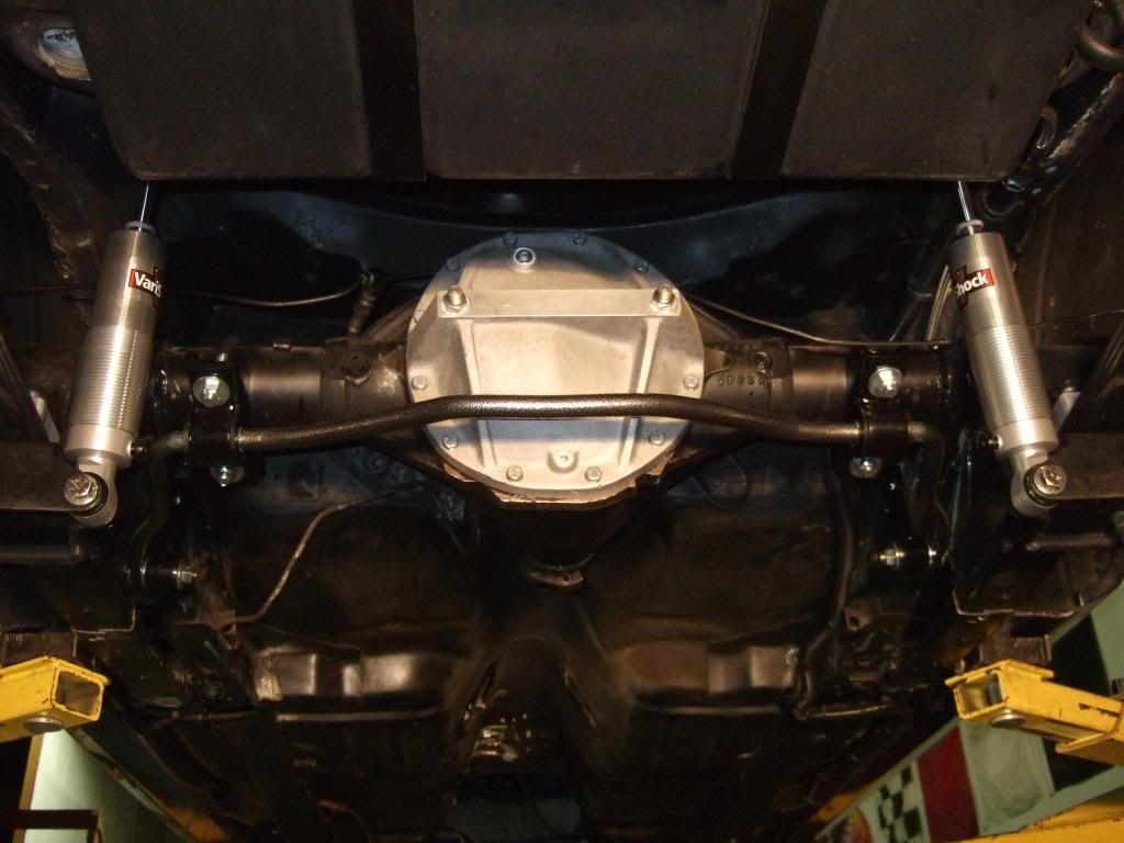

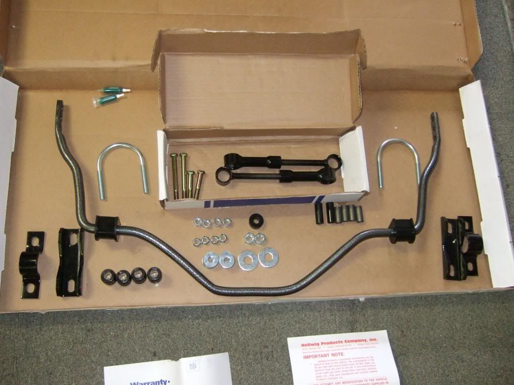

We tackled the rear suspension area today starting with the Hellwig 5824 sway bar.
http://i236.photobucket.com/albums/f...8/DSCF3114.jpg

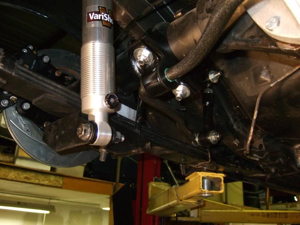

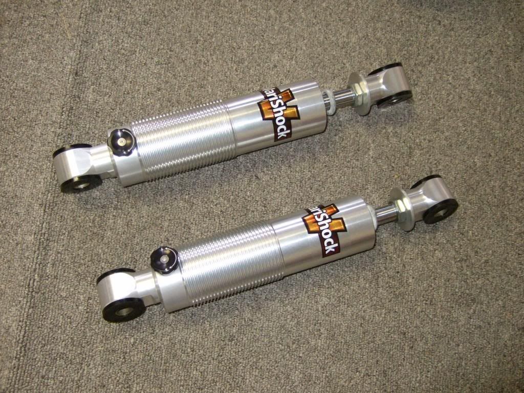

Custom length (they said no one ordered this size in over a year) Varishocks. Due to the fab work done by the previous shop working on the car we needed a very short shock compared to most 1st gens. Thanks to Mark @ SC&C for help on this.
http://i236.photobucket.com/albums/f...8/DSCF3110.jpg
Installed, along with a 1" lowering block that we swapped in to replace the 2" block already there. Can't lose too much of the attempted -- but not quite reached -- DFresh slammed stance.
http://i236.photobucket.com/albums/f...8/DSCF3132.jpg
http://i236.photobucket.com/albums/f...8/DSCF3135.jpg

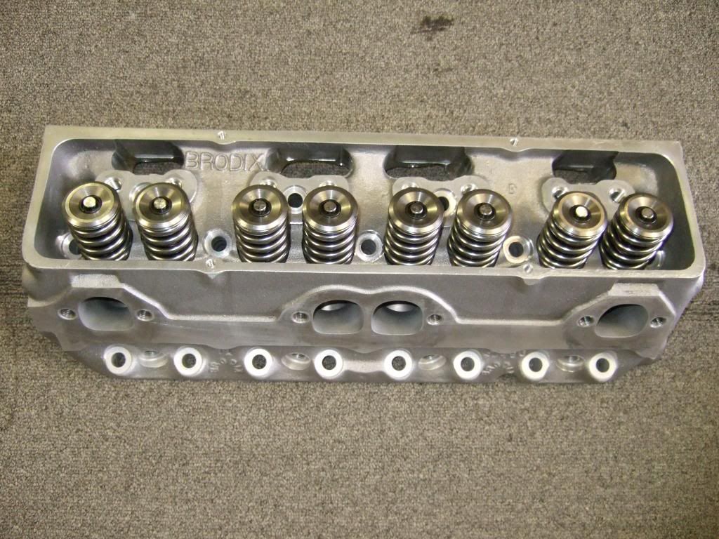

Got my heads back from the machine shop. Wasn't expecting it, but not surprisingly I guess, they needed new guides and valve springs. They're CNC ported Brodix Track 1's. I guess the Pacaloy valve springs are supposed to be pretty nice pieces.
http://i236.photobucket.com/albums/f...8/DSCF3107.jpg
http://i236.photobucket.com/albums/f...8/DSCF3111.jpg

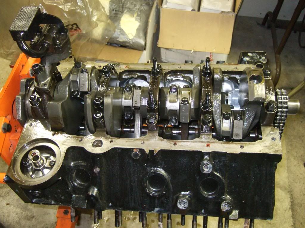

A shot of the naked 377. We pulled the main bearing to inspect and it looked pretty darn good. At least I now know what we're dealing with on this bastardized Camaro.
http://i236.photobucket.com/albums/f...8/DSCF3141.jpg
