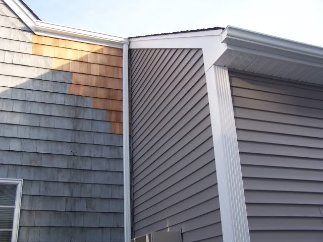

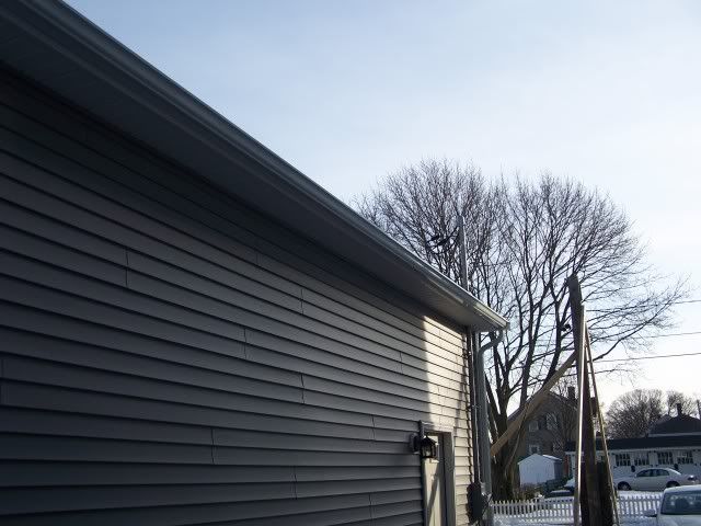

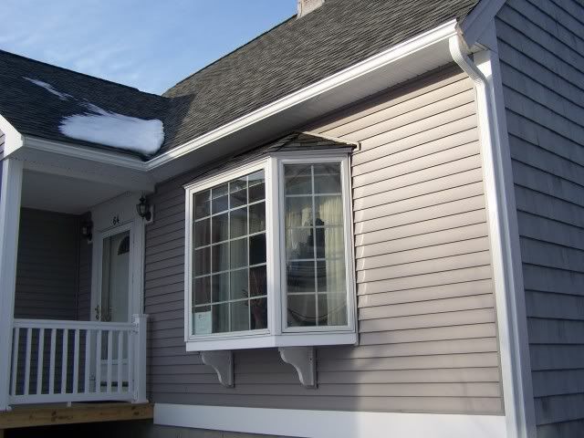

The guy came and did the gutters today. It took one guy about 4 hours to finnish the job. He did some nice work. Here are some pictures of the work.
http://i172.photobucket.com/albums/w...ures/002-4.jpg
This corner was tricky, the porch roof is a couple of inches higher than the house roof. He did a nice job matching it.

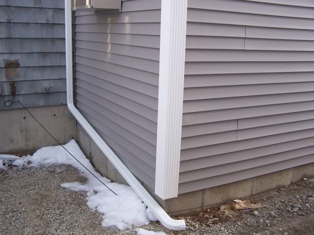

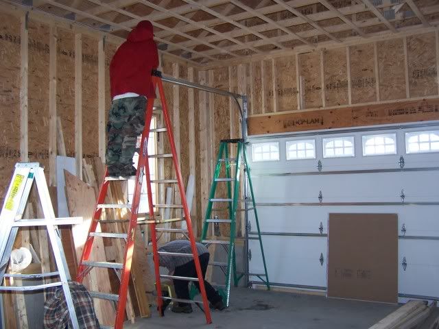

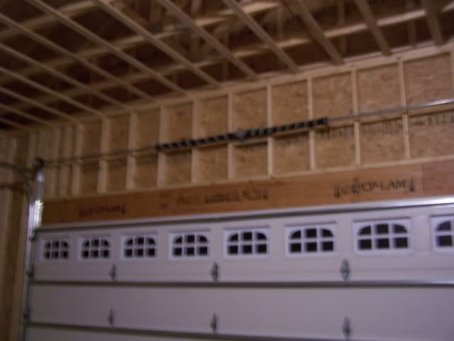

Then I got a call around 11 am from the garage door guy he wanted to install the track and opener today because he had a cancelation. He came down and started installing it. They got the track in and were adjusting the springs . The door was light when it was down and heavy when it was half way up. He said they sent the wrong springs so it won't be done until next week.
Atleast I got to see it open halfway.
http://i172.photobucket.com/albums/w...ures/003-3.jpg
http://i172.photobucket.com/albums/w...ures/008-1.jpg
http://i172.photobucket.com/albums/w...ures/009-1.jpg
Oh well they tried.

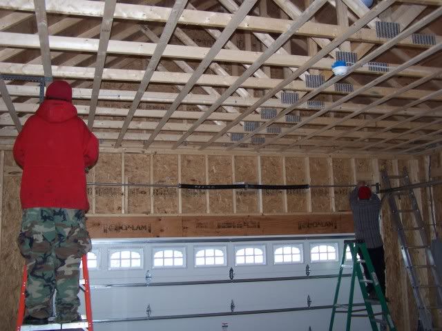

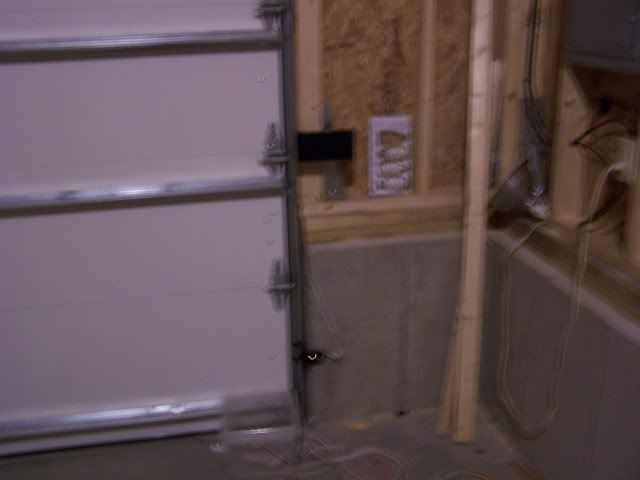

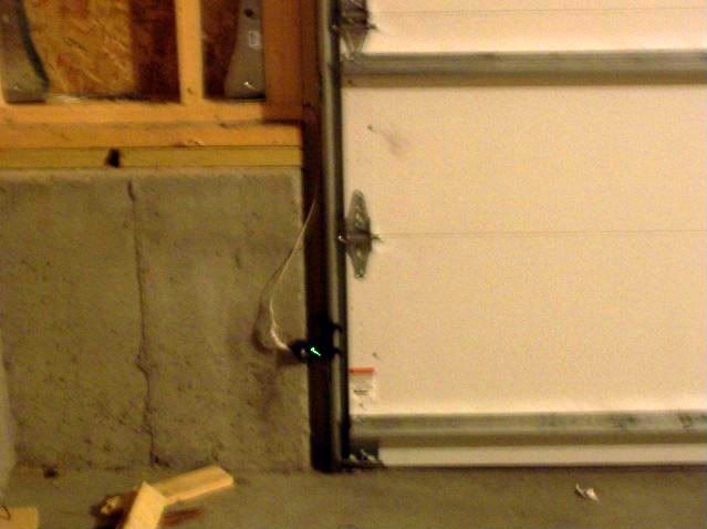

This has been a pretty good week for progress. The door guy called , the springs came in . He came down Monday and installed them and the LiftMaster 3800. The door is finnaly finnished and usable. The cable was attached to the temporary power pole and had to be run through the garage to the house. That got done too. I have some pictures that were taken with a only the 300 watt compact fuoresent that screws in a regular socket. Its pretty good it only uses 68 watts and is pretty bright.
http://i172.photobucket.com/albums/w...stalled001.jpg
http://i172.photobucket.com/albums/w...stalled002.jpg
http://i172.photobucket.com/albums/w...stalled003.jpg
http://i172.photobucket.com/albums/w...stalled004.jpg

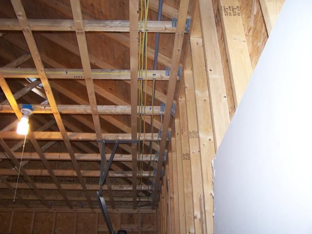

I don't see near enough electrical in the rafters. Get a ton of light in that garage. You'll thank me when you start twisting wrenches. How much did that garage door opener cost? Thinking of converting mine when I get a hoist.
waynieZ 01-27-2011 09:49 PM
I plan on alot more lights. That is just to hold me over untill the wallet stops bleeding a little. The Liftmaster cost me $340 with two extra remotes plus what came with it. It is a great opener, it is super quiet.

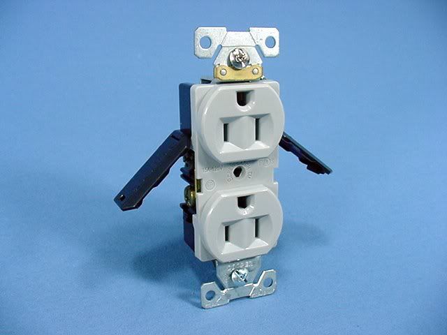

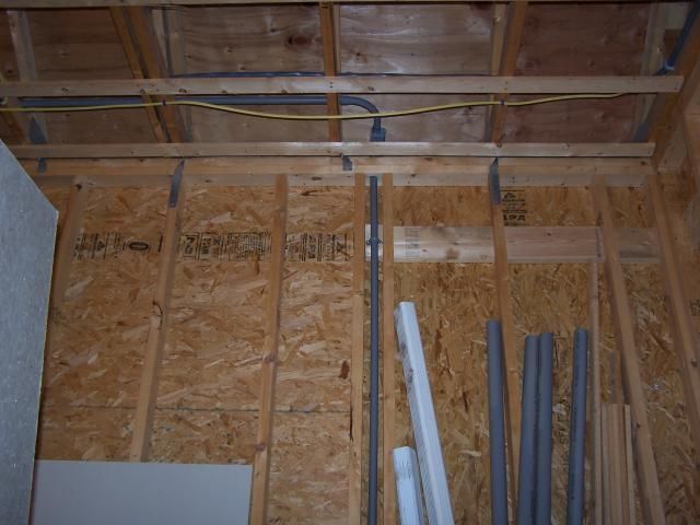

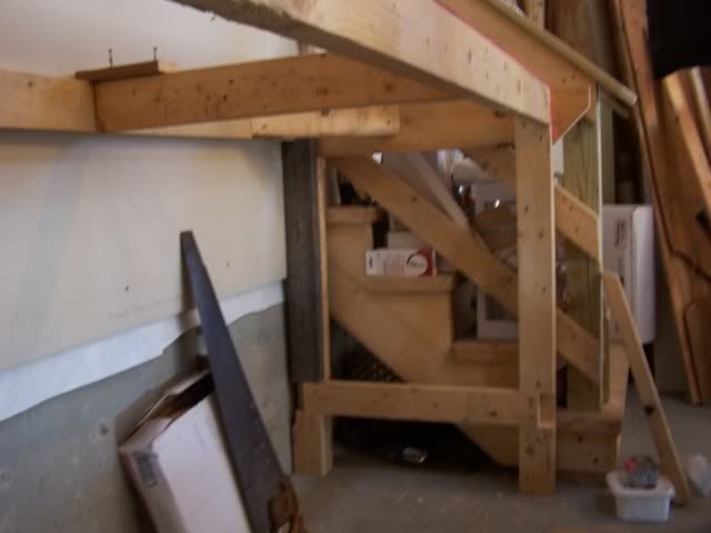

Hi Alex. I started getting some material to do some wiring. I got 750 ft of 12-2 romex and 18 industrial recepticles with boxes. I also put a second 300w compact flourescent in for now. Its amazing the amount of light from these two bulbs . Right now there is one over each bay. I got the wire off Craiglist in three 250ft coils. With shipping to my house was around $75 ea. which is cheaper then buying them from HD. Its $83 ea plus tax, Saved close to $50. The recepticles came from E bay they cost me with shipping around $4 ea they sell at HD for around $8-9 ea. A couple of weeks ago I saw a set of attic stairs for a 12' cieling Werner 300lb rated aluminum. The budget for the garage and the car are almost non existent now, so it was tuff to spend the money on these but when I checked they sell for over $400 for the 12' set. So I got them.
Here's a picture of the stairs.
http://i172.photobucket.com/albums/w...ictures157.jpg
http://i172.photobucket.com/albums/w...ictures160.jpg
This was taken with just the compact flourescents.
http://i172.photobucket.com/albums/w...ictures136.jpg
Here are the recepticles.
http://i172.photobucket.com/albums/w...252gy-ea-2.jpg
http://i172.photobucket.com/albums/w...252gy-ea-3.jpg

GregWeld 05-18-2011 04:53 PM
Wayne -- Run a GFIC as your FIRST receptacle. People don't realize it but concrete can ground you out when you're down on your hands and knees... so you can get your butt kicked with a shorted tool etc.
At least that's what my buddy electrician made me do - for that reason...
:cheers:
waynieZ 05-18-2011 05:34 PM
Thanks Greg. I only learned about thet a couple of weeks ago so I bought 4- 20amp GFCI breakers for $15 Ea. I used to laugh at my wife for using coupons. Now I'm the craigslist and E Bay king lol.

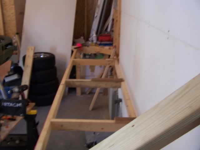

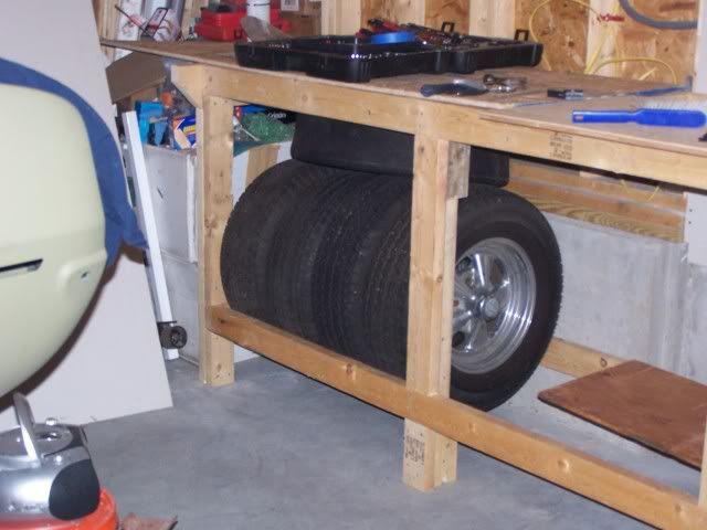

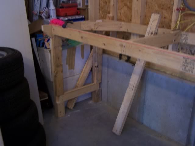

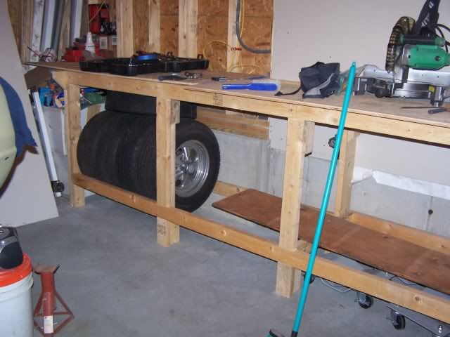

Built a little work bench for the garage
I've got a little up date. I started building a work bench along the back wall of the garage. I had some wood left over from the build so I put it to good use. Some of it reminded me of the road courses you guy run or sort of how I like my women ( a little twisted ). The bench is 12' L x 32 W x 42 H it is attached to the wall with Hex Washer Head Tapcon's. I divided the length by three for the up rights and added a cross brace a 2x4 at the 8' mark so I would have something to secure the plywood I'm using for a top. It will be two 3/4" pieces doubled up. I used cad plated deck screws to build it. I just threw some pieces of plywood on top for now so I can get back on the car. I'll get the plywood ripped and attach it after I'm done putting in some shelves and a few more up rights.
Here are a few pictures.
http://i172.photobucket.com/albums/w...t/000_1094.jpg
http://i172.photobucket.com/albums/w...t/000_1097.jpg
http://i172.photobucket.com/albums/w...t/000_1095.jpg
http://i172.photobucket.com/albums/w...t/000_1099.jpg
http://i172.photobucket.com/albums/w...t/000_1104.jpg
http://i172.photobucket.com/albums/w...t/000_1101.jpg
http://i172.photobucket.com/albums/w...t/000_1105.jpg
The last bay ended up perfect to fit my old wheels and tires.

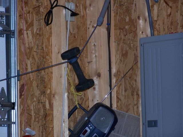

got out in the garage today,this was actually a 2 day job first I put pvc conduit from my main panel to my compressor disconnect.
http://i172.photobucket.com/albums/w...psd6718c2f.jpg
http://i172.photobucket.com/albums/w...ps5afcf68d.jpg
http://i172.photobucket.com/albums/w...ps2ddcf150.jpg
http://i172.photobucket.com/albums/w...ps5289304b.jpg
http://i172.photobucket.com/albums/w...ps24232cce.jpg
Then it was time to pull the 2#8 power and #10 ground the 30 feet. No one around so I used my s20 year old shop vac taped to the end of the pve near the main to pull some braided line through the pipe so I could pull the wires. Got the line through only took 20 minutes. Then came time to pull the wire. I was all alone so I got my friend Bell to help Dumb bell that is. I tied the weight to the end of the line and went back to the other end and fed the wires in. Amazingly it actually worked ! Only had one ladder at the time so it was pull move the ladder then repeat. Must have gone up and down at least 100 time easy. Then I gave in and got my extension ladder to use on one end.
Here's my little helper.
http://i172.photobucket.com/albums/w...ps29d58e00.jpg
I tied the line to the garage door because the weight kept hitting a shelf below the panel and would only pull 3' of wire at a time. I have a video of it working but can't load it to Photobucket for some reason. I'll try again later. All in all a very productive day.
