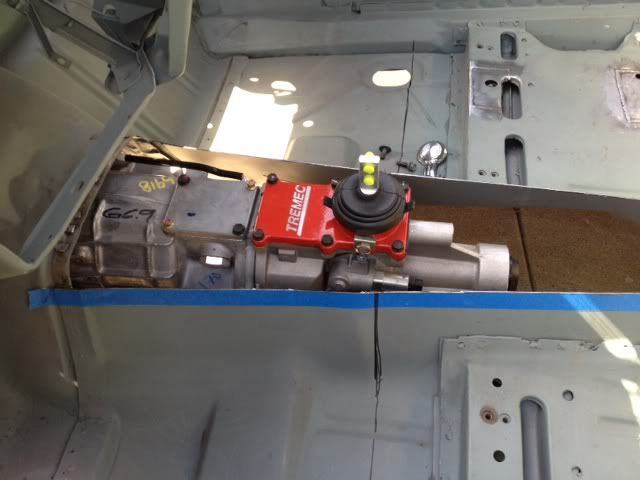

Brown truck dropped these off.
http://i1232.photobucket.com/albums/...psd957ef1c.jpg
Got firewall done " again " minus a few holes. AC fits in perfect. Clutch bracket is set. Cut trans cross member a bit. Looking for a good entry location for engine harness and battery cable. Put it all back together to double check clearances.http://i1232.photobucket.com/albums/...ps67c70553.jpg

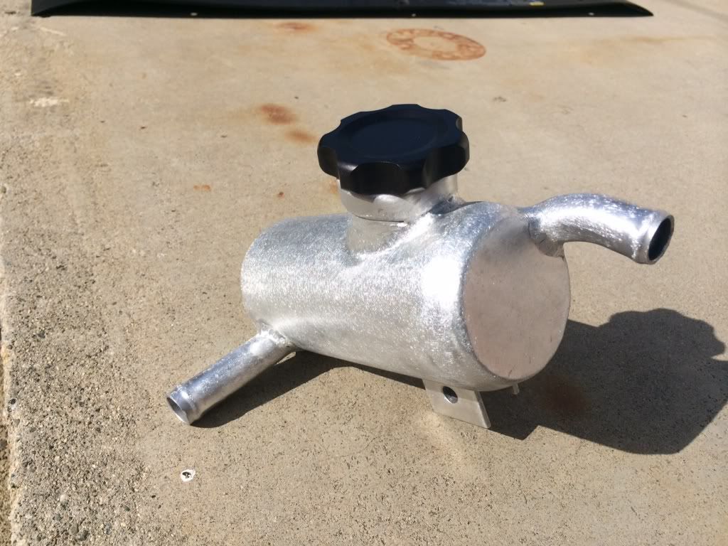

AC and heater lines , ran and plug harness to make length adjustments , built a cool bracket and location for + power block. Built aluminum close out panel to match passenger side, it also holds AC dryer. Upgraded to carbon fiber SC shaft and smaller pulley, AC condensor is done , heat exchanger clerance position and mods done , building an expansion tank from an old AC dryer.

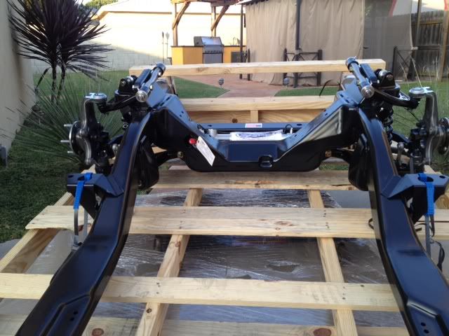

Got these new inner fenders from Ron in SoCal ( tx )
http://i1232.photobucket.com/albums/...ps6ff94143.jpg
http://i1232.photobucket.com/albums/...ps9ba4ad75.jpg
http://i1232.photobucket.com/albums/...ps51d77ffd.jpg

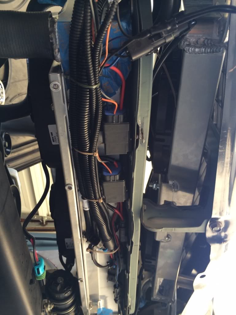

This guy said " hide that awful bunch o wires
http://i1232.photobucket.com/albums/...ps289afeab.jpg
http://i1232.photobucket.com/albums/...ps4b25b874.jpg
Rough wiring will get it looking good for final. Built this cover to hide most of it. It will be anodized black on last stage ,

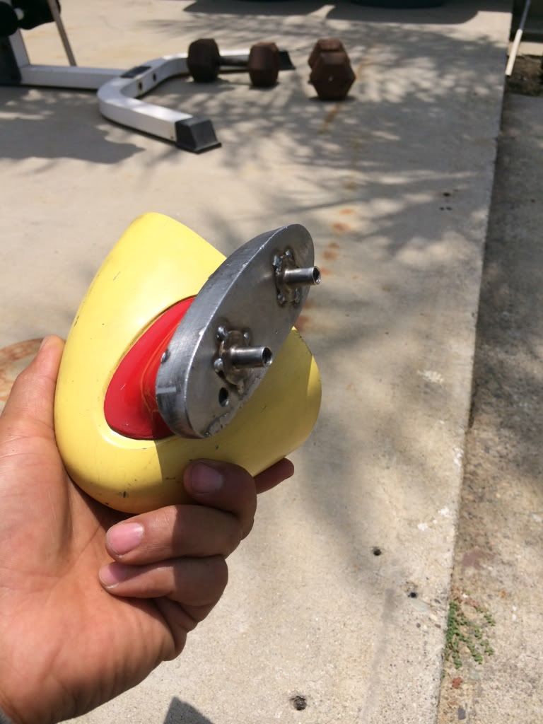

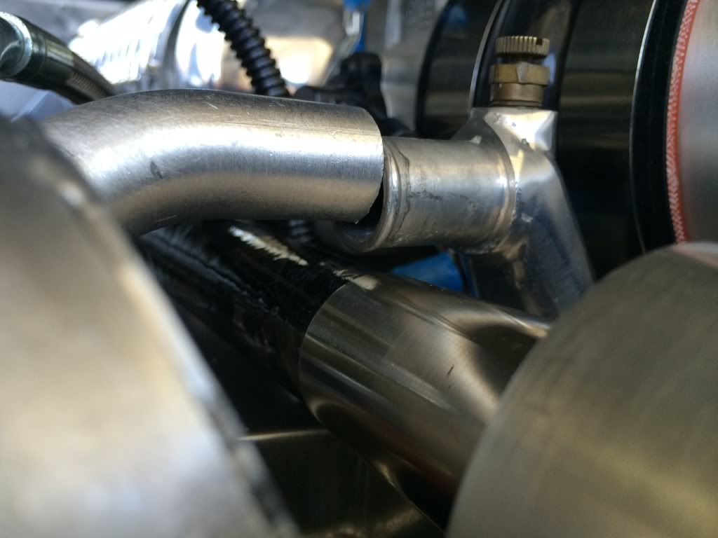

Sometimes a solution creates another problem such the case with CF shaft now it has no clearance for hose and clamp. Got to raise it about a 1/4"
http://i1232.photobucket.com/albums/...ps869add2d.jpg

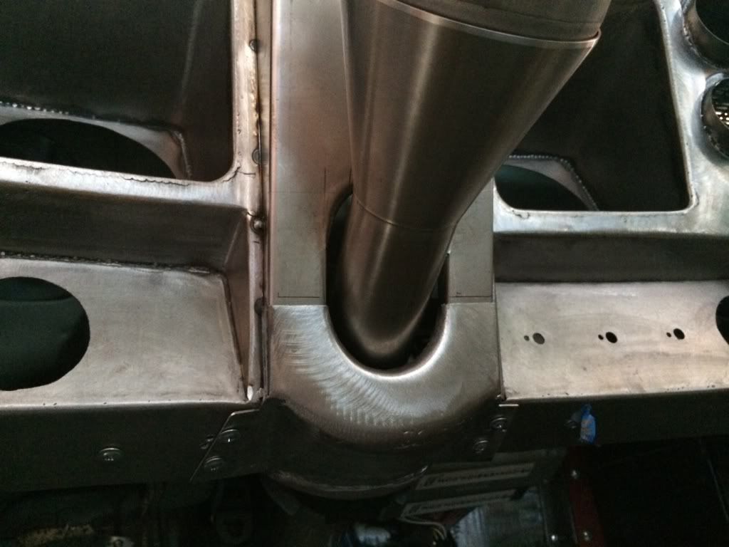

Here is how I went about it. It got it cut, raised 1/4" , welded it and finally open up inside with a carbide tip
Good idea on those clamps I'll be using them on all water lines.

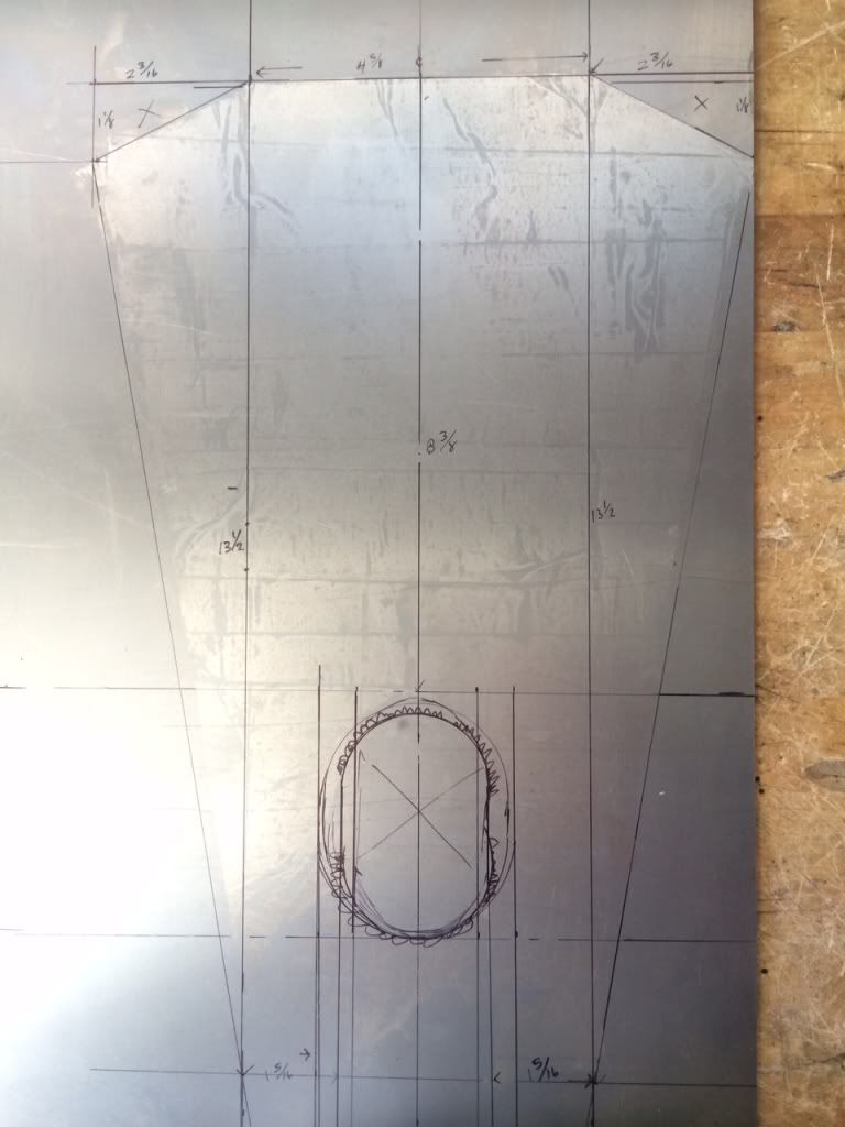

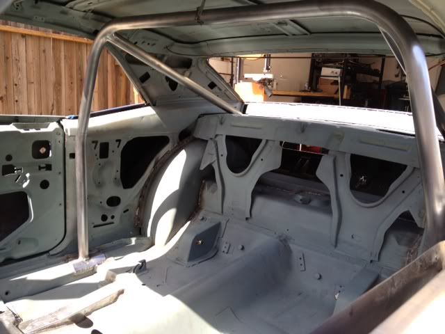

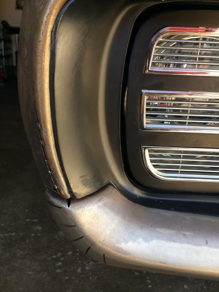

Started to finalize all gaps , cut header panel to bring fenders closer to hood and tuck them real nice around grill headlight area. Could not get driver fender to fit half way decent , so I found out bottom corner had been patched and when welded it was tweaked like crazy, than found structure was rusty so I figure cut the whole thing of and start from scratch. Got Momo steering wheel bolted seat on make sure it was where I want to be and got Flaming river colum complete to the rack, had to reshape center of dash due to diameter difference from stock, made a close out panel where colum meets dash. Mirrors are in ( got that idea from DSE). Both doors are gapped , not final . Gap is less than 1/8" They open and fit perfect but I know with paint it will be an issue. For now. I just like that tight look. Hoping to finish trunk gaps but maybe replacing lid.
Next I will start setting up glass all around , make sure it all plays well together. making space for power steering cooler, doing some electrical.
Begin planning interior. Maybe moving roll bar a bit out of the way. All well a bunch of BS go come

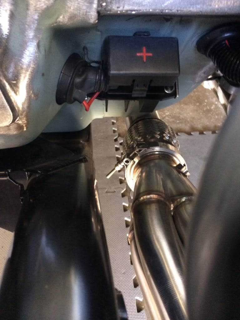

Got the block in there , ran wire inside ( right at kick panel area and to the trunk)

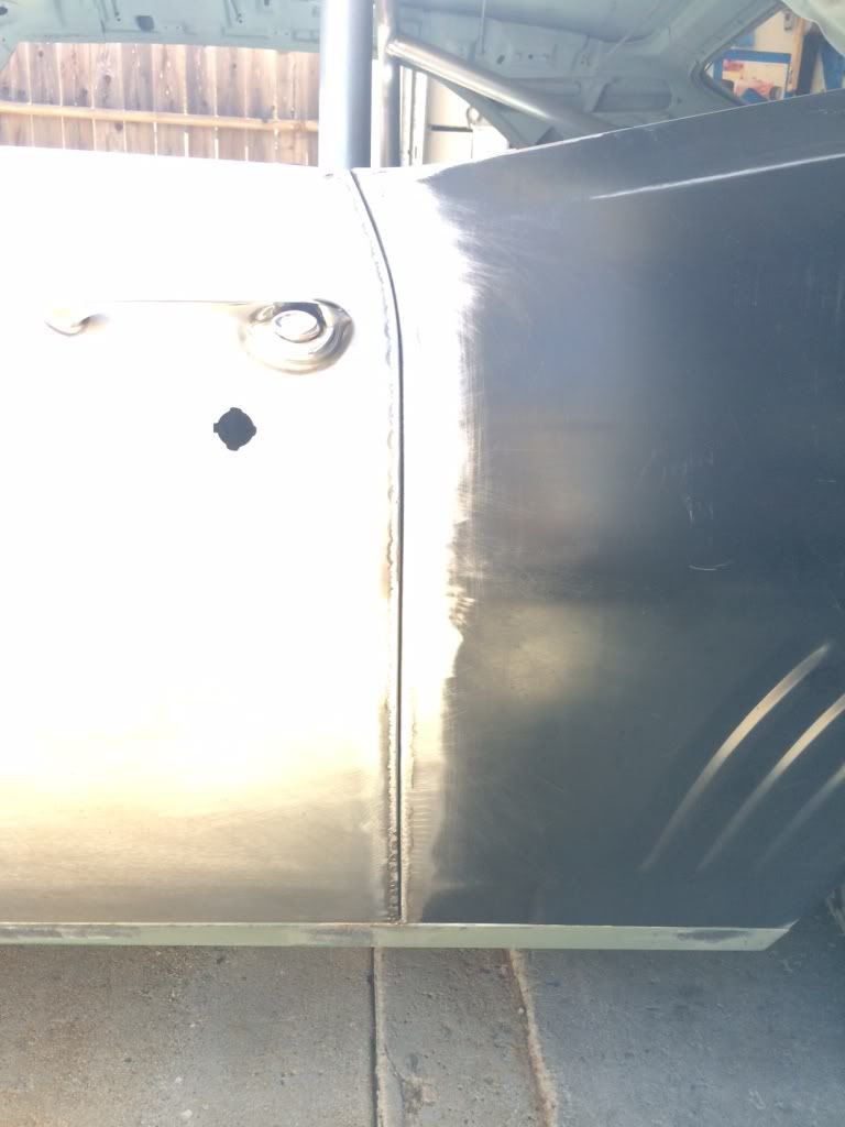

frankv11 06-29-2014 11:07 PM

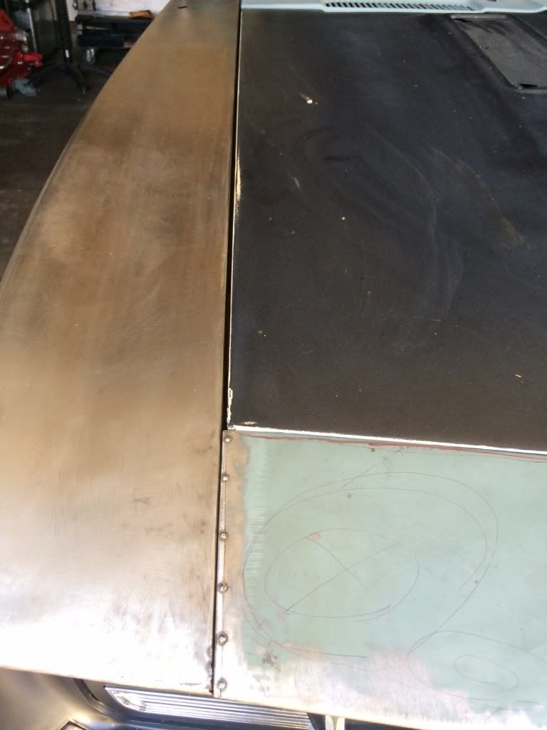

A few more pictures of the front , coming along . Still got work to do where fender meets header panel ( slight buckle ).
Hood it's there I'm just debating on buying billet hinges or stocks to finalize gap. I have old stocks in there now and they pretty worn out.
Header panel will get cut with thin dremel blade in between spot welds to get some good penetration.

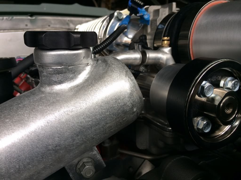

Accessory drive is mostly from 05 Cts-v . I changed alternator bracket ( 01 Camaro - modified )to keep at stock location and built compressor bracket ( using sd7 compressor ) from scratch to run from same belt. It was important to me in keeping all low and stock looking.
It's not yet a proof set up, waiting to fire it up to see how that belt behaves . Especially on high rpm shifts.

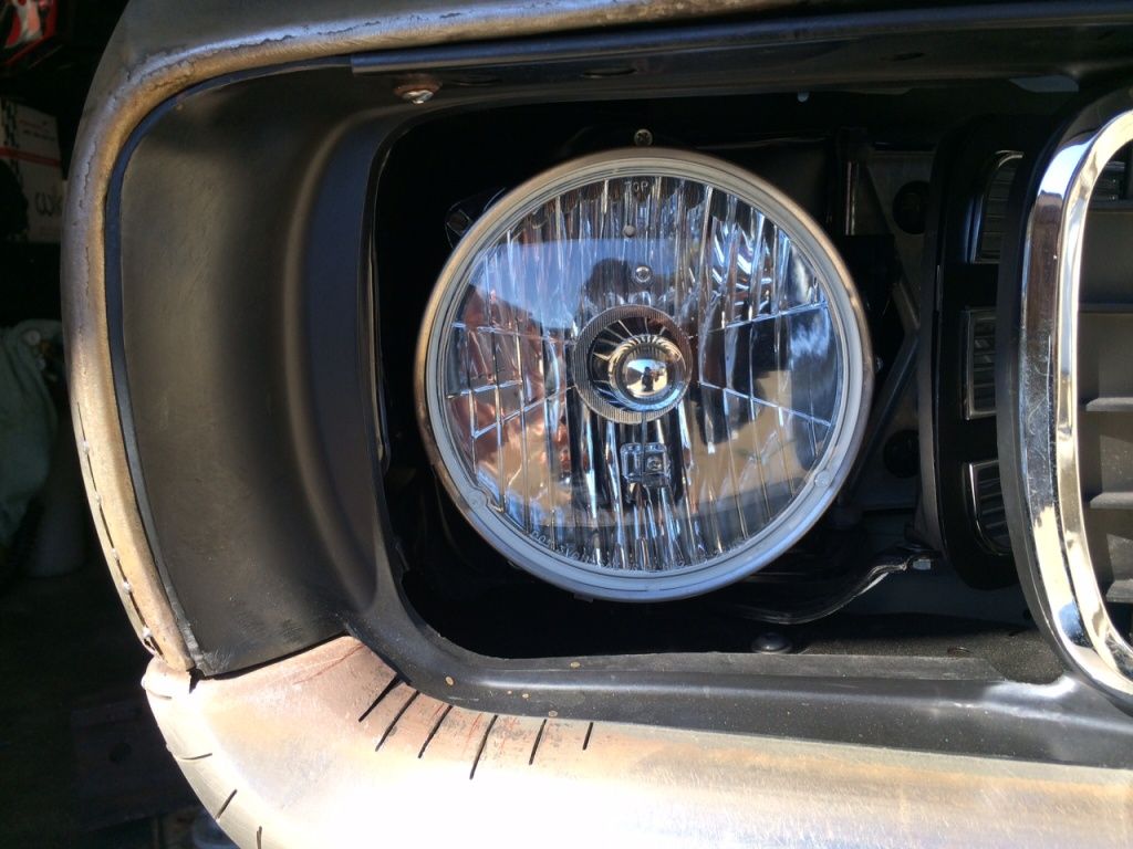

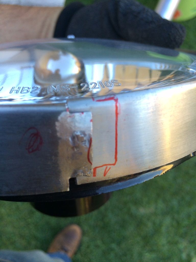

Those head lamp doors are a pain in the a// to make them fit. I had to reposition the two weld in nuts on core support. Played with it quite a bit

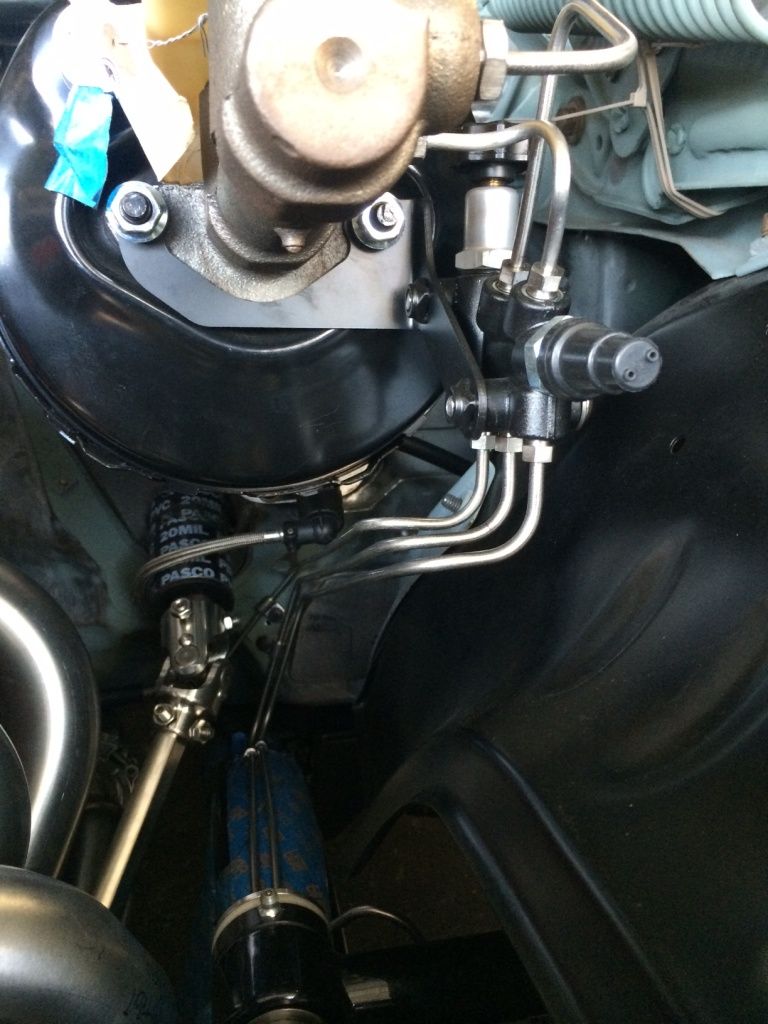

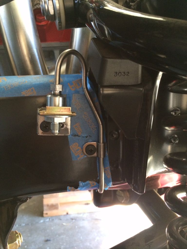

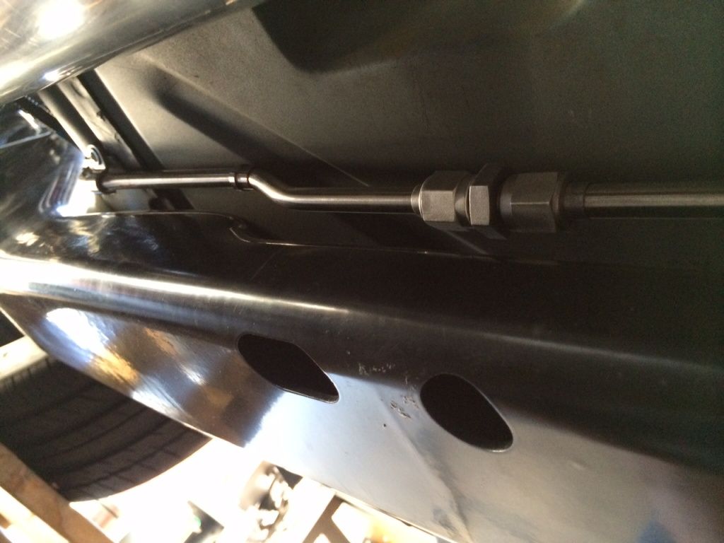

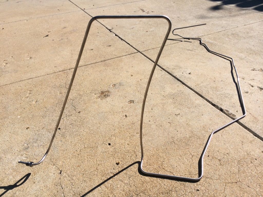

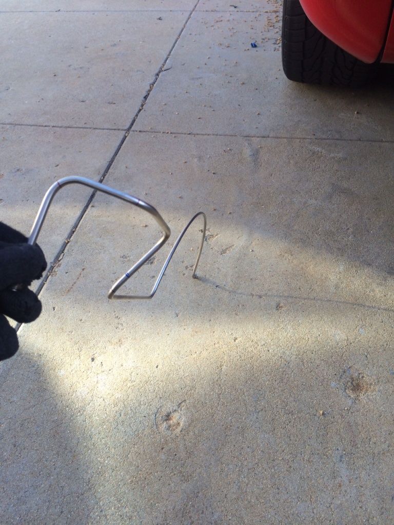

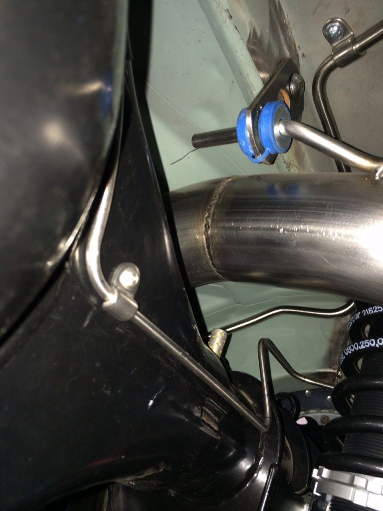

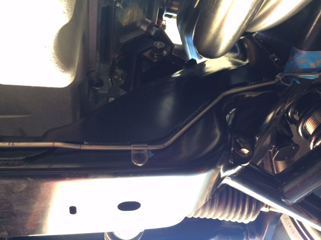

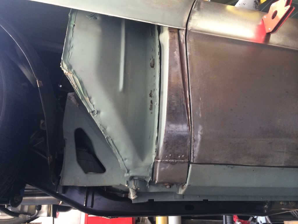

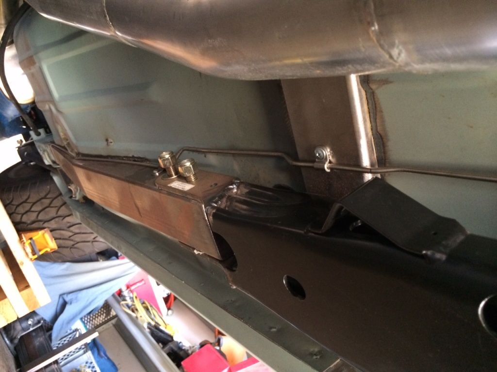

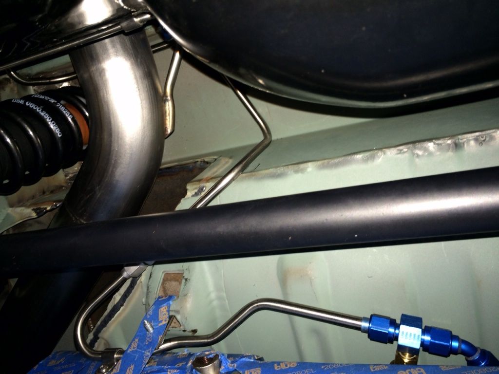

Brake lines are done was able to run one piece from proportioning valve to flex line for fronts. 3/16 SS. Any one looking to buy a flaring tool I will highly recommend the RIGID 458r for 45s and they also have a 37 degrees. That's the best tool I have bought and here benders same quality.
Fuel plumbing is also checked off the list 3/8 SS.
I ran both fuel and brake-lines on the inner side if rail "hope it don't get to hot"" maybe build a heat shield.
http://i1232.photobucket.com/albums/...ps6dcf79e7.jpg
Rear end passenger side piece
http://i1232.photobucket.com/albums/...ps641e37d9.jpg
Front passenger
http://i1232.photobucket.com/albums/...ps5198dad8.jpg

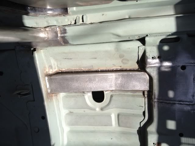

http://i1232.photobucket.com/albums/...psaac50b2d.jpg
Followed the DSE weld
http://i1232.photobucket.com/albums/...ps93ae9fe2.jpg
[URL=http://s1232.photobucket.com/user/frankv11/media/Mobile%20Uploads/photo4_zps93ae9fe2.jpg.html]
http://i1232.photobucket.com/albums/...ps5e81cbb9.jpg
http://i1232.photobucket.com/albums/...psdc4b24a6.jpg
Need just a bit if massaging here once I can get access to sett up clamps

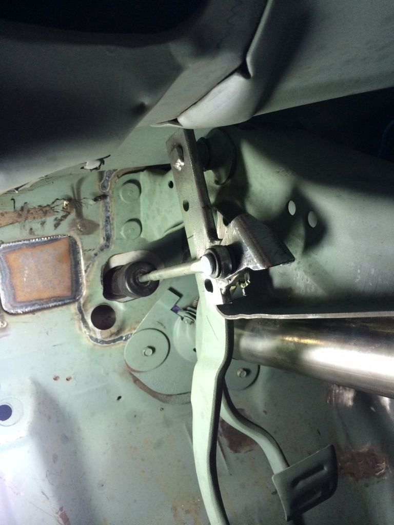

Setting up clutch pedal with a stop and pushed pedal 1/4" towards passenger

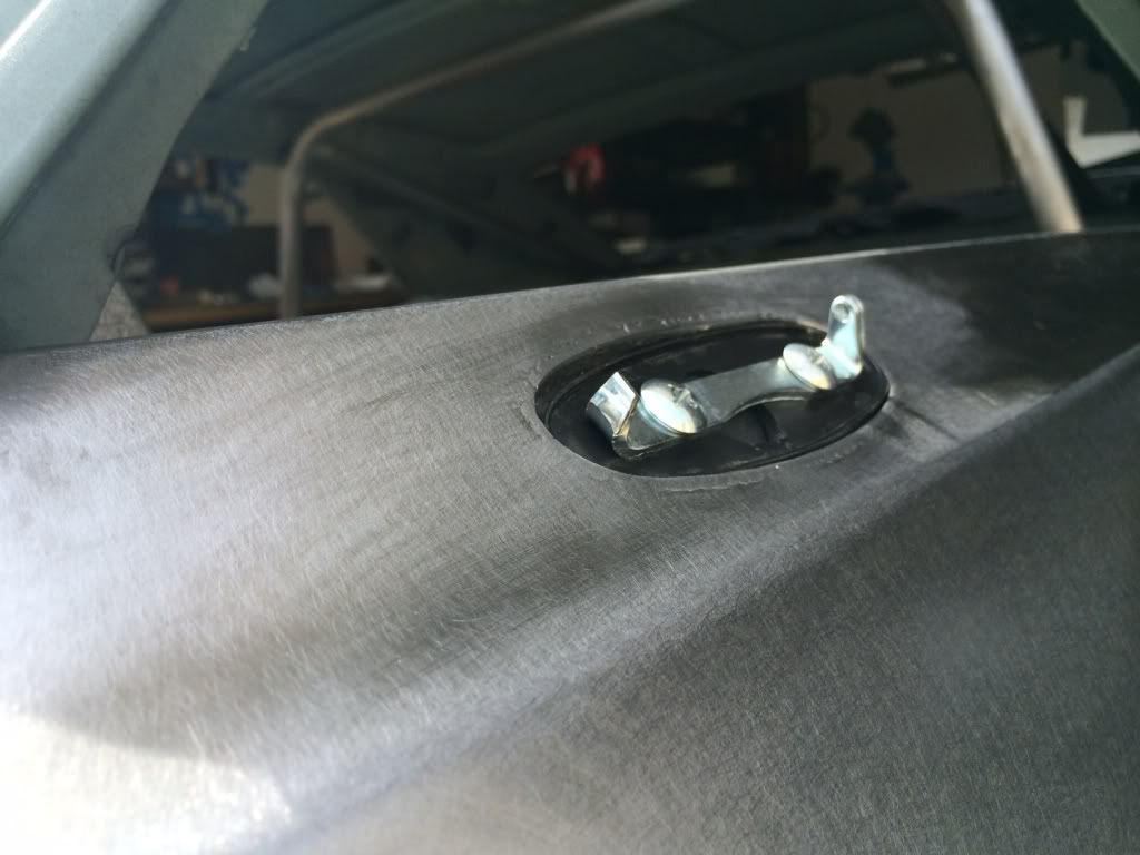

Just bought some OEM panels "$40" to remove chromes and handle pockets.
Question can I use the stock rod that goes from latch to handle or is it deluxe specific.
canrc 09-29-2014 11:02 PM
Congrats Frank! Good times ahead!
Car look amazing:thumbsup:
tubbed69 09-30-2014 04:53 AM
Originally Posted by frankv11 (Post 571950)
Thanks Jeff it's truly a blessing to have two beautiful healthy boys.
At the rate I'm going they will probably be finishing it for me.
I missed your post on those deluxe panel items that was a steal.
Frank I used the same rod and it was fine.

All I can say I have more respect for those tubing guys. Thanks ron
