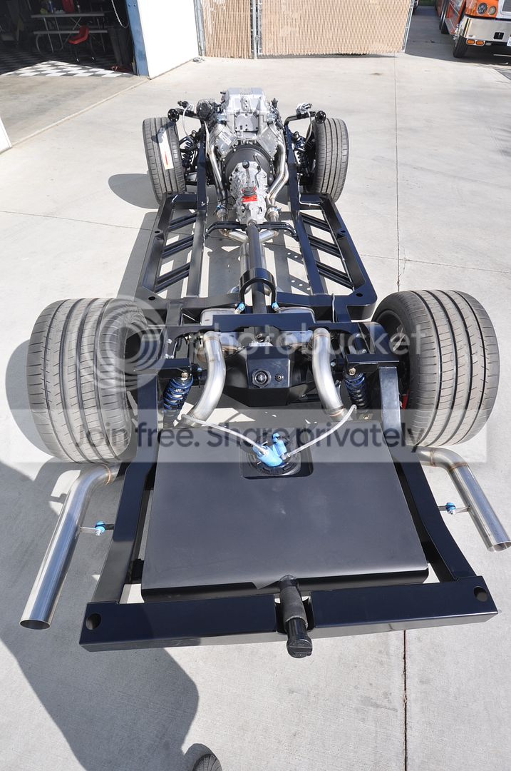

FETorino 01-28-2013 07:56 PM
Originally Posted by ironworks (Post 460784)
http://i616.photobucket.com/albums/t...psa2f985cd.jpg
This last picture is an excellent example of why you powder coat or paint the fuel tank black on these cars. HAHA
Back to work.
Looks wicked. Black on the tank for sure. What do you suggest to clean up the look of that brake reservoir? :lmao:

ironworks 01-29-2013 07:41 AM
Good to meet you at GNRS. Congrats on the sales.
It was nice meeting you also. I was amazed we went all weekend with that unpainted reservoir on the firewall and no one puked or passed out. Greg did not even say one word about it either. Maybe he was saving his comment for Latg blog post.

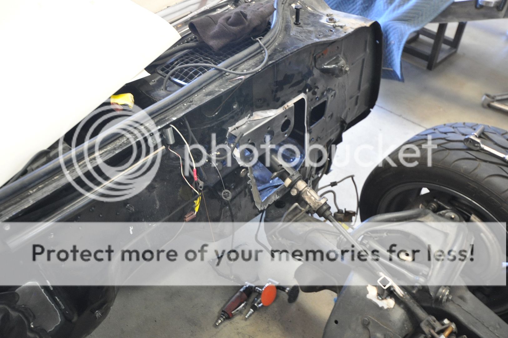

We ordered a set of Firewall down bar parts from Holohans Rod shop to use for the down bars. There parts are very nice. I could not find any other parts that would work as well as these. They make a great addition to the look we are going for.

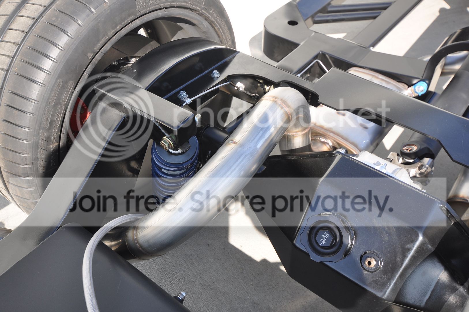

The inner fenders have been widened and reshaped to accept this big of a tire at the ride height. But the results are awesome. Broc knocked them out of the park. And they look factory.
http://i616.photobucket.com/albums/t...19-2013004.jpg
http://i616.photobucket.com/albums/t...19-2013003.jpg

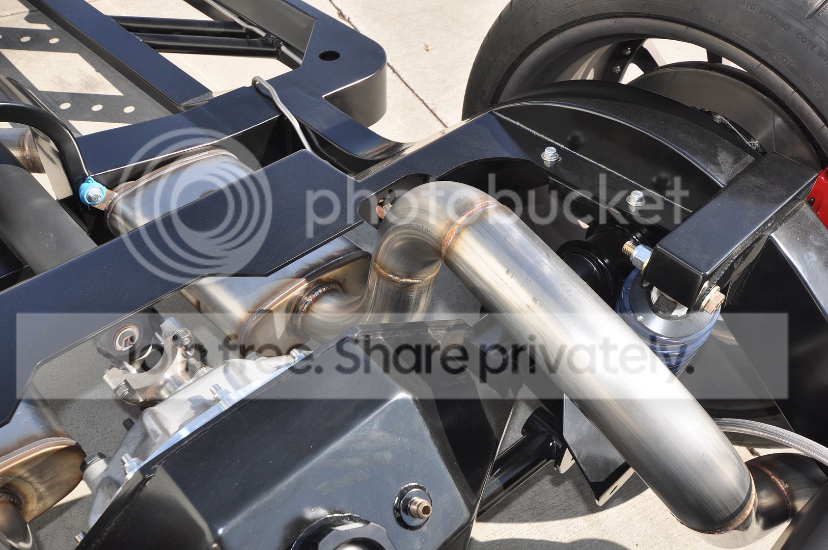

We are getting the exhaust system all wrapped up. I love a properly built stainless exhaust. Henry did a great job on it.
http://i616.photobucket.com/albums/t...-2-2013012.jpg
http://i616.photobucket.com/albums/t...-2-2013013.jpg

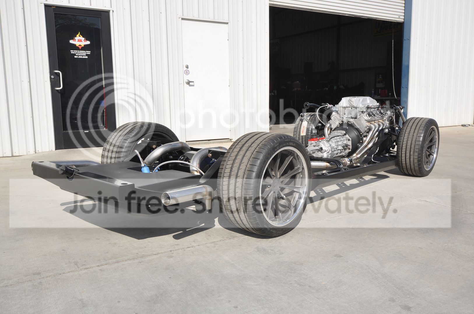

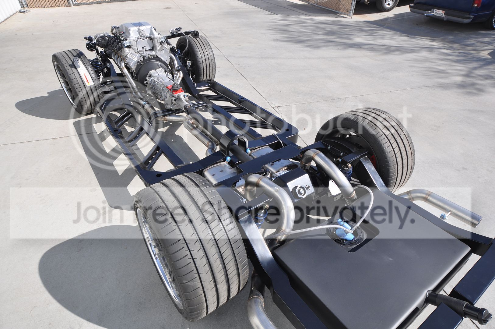

The chassis as a complete roller. There are more trick in the chassis then any frame we have ever done to get it the car to sit like it does.
http://i616.photobucket.com/albums/t...26-2013020.jpg
http://i616.photobucket.com/albums/t...26-2013019.jpg

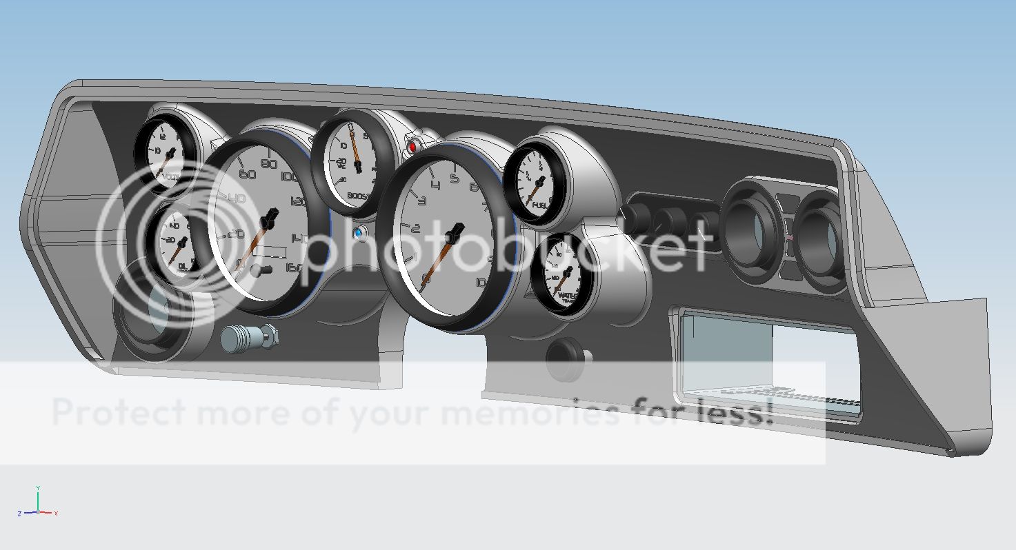

Finally if you have not seen the complete gauge cluster, it is amazing.

Looks great! Don't the down bars need to tie into a cage in order to be functional or are they just for show on this car?
ironworks 03-07-2013 06:15 AM
Ideally tying them into a rollcage would be best. But we installed them to add some front end stability and to give us a place to mount the triple adjustable reservoirs. I suppose in reality the bars should be a continuous section of the rollcage but that would require. So any of the connectors unless properly added to the cage are kinda just for show or not doing what they could. \
This car is intended as a low speed autocross car and for lots of fun on the street. So we decided the cage might be a bad idea as a street car.
WSSix 03-07-2013 06:50 AM
Thanks Rodger. I had always thought that was the case given how thin a firewall really is. I just wasn't sure.
ironworks 03-07-2013 07:40 AM
The firewall is quite thin but we purposely landed the joint up high on the firewall to use the strength the kick panel floor vents create. So there is a really strong section these massive joints weld to on both sides of the firewall. granted it is no where near what a 10-12 point cage would be. But this car will be driven 99.9 percent of the time with out a helmet and if you have not heard me soap box session about rollcages in street cars, I will save you. Its on here quite a few times.

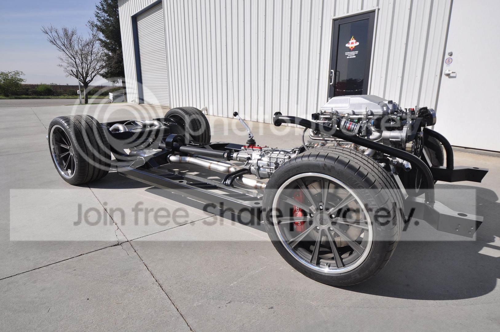

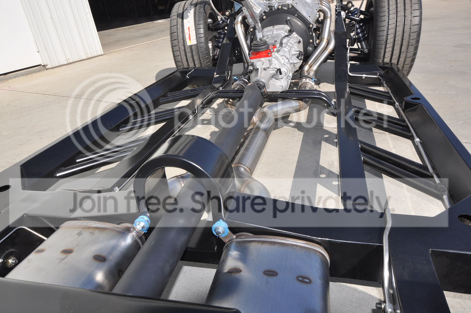

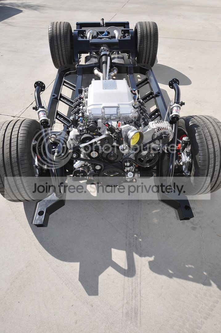

We have the chassis ready to go under the body. I usually hate installing a body on the chassis when it looks so good.
http://i616.photobucket.com/albums/t...19-2013022.jpg
http://i616.photobucket.com/albums/t...19-2013021.jpg
http://i616.photobucket.com/albums/t...19-2013020.jpg
http://i616.photobucket.com/albums/t...19-2013019.jpg
http://i616.photobucket.com/albums/t...19-2013017.jpg
http://i616.photobucket.com/albums/t...19-2013016.jpg
http://i616.photobucket.com/albums/t...19-2013015.jpg
http://i616.photobucket.com/albums/t...19-2013014.jpg
I like frames like that that are just total function but in the function it just looks so ready for business.
