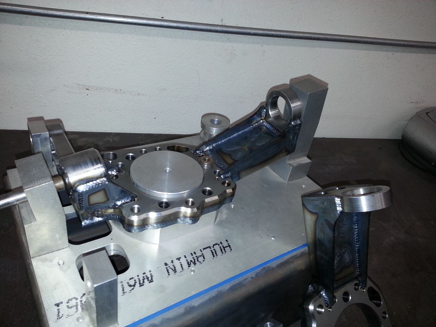

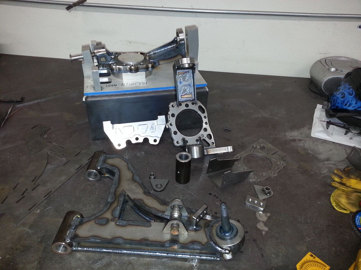

We got a new lower control arm that will now clear up to 315's on the front! The first design was creating tire rub when we went full lock to lock & had to many rack n pinion limiters.. I really did not want do a fabricated control arm but was the easiest way to get clearance..
The spindle also changed.. When we welded the caliper mounting brackets they distorted a bit.. Did not like that.. so we redesigned the caliper mount bracket to bolt directly to the machined part of the spindle plus it holds the Wilwood radial mount caliper.. It interlock for less flex on caliper mount which translates to better pedal feel.. Plus we took some weight out of it..Waiting for SKF bearing packs from Van Steel & we will bolt these on next week..

preston 03-11-2014 01:01 PM
If you don't mind sharing (and I understand if you don't)
How much does your upright weigh with brake bracket included ?
That LCA looks massive, how much does it weigh and what thickness metal is it constructed from ? The pivots look like they are sized for a stock configuration style bushing ? what are you using - delrin, poly, or rubber ?
I have always loved a proper Mopar - some of their styling was the best. Love how easily you created that front flare its massive and yet not that noticeable. Purple is a great color too.
Cris@JCG 03-12-2014 09:12 PM
Thank you for the props sir!
Originally Posted by 67XR7 (Post 541159)
I got to admit, I have talked a lot of sh!t about this car being LS powered, But seeing it in person and in action this last weekend has truly made me a fan!!! JCG has done an outstanding job on this car!!!!!
I look forward to seeing it in the future!
Uprights with caliper brackets are about 11 lbs..
Lower control arm I have not got a weight & 1/8 plate.. The pivots are our own delrin bushings with bushings.. heavy? yup.. but strong!
