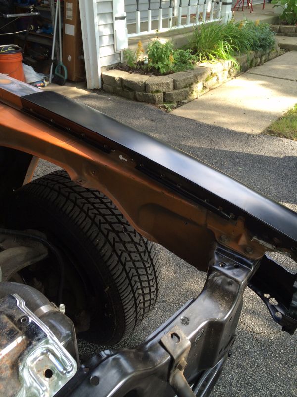

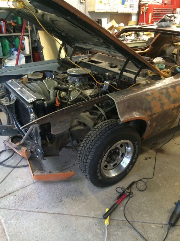

Ummmm what's going on here??? :peepwall:
http://i79.photobucket.com/albums/j1...ps241403fa.jpg
http://i79.photobucket.com/albums/j1...ps143438f7.jpg
65_LS1_T56 09-01-2014 06:18 PM
I'm guessing somebody doesn't like the way the repop fender fits to the door. He's gonna do a fenderectomy :superhack:
HEEP 09-01-2014 06:36 PM
Originally Posted by Rick D (Post 568324)
Looks like someone went a little crazy with a cutoff wheel or plasma.....
glassman 09-01-2014 06:43 PM
I'd say your going for more airflow. The brakes will cool fine with that mod IMO, but i really think your going after cooling the coils as they bounce up and down (kinda like the mattress in your master bed):peepwall:

Ding ding ding!! Yup but it was at the back of the hood that lined up real bad, the hood was almost an inch up from the back of the fender. The line to the door was to bad; workable any. Plus this way the inner structure of the org gets to stay. It's not even close to the org.
Air saw :superhack: and spot weld drill, but not crazy (well maybe the guy running it) easiest way to it fix the issue in the end.

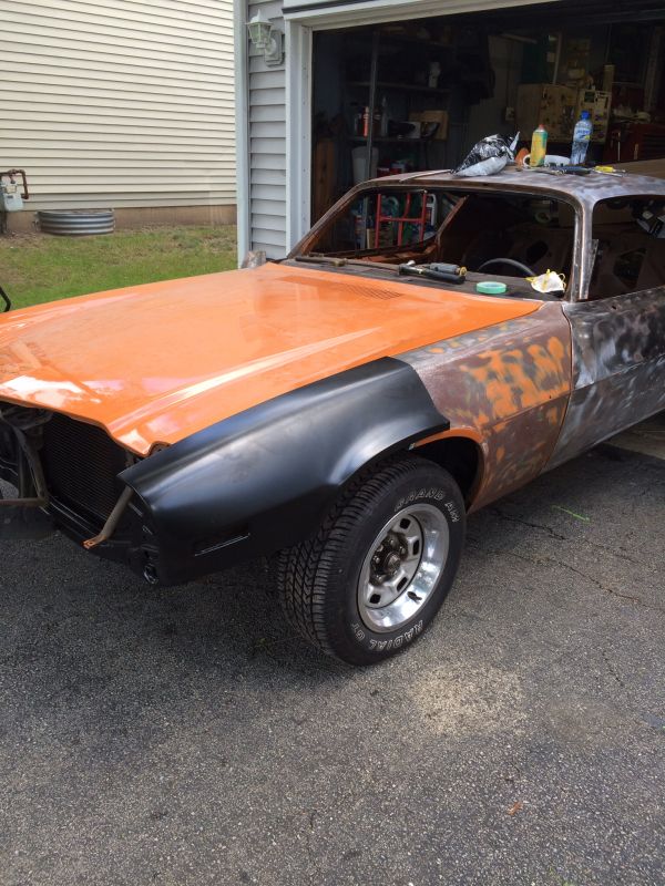

Rick D 09-02-2014 04:15 AM
So the fender didn't line well to the hood, so it was either drill out all the spot welds at the top of the A/M fender and try to over it up and move the cage nuts down for the hood hinge or just use the front of the A/M fender as a patch panel :superhack: so as you can see which idea won, this will be the easiest fix in the end.
I also get to keep my org inner structure of the fender which the A/M doesn't look anything like:EmoteClueless: and I get a much better fitting fender. I should be all wrapped up with this part by next weekend. Then it's on to the rear end of the car!!!
More of this :superhack: to come!!
