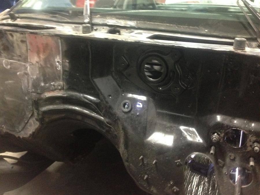

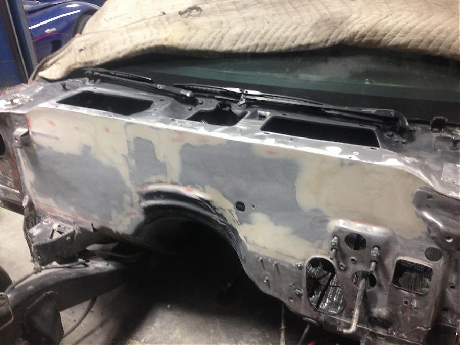

Originally Posted by chichirone (Post 577517)
I finally found the pics.

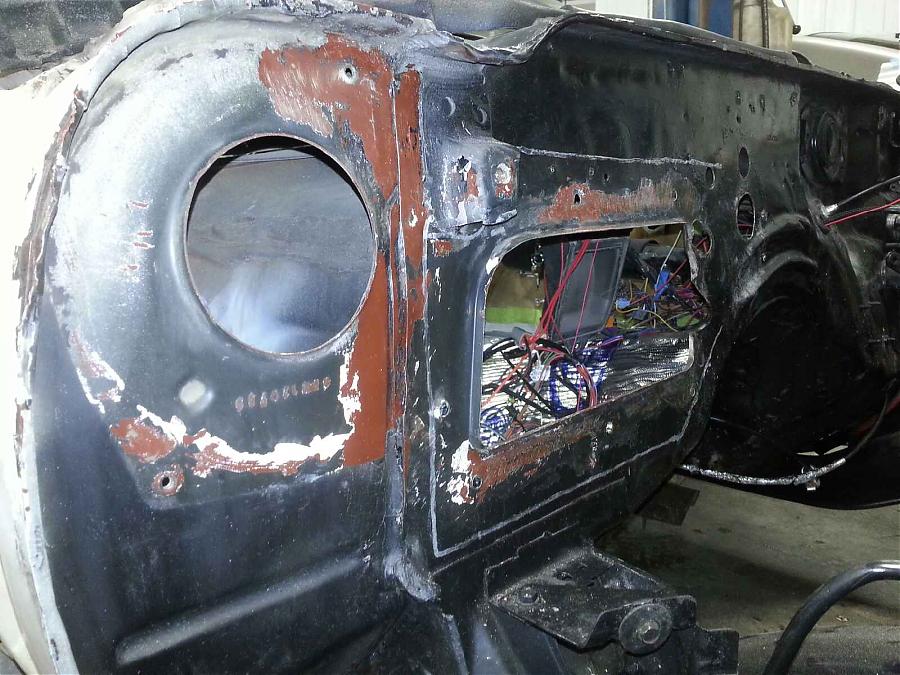

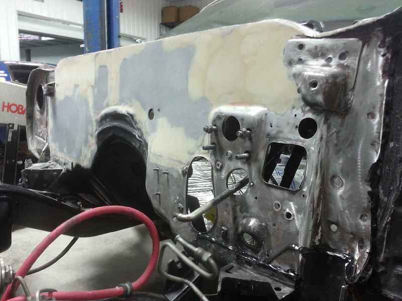

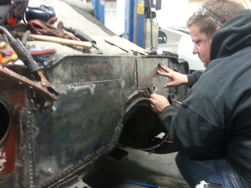

Relocated the DSE wiper motor to the firewall under the driver side front fender.
http://i1372.photobucket.com/albums/...s40ade019.jpeg

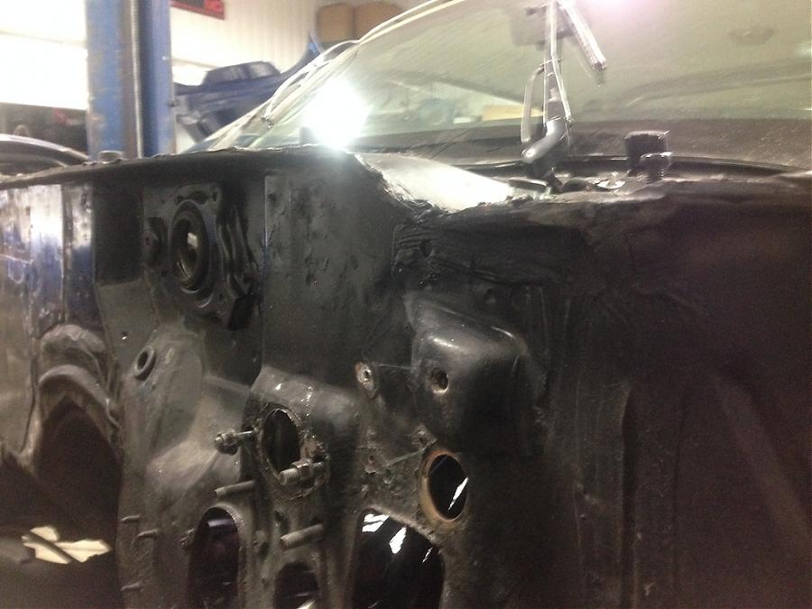

A hole was cut into the shell to gain access to the wiper arms, brackets and wiper motor.
http://i1372.photobucket.com/albums/...s906341bc.jpeg
Its a little hard to see but the wiper arm has been extended across the cowl to reach the wiper motor.
http://i1372.photobucket.com/albums/...sa22b6383.jpeg

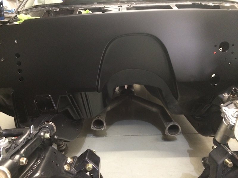

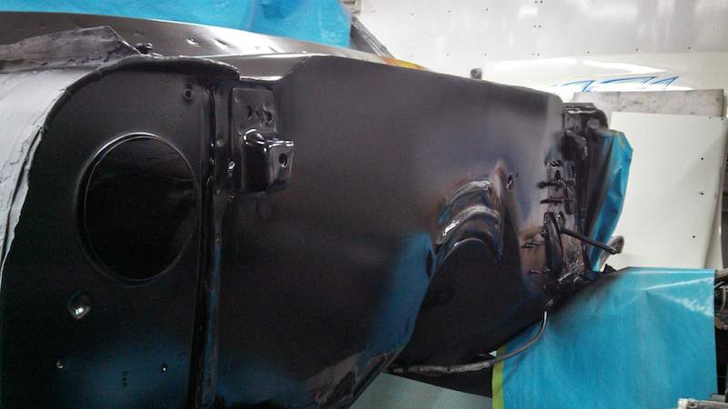

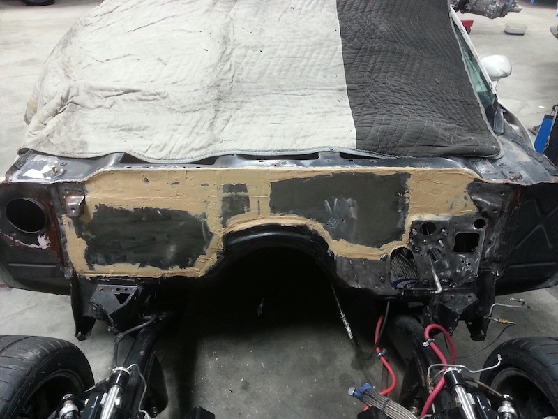

Smoothed firewall after relocated wiper motor. You can see it covered up for paint work.
http://i1372.photobucket.com/albums/...sce425784.jpeg
Awesome, thank you. I think I will do the same thing.

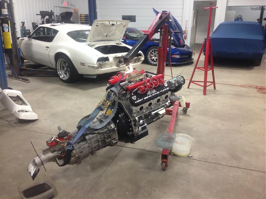

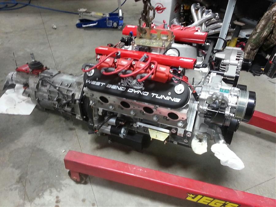

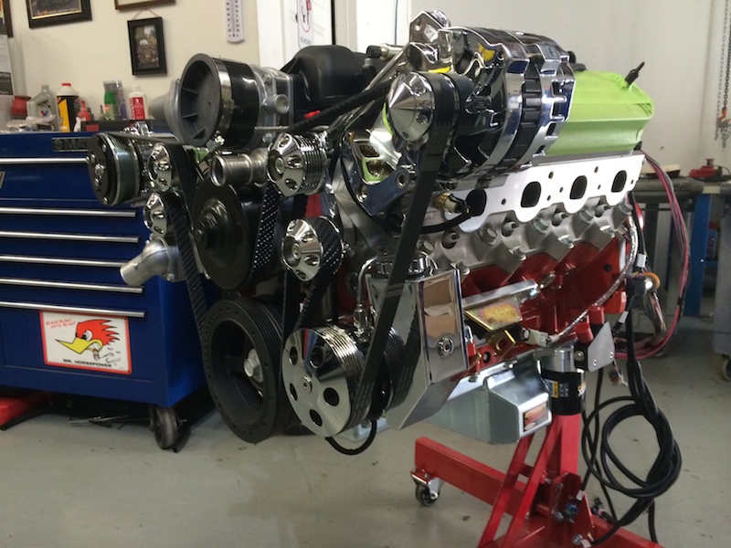

Our buddy Brad Reikkoff from West Bend Dyno just sent me this picture of the KLRBRD engine in MSD's catalog for the Atomic EFI. Pretty cool.
Attachment 51168

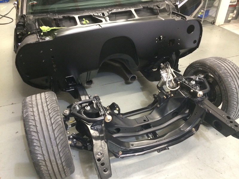

The Ridetech airbar and driver side frame rail broke. Looks like we will be rebuilding the rear suspension...any ideas?

Define broke ?
Frame rail failure where the bracket mounts ?
chichirone 02-14-2015 08:07 PM

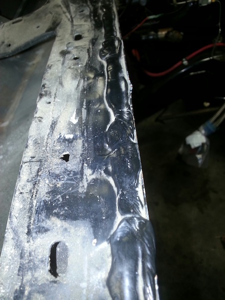

Yes...on one side the frame rail split where bracket mounts (welded not bolted in) and on the other side the Airbar separated from the UCA mount plate.
syborg tt 02-14-2015 08:14 PM
Similar to this I assume.
Before we installed mine I spoke with my chassis guy and he suggested a few stitch welds. He felt the full weld was the cause of the failure.
And also the obvious fact that the rail was never designed to carry such a load.
http://tapatalk.imageshack.com/v2/15...36c931720b.jpg
http://tapatalk.imageshack.com/v2/15...bef3ab478a.jpg

Looks very familiar. What did you decide to do as a remedy?
Vince@Meanstreets 02-15-2015 08:02 PM
yeah, when welding them in you want to avoid the corner of the frame rail. I use the bolts and then run a few 1" beads on the flats only.
