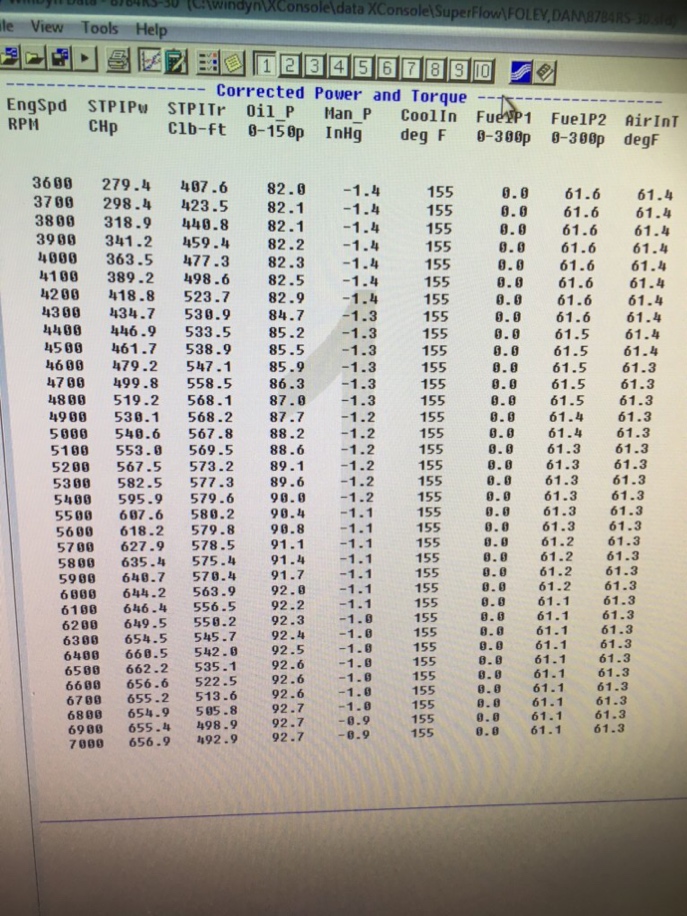

GregWeld 02-21-2019 04:34 PM
1 Attachment(s)
I just realized I hadn’t updated this thread...... I must be getting old!
Motor dyno’d and is shipped back to SpeedTech already.
This is a proven combination of parts etc — seems Brian Finch - Chris Smith (Smitty) - and I have the same basic motor. Smitty and I have the same exact cams even and his dyno’d the day after mine — Here’s the dyno sheet.
THIS is not the final dyno sheet — it actually made 666.7 when final tuning was done
Attachment 68464
Sent from my iPad using Tapatalk Pro
