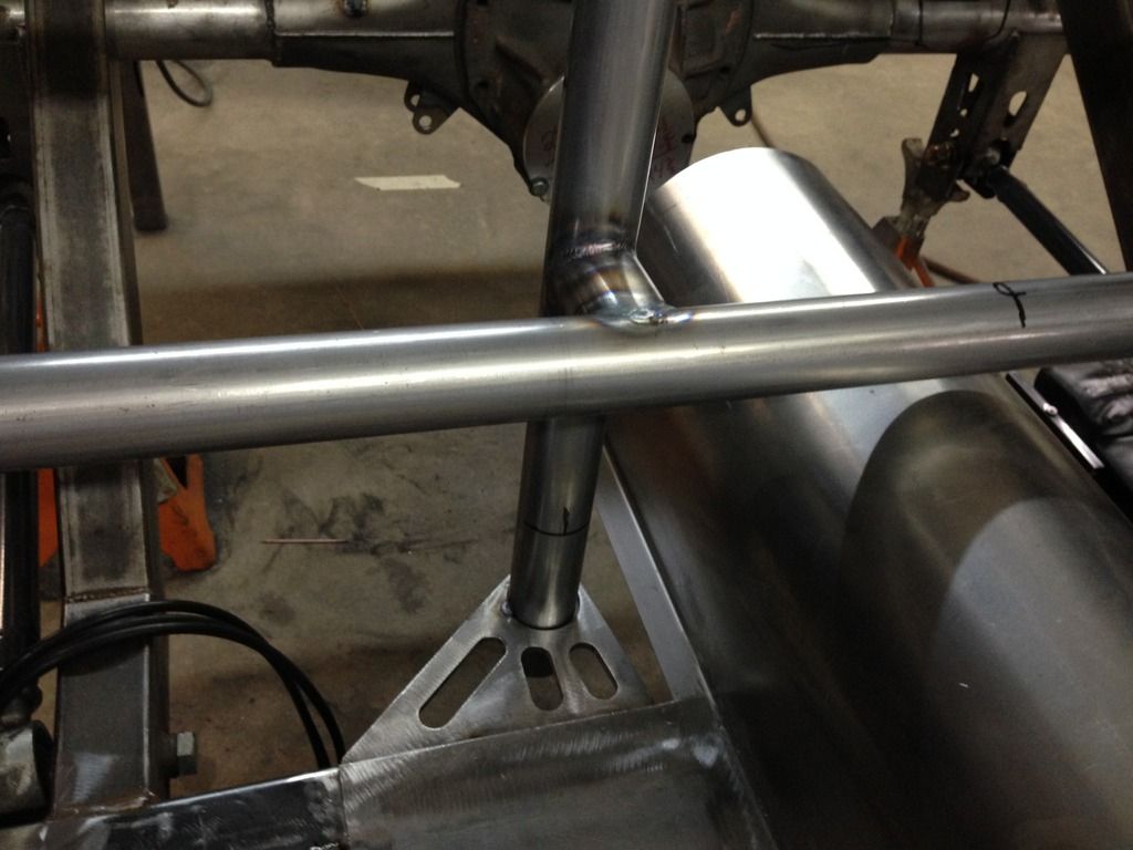

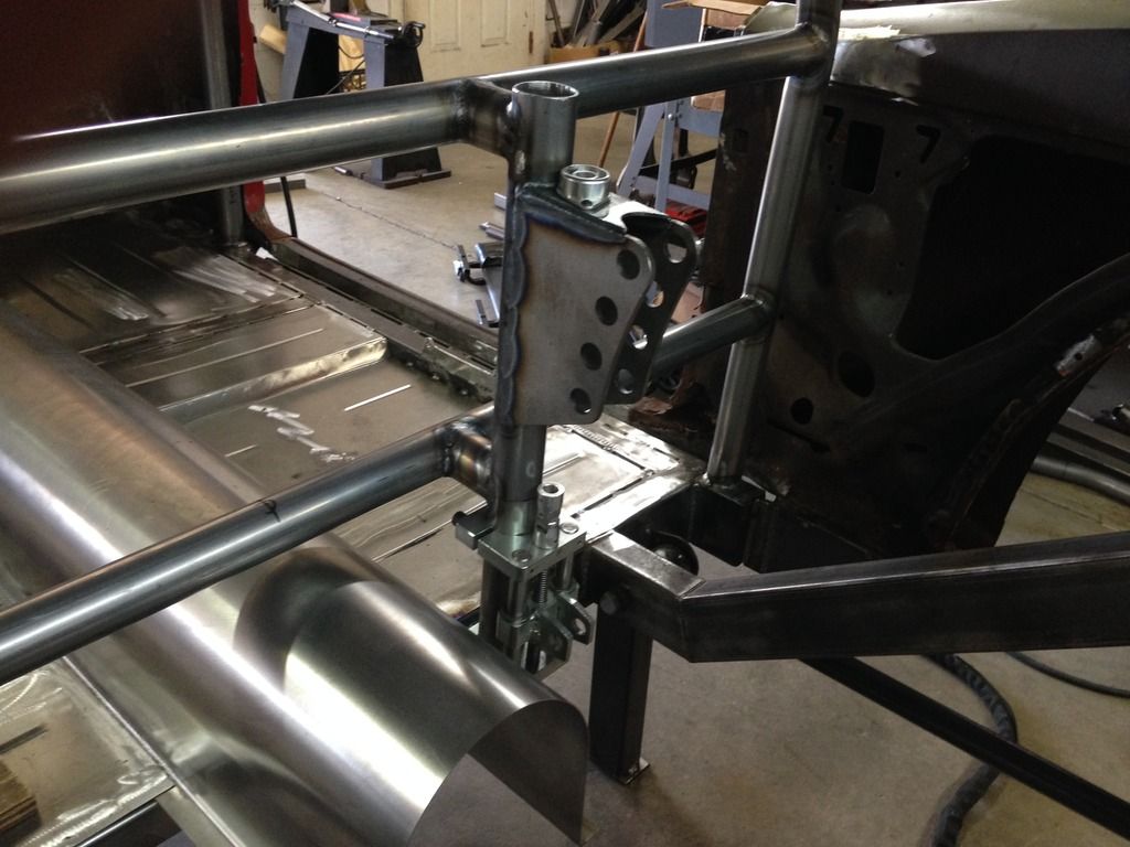

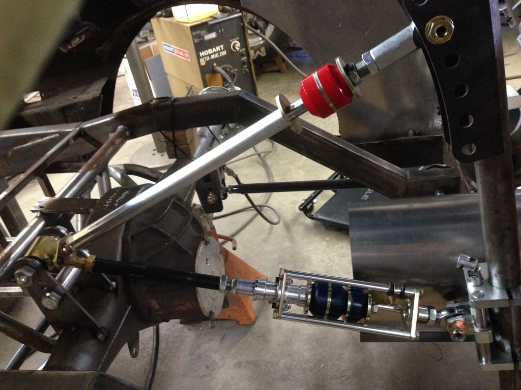

Some parts have been used and some have been new. My braking system is all new stuff and so is all of the suspenion. As an expample, the rods that I have for the motor are $3600 new. I got them from Roush with 3 test dyno pulls when they were working on bore and stroke combinations...$600.
Do you consider that used or tested? I call it a bargin.

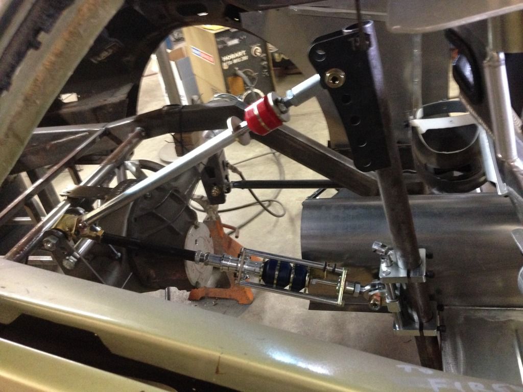

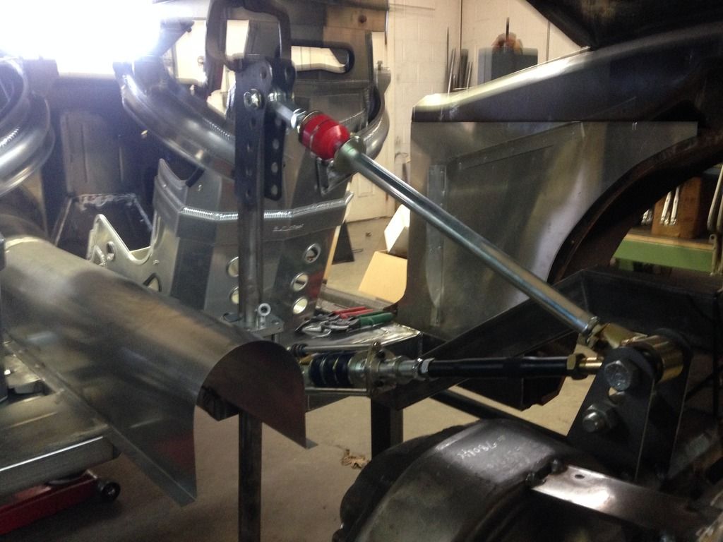

Ron Sutton is working with me for front and rear suspension design and car set-up.

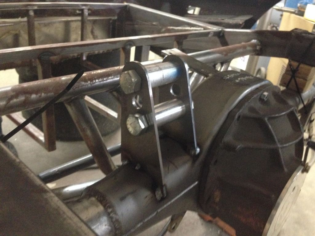

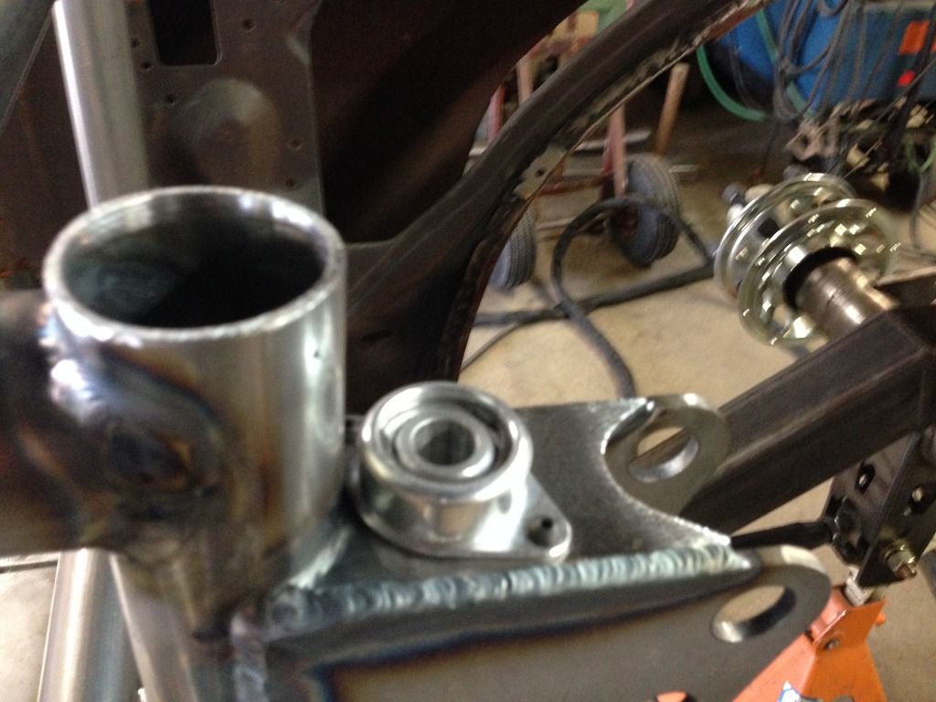

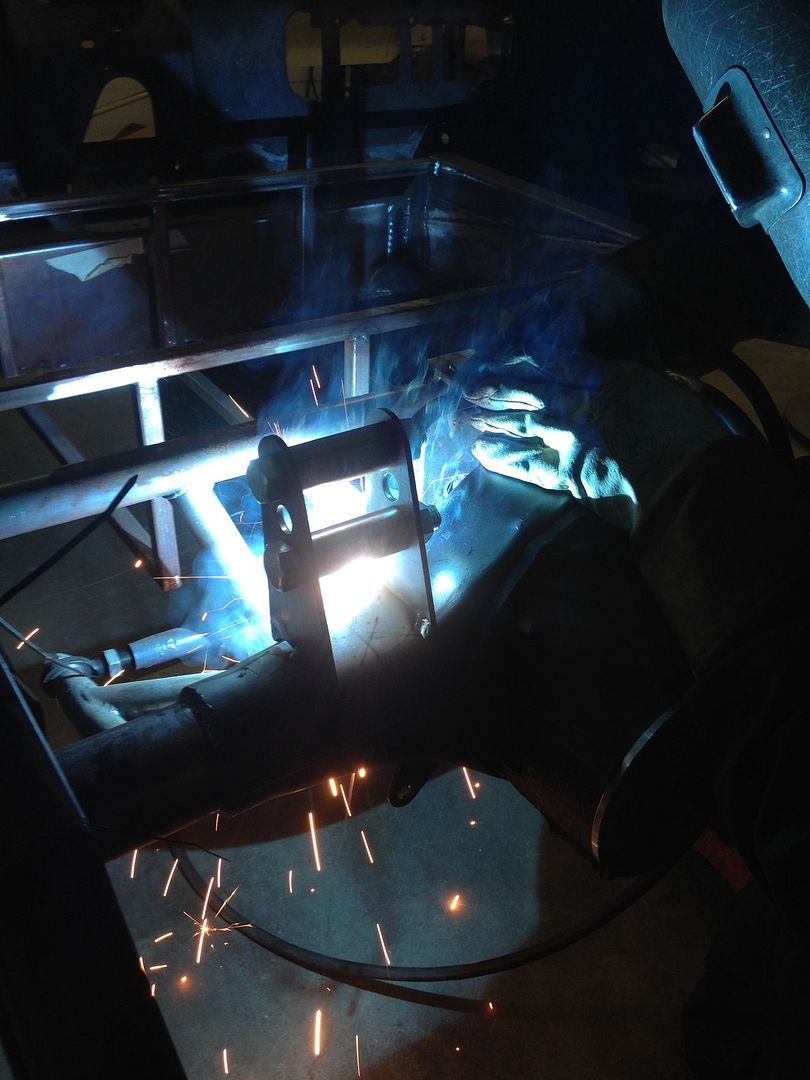

Which goes right into my next few pictures of the decoupled 3 link mock up. Sutton took my information and made a blueprint for the install. After installing the housing mount I had see what it looked like.
http://i1138.photobucket.com/albums/...psmb6jwpfx.jpg
http://i1138.photobucket.com/albums/...psizbxcwux.jpg
http://i1138.photobucket.com/albums/...psa5gtseqj.jpg

http://i1138.photobucket.com/albums/...psqswxwby9.jpg
http://i1138.photobucket.com/albums/...pszofttksf.jpg
http://i1138.photobucket.com/albums/...psyrisrxjh.jpg
http://i1138.photobucket.com/albums/...psoand5f6p.jpg
http://i1138.photobucket.com/albums/...pskzusyaop.jpg

WOW! Coming out BADA$$

Damn that's cool. You're heading in the right direction.

Payton - Damn nice recovery since your discovery of the limousine wheelbase. :thumbsup:

You going to have wedge and trackbar adjusters in the rear window?

Thrift car
Payton,
very cool stuff.. you can actually see the angles Ron and the boys
talk about in real life fabrication
I thought my cutting the swaybar and adding new tabs was
an undertaking.. not even close
Bob
