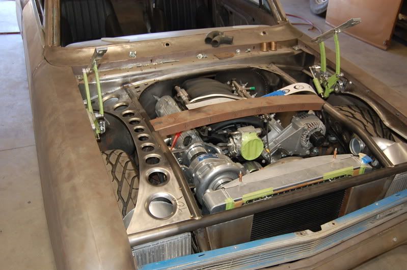

Engine Bay Gusset
http://i56.photobucket.com/albums/g1...26-2008019.jpg
I was thinking of leaving it like that but Rodger would like to add a solid sheetmetal piece that will clear the hinge. Wadda ya think?
John
ArisESQ 09-09-2008 03:18 PM
you could probably run a pretty seriously pumped up LS3 for the cost of that LS7... but then again, maybe with all the trouble you'd have to go through to arrange/make the swap it wouldnt be worth it.
