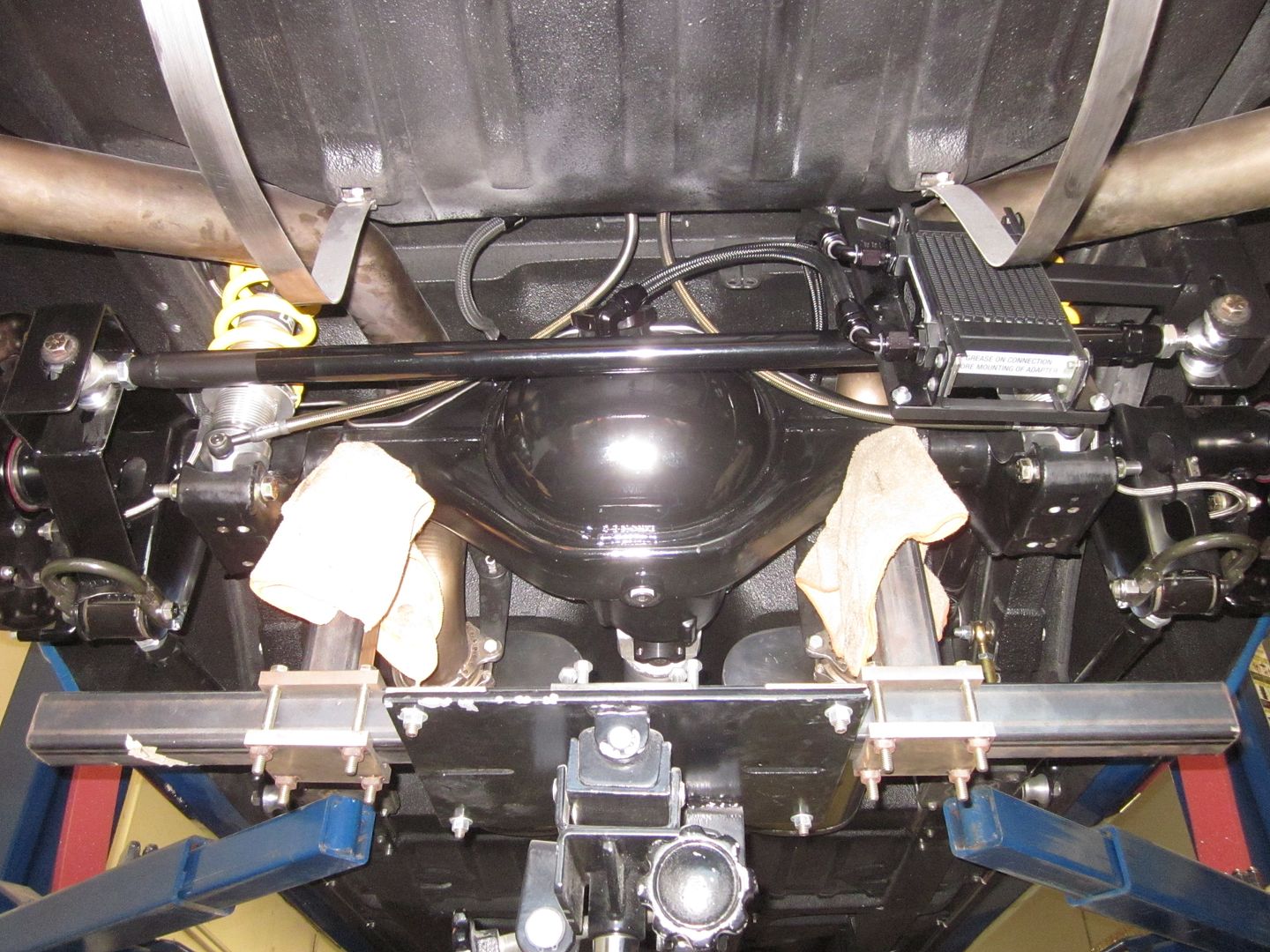

Cris@JCG 02-15-2013 06:20 PM
I have a C&R unit that has a Tru Trac in it with the internal pump .. No problem on the replacement of the locker
Now why would you get a unit like this.. a built in pump for cooler & not run it.. i recommend that you run it.. Also when you vent the diff.. try to run a -10 hose.. it will help with pressure the diff builds.. here is pic of the one I did on Blu...

carbuff 02-17-2013 09:36 AM
Good to know...
Cris,
Does that cooler get much airflow? Tucked up against the gas tank like that, it's hard to see how much air would get through the fins? Or is the cooling in this case less about flow and more just about surface area to dissipate the heat? You aren't running a temp gauge on the diff, are you?

carbuff 02-17-2013 06:46 PM
Originally Posted by Flash68 (Post 465296)
I can't see why one would install a system like this and not monitor temps. I'll surely run a diff temp gauge.
Where does one install the temperatur probe for the differential? I presume it needs to be at or near the bottom to stay 'in' the fluid... I'm not sure if I've seen one before...
intocarss 02-18-2013 01:50 PM
I'd bet you can attach it to the out going line to the cooler
carbuff 02-18-2013 01:56 PM
Agreed, but in Dave's case, and more importantly, mine :D , we will neither have coolers, at least to start. So I was wondering, if I wanted to run a gauge to monitor the temps to decide if I need a gauge, how I would go about it?

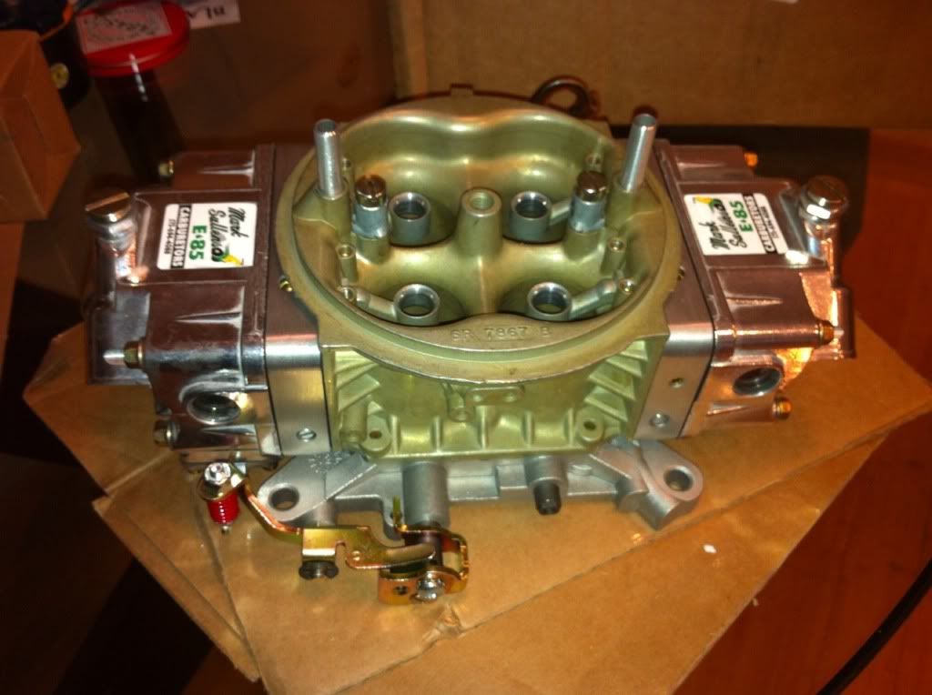

Ok more parts coming in as I wait for the big pallet gets here.
Did lots of research on E85 and came with this guy as my carb builder. Braswell and Hendrick Motorsports have had him do work for them.
http://marksullense85carburetors.com/
It's a Holley 950HP main body with numerous modifications for E85. Due to E85 requiring approx 30% more volume than gas, it has #97 jets in it. The relatively small 1.375" venturi size is intentional for excellent throttle response and mid range torque, and it will be a sacrifice of hp on the top end. I figure I got Rob beat on hp by a mile, so I am going after the torque to make it a sweep. :D
http://i236.photobucket.com/albums/f...ps84779a1e.jpg
And of course an update here would be incomplete without some Nascar reference of some kind. Got some carbon fiber brake cooling ducts that fit over the lower valance openings almost perfectly. $35 on ebay. And yeah it's Toyota stuff, what can ya do.
http://i236.photobucket.com/albums/f...psd2e940b2.jpg
The engine is ALMOST ready to the front of the line. All the engines that have race deadlines move up to the front at the shop Mike said. I told him I have a really important dyno contest on the internet I am late for -- does that count?
Oh BTW, that little 781 cube motor ONLY made 1540 hp and 1200 ft lbs. They were pretty disappointed actually. :rolleyes:

Originally Posted by Flash68 (Post 466152)
That E-85 stuff.... pretty cool being a trail blazer for this community with that. I have always had an interest in the ethanol stuff, even considered farming corn.... but then found out there is a $10,000 fine if you make ethanol without the proper goverment papers. Go figure. You can make bio-diesel. :headscratch:
I can't wait to see this carb in action on that motor. Hot diggity Damn! :D
FETorino 02-20-2013 11:33 PM
The engine is ALMOST ready to the front of the line. All the engines that have race deadlines move up to the front at the shop Mike said. I told him I have a really important dyno contest on the interest I am late for -- does that count?
Imagine if your motor ever actually runs how excited you'll be.:mock:
That carb looks tiny
Originally Posted by 67zo6Camaro (Post 466154)
That E-85 stuff.... pretty cool being a trail blazer for this community with that. I have always had an interest in the ethanol stuff, ! :D
I have to give DG credit for that E85 idea. Too bad for him my motor will run on it while his is still a pile of parts.

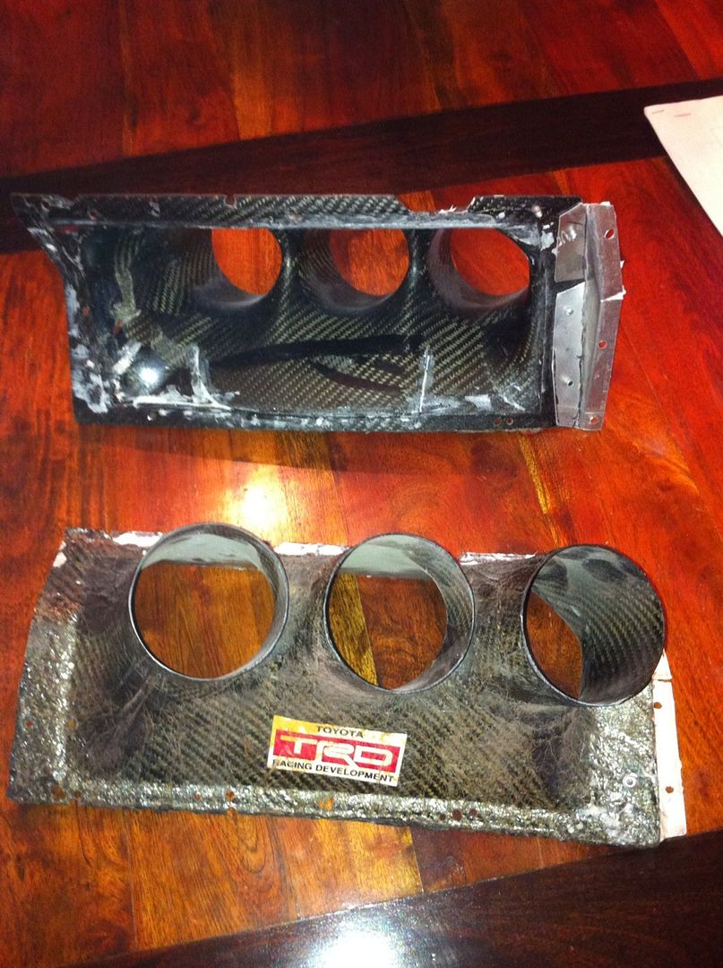

XLexusTech 02-21-2013 07:54 AM
Can you share the Ebay info/Seller/store.. i may be keen to pick up some of those TRD items.

Originally Posted by carbuff (Post 466188)
Well, I won't have a cooler at this point, so I can't really use it. ;) Perhaps you can?
I think I'm going to have Eric weld in a temp sensor probe on the housing, maybe on the lower front area so that the probe would come out facing forward. The sensor itself is pretty small, so it should fit ok. The housing is out right now for some underbody paint and cleanup before final install, so now's the time. :)
I'll snap a pic of where my fitting is on mine when I receive it... looks like early next week.
dano610, but search "carbon fiber brake ducts" and there are 40 options on there right now. Some really cool pieces from Hendrick just showed up.
