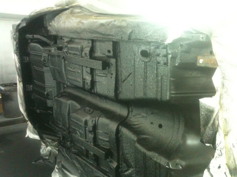

2nd Chance Camaro - Line-X Protective Coatings
2013 06-10 2nd Chance Camaro - Line-X Protective Coatings
www.2ndchancecamaro.com
Good Evening,
Now that the body work is complete Kenny applied the Line-X protective coating to the underside of the car because I plan to keep and
drive this car.
... and yes Kenny is taking pictures again so there will be an immediate downgrade in picture quality so don't try to adjust your screen.
http://garagescene.net/_data/i/uploa...42f01e0-me.jpg
www.linex.com
