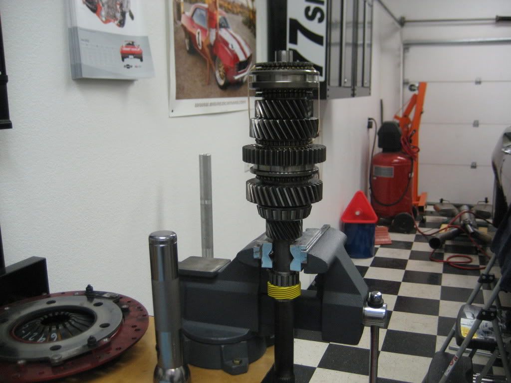

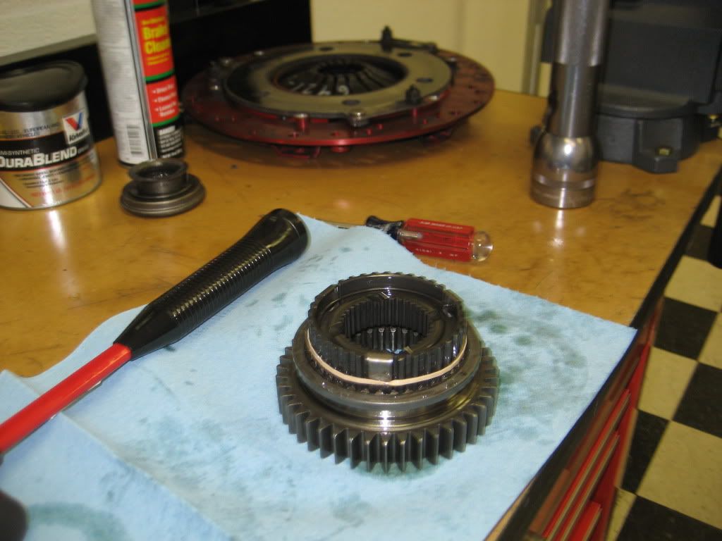

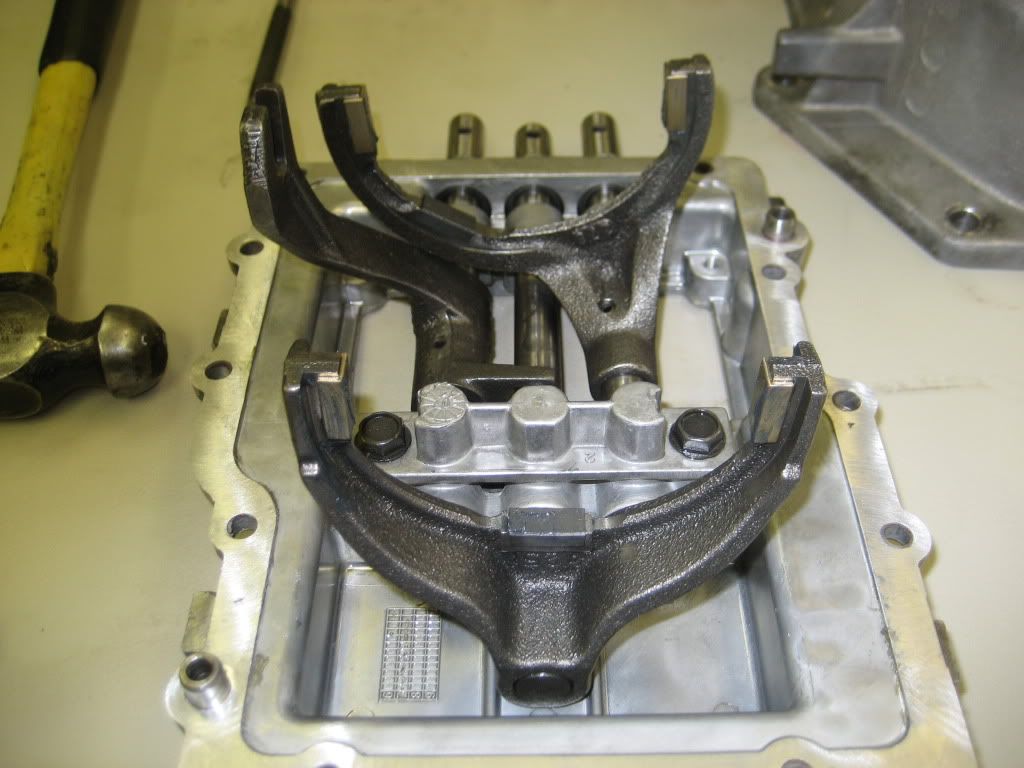

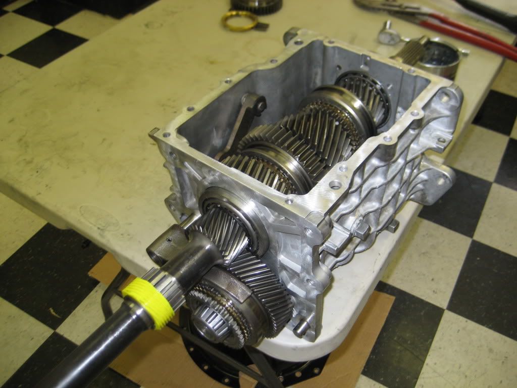

This is a finicky piece. The teeth were chewed up on the 2nd gear side so I ordered the new slider. It wouldn't mesh with my old gear so I ordered the slider/gear assembly. The gear didn't want to play nice with my mainshaft so I ended up using the new slider and my old gear.
http://i200.photobucket.com/albums/a...1969/003-9.jpg
I reassembled the main shaft in the vice. Also pictured is the main shaft assembly and 5th installed.
http://i200.photobucket.com/albums/a...1969/005-5.jpg
http://i200.photobucket.com/albums/a...1969/010-1.jpg
This picture shows the broze shift pads on the outer fingers of the 1-2/3-4 shift forks.
http://i200.photobucket.com/albums/a...1969/008-6.jpg

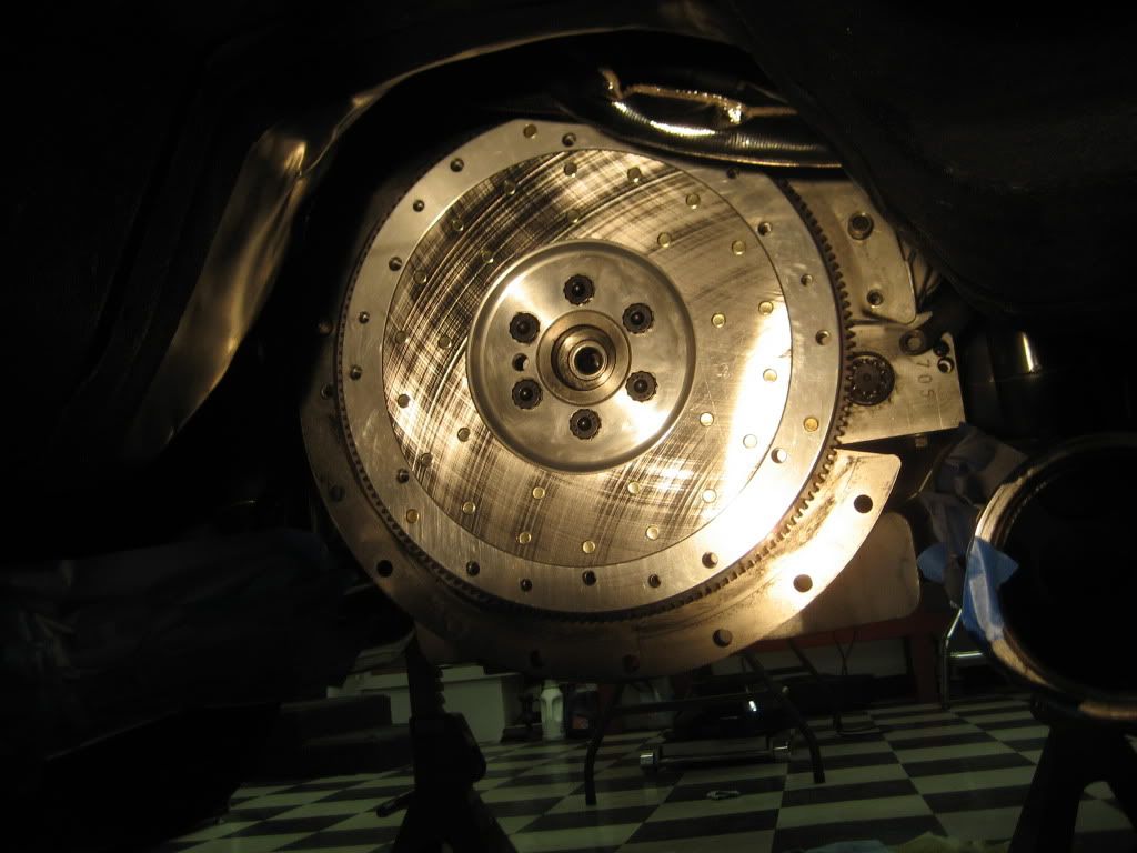

As usual, I can't leave anything alone. I decided to swap to an aluminum flywheel. I had Jason Pettis balance it before sending it my way. He always recommends balancing anything from a manufacturer.(Clutch pack, flywheel) He has better equipment and always finds them to be out of balance to some degree. The old steel flywheel was 30 lbs. The new McLeod aluminum comes out to 14 lbs.
http://i200.photobucket.com/albums/a...969/003-10.jpg
The trans feels sharper and the shifter has really shortened the throws. 3/2 & 2/1 downshifts are definitely better. 3rd seems to find home easier while 4th/5th feel about the same. The work definitely netted me an noticable improvement. Buttonwillow next month will test out the repeated high rpm shifting. My 1-2 shift still isn't perfect. It's still the notchiest gear but it has improved. I'm going to adjust the clutch a hair tighter for more disc disengagement. I'm happier with the trans and that was my goal. :thumbsup:
I regards to the aluminum flywheel. I love it!!! This engine isn't radical and it eats up that aluminum flywheel with NO problem. I can still take off with very little throttle. It's really changed the whole feel of the car. It revs so much faster and has really upt the anty in terms of a performance feel. The car even seems to take off better. It's crisp and more fun to drive! RPM matching is easier. Man, I wish I would've done this a long time ago. High reving big block torque and aluminum flywheels should sleep together every chance they get! :thumbsup: :thumbsup: :thumbsup: :D It just doesn't feel like 489 cubic inches..... I can't wait to drive it again.
