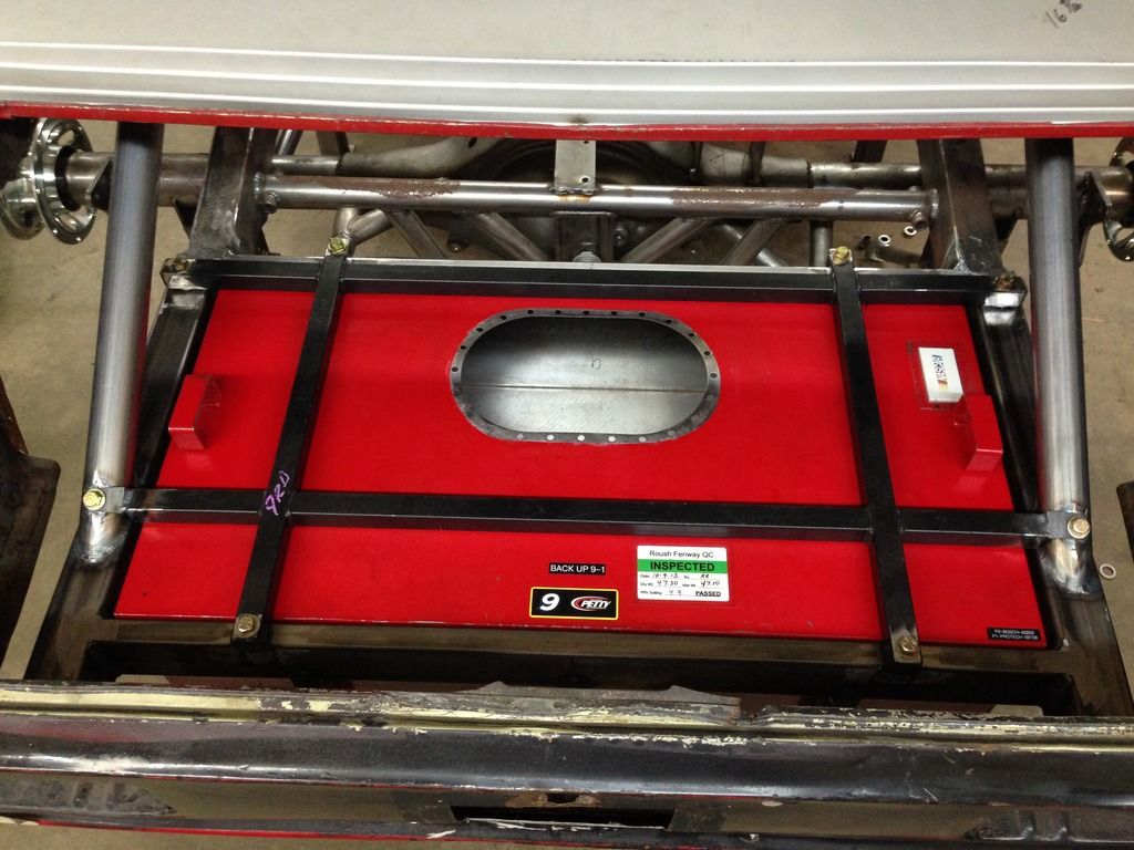

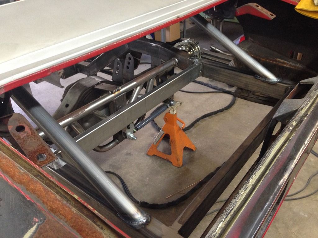

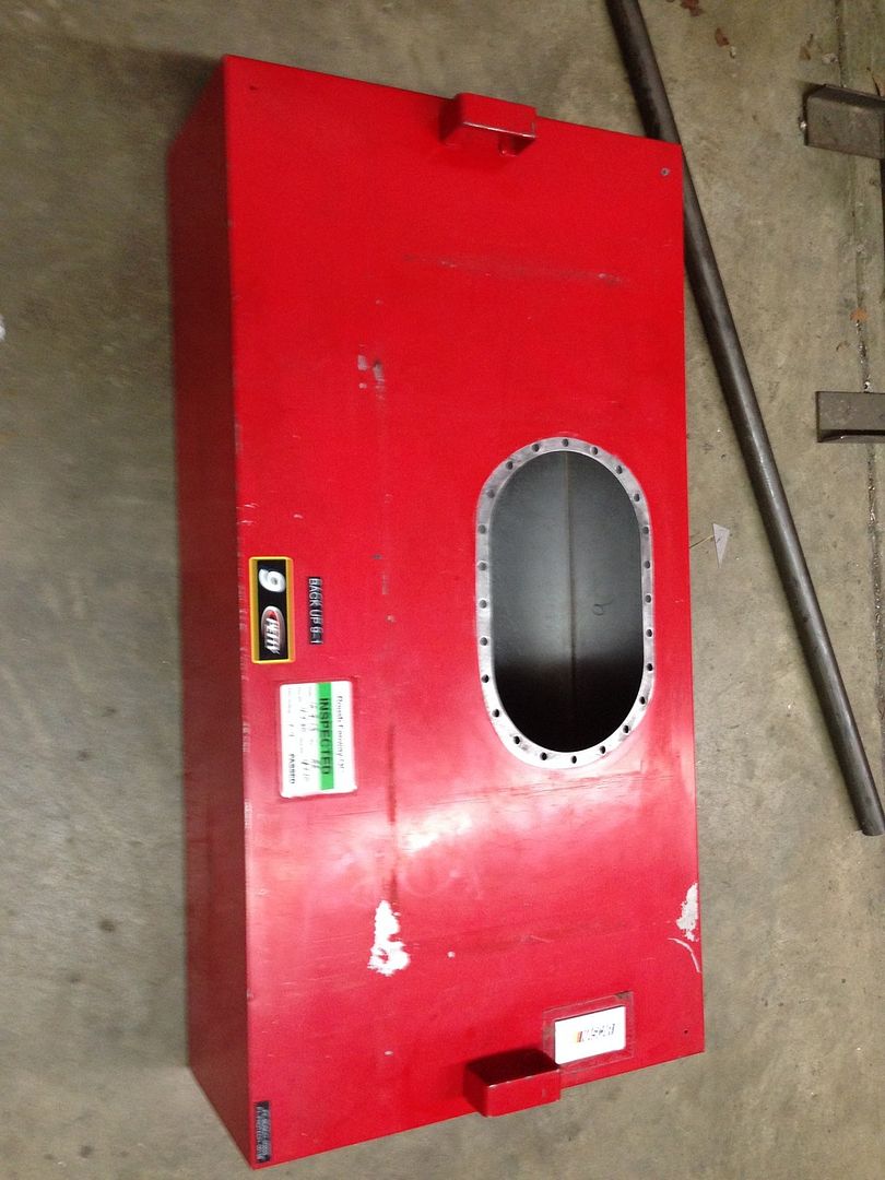

So just like about everything else on this car. The place for the fuel cell was made to a dimension that no off the shelf fuel cell would fit. We also did not like that there was no protection for the cell in the event of a rear impact.
The rear section was cut out and re-made.
http://i1138.photobucket.com/albums/...pslp6ujdgw.jpg

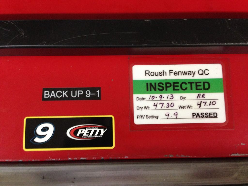

One of the benefits of living in Charlotte is all of the used NASCAR parts as previously stated. I picked up this used can for $50.
http://i1138.photobucket.com/albums/...psmnoj7xig.jpg

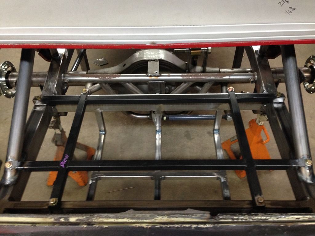

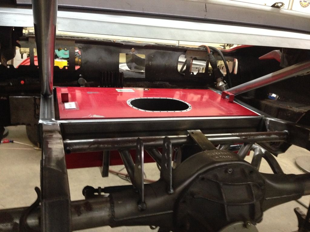

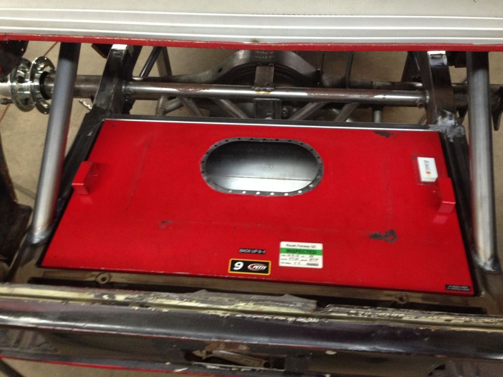

Can in place and ready for top bracing
http://i1138.photobucket.com/albums/...ps9hc30okj.jpg
http://i1138.photobucket.com/albums/...ps8h2or0yh.jpg

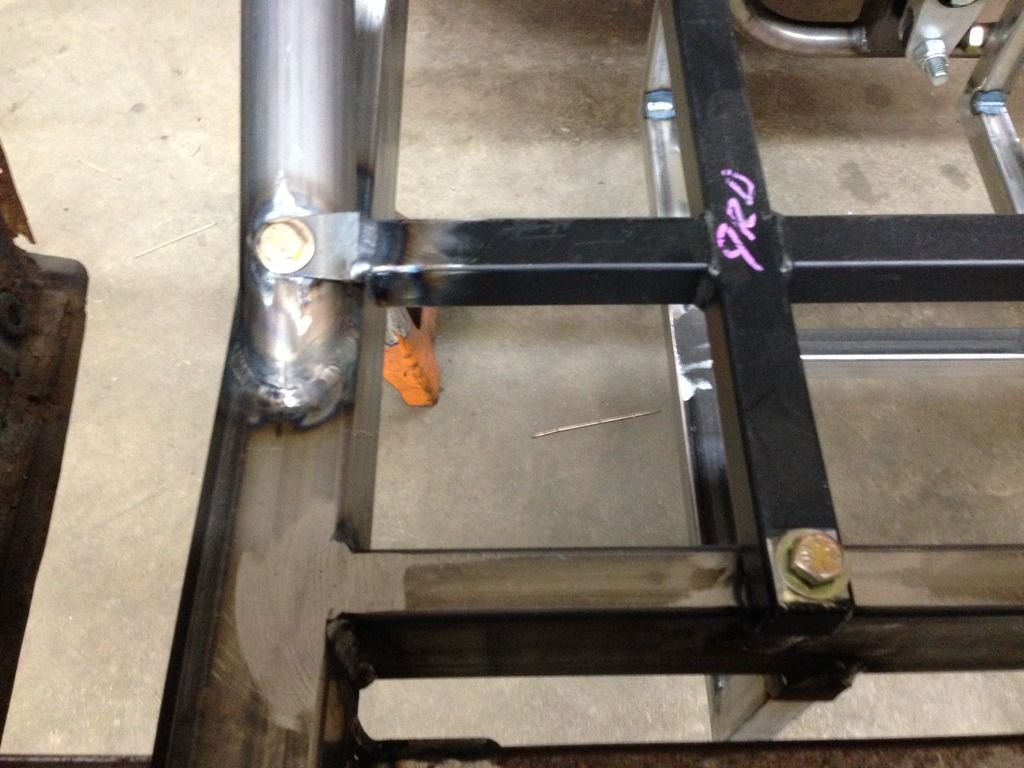

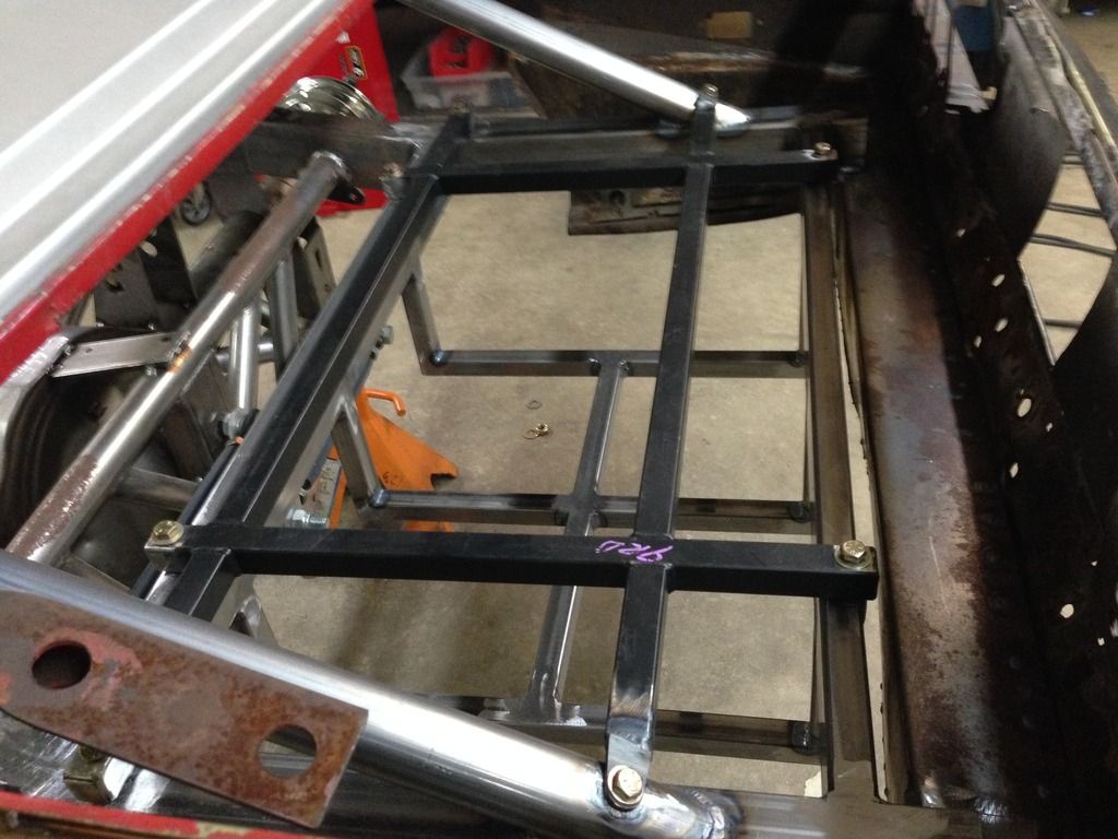

This is the finished top portion.
http://i1138.photobucket.com/albums/...psxpspjt28.jpg
http://i1138.photobucket.com/albums/...psemaeqf9e.jpg
http://i1138.photobucket.com/albums/...pskwgbfwss.jpg

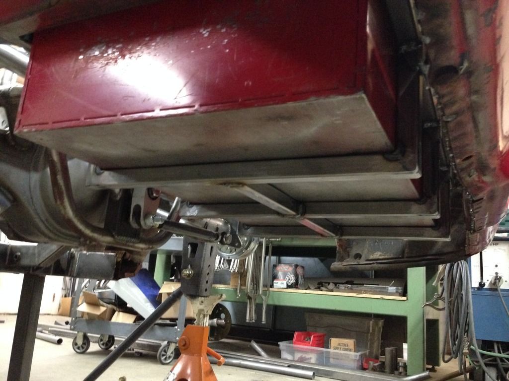

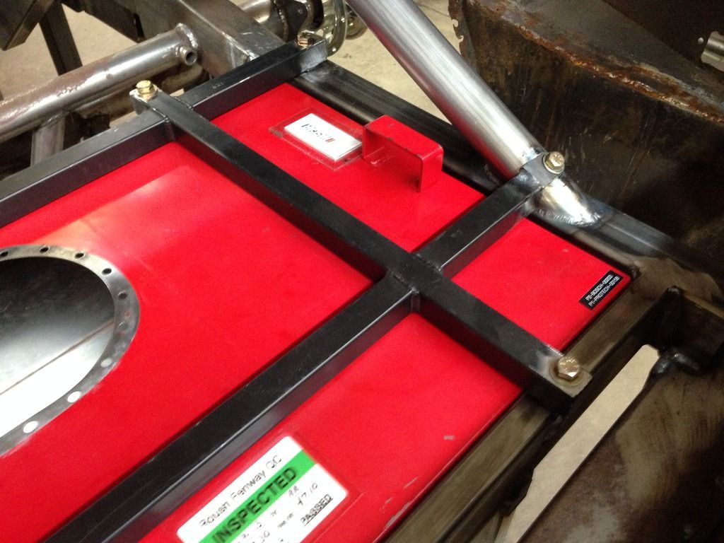

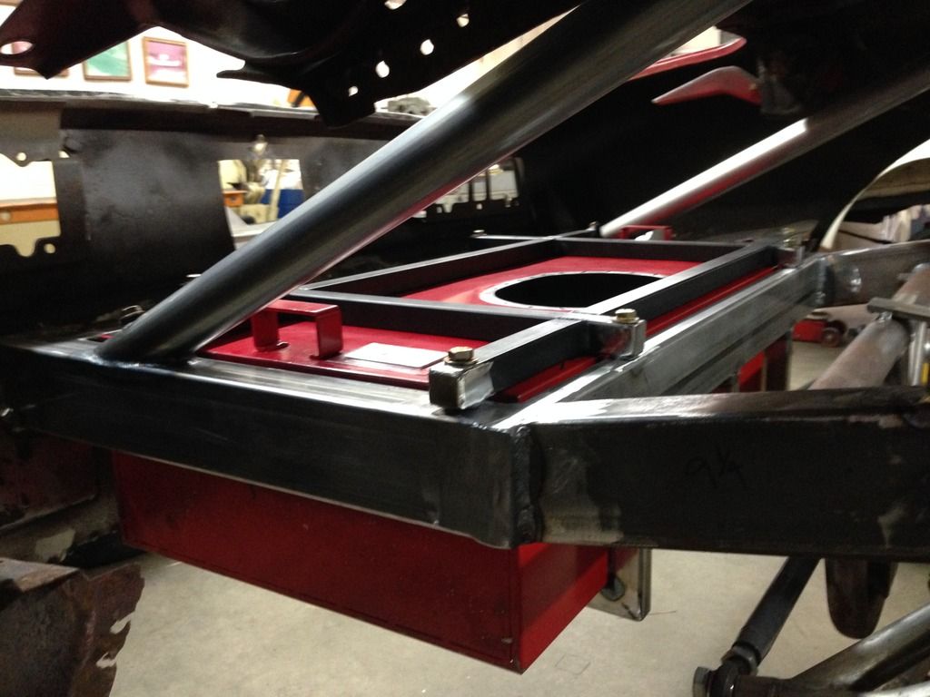

All bolted together
http://i1138.photobucket.com/albums/...psva9ve2hl.jpg
http://i1138.photobucket.com/albums/...psbnl4gihg.jpg
http://i1138.photobucket.com/albums/...pslmenmwbr.jpg
http://i1138.photobucket.com/albums/...psfja5rpja.jpg
http://i1138.photobucket.com/albums/...psiymlxvet.jpg

WSSix 03-26-2015 07:31 PM
Will there be any of that foam or other material to prevent fuel sloshing put in there, Payton? I know nothing about a NASCAR fuel cell. I just figured there would be something in the tank to help keep the fuel around the pump.
Car's looking good as always now that it's in capable hands.
Sieg 03-26-2015 08:50 PM
Looking great Peyton :thumbsup:
What's the capacity of the can?
