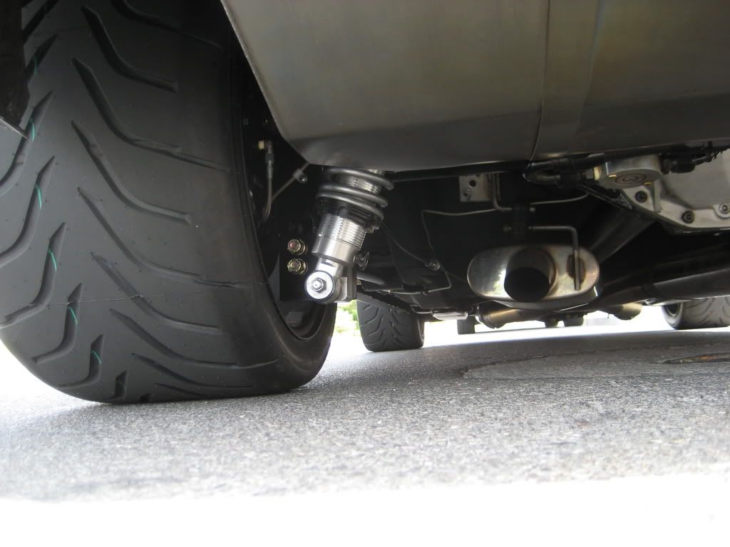

Hey Todd,
Just caught back up on this thread and wow, your car is performing great.
I took a break from mine for a bit after the mad thrash to get it on the road and I'm discovering that working out the bugs can be tougher than building it in the first place...so I admire your perseverance.
Now that it you've had them awhile, I wanted to follow up on your rear springs...are you still happy with the 275 springs in the shorter length? How do they ride on the street?
I'm running 200/12 inch spring on my tri-4 bar and feel they're way too soft...

Jason, I am happy with the springs. They ride fine on the street with the shocks dialed down between 0-2. When I lowered the car .25" two weeks ago, I had to safetly wire the spring to the shock body due to a small gap between the adjuster collar and spring at full extension. I've autocrossed and road raced and haven't encountered any issues.(I have 2.25" compression and 2.75" of rebound) I really depends on your setup. If you have a rear sway bar, going to this stiff spring will require the removal of the rear sway bar. Feel free to PM me any questions....

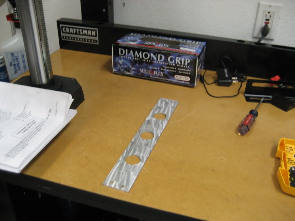

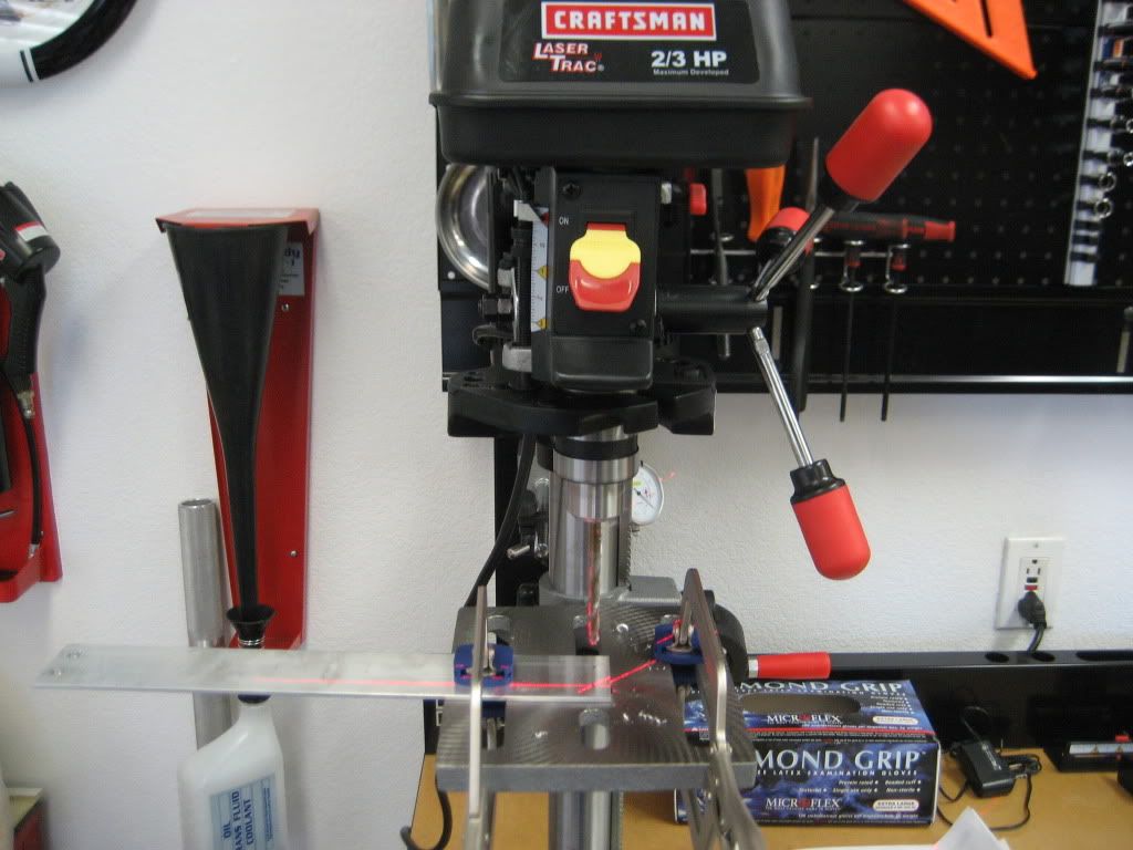

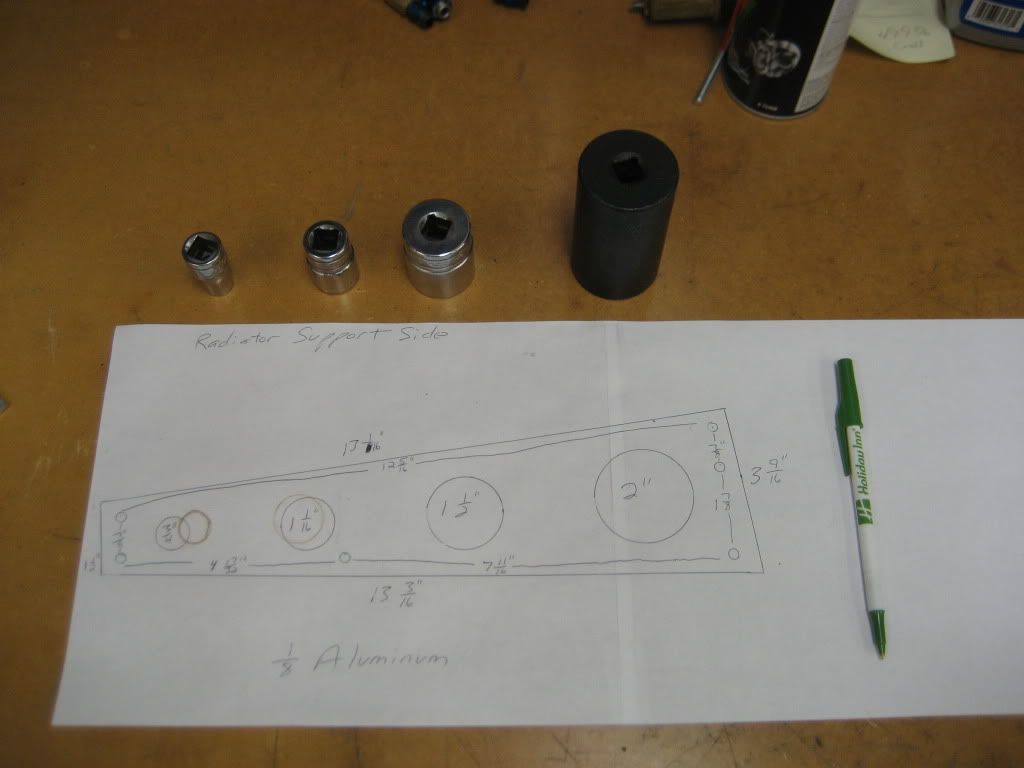

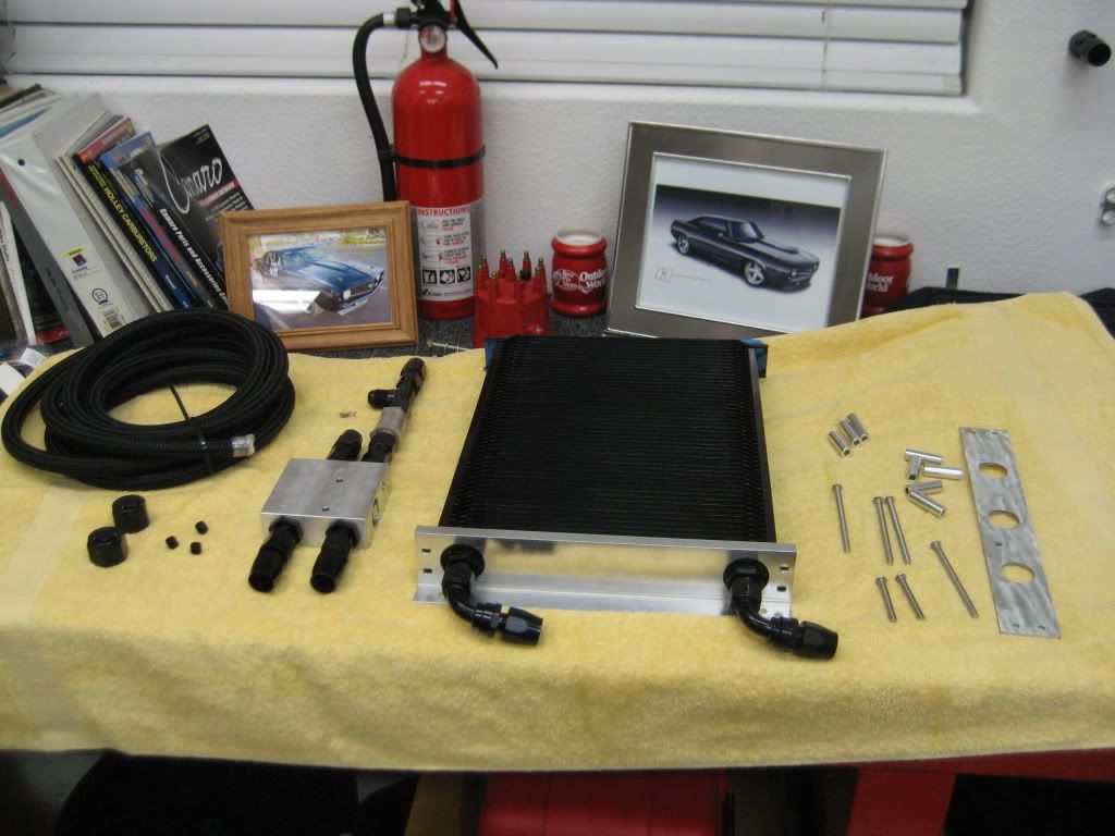

Back to the fastest black 69 Camaro on the planet. :lol: I'm trying to stuff a full size truck in a compact spot. If you read my thread, you know that my oil temps were getting a little toasty at buttonwillow. Since I have to plumb in a larger oil cooler, why not over engineer it right? Honestly, my thought is that it will help keep the engine cooler in these brutal Summers as well. I may install a fan later below the grill opening to aid in high heat conditions. Also, I'm switching over to a full synthetic red line oil. My engine builder, Jason Pettis, said go for it and he wasn't concerned with my oil temps for that short duration. Clearly, they must come down and synthetic oil will take the heat better and keep it's viscosity. I was running a partial synthetic Brad Penn.
As usual, this project got expensive. Between the fittings, hose, oil cooler, t stat, it wasn't bad. Then I decided I needed to upgrade the shop for the project.:rolleyes: Nothing to spendy but I picked up a new drill press and belt sander so I can fabricate with more authority. Car's 99.9% done, perfect timing!
http://i200.photobucket.com/albums/a...lcooler005.jpg
http://i200.photobucket.com/albums/a...lcooler003.jpg
I fabricated the mounting bracket and lets just say when I mounted it, it didn't work out quite like I had hoped. So now, I designed a bracket for my water jet guy and I can still use my bracket, just not how I imagined.
http://i200.photobucket.com/albums/a...lcooler014.jpg
http://i200.photobucket.com/albums/a...lcooler010.jpg
http://i200.photobucket.com/albums/a...lcooler006.jpg

GregWeld 10-23-2011 08:03 PM
Nice shot! Nice deer....
Charley's '66 and my new (to me) Mustang have big oil coolers in front of the radiator... and he actually taped both of ours up in order to get the temps UP... after the first 20 minute sessions then we'd pull the tape.
I can't remember -- does the Camaro have an Accusump? That gives you a lot more oil capacity... which also might help with temps??

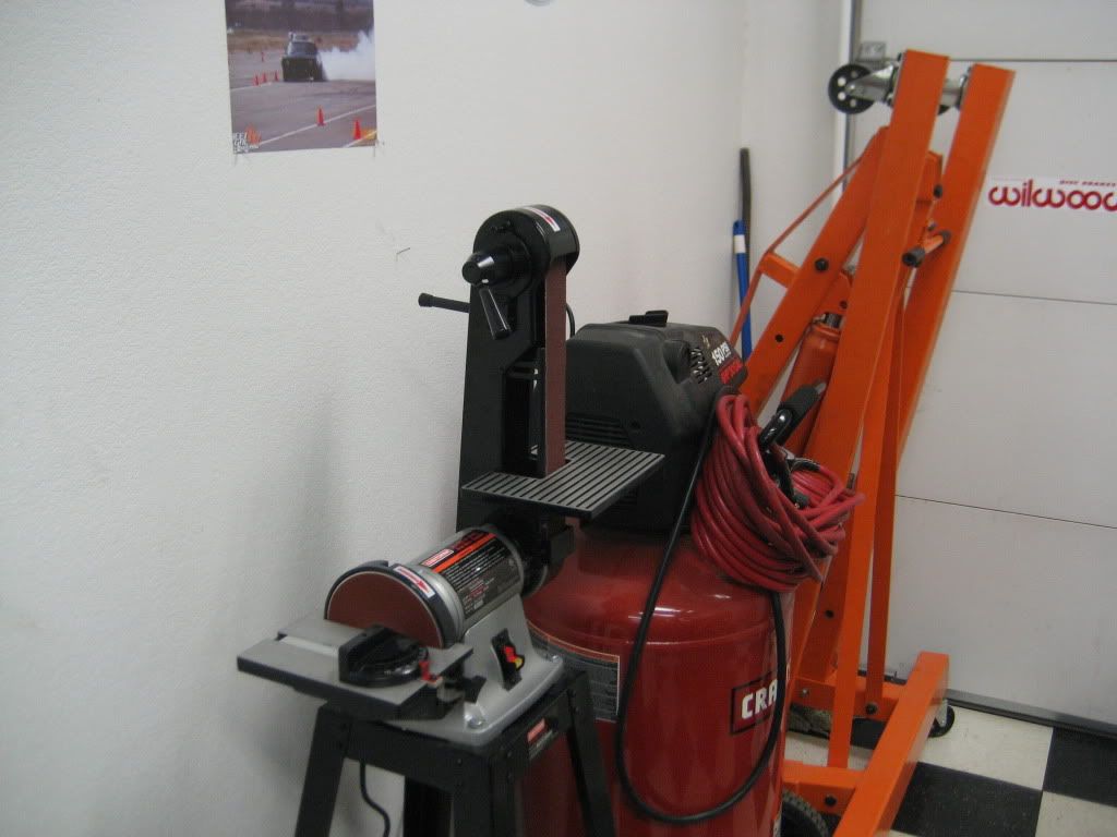

Track Junky 10-23-2011 08:23 PM
Drill press and belt sander!! Thats awesome. I love buying new toys for the shop/garage.
What was that block on the left with the fittings and line tapped into it? Attatchment block? I was thinking oil thermostat but never seen that one before.
sik68 10-23-2011 09:45 PM
Nice! High temps and short shifting are a thing of the past!
Vegas69 10-23-2011 09:49 PM
Mine is going to be mounted partially in front of the radiator support(With a gap of course) and the rest in front of the radiator. I do have a 3 qt accumulator. Big blocks make big heat. :unibrow: I thought about making an aluminum cover for the oil cooler in winter months. I'm hoping the t stat works as promised.
Yep, it's an Earl's T Stat, one way valve, and 3 way to plumb in my accumulator. Starts to open at 165 and fully open at 180. I found that the Mocal and Canton have approx. 10-15% of the oil going through the cooler at all times. This one is supposed to act more like a coolant t stat. We'll see.. My car will run to cool in the cold months at freeway speeds so cooling the oill all the time was not that appealing. (One of the reasons I went with a heat exchanger for oil cooling originally)My decision to go with a 180 was in hopes that it would help my cooling system in the summer in stop and go traffic. It doesn't get to hot but less heat will certainly help my heat soak with modern gas. These are theories and you know how that goes.

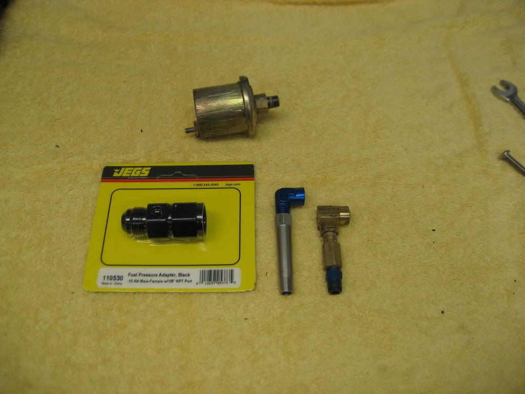

Where did you find the oil sender extension? I could use something like that as I have the same mixture of fittings on my 69 BB.
Vegas69 10-24-2011 09:24 AM
That will be a blast. An Elk hunt is on my radar. I'm going to start drawing for my Desert Bighorn tag. In Nevada, once you draw a tag, you can't draw for another 10 years even if you don't harvest. Some guys have been trying to draw for a long time. I really want to go back home and hunt some whitetails once of these years. I have an uncle that has some prime land we hunted as a kid. I've missed a handful of monsters there.
I found the extension at Jegs. I can grab the part number?
