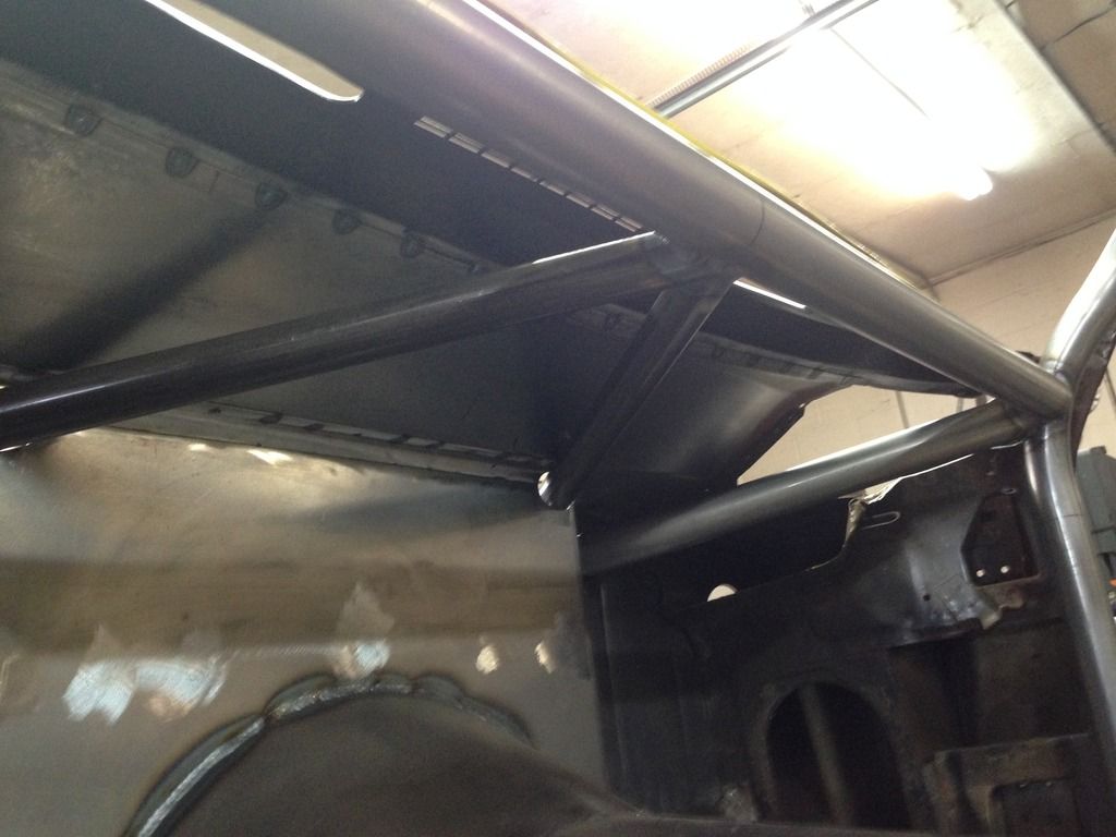

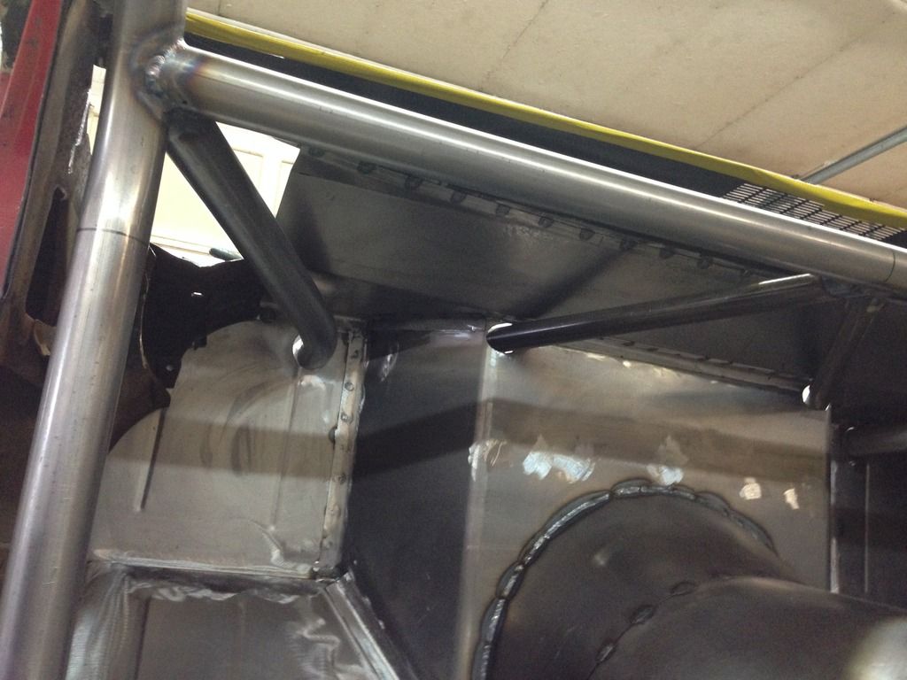

Originally Posted by Payton King (Post 599116)
Any reason you guys didn't use those diagonals to brace the bend in the front upper rails? Would have meant not having to penetrate the firewall, and would have given you better load paths?
Payton King 03-30-2015 07:26 AM
The angle would have been too acute to add much support. Hard to see from the photos.
