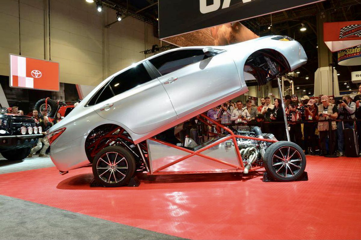

Originally Posted by clill (Post 709180)
He could out run us in a Camray...
Agreed!
https://i.postimg.cc/26HH571z/BD9116...208-F3-CE8.jpg
:P
