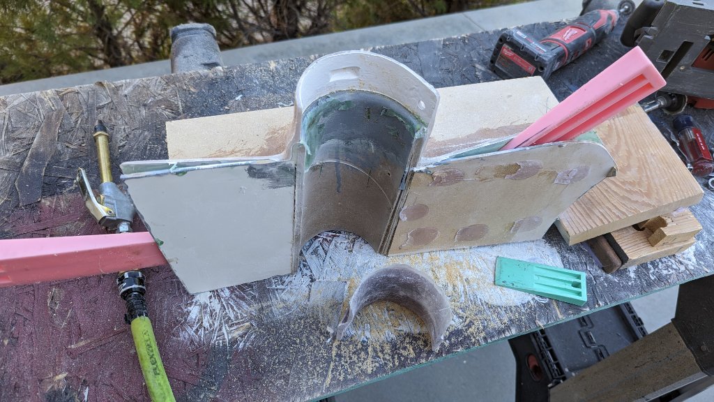

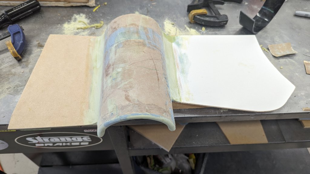

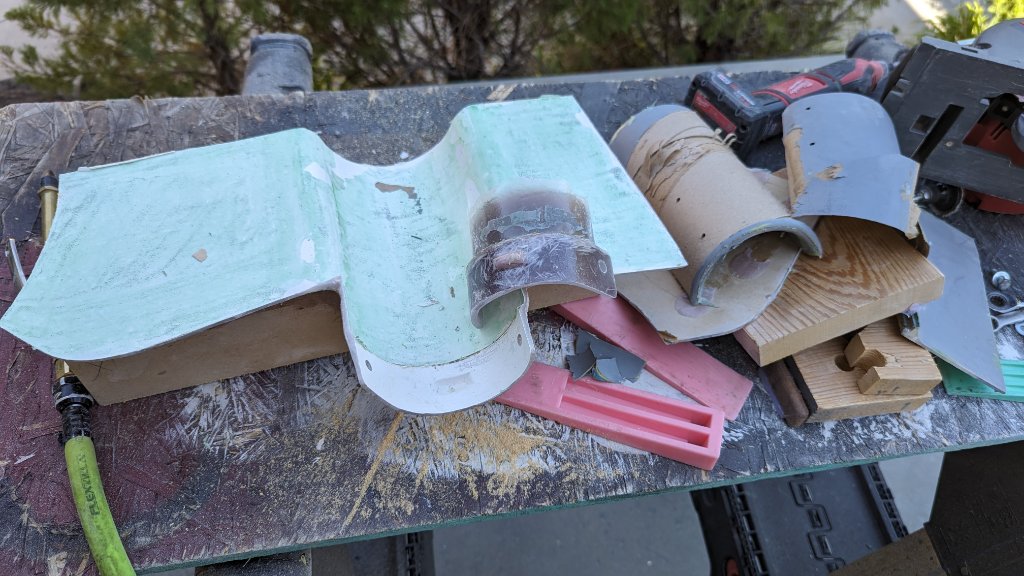

This is the plug for the panel below the steering column.
Attachment 80498
The plug smoothed and primed with plastic hot-glued in place for a flange in the 2 piece mold.
Attachment 80499
The mold completed, with the plug still in it.
Attachment 80500
Same, other side.
Attachment 80501
Breaking out the plug from the mold.
Attachment 80502
All broken apart.
Attachment 80503
Mold cleaned and ready to laminate the part.
Attachment 80504
Yes, lots of work for a one time use mold...for a part that is getting covered and will basically be hidden from view.
Attachment 80506

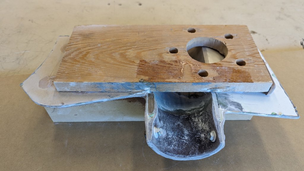

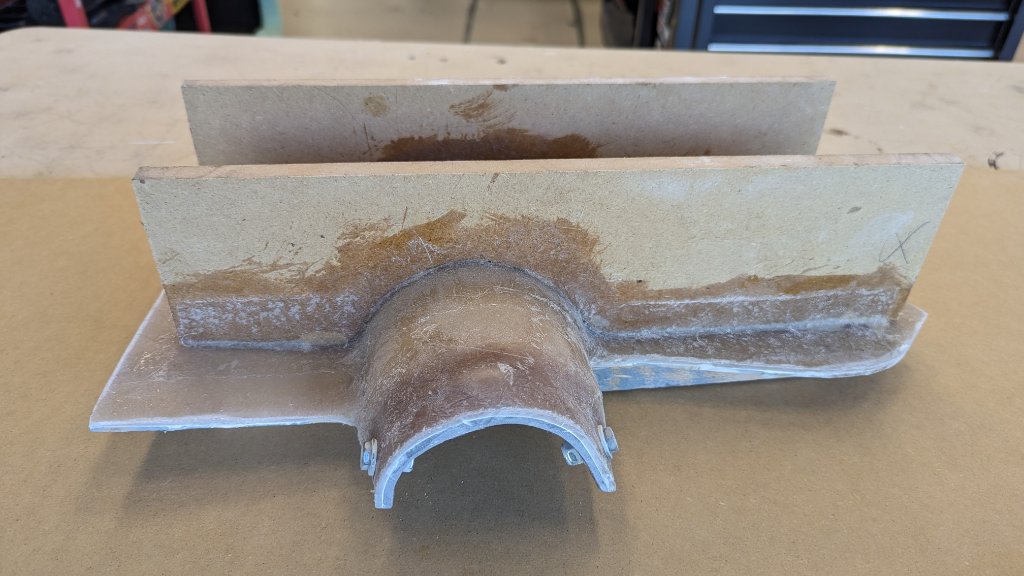

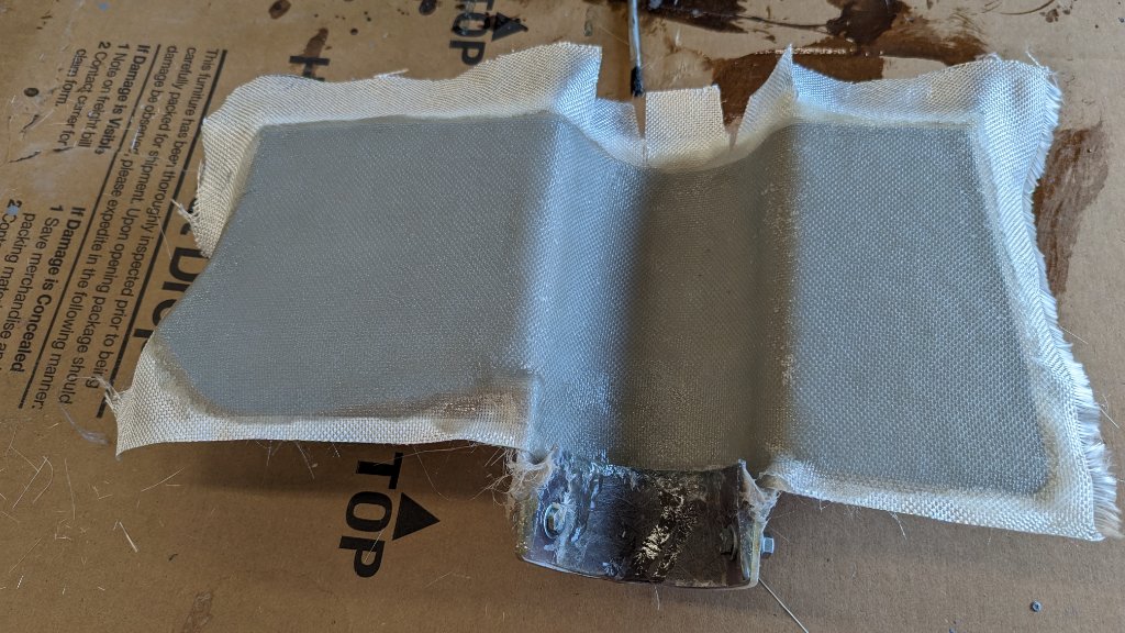

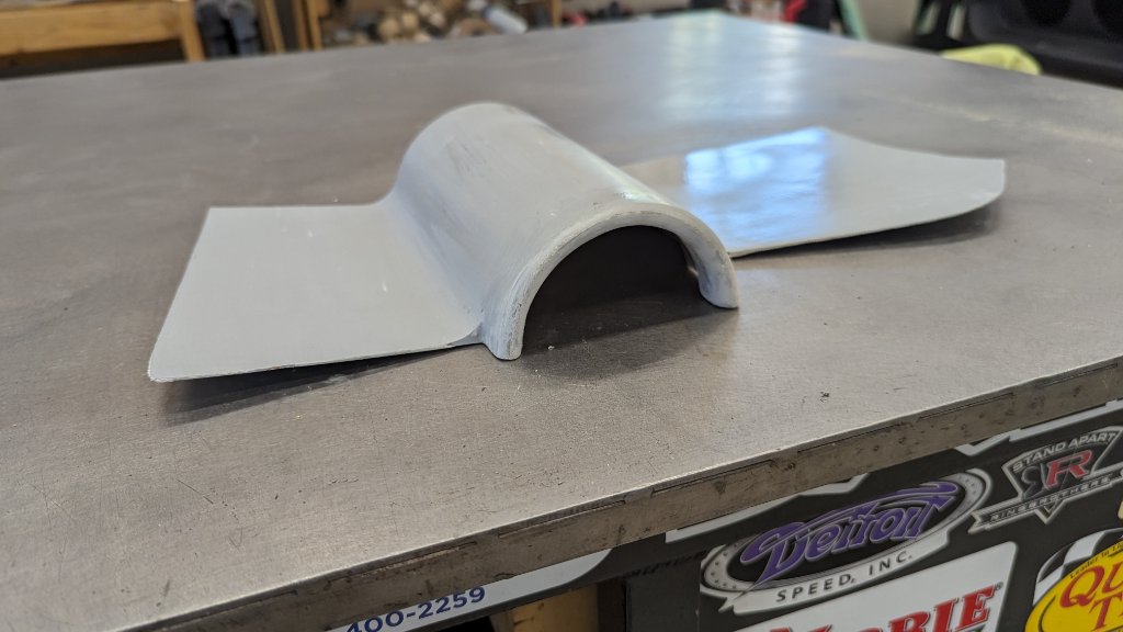

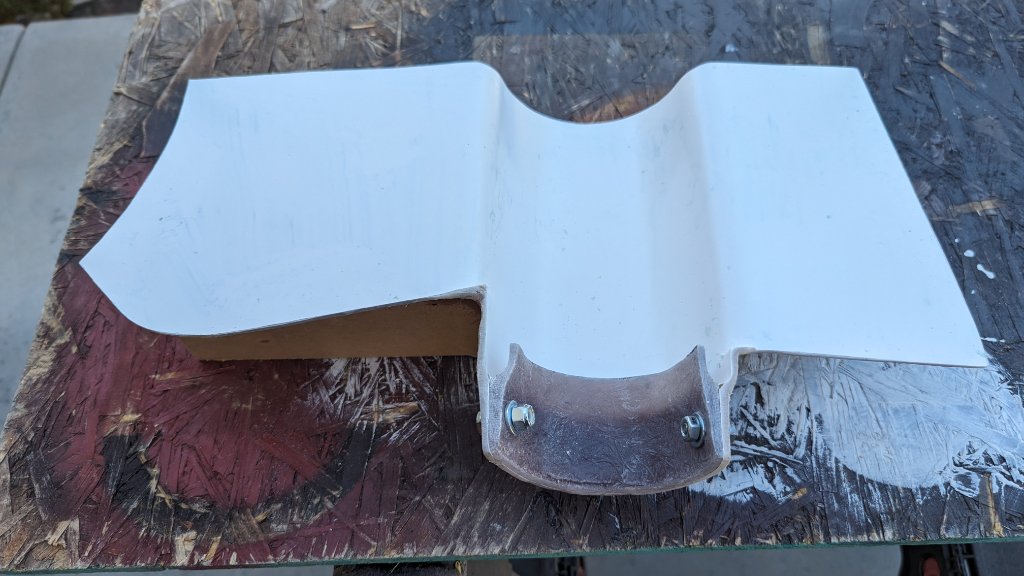

Goosesdad 08-28-2023 07:28 AM
3 Attachment(s)
Thanks gents! Honestly, no voodoo here - glass is easy stuff for the talent in this group!
Laminated.
Attachment 80510
Here the part out of the mold.
Attachment 80511
Attachment 80512

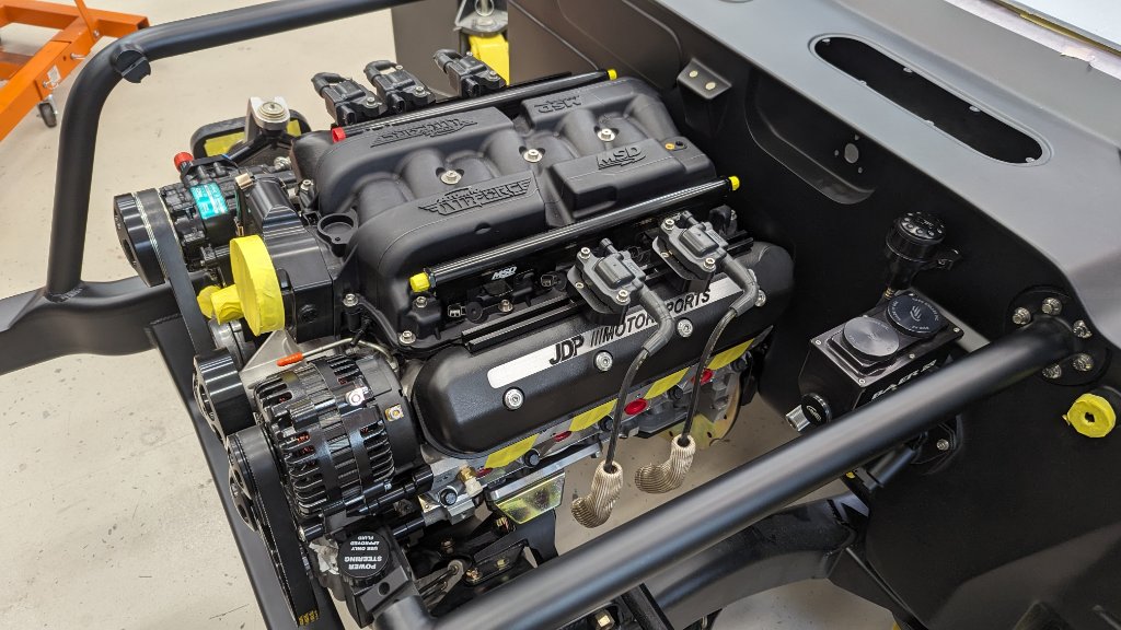

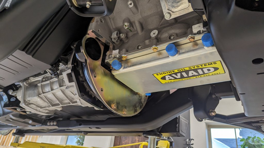

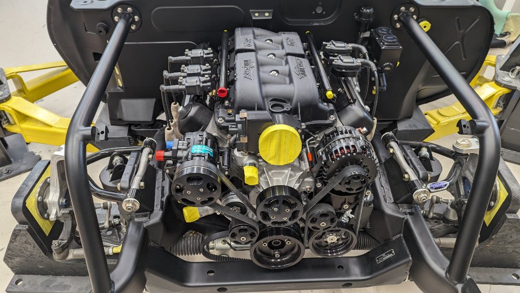

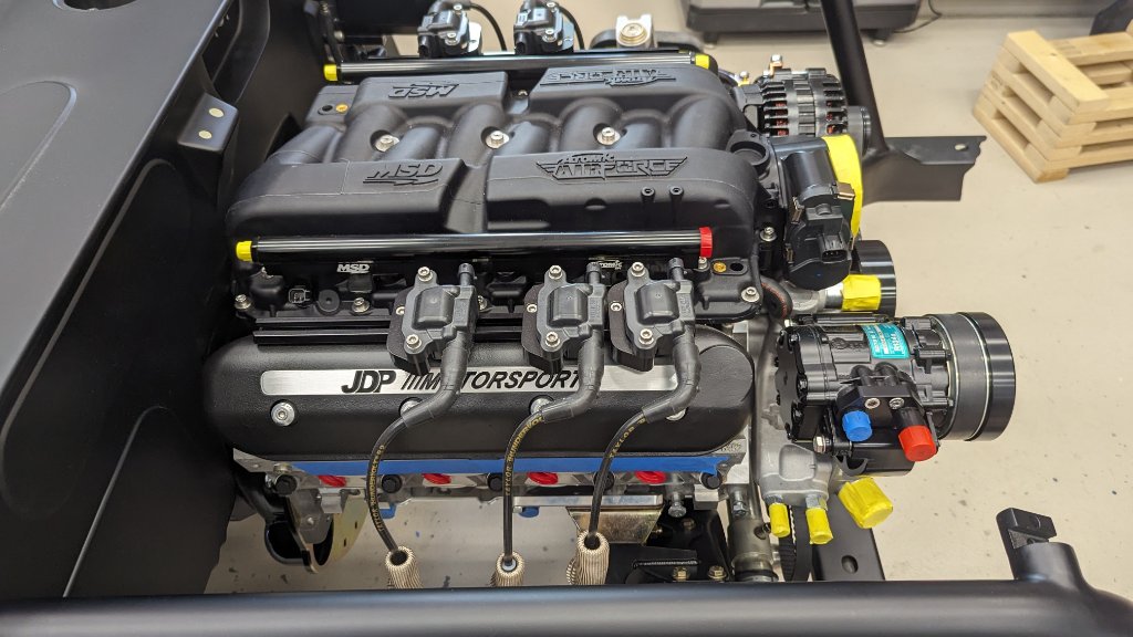

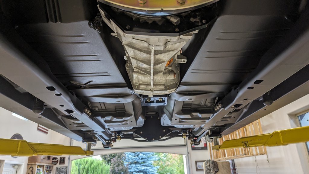

Goosesdad 09-25-2023 08:26 AM
5 Attachment(s)
Set the engine and trans in this weekend. Not permanent, have some details to work out with the dry sump and the headers. It was pretty satisfying for sure!!
Attachment 80596
Attachment 80597
Attachment 80598
Attachment 80599
Attachment 80600
camcojb 09-25-2023 08:41 AM
Looks incredible.
