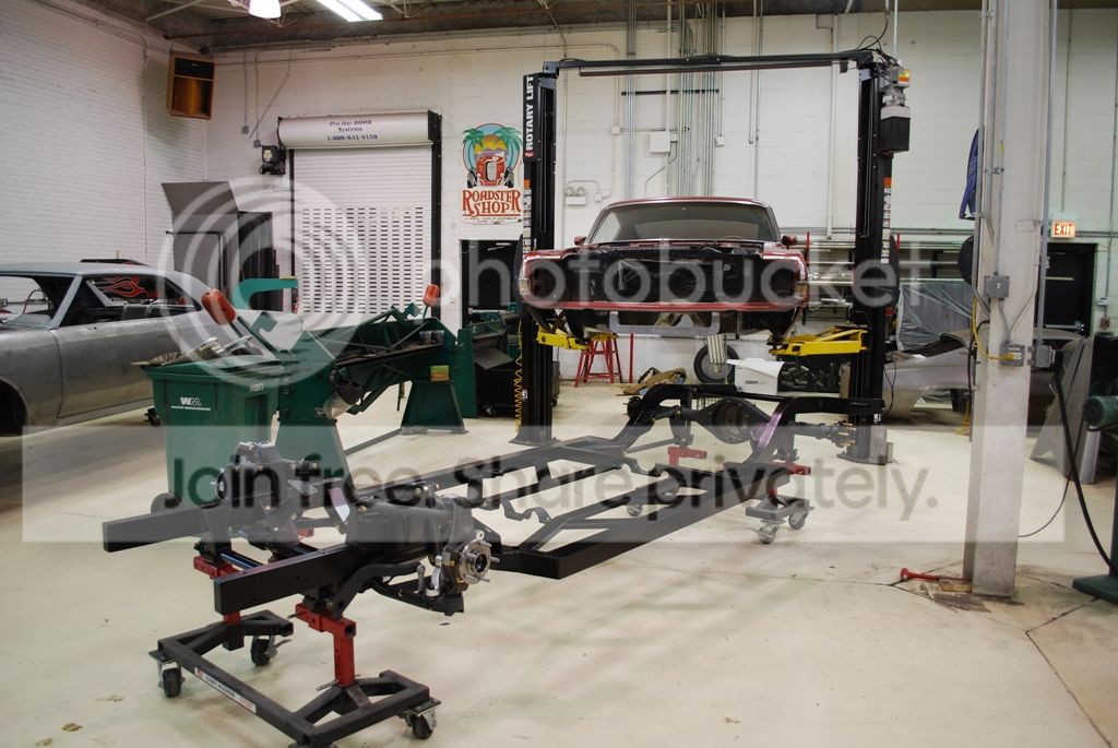

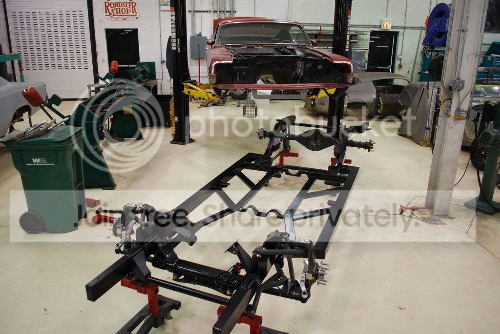

Roadster Shop 01-14-2013 08:43 AM

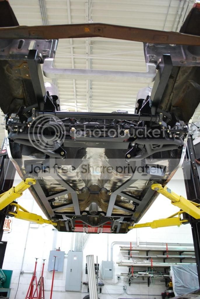

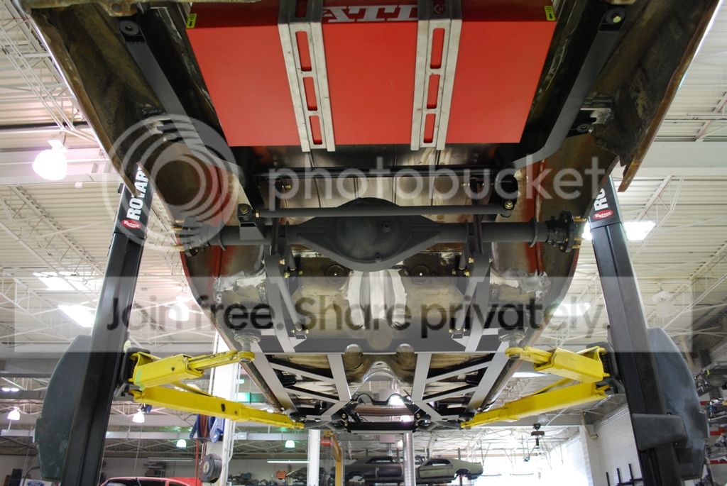

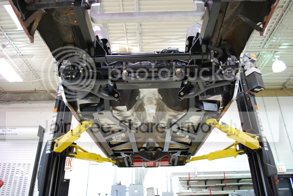

Updated Pics
Time for some updated progress pictures. The chassis is powdercoated, assembled, and back under the car. The fuel tank is in place and we are now buttoning up the final items on the Torino before sending it back to Cali.
http://i563.photobucket.com/albums/s...ps673329e7.jpg
http://i563.photobucket.com/albums/s...pscc6e09c2.jpg
http://i563.photobucket.com/albums/s...psef17d6ec.jpg
http://i563.photobucket.com/albums/s...ps893ddc12.jpg
http://i563.photobucket.com/albums/s...psc8d96462.jpg
http://i563.photobucket.com/albums/s...ps1787637d.jpg
GregWeld 01-14-2013 08:55 AM
:thumbsup: :thumbsup: :thumbsup: :thumbsup: :thumbsup:
Did you have to install a new heavier duty Rotary lift in order to hoist that bad boy up there??:lol: :lol:

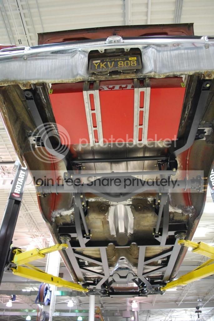

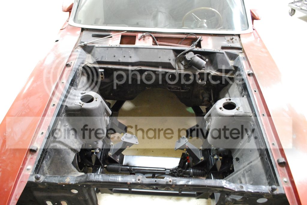

Roadster Shop 01-14-2013 06:31 PM
A few pics from the end of the day.
http://i563.photobucket.com/albums/s...pse75ed920.jpg
http://i563.photobucket.com/albums/s...ps469748d7.jpg
Rob is still working out the ideas for the inner fenders and possibly down bars from the firewall to the frame. The shock towers and most of the inner fender will definitely go. We just left it in for strength during transportation.
http://i563.photobucket.com/albums/s...ps3349c718.jpg
Pretty good shot of the frame rail to pinchweld difference. Not too bad considering it was a unibody car and we were able to get a 3.5" - 4" frame rail in place.
http://i563.photobucket.com/albums/s...ps5b22de2b.jpg
